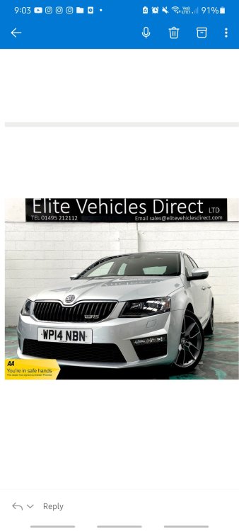

Skoda octavia vrs iii
Hello there, new to the forum and skoda octavia 3, i previously had an octavia 2 vrs
I want to retrofit powerfolding mirrors, but i don't know what's needed for it, the car is an 2014 octavia vrs
Thank you
