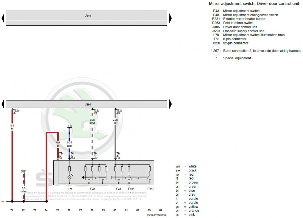

Looking at the new switch with Fold-in function, there are 6 pins (I have not looked at the old one yet, as it is still fitted). I have also looked at the wiring diagram, which shows 4 wires in T6r. My question is this, does the new Fold-in Mirror Switch (fold-in, heated, left/right adjustment) need four wires or 6? If the latter, where do the extra two cables go?

Just had a quick look at the WD I have and I can only see 4 wires :)
The fold in switch (E263) looks to share the resistor ladder with the other rotational settings which makes sense:
Yeah it’s 4 wires, no extra wires need adding, switch is plug and play.
@langers2k thank you, that looks like the same WD I was looking at. I am glad I was reading it correctly.
Thank you @SashaGrace you have confirmed I am not going mad. If the rain holds off tomorrow, I will replace the mirrors and the control switch.
