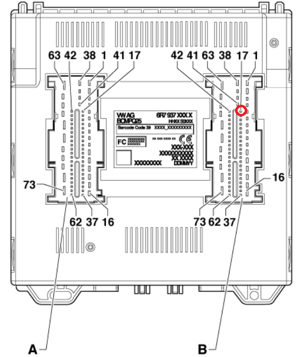

With the BCM is this located behind the fuse board on these cars is it located behind the hidden relays with the white and black plugs in the back of it?
I have been assuming for a while this is the BCM but i could be horribly wrong this is what i think its looks like by feeling the plugs on it last night could not really see it though as it was dark and i was upside down.
  • Sponsor
Yep, that's it. Not sure if both of those connectors are 73 ways or not.
Wiring diagram calls it 73b, as if there might be a 73a, but doesn't say anything about connector colour.
Maybe best to find pin 17 on both of them, and see if the grey/white wire from pin 5 at the A-pillar gets to either?

It's the white connector, I've just found out.
thats good how are the pins layd out does it go from top to bottom or bottom to top on this connecter or do i need to just send it and play around for a while :)
  • Sponsor
39 minutes ago, Pete_Ex-Wino said:
Perfect ❤️ we will soon see how deep i have got myself into this car im getting quite giddy about the thought of finally fixing this issue if i cant don't it I'm going to have to put the white flag in but i'm determined to fix it now.
