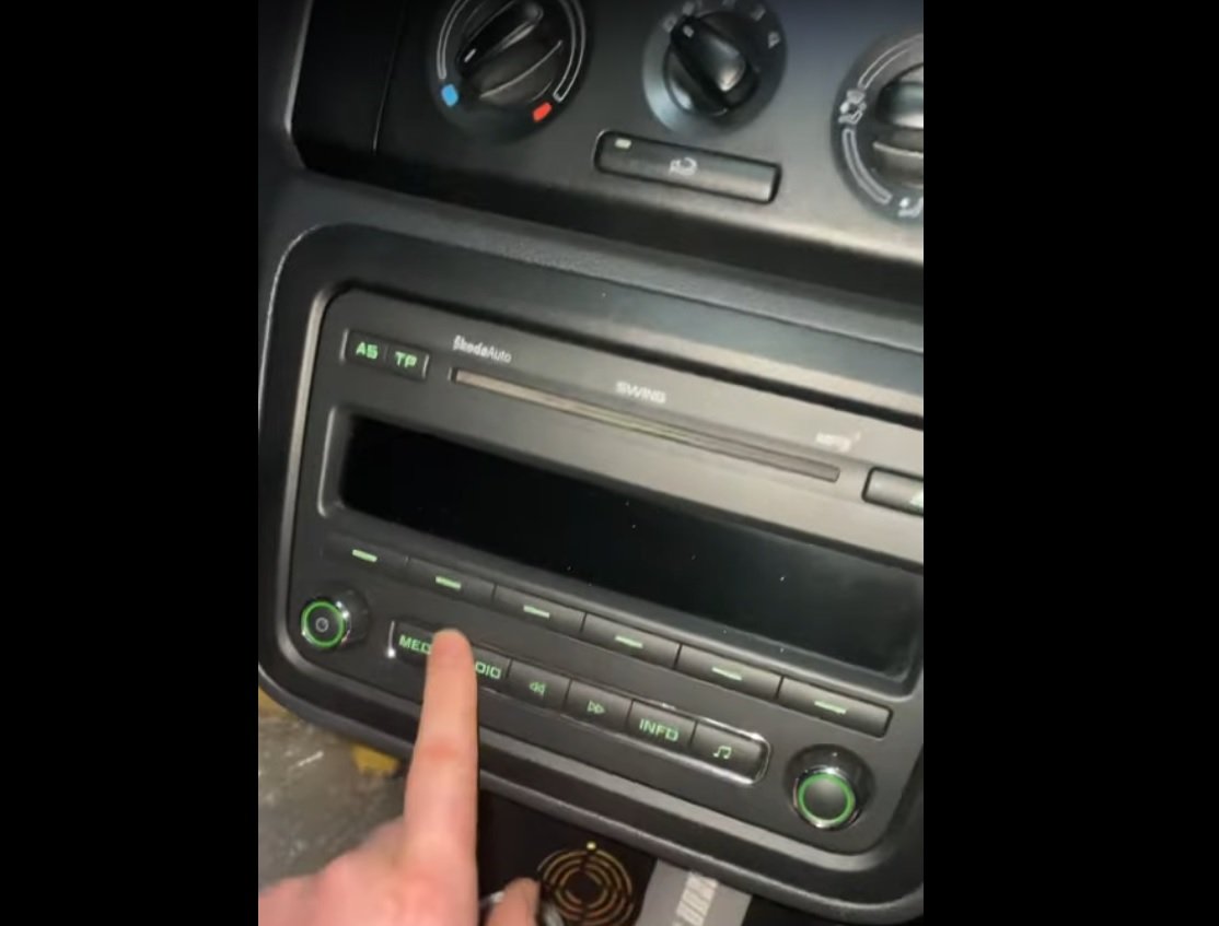

Please see video I have just made quick
fuse box has no switch
and yes the
I personally think it might be a control module fault but I might be wrong and I don’t wanna go digging into the dash to find it really 😞

in this part of the video, the illumination on the stereo "seems" to be on "before" you press the unlock dash switch.......
What happens regarding interior illumination when you unlock the car...DO NOT put key in, just flick lights to position 1 ?
