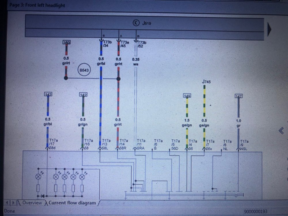

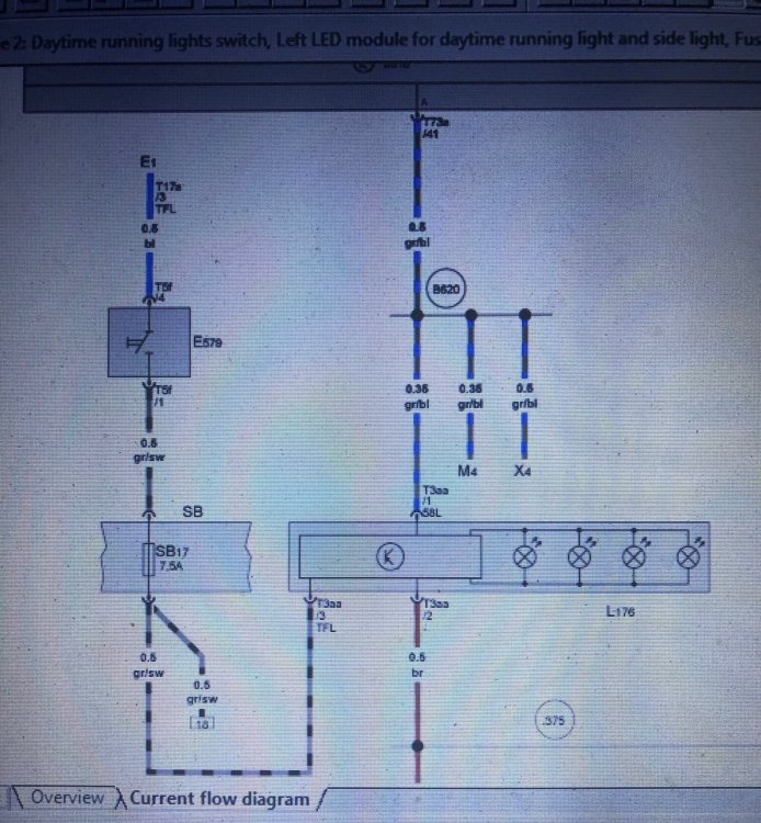

Yeah i get what you mean lol yeah i phone the skoda dealer where the previous owner brought the car from and they have informed me that my car does not have DRL and its not factory fitted and was not brought as an extra which is not good for me im going to have a hunt through the engine bay tonight and start on the light connectors to see if there is something poking out i have a theory that the burnt-out earth cable has eaten some wires for the rear of the car and the BCM thinks the dipped beams are always on whitch make sense but nothing so fair on this car has made sense.
Pete the wiring god can you please send me the pin out for the dipped lights on the BCM if you have it if not ill prob have to buy the Haynes wiring manual which will make me cry im soo glad im not colour blind.
I have no clue about this one but generally I've found Haynes manuals have errors and omissions (not that manufacturer's workshop manuals don't) but updated databases should probably be corrected and have less, stick with a good source of info - but obviously all sources need cross referencing and checking as much as possible - especially if from my direction.
do you have any ideas of where I’m able to find this sort of information as I don’t wanna bug Pete to much as he is a very busy guy :)
Looking at the various versions of the headlights on the MK2 (2011) the dipped beam supply does not go via the BCM only the side light output from the light switch goes to the BCM
