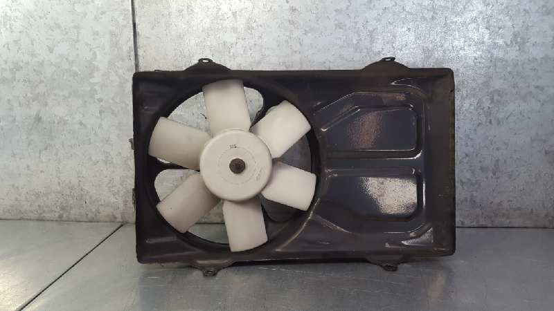

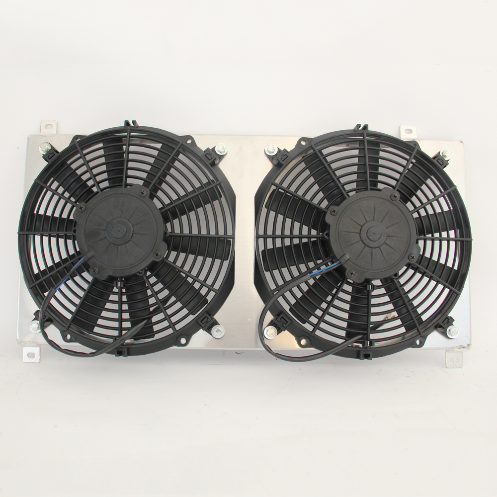

Also, If I were you, I would make the 1.6 radiator conversion and add a double fan setup for it.
Maybe something like this:
Make the second fan to have its own circuit and fuse, also add a manual emergency switch hidden but close for you to easy access when needed.
That's what I think as an ultimate cooling mod, worthy for your Trusty. :)

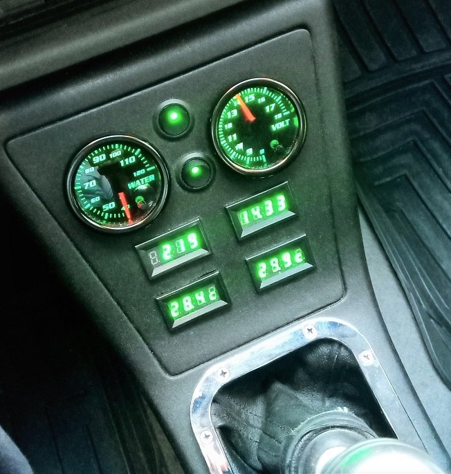

Yes i still have them but after the well known problem the sensor ''reads'' the coolant temperature just before the radiator and it's hard to look in the console while driving especially in Mountain roads.
I had in the past a gauge in the plastic column (driver's side) but blocks the vision in parking movements.
I have to thing about it.
What worries me is that i can not attach a sensor inside the expansion tank for example so i could read the digital numbers  easily at a glance.

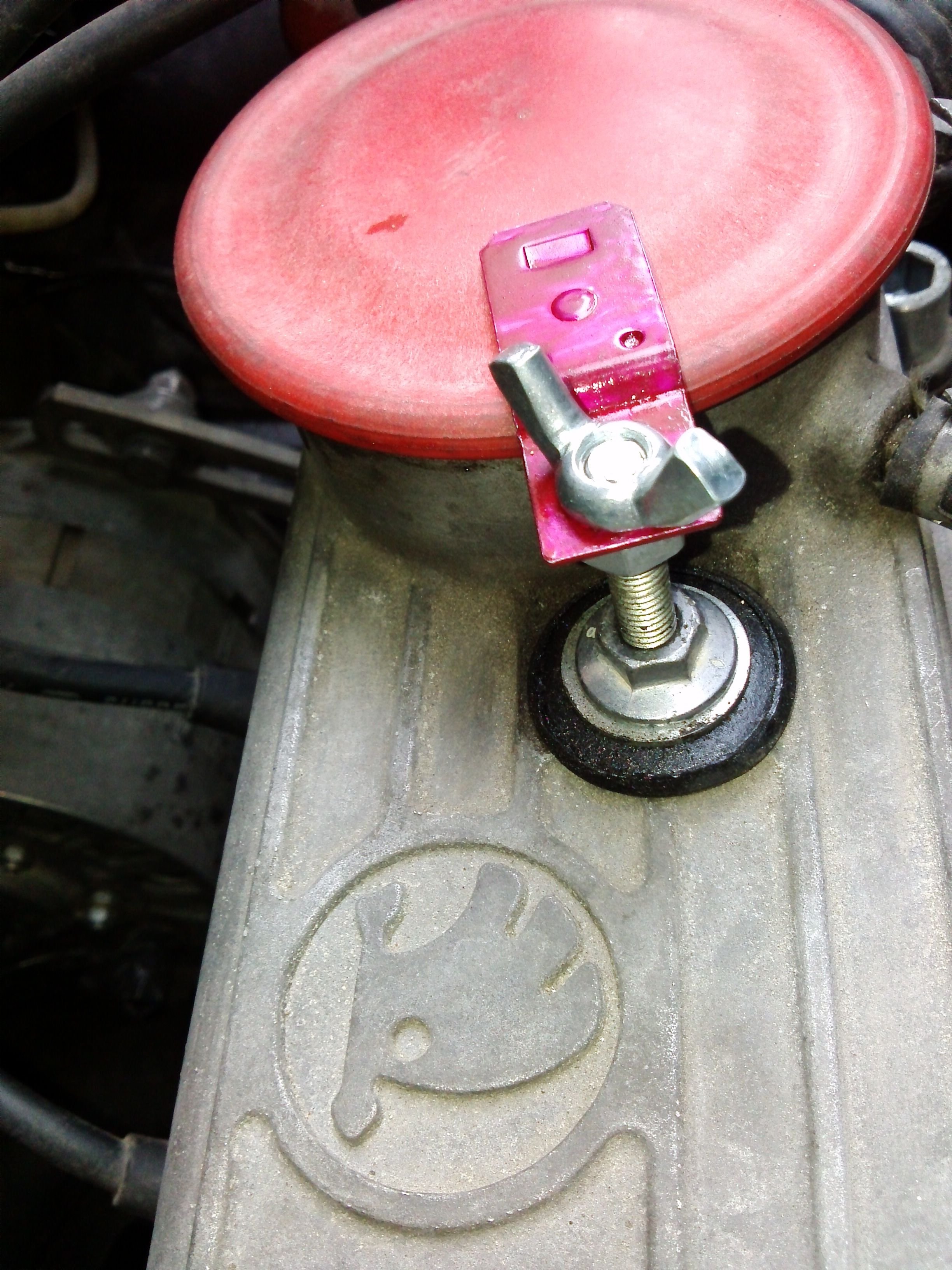

After reading your first post, I was thinking for a solution for the oil cap.
Here it is, a quick release design.
''better Safe than sorry''
I just change the gasket every year...

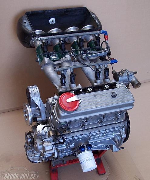

On 19/12/2022 at 17:24, Papez said:
This is actually used on racing Skodas
It's always a welcoming sight to see race modified classic Škoda engines. :thumbup:
Well they can be race modified and get many ponies out for their displacement and topology.
8v non xflow
1 hour ago, Thefeliciahacker said:
8v non xflow
Yes but mine tried to escape twice.

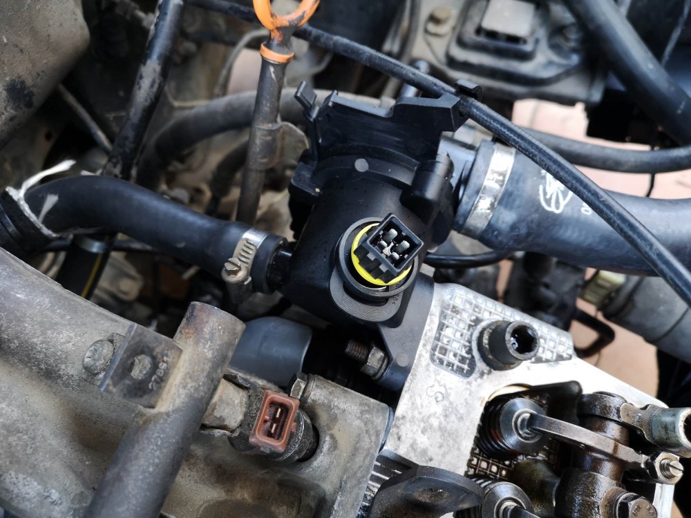

Another ''engine bay surprise'' today.

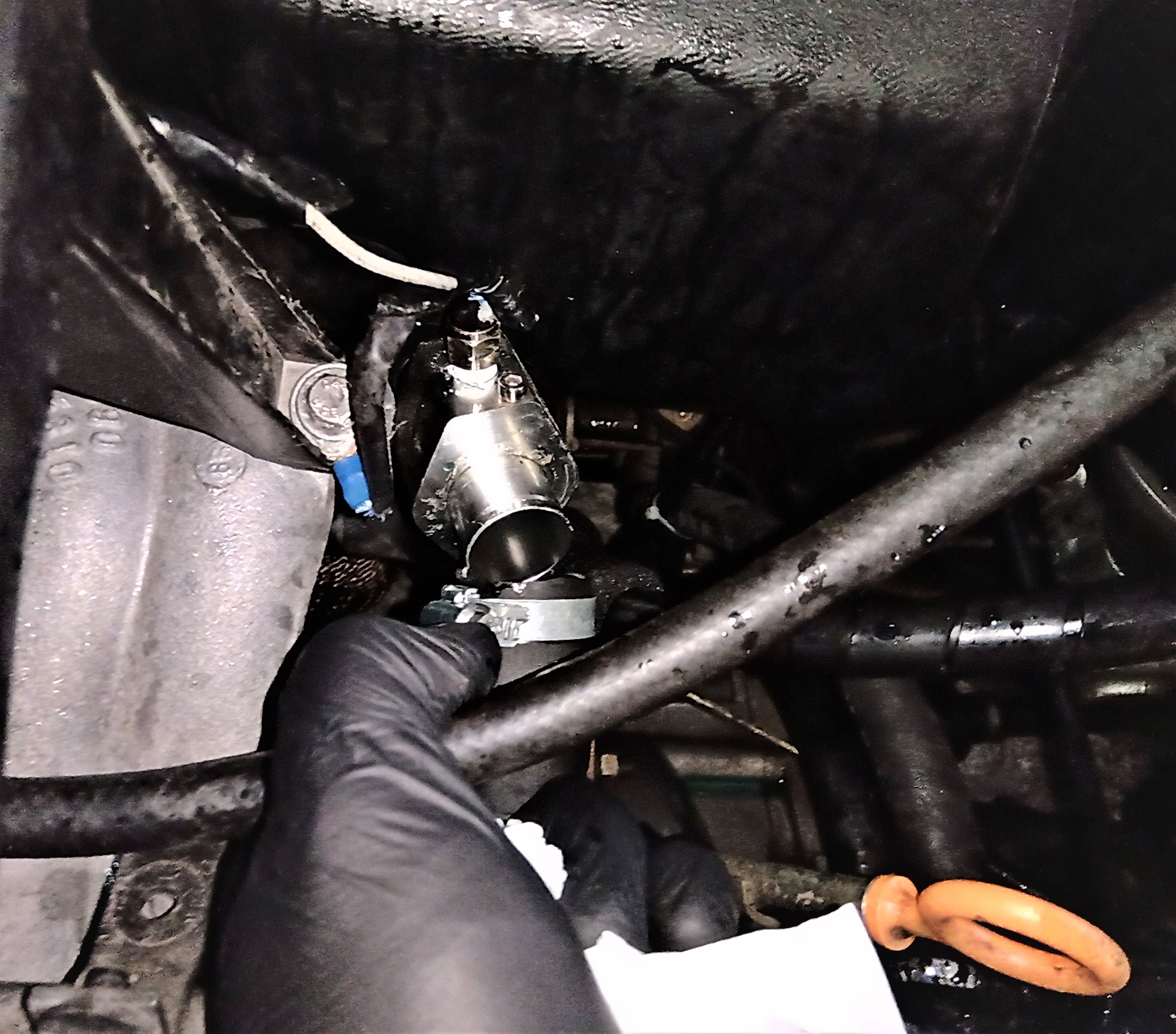

I asked for an inspection due to my future trip for Christmas, few days ego i noticed that the level of coolant was few cm lower i asked for a Coolant leak test (by ''pressing" as we say it here) and a ''sneaky" leak was found.
Sloppy work from previous mechanic with overtighten and a crack show-up in thermostat housing (it's plastic), the leak was on the lower side, not visible as you look the engine bay.
Plus some cracks show up in Poly-V belt and i change it as a precaution and the mechanic found one Steering Rack Boot with a cut so i replaced them both.

I have found in my photos archive another unpleasant ''Engine bay'' surprise.
Sloppy work from a mechanic in thermostat, the screws and the use of gasket glue, after some years i noticed the Coolant level went 2cm down and in purpose i asked for a ''pressing test'' and the new mechanic found a small leak.
Was from below, not obvious at first glance or as you look at it from above.

The thermostat outlet shall be held in with 3 plastic thread screws, and no need for RTV just buy a 20cent O-RING, replace it and be done with it.....
Take note on how it should look like
Read again, i said ''archive'' which means Old.
IF you have paid attention you would notice the Yellow ring, was for a test period only since i use Blue, the thermostat housing has been replaced.
