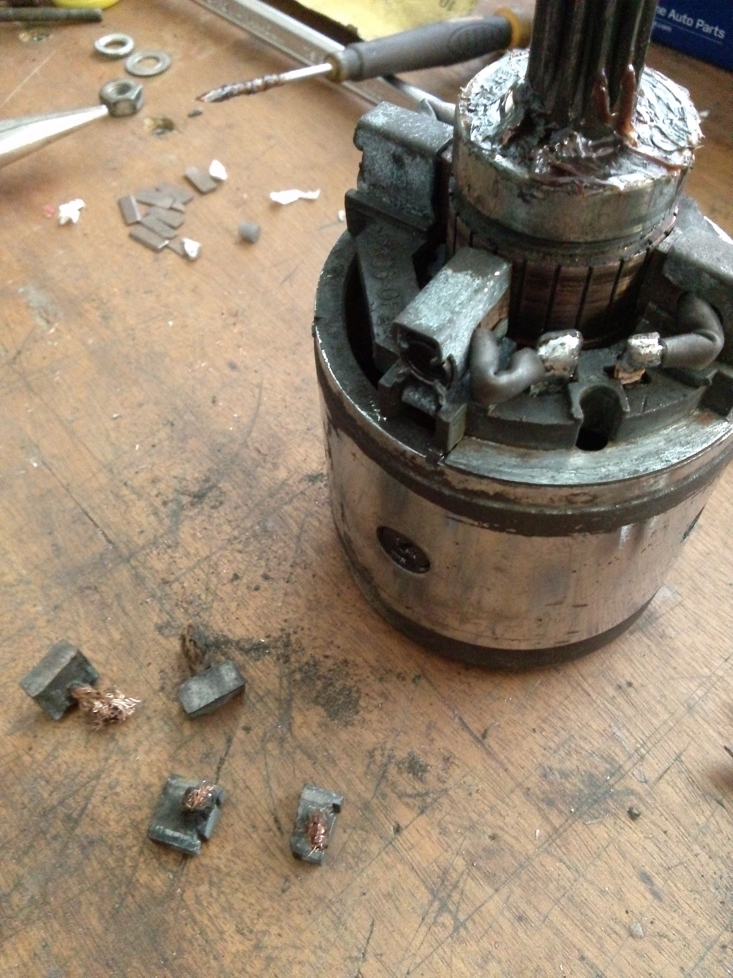

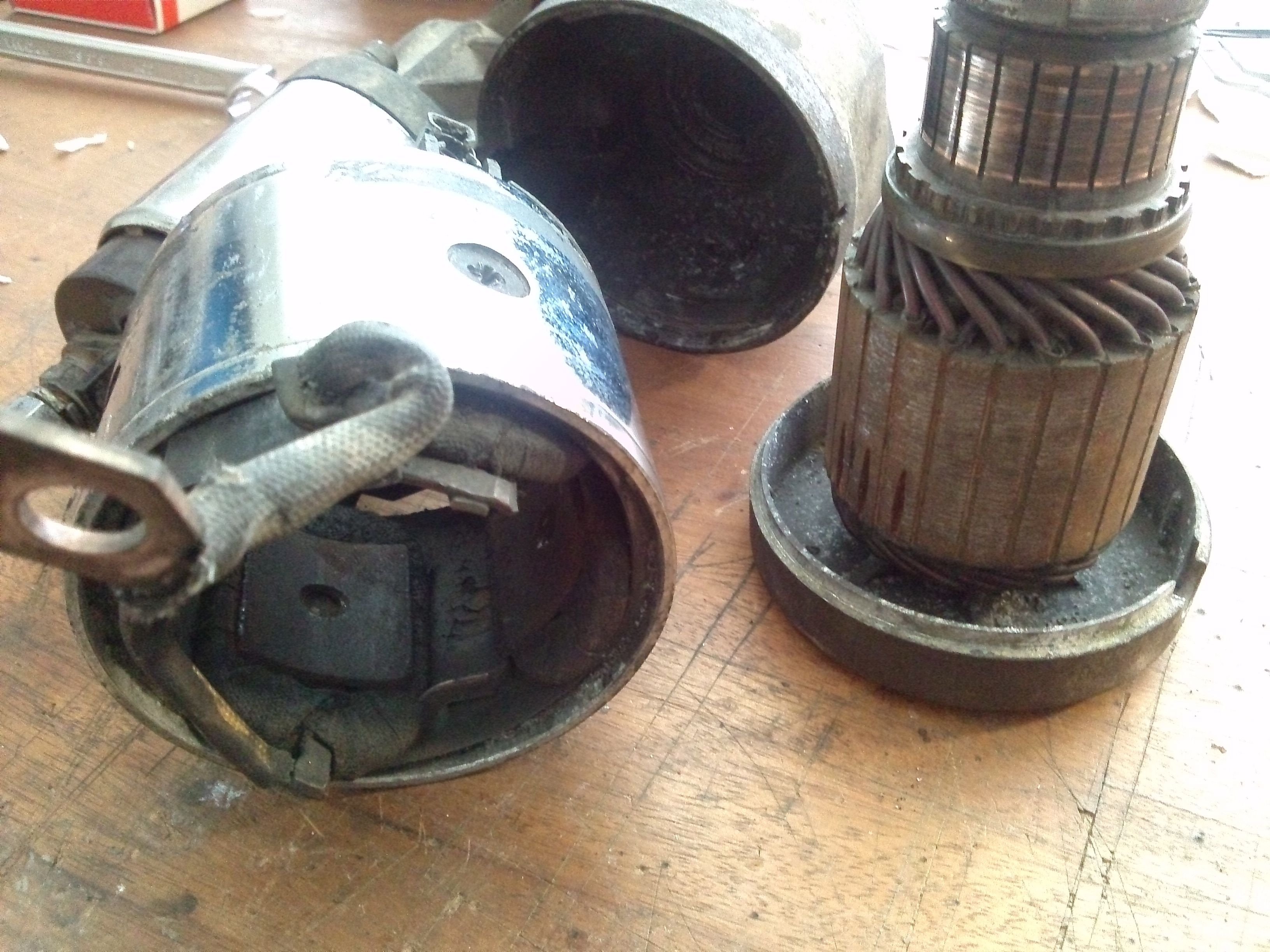

Abnormal level of rainfall happened last week. Ordinary roads turned into rivers. Many cars were stranded on the roads. I had to take the car out that day. I used the most unaffected roads but I couldn't escape all.
The starter motor was working after the water riding but it sounded strange. Next day, it wasn't working. I had to push the car to start it.
Engine bay was pretty dry and had no sign of water residue but after removing the starter motor, I had my SURPRISE. It was filled water. 😞
It took the weekend to clean, dry the whole starter motor and change the fouled carbon brushes.
This starter motor is a Felicia 4 brush type. Probably you have something similar.
Opel Corsa 4pcs. carbon brush set fits after cutting from both edges. Code Rx120.
