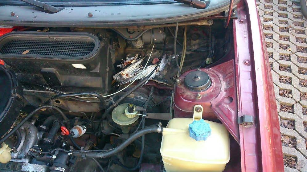

Here's a photo from winter 2015.
What you see are the remains of a poor pigeon. God only knows for how long I drove around with that in my car.
Some animal rented my engine bay to make itself a nice restaurant. Probably a cat or a ferret.
Oh God, did you got any bad smell inside the cabin?
Actually no, as it was the coldest part of winter and what remained of the pigeon were just bones and feathers.

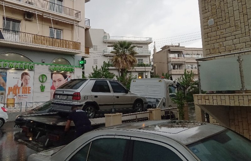

Another engine bay surpsise yesterday:
The main coolant hose popped-up from the radiator socket and coolant came out, today i am in the repair-shop.
For 3rd time in her life my Trusty is on the Road Assistance truck, ''wounded". 😪

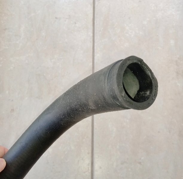

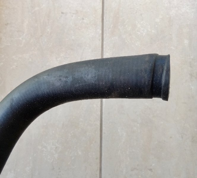

Here is the main coolant hose, the mechanic had pushet it all the way back to the end and the clamp hose was a quality one but after 2 years 9same month, same hour) decide to ''escape''.

That doesn't look great at all, photo suggests the hose might be too short, or perhaps wrong shape, or other end was given too much "spare", or the radiator inlet wasn't positioned correctly for some reason. For many years now I prefer (well made good quality) silicone hoses as they are so much more durable than the replacement hoses I could get and NOS (kept correctly) had disappeared or been used up as far as I could find anyway. When it's possible, pay more and fit once is my motto it usually works out less expensive in money and hassle not to mention possible other damage.
The length-diameter was for this radiator

The main problem was that the radiator's plastic socked was broke and a half part of it was ''available'' to get the hose inserted.
The mechanic pushed the hose as deep he could and tighten the clamp closest to the main radiator as he could.
For 2 years i haven't even a drop as leak but suddenly...boom !
Fair enough, I forgot that. I think back then sleeving or inset might have been suggested - but you got 2 years out of a temporary fix so not bad.

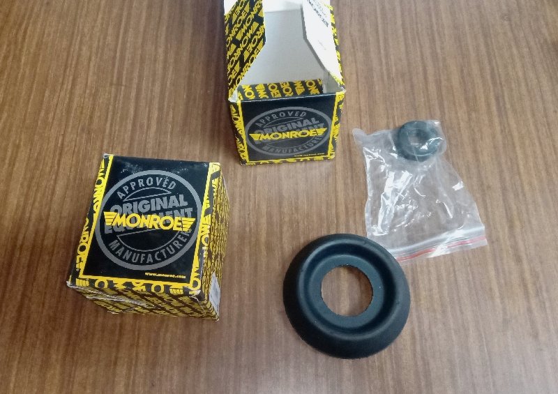

Another (unpleasant of course) surprise, Top Mount.
The previous mechanic in the Koni rebuild task at 2023 told me that the top mounts were ''OK'' but recently i had some vibrations when i was in uphill in 2nd gear, i had to brake and downshift in 1st and then i had to accelerate.
I went to my mechanic and raise it in the lifting jack and telephone me that would be a good idea i to replace them.
MONROE MK069
6U0 412 249
6U0 412 355
The mechanic said that in the driving test the front suspension was ''more tight'' than before but i have no personal experience because those days due to the good weather i am using my small motorcycle to go to work.

Monroe is very poor quality

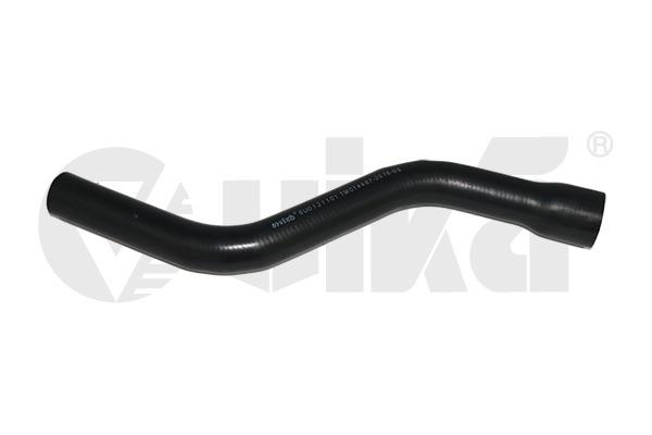

Hi-tech situations, now VIKA coolant hose with marking on it. 😄

6U0 412 355, few examples:
https://kritosparts.gr/part.aspx?expression=6U0%20412%20355
https://www.maxxparts.eu/code/6U0412355
https://www.getparts.gr/index.php?category_id
Done today.
After few kilometres in a small Mountain Road and in City Traffic: the front-end is a bit more tighter than before, no vibrations starting from traffic light in low rpm or going from 2nd to 1st (and accelerate) for example while braking due to a front car sudden deceleration.
Is 2020-12 manufacturer year and month or "best before" date. 😄 I used to fit top hoses that were crazy at less than 12 months old, which is why I went over to (purpose made from ) silicone hose kit (three-ply as four ply was difficult to fit in some circumstances) a fit and forget solution (I know you can't get such kits for your model).
That's why i wrote ''Hi-tech situations''
VIKA now delivers ''fresh'' products to your door.
