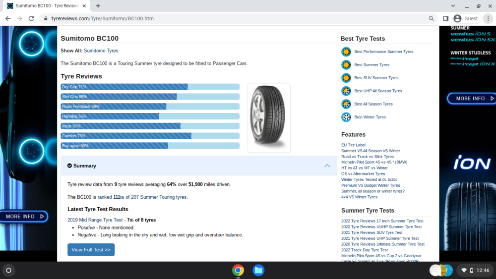

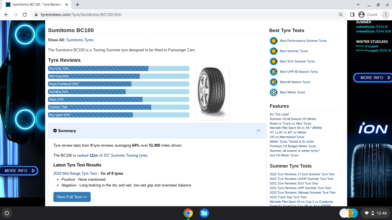

So not considered ditch finders, just reasonably cheap tyres that are hard wearing and not so good at stopping maybe.

17 minutes ago, CReese123 said:
I'm unsure buddy, given I've only noticed this today after two weeks. I'd have thought if it were tyre related I would've noticed the issue instantly upon changing them? I've drove a decent amount in the meantime.
Sumitomo tyres - 185/60r15
Surely abs engagement at 5-10mph isn't nt meant to be, though, regardless?

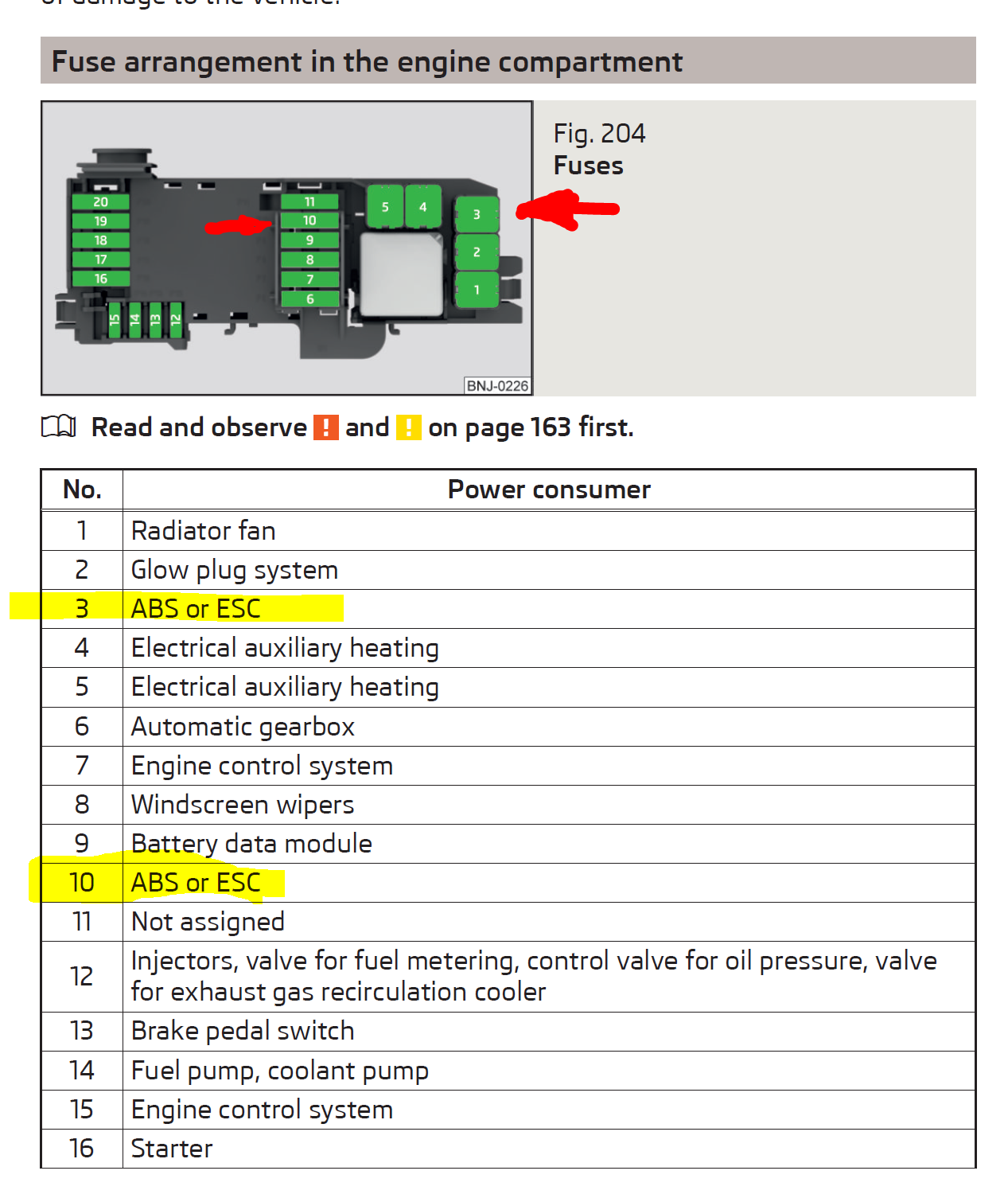

I think @Breezy_Pete has the solution here: disable the ABS completely and see what happens when you jam on the brakes at low speed.
If the wheels lock, then there's your answer.
I think this is what you want. https://manuall.co.uk/skoda-fabia-2016/
(Image below is a grab from page 166 with highlighting and arrows)
