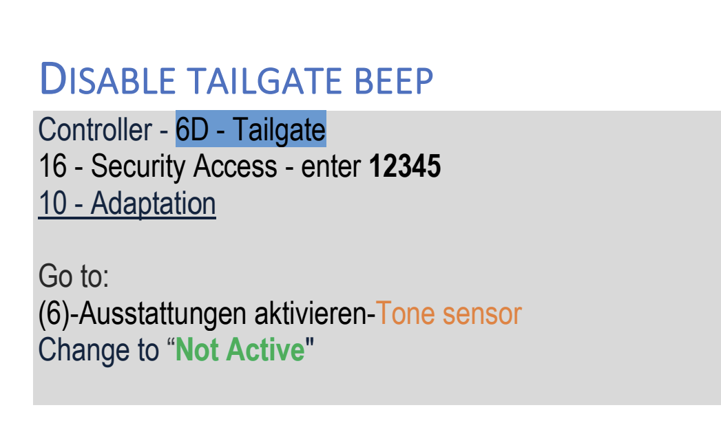

U can use either VCDS or OBDEleven to disable the tailgate beep, using these instructions:-
1637644643_Screenshot_20220702-1030322.thumb.png.b7f4618f11c4877a5c569428b209d6f3.png
just be careful if you've got the kick sensor for closing the boot (or whatever its called) I turned off my beep, and I've been smacked on the head on more than one occasion, because the cat has triggered it to close, or I've triggered with my foot by accident. 😆
