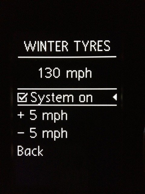

i got my car 3 weeks ago and the tyres are bridgestone t005 yet when i hit 74 mph it flashes up caution winter tyres.why?
Hello Jos, there is a setting in the infotainment system, settings - 'winter tyre speed warning' - if normal tyres are fitted, you need to uncheck the box.

@Joss1733You go to settings and Winter Tyres and cancel or set to some warning speed that suits you. Maybe 100 mph where that would get a ban.
Since no Winter Tyres are on that can maybe be used as a different speed from your other Speed Warning you can set on the car.
The car does not know what tyres are on,
the setting @ 74 mph will have been done by someone in error.    Or a glitch with the car and it is set for 119 kp/h
Reading the Owners Manual will help greatly.
thx for the info
