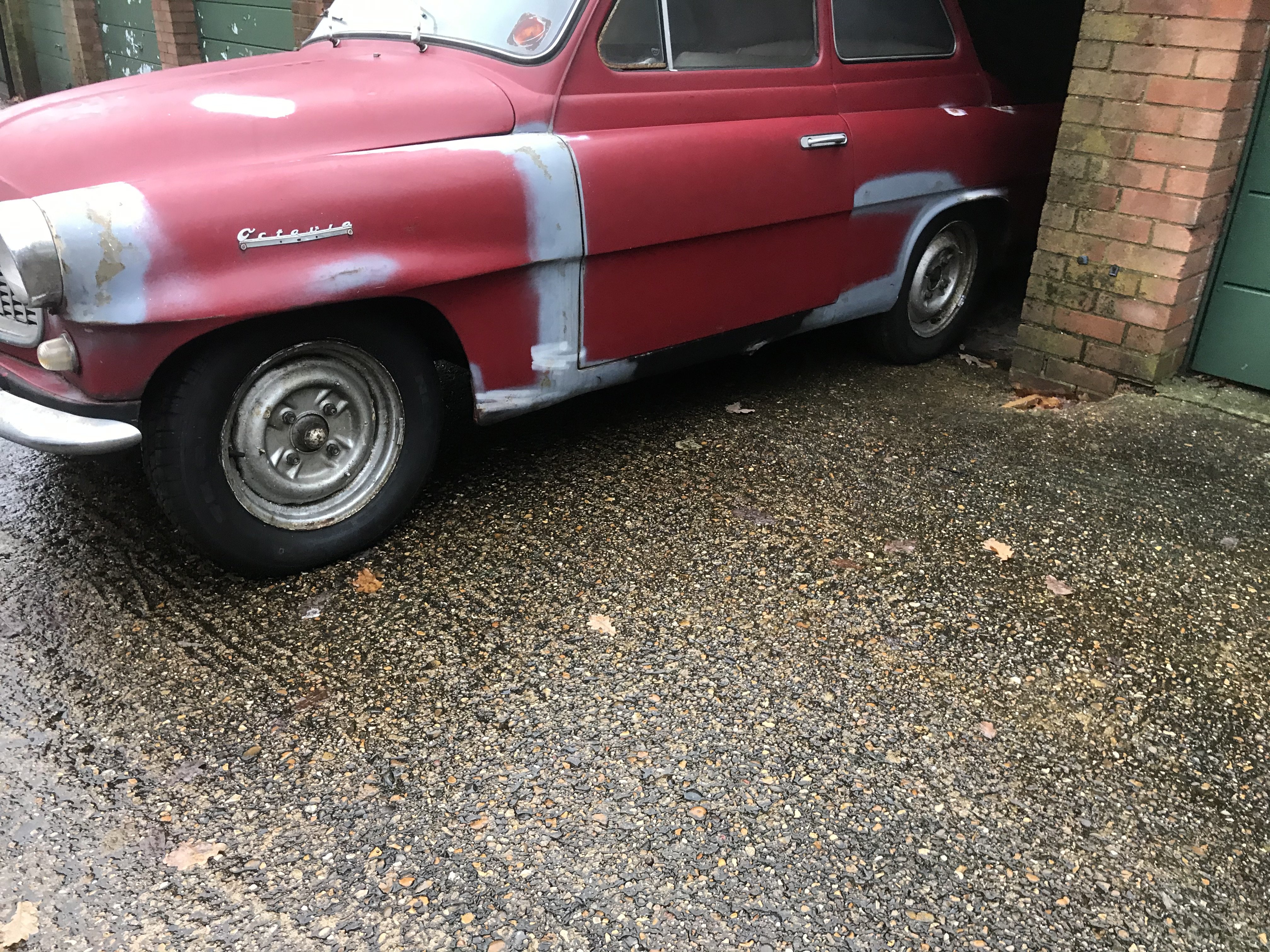

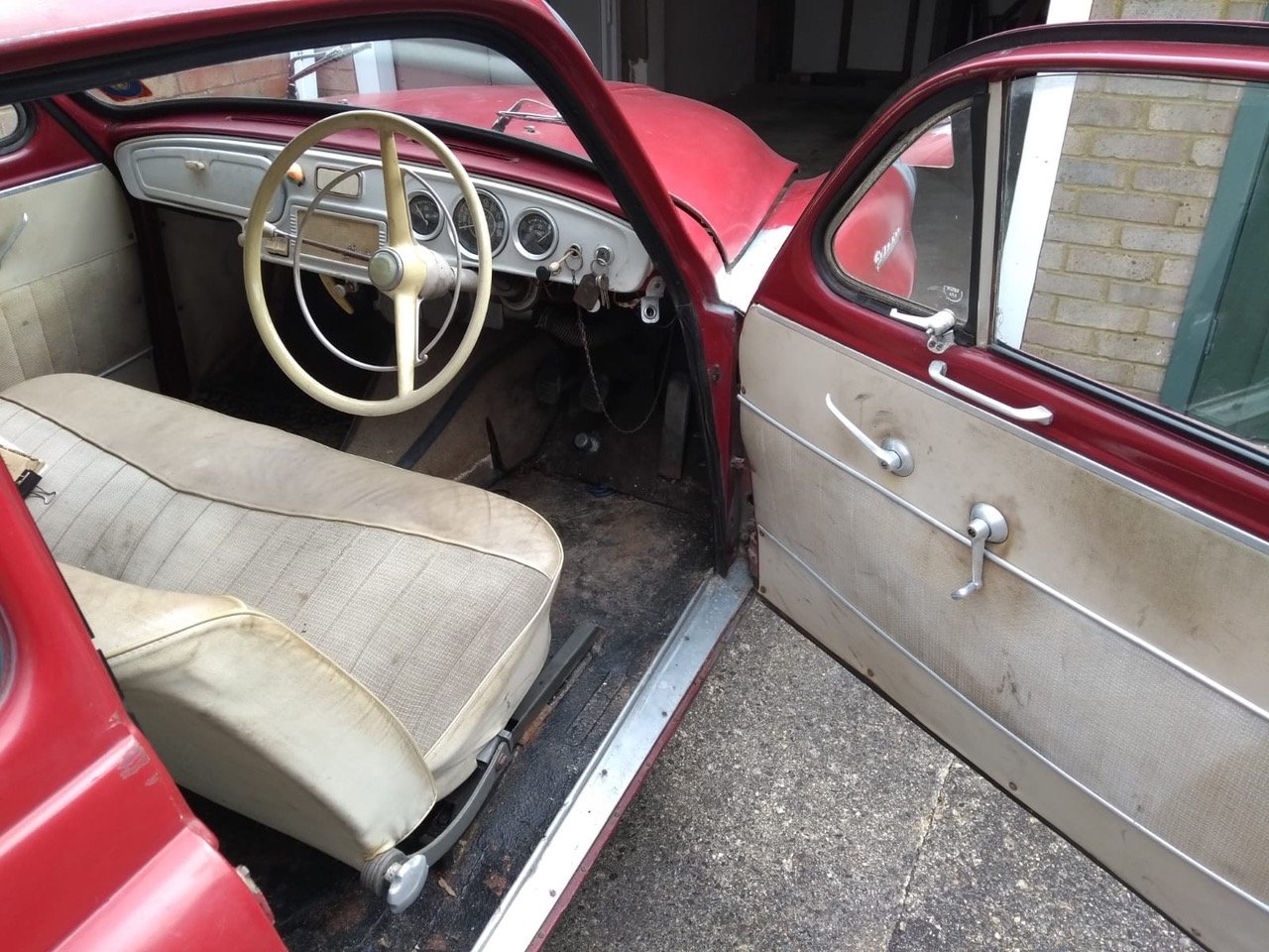

Ladies and Gents,
Owing to a drastic increase in the rental charge for my lock-up, and an inability to find another one nearby at an acceptable rental I'm having to consider moving my Skoda Octavia on. I should very much like it to go to a fellow enthusiast, who would appreciate its quirkiness and its odd-ball character. In addition I have a strong aversion to disposing of cars such as these via E-Bay, so that will be a last resort. Although the car has to go, the lock-up rental increase is not for a couple of months, so I do have some breathing space.
Should any readers of this Forum be interested in the car I'm happy to supply more information on request. Contact me on email at: *****@*****.tld or call me on (removed) if you have any questions. The car is in Southgate, North London and would need trailering away. Sensible offers accepted!
