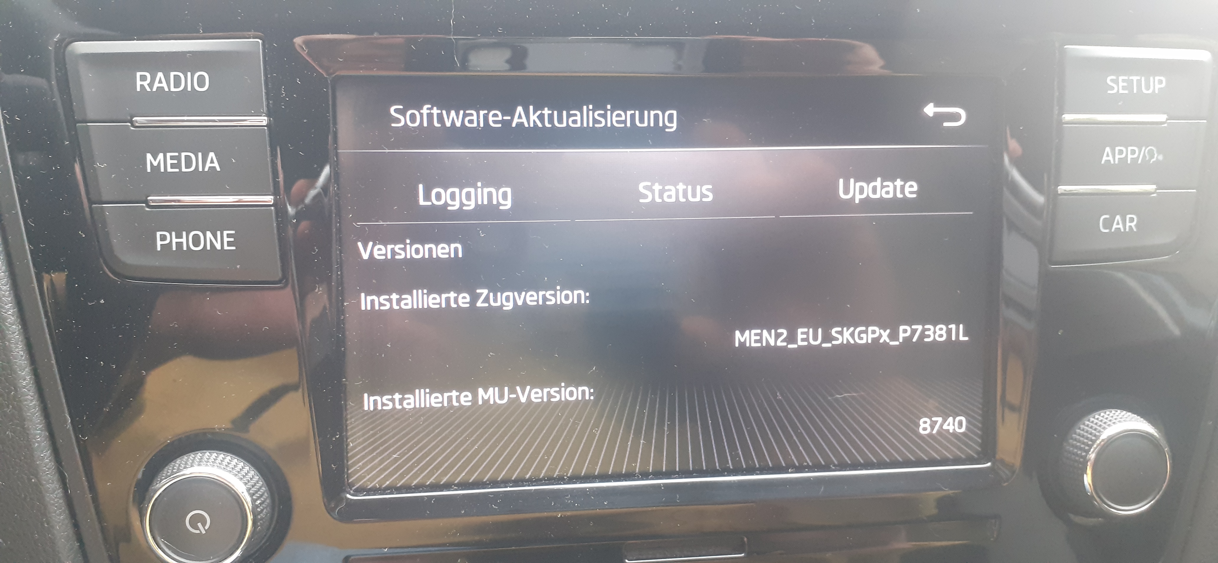

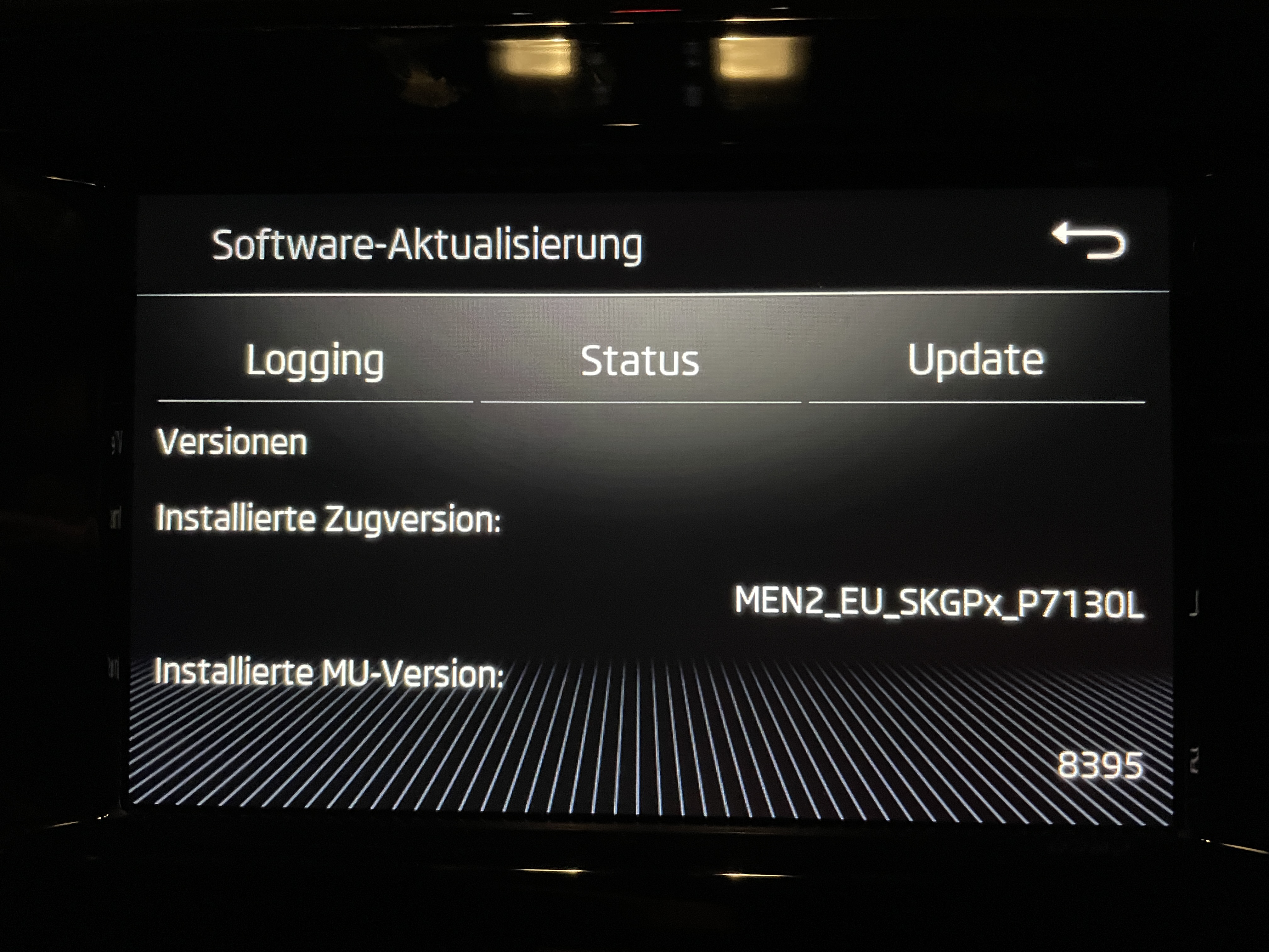

Do you also have an update for my Swing on Fabia III?
MEN2_EU_SKGPx_P7381L
8740
Thanks !

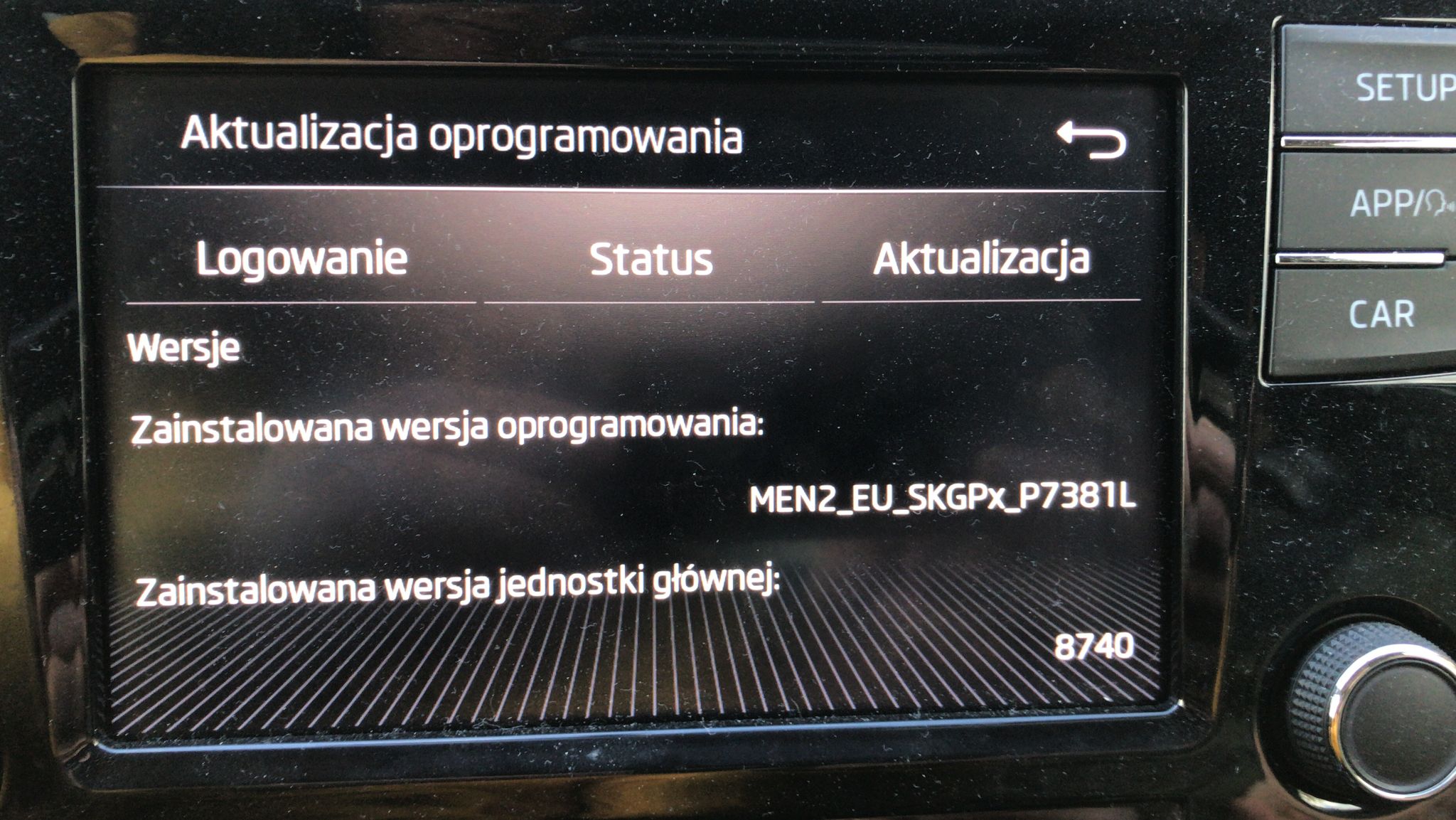

Good morning, can I get new software for this Swing radio model for Skoda Rapid 2019 year ? According to Vin on the website www.skoda.com there is no access to a newer version of the radio !?
men2_eu_skgpx p7381l
version 8740

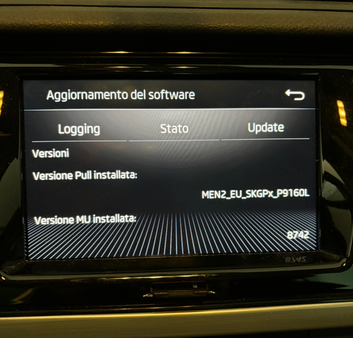

@varooom

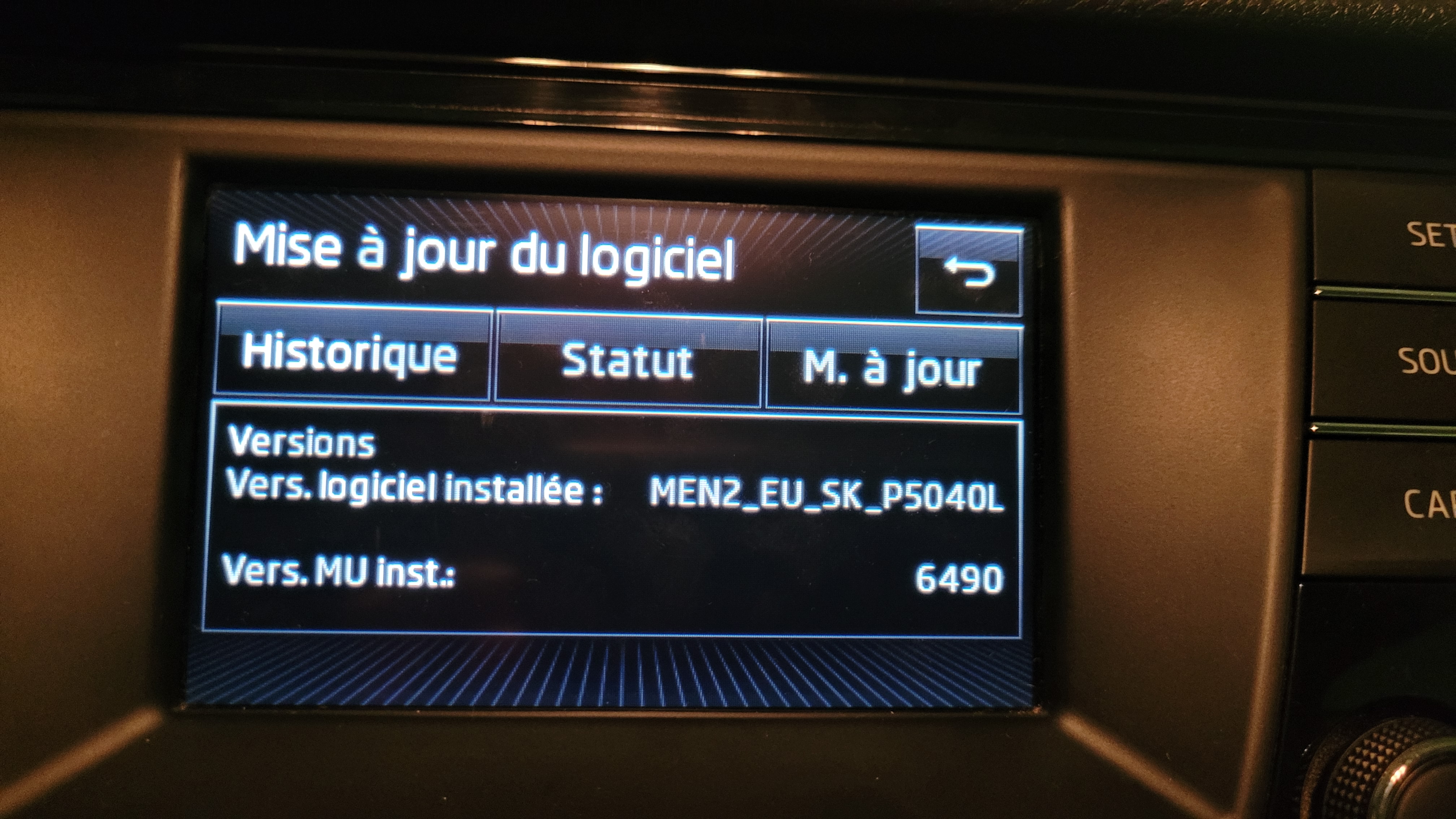

Can you help me please having the update for my unit :
MENZ_EU_SKGPx_P9160L
874Z
Thanks in advance.

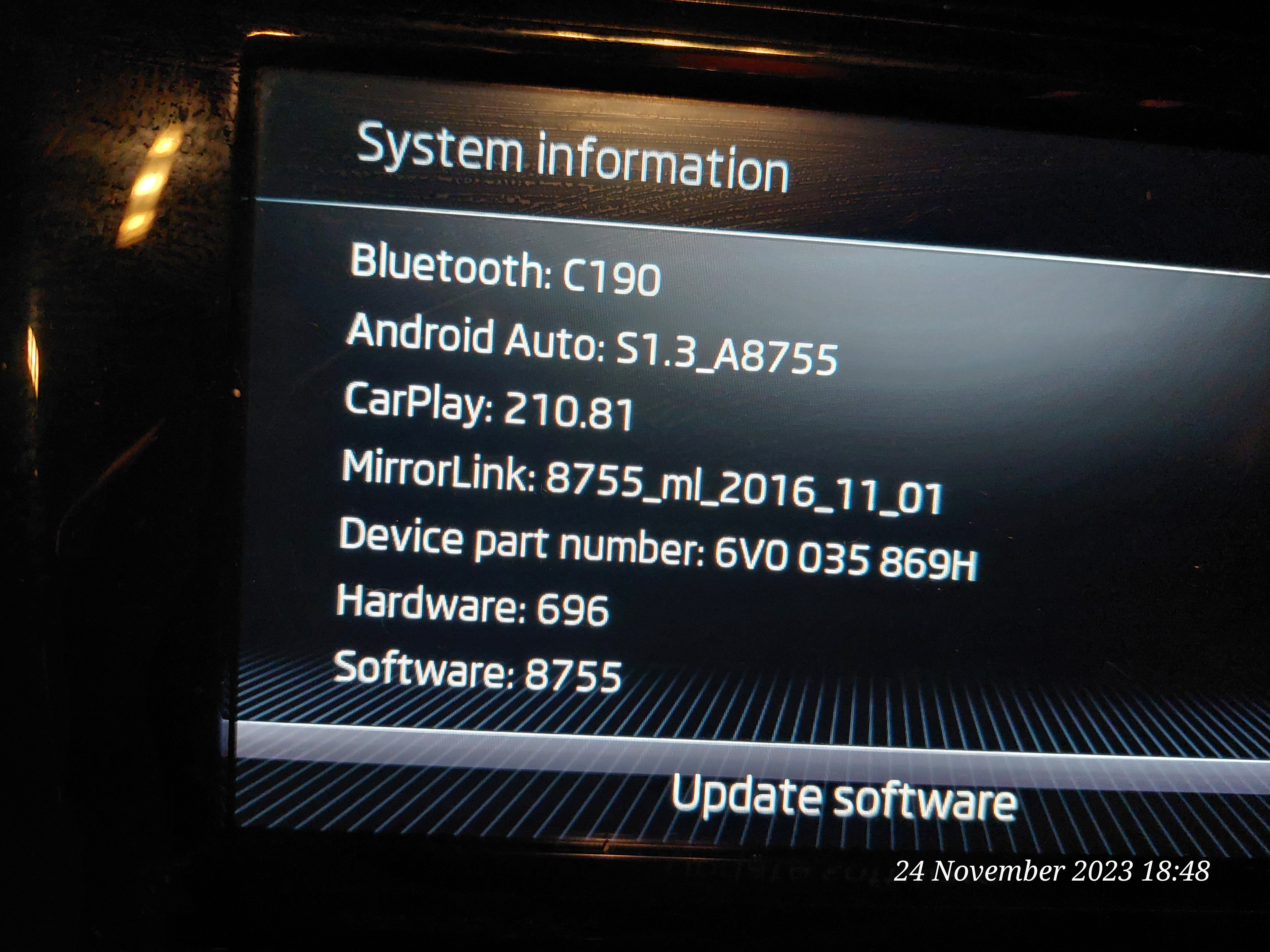

Hi All,
I upgraded Swing software to 8755 yesterday on my 2019 Fabia.
After restart, I could still use Carplay yesterday. But today, there is no more CarPlay available, only Android Auto and Mirror Link are available.
Does anyone know what the problem is? Any solution? Thank you

18 minutes ago, Tione99 said:
Did you install the software yourself or did you go to a Škoda centre ??
By myself. But I just found out that the CarPlay is back after resetting the Smartlink setting
