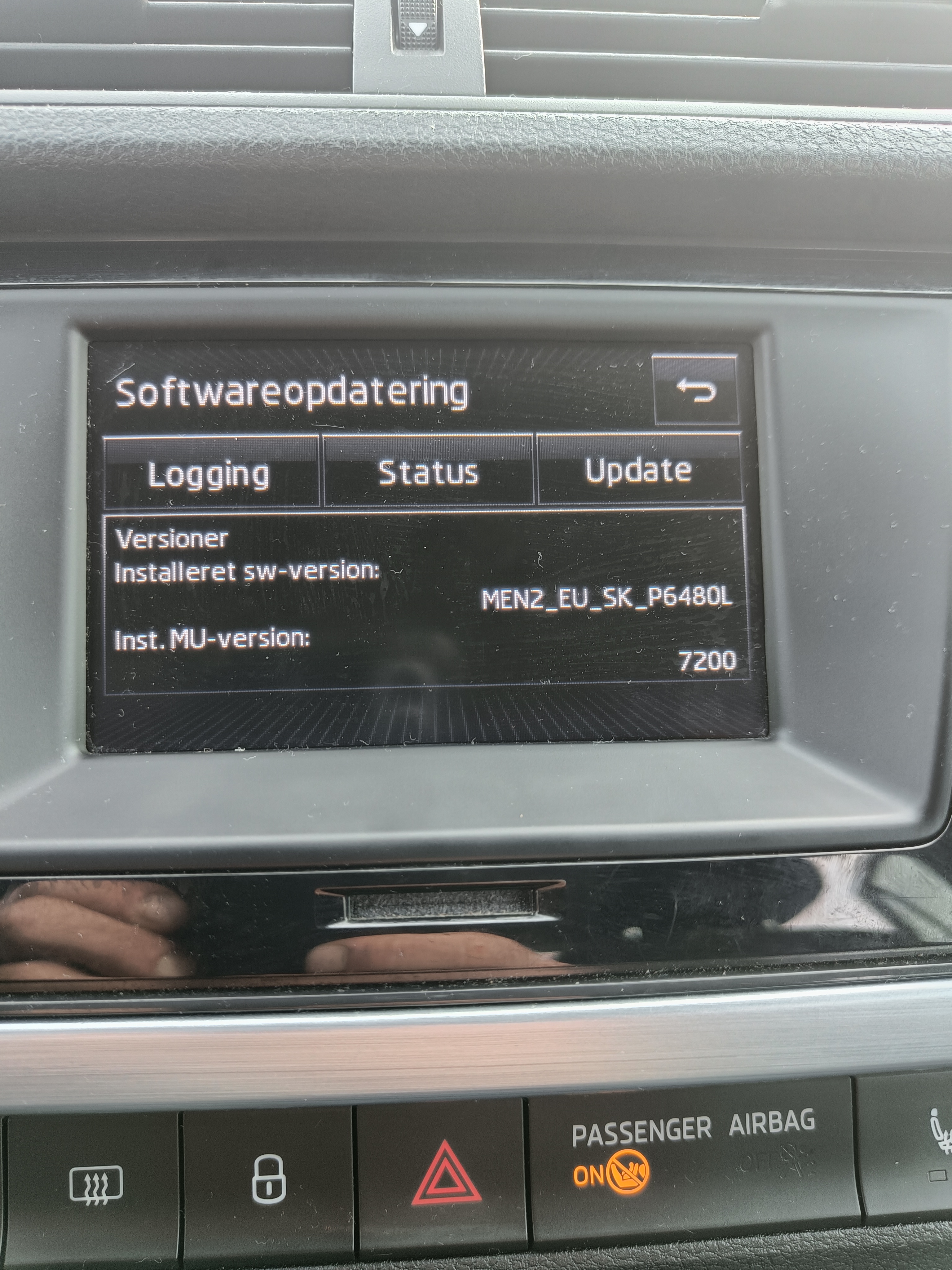

Hey can you help with my infotainment?IMG20230428170700.thumb.jpg.070c01920fc5904d773aad38888cba1d.jpg
Sorry cannot find an update for that Software Train.

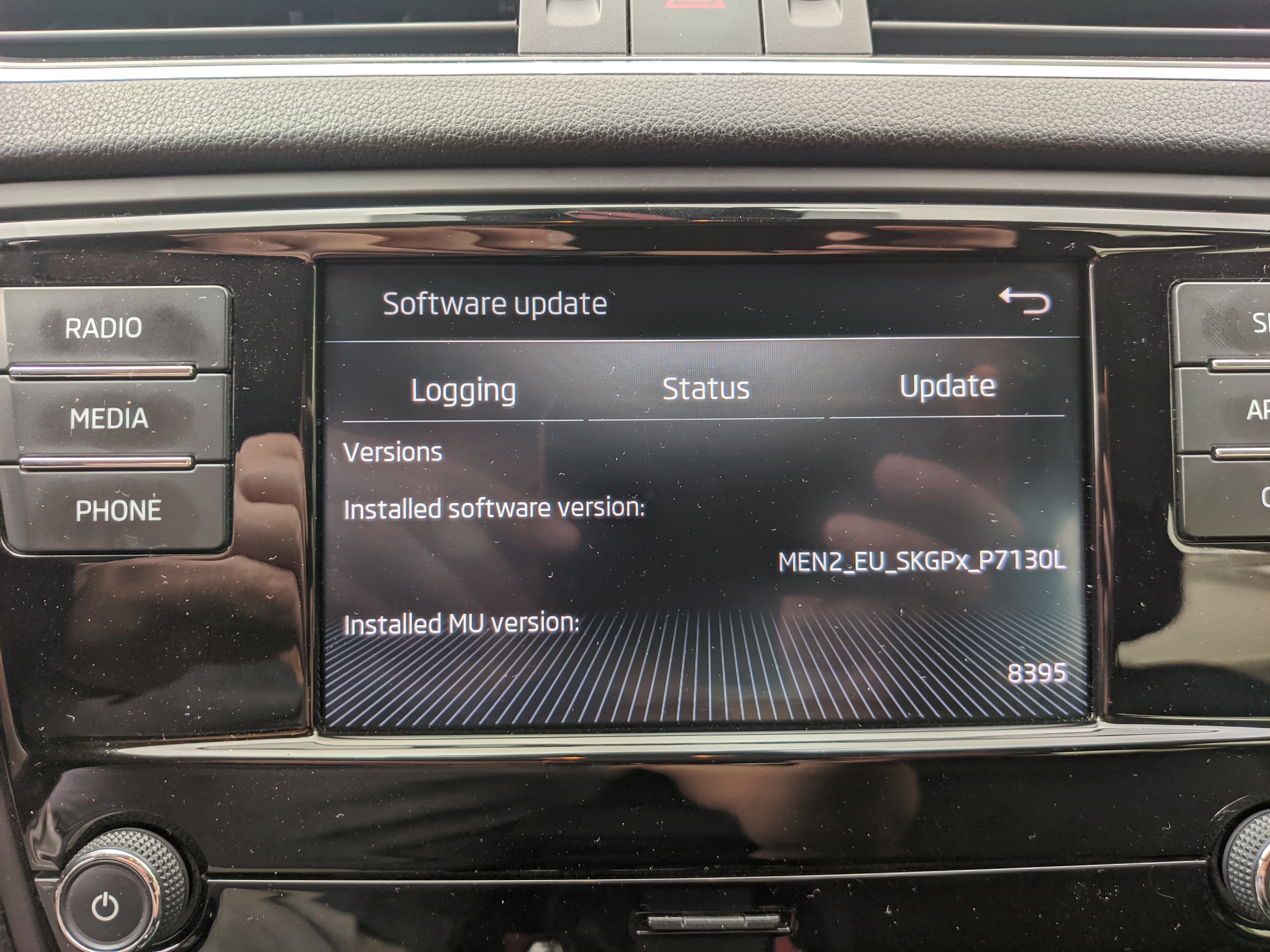

Hi,
Following item can be updated?
SWING OCTAVIA
5F
5E0035871D
8395
9 minutes ago, yakov said:
Hi,
SWING OCTAVIA
5F
5E0035871D
8395
You need to find a Software Train from your car.
Hold down the Menu/Setup button for about 10 seconds to enter the engineering menu, then post back details or a picture.
details:
21 minutes ago, yakov said:
details:
Ok, I can now send you 8755 version

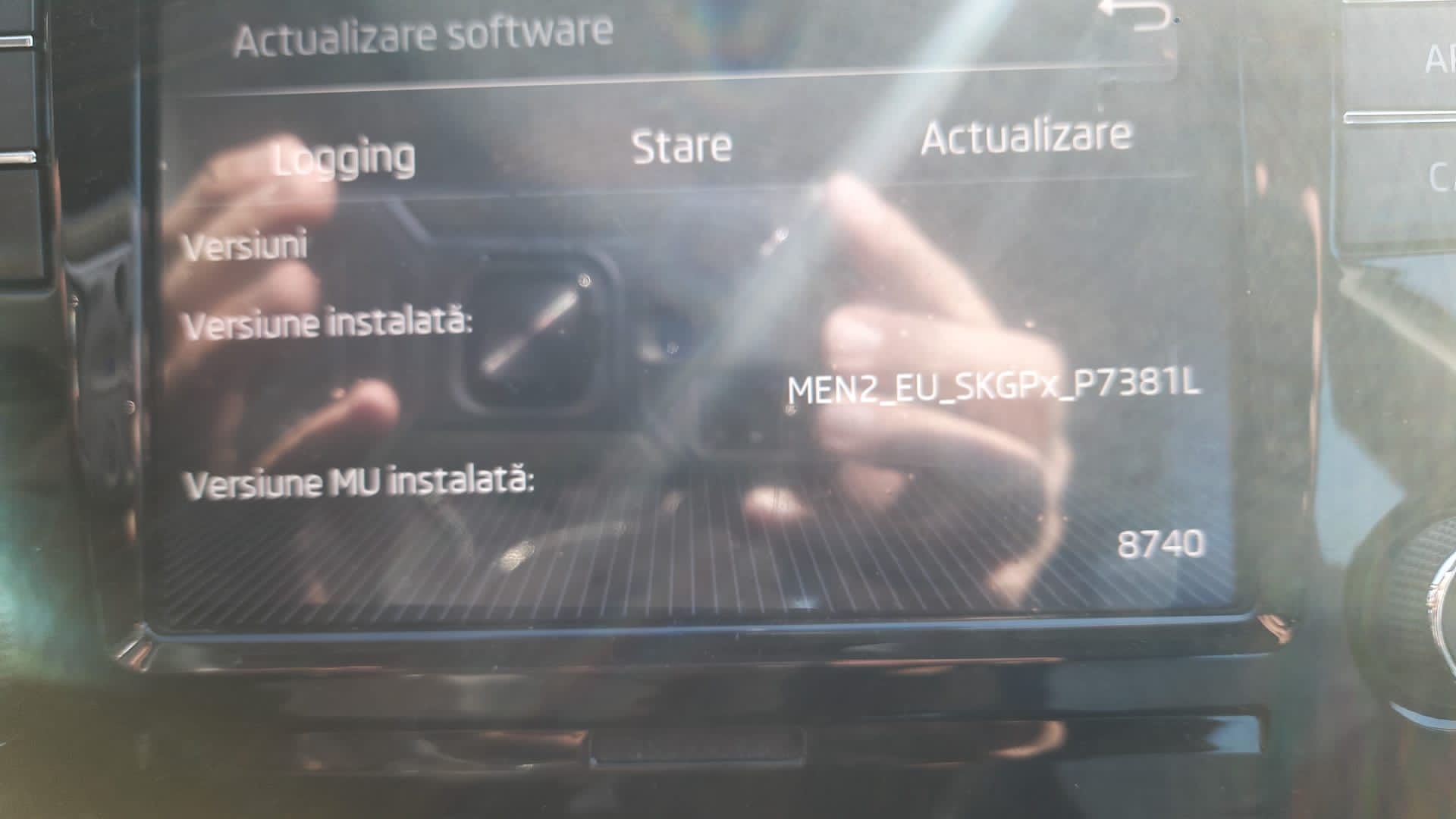

Hello, please can someone help me to send the last update for my infotainment system?
The Software update information you wanted is:
Installed software version: MEN2_EU_SKGPx_P7381L
Installed MU version: 8740
Hardware: 690
Thanks a lot!
Hardware: 690
Thanks a lot!
Yes you will have PM for 8755 version

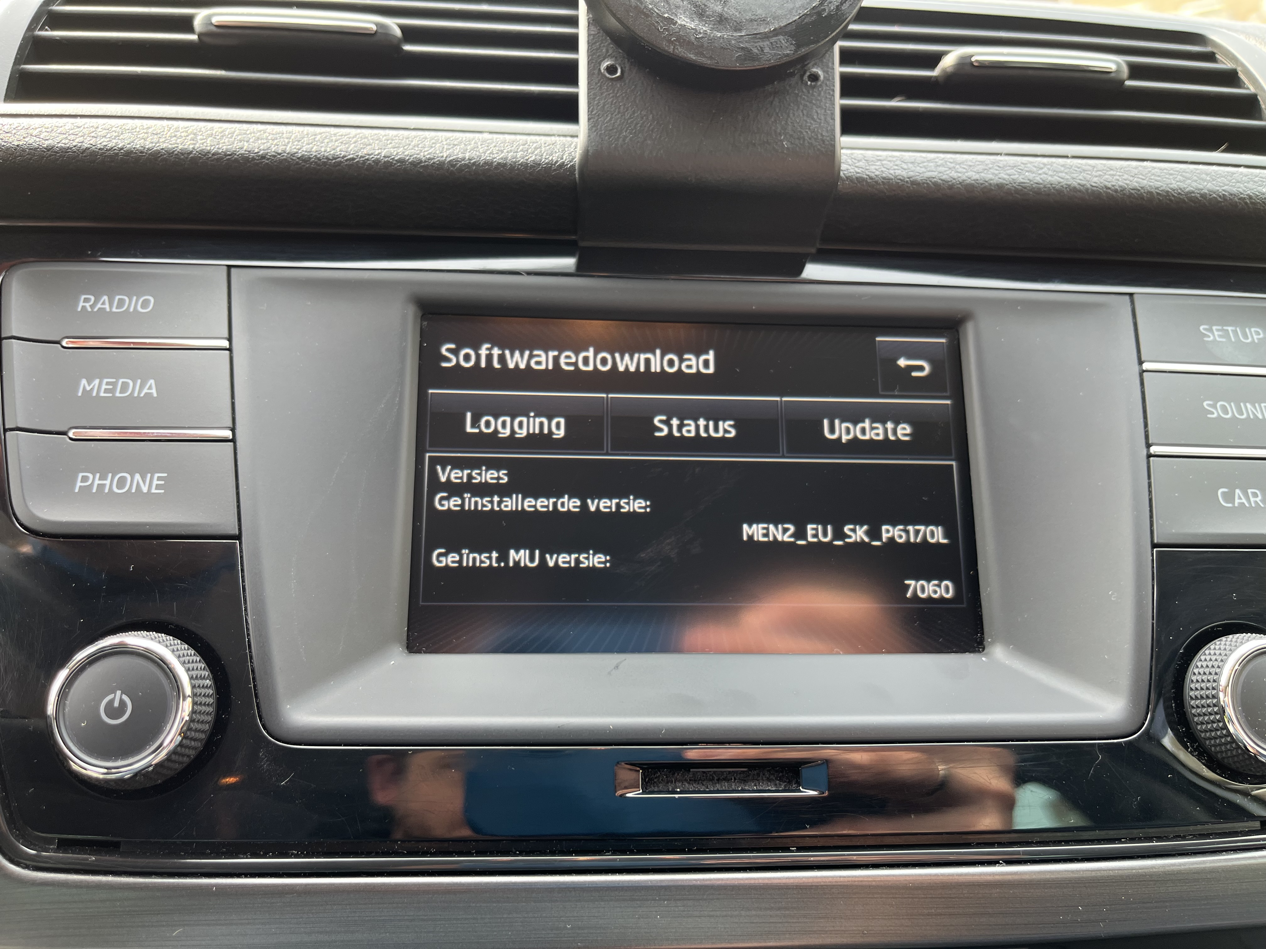

Hi, do you know if there is a software update for my swing head unit?
Not seen any update for that SW Train value.
Ah ok, thank you for checking anyway 😊
