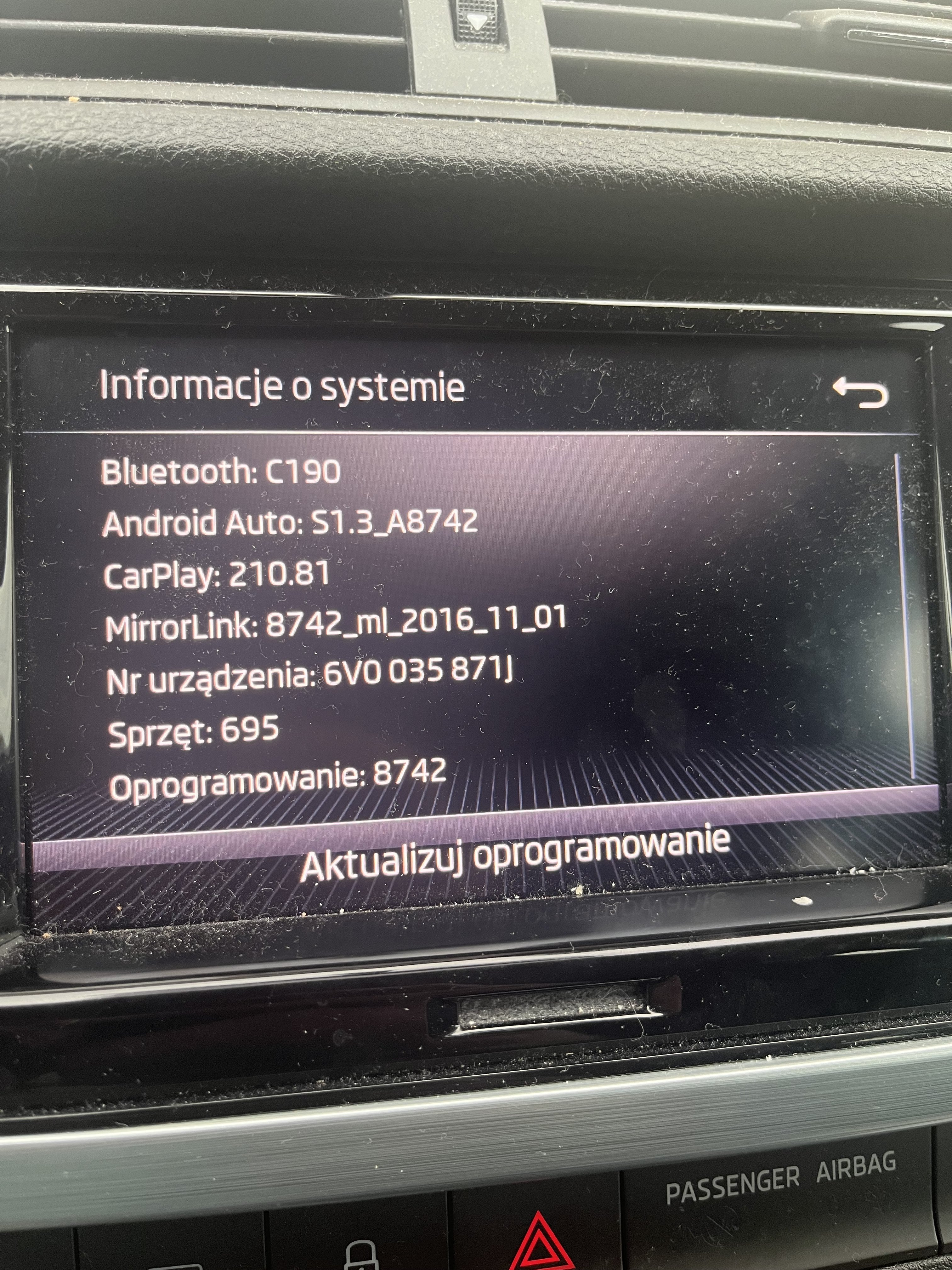

Hi, i have problem with sound in apple carplay. Is any new SW firmware for this version Skoda Swing ?
Yes you need 8755 version to cure to noise.  I will send link by PM.

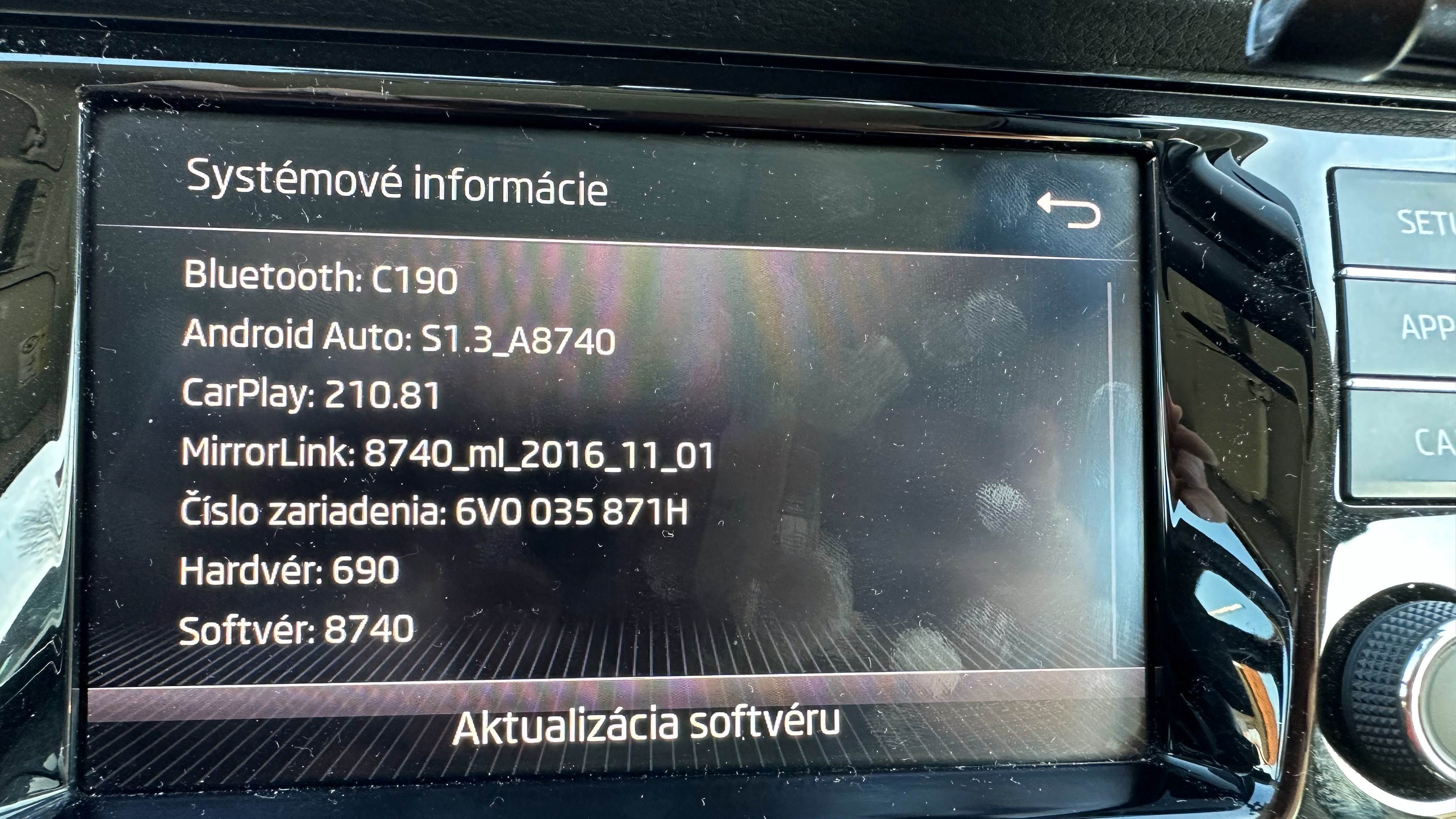

Hello dear colleagues,
could you send me the link to radio software update as well. Currently carplay is not working at all…
car doesn’t see my iphone (ios 16.5 onboard).
thanks in advance
thanks in advance
You can update to 8755 version, but won't know if it fixes error.
Hopefully it will.

@varooom thanks again for the update. Unfortunely it didn’t help. Currently carplay in my fabia 3 is dead. I will try to get in contact with apple. As I wrote before, with VW Touran (also usb connection) carplay works just fine…

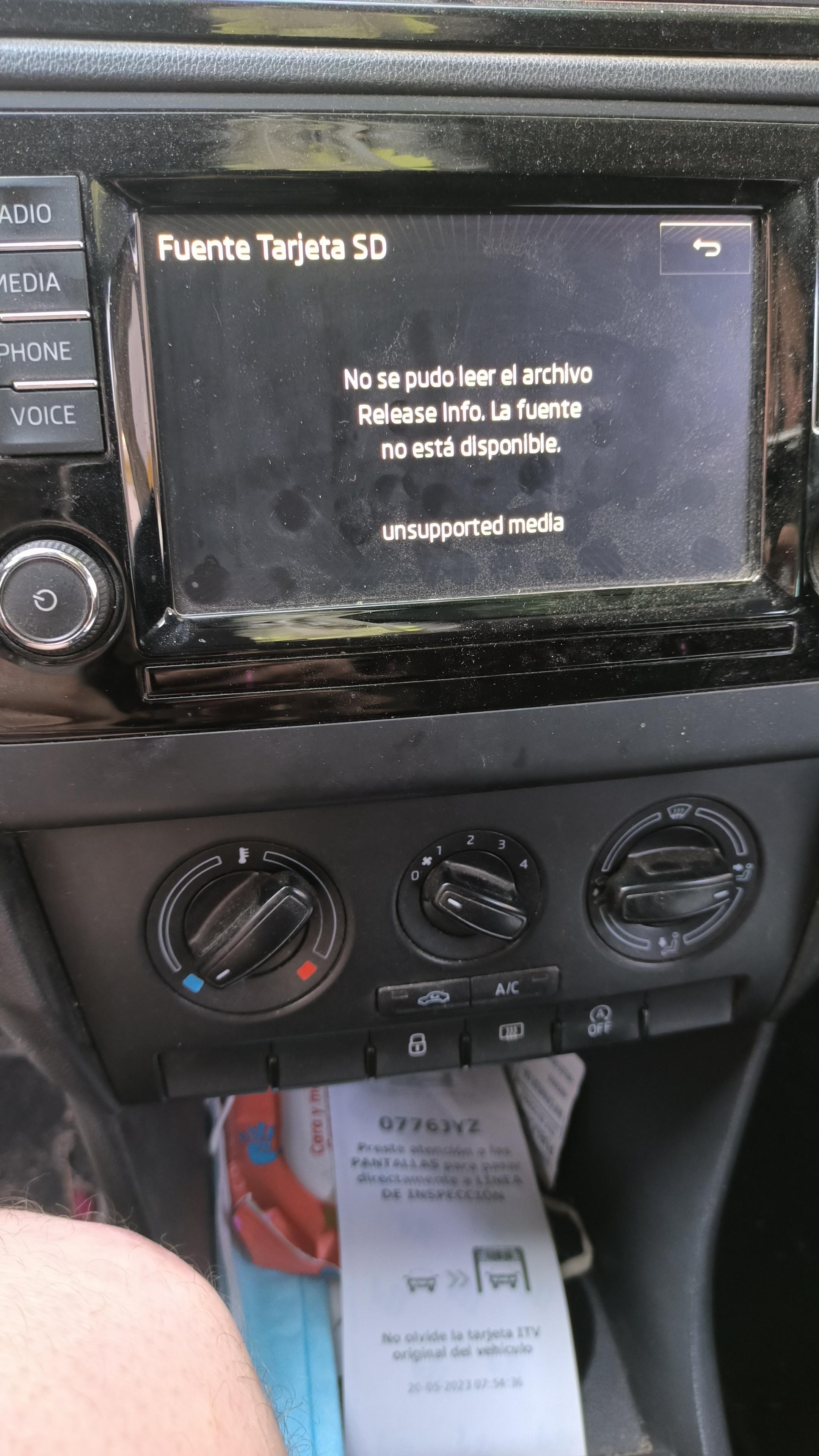

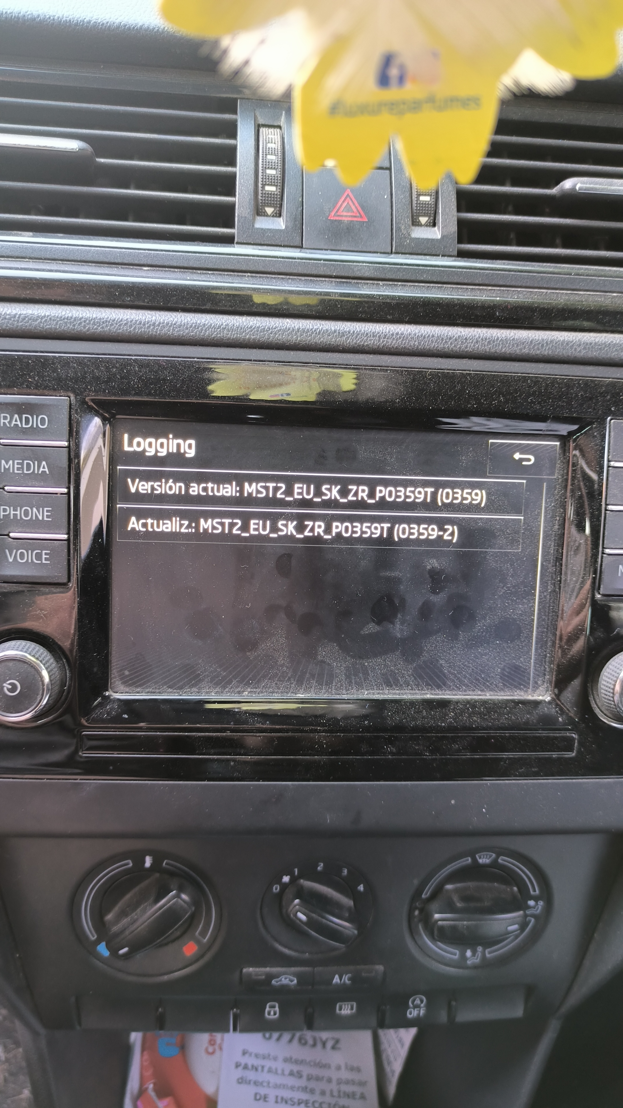

Buenas varooom me pasaste una actualizacion pero me pone esto
Creo que me pasaste la 0369 y es la 0359 no se si eso tiene algo que ver te paso la foto
Make sure that you are in this screen to make update
https://www.briskoda.net/forums/uploads/monthly_2023_05/IMG_20230518_083443.jpg.5596e6da12657643849150b80daec816.jpg
If that fails still, then make sure you have extracted the update to correct path (where M: = SD Card letter)
BAD!
M:\MST2_EU_SK_ZR_P0369T
GOOD!
M:\
Extraigo el archivo en la sd,pero No se como se hace que me dices de la ruta, no se donde se pone ni nada

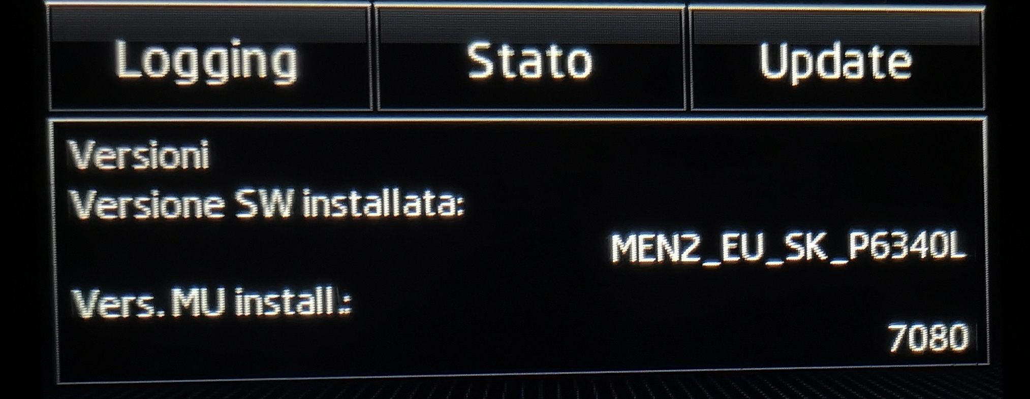

Ciao a tutti è la orima volta che scrivo qui.
Voelvo capire/sapere se esistono aggiornamenti per il sistema infotainment Swing (su skoda fabia mk3 del 2017).
Chi mi sa aiutare?
Attualmente c'è installato questo:
Chi mi sa aiutare?
One, no update
Two, write in English on forum
