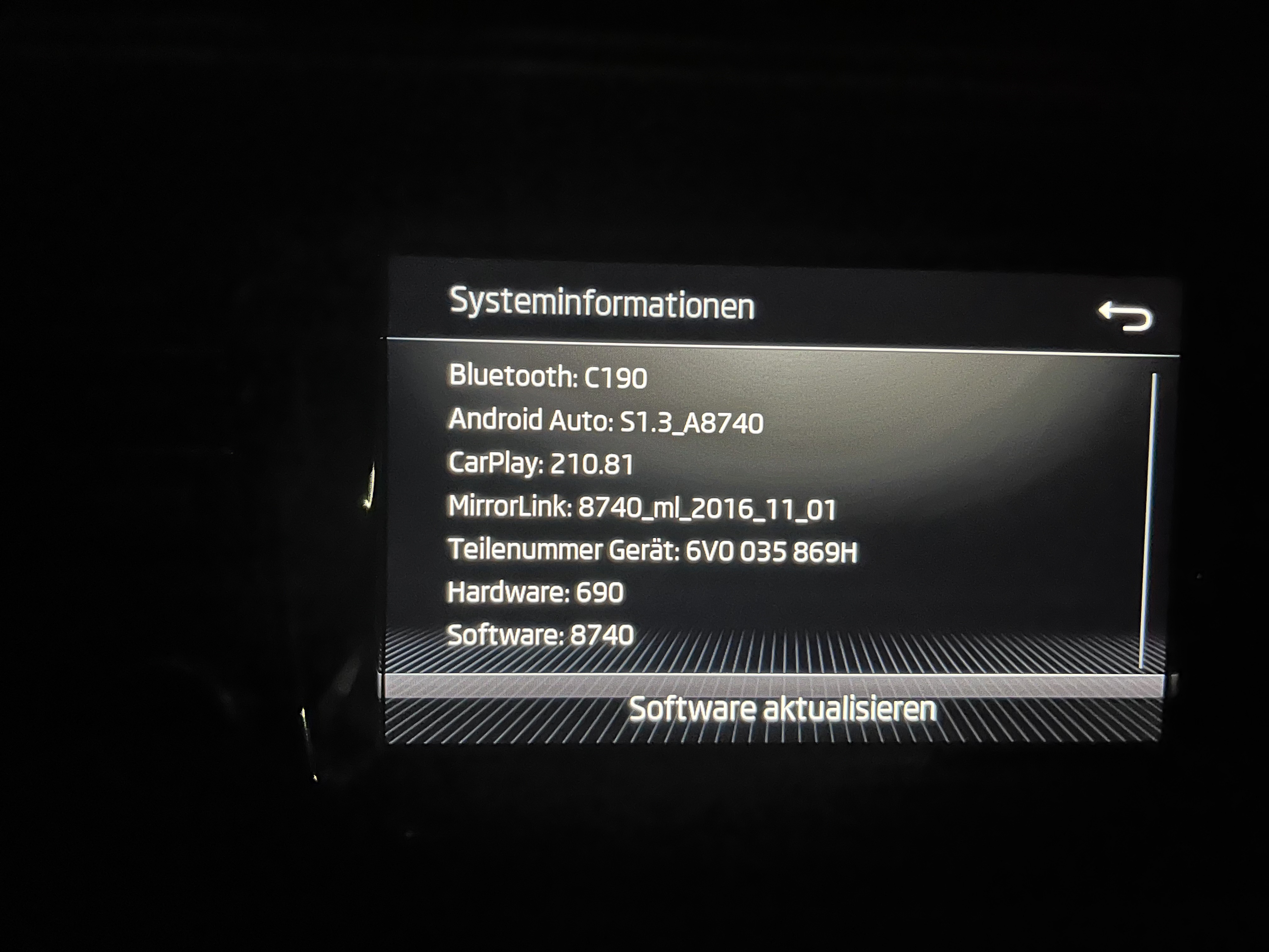

Hey @varooom , thanks for all your help with this! Really helpful thread.
I’m having the same issue with my Fabia. Picture attached of the service screen. Would you be able to help with the update?
Thank you!
Thank you!
I will send you a link now for update
Thank you so much! It worked a treat! Im so pleased. Thanks for your good deed!

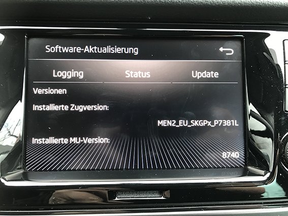

Foto anexada da tela do serviço. Você poderia ajudar com a atualização?
TRANSLATION:-
Attached photo of the service screen. Could you help with the update?

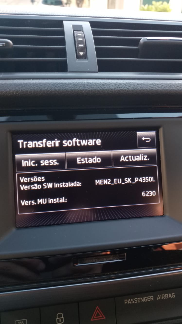

There is a new update for this unit? Skoda says there is no update. Thanks.
I have sent PM with version 8755 link
I am really appreciate, thanks a lot!

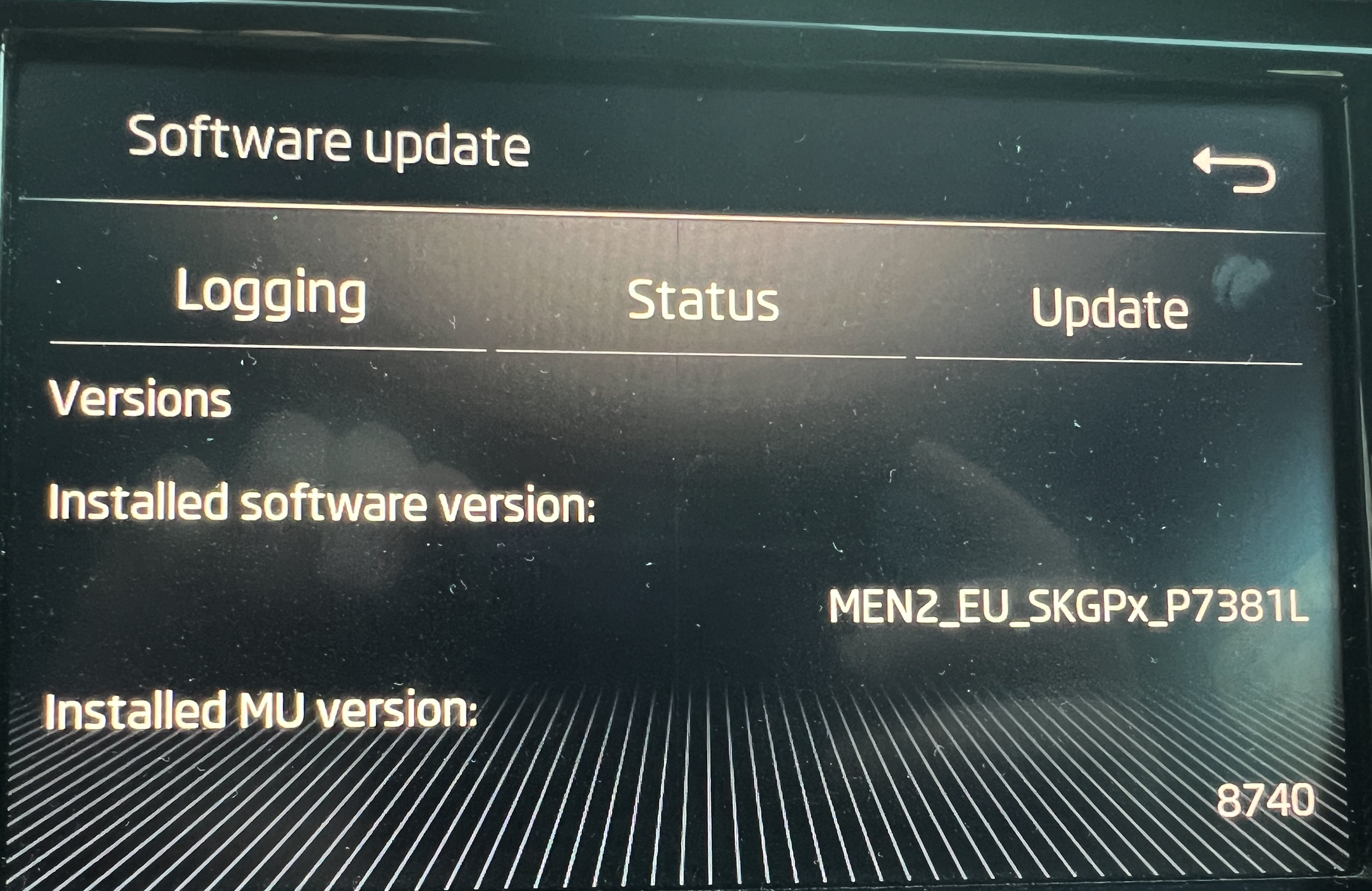

Hey @varooom, thank you for providing us with the latest update for our poor swing media units :)!

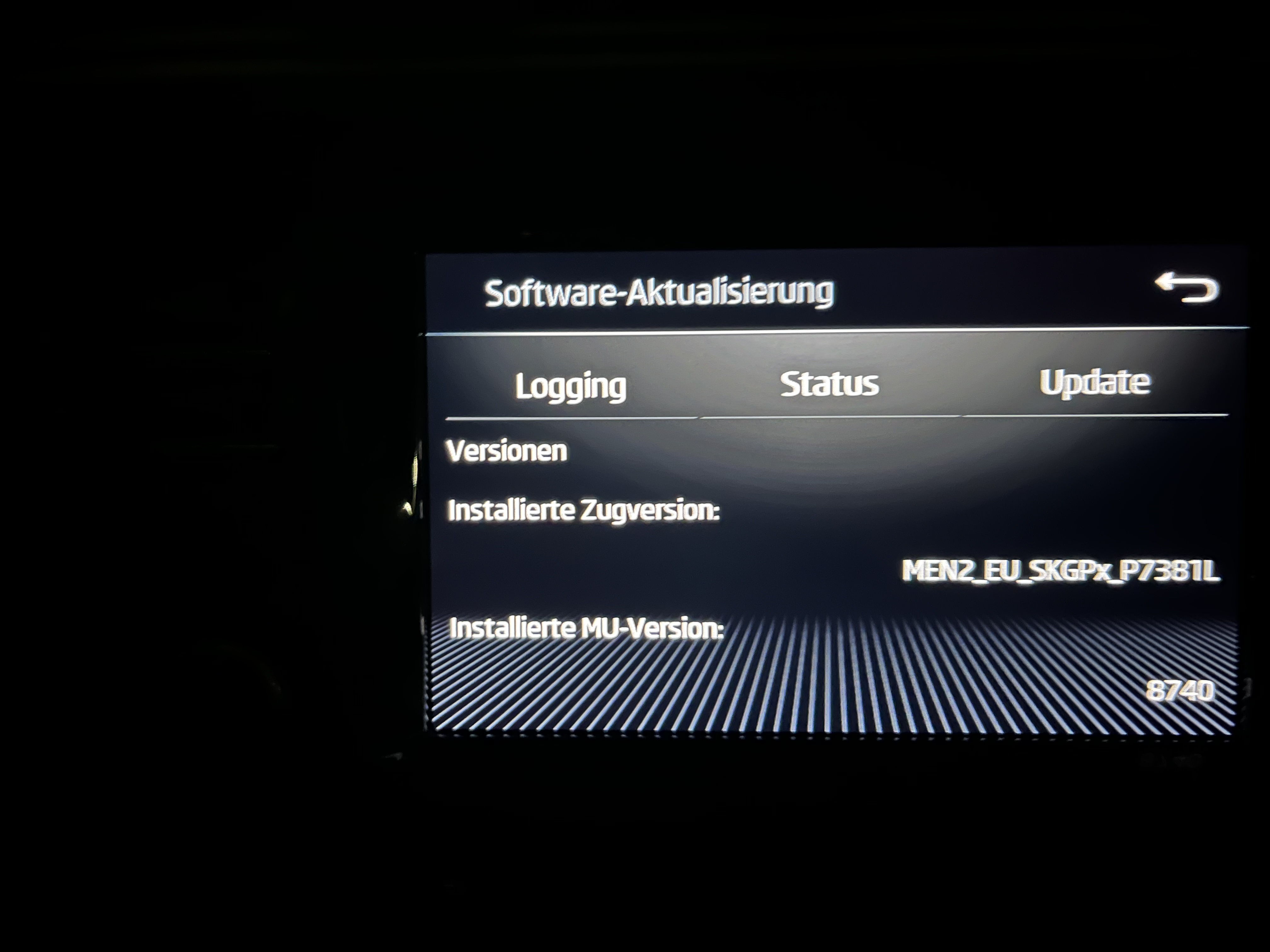

Would you be able to provide me with the update?
Attached is the required info.
PM Sent

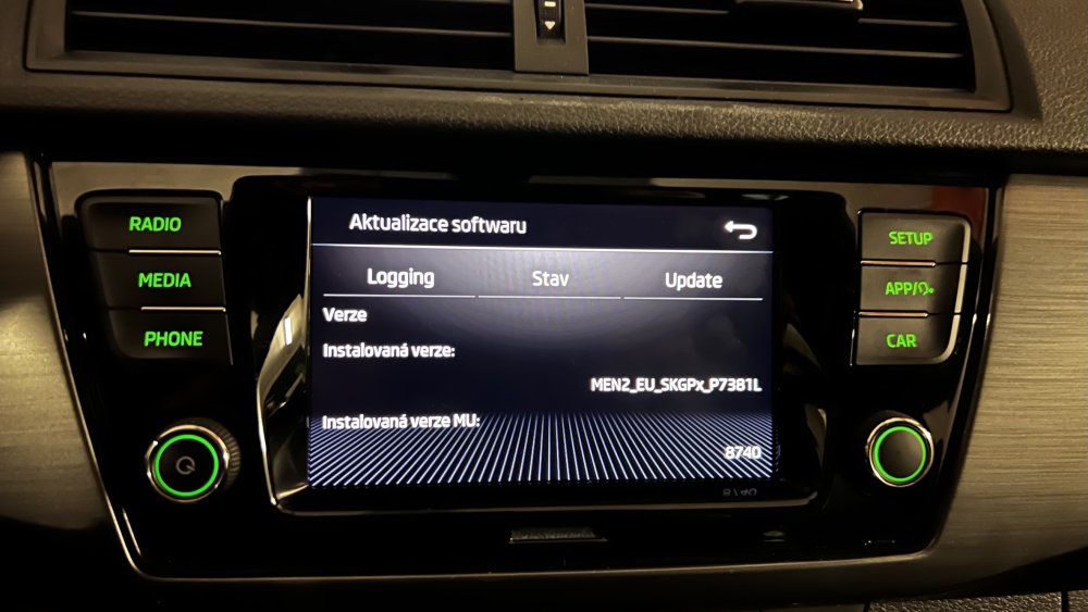

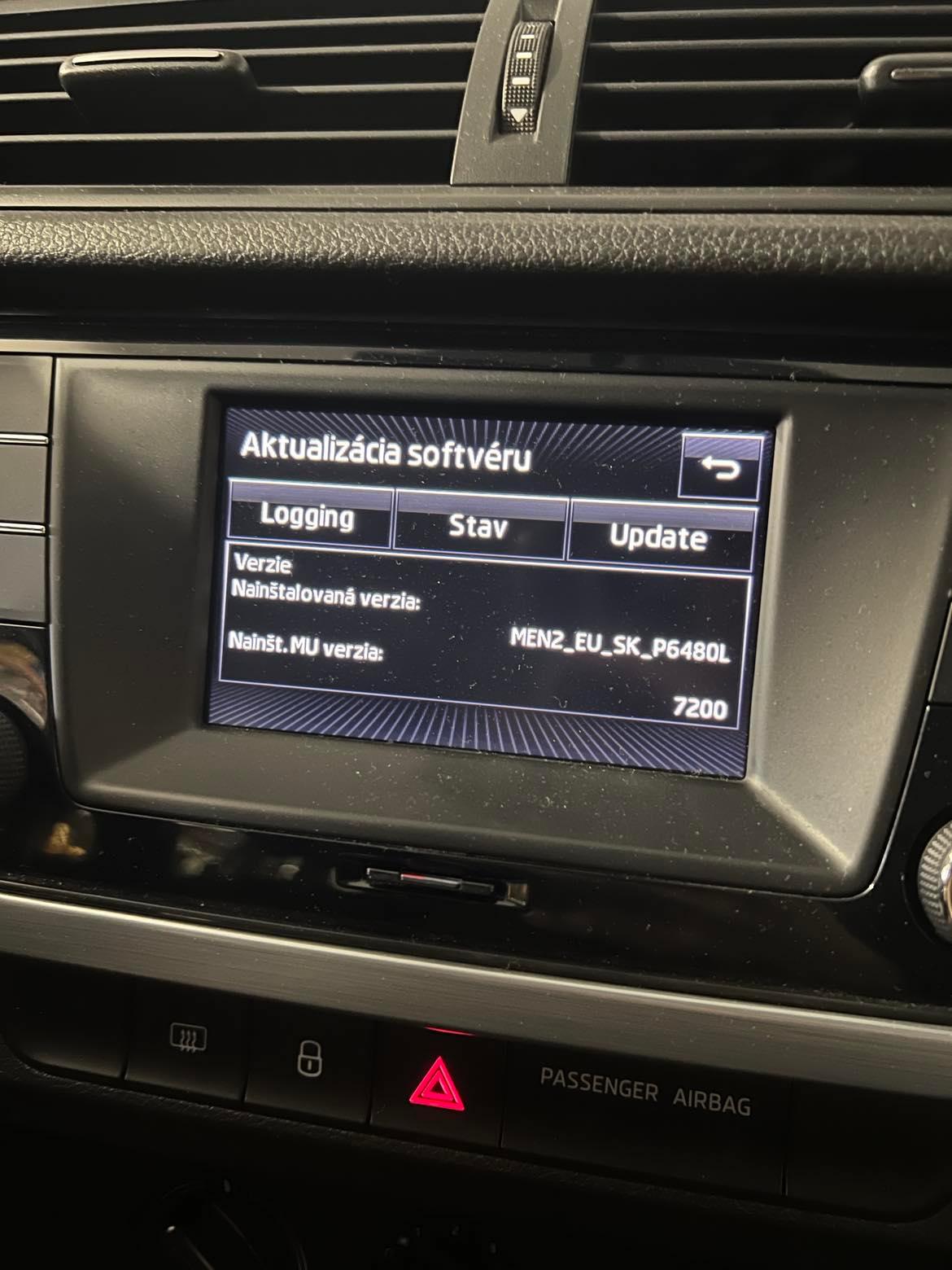

Hi! Is there an update for MEN2_EU_SK_P5040L?
Thans a lot for providing us with these files!
Sadly I do not believe there is a file for your Software Train.
MEN2_EU_SK_Pxxxxx = No
MEN2_EU_SKGPx_Pxxxxx = Yes
Thank you, anyway!

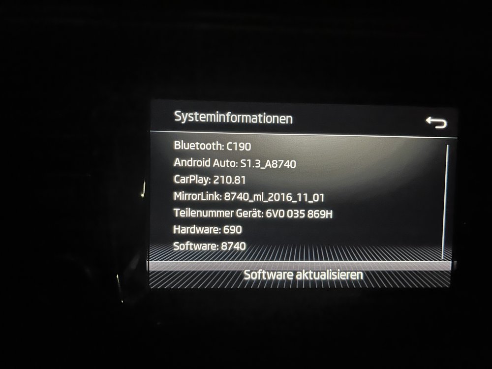

Hello @varooom,
After a long search for a solution to the well-known Swing problems with static/crackling audio issues, I came across this and am happy that someone is helping the poor souls where the car dealer does not want to.
Could you please also supply me with the update 8755 and a how-to? Here is my Fabia's info:
Does this effect anything if there is still a warranty? Thank you!!
Just now, PCvrstf said:
Hello @varooom,
I can send you a link and some simple instructions.
If the car is in warranty, you should complain and they should do the update for you, if you choose to do it yourself then I highly doubt this would break anything.
You will probably have a small 'fault' in the diagnostic scan, as the car needs an online connection for the mothership to register the update and feedback to the car a new checksum confirmation.
This doesn't stop the radio, it's just a stored fault, and you can clear with VCDS.

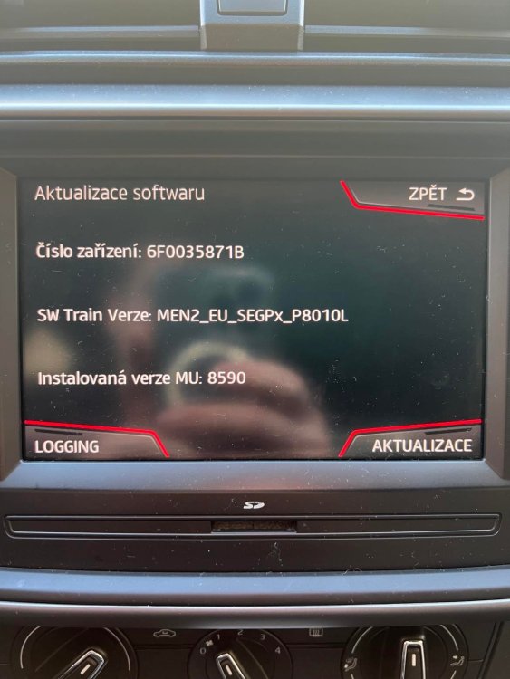

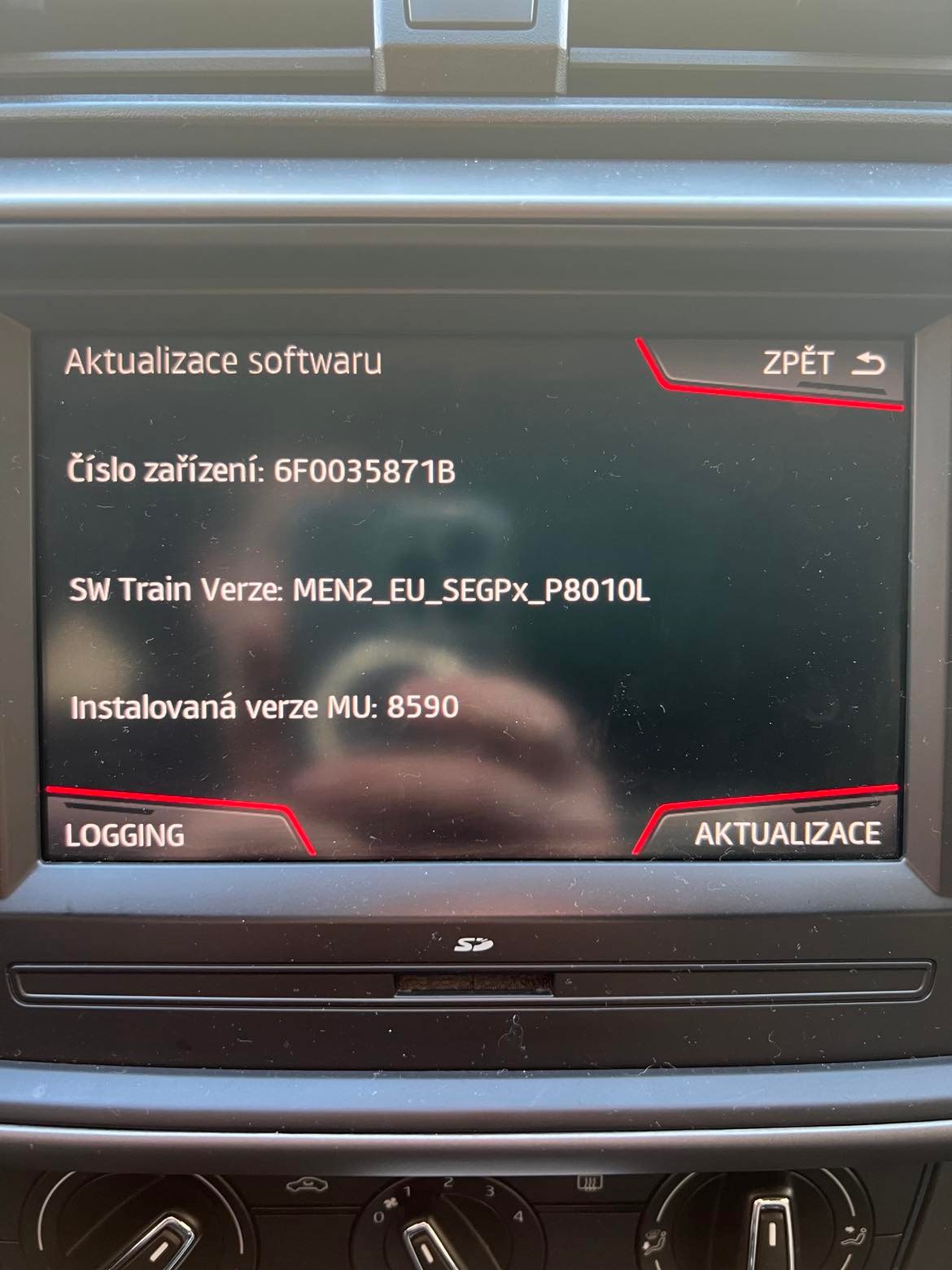

Hello,
I have two cars (Skoda, Seat) and both has swing radio. Could you please send me link, where I can update the system? As I'm correct just GPx version is possible to update, right?
Thank you so much and wishing you a happy holidays . Thx

I don't have any updates for either radios.
@pab567 Can you check your collection for the above 2x SW Trains?

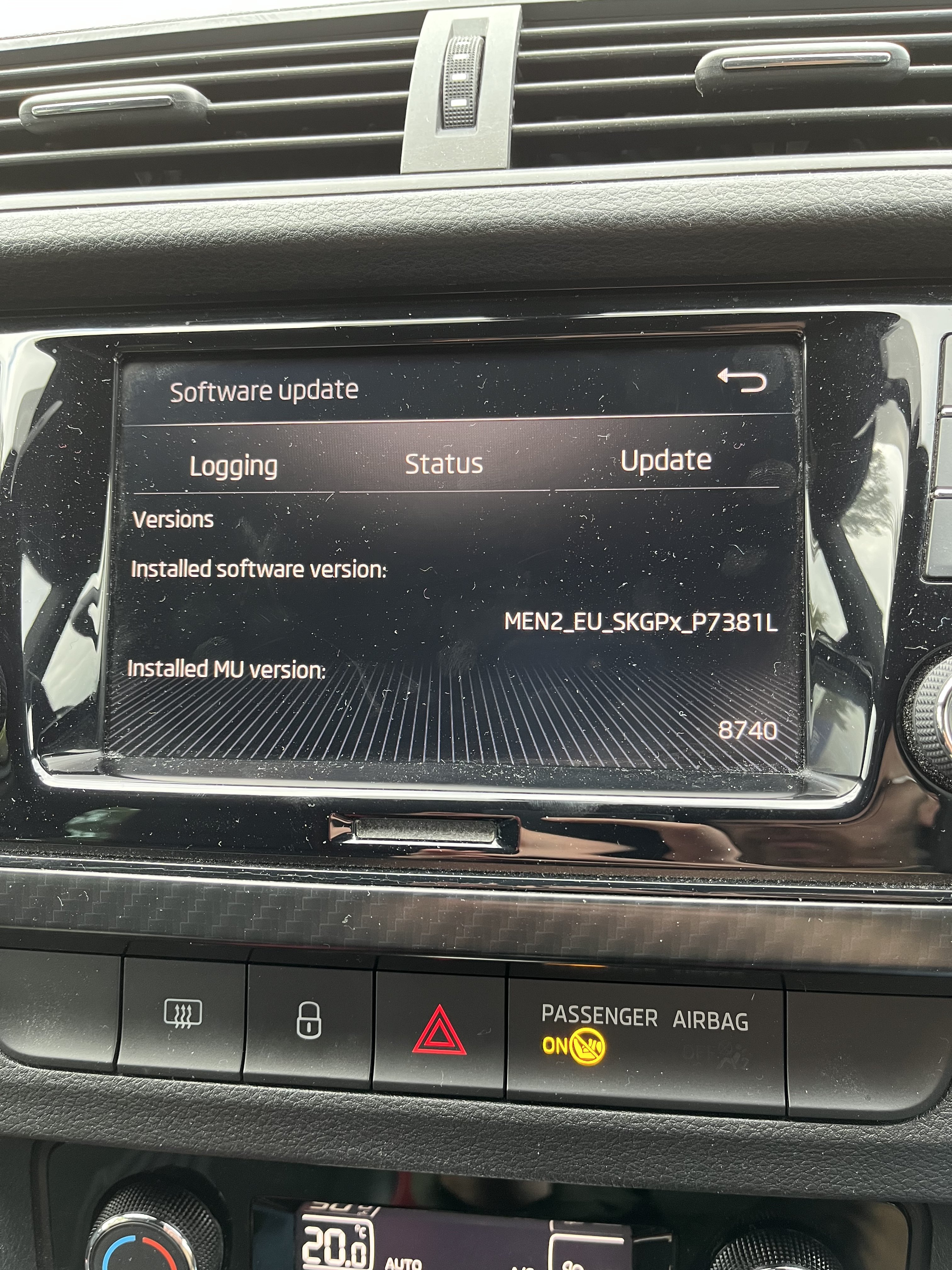

Hi,
@varooom can you send me the link to download the update to this swing radio? Thank you very much!
