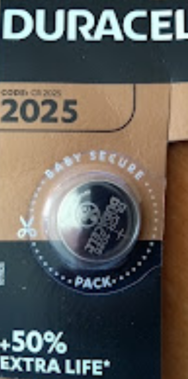

  • So I just changed my 1YO Duracell and its still reading 3.02V on a multimeter but like a good person I am changing it.  One thing I did notice is that the Duracells have an anti-child casing but
