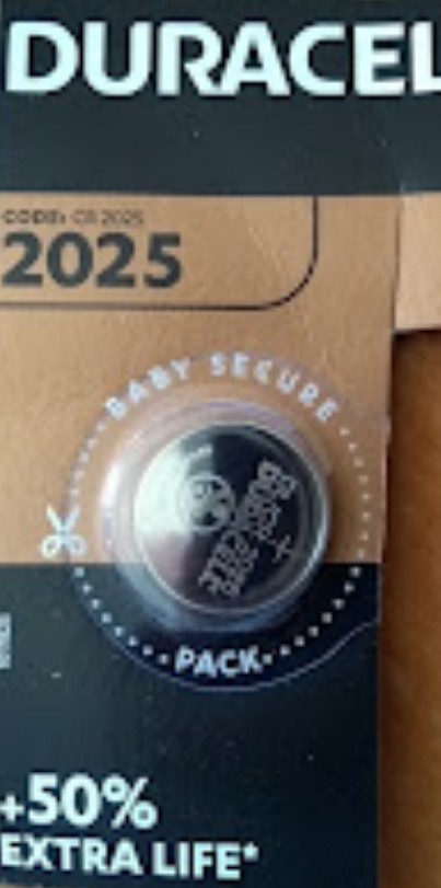

So I just changed my 1YO Duracell and its still reading 3.02V on a multimeter but like a good person I am changing it.
One thing I did notice is that the Duracells have an anti-child casing but also an anti-die if you swallow sticky label on the minus side.I removed this last year (obviously) but on the old battery I noticed a small sliver of tape that did not come off when I ripped off the sticker last time round.  It was totally invisible 1 year ago but age,air and dust has made it more noticable.  It goes virtually half way around the rim  of the minus side as you can see.   I wonder if some folk are leaving this bit of tape attached and, if you pop the battery in and this bit of tape happens to be where the contacts are - it may stop it working properly (or at all).
One to watch out for 🙂
I have half peeled it off the old Duracell CR2025 battery so you can see what I mean:
