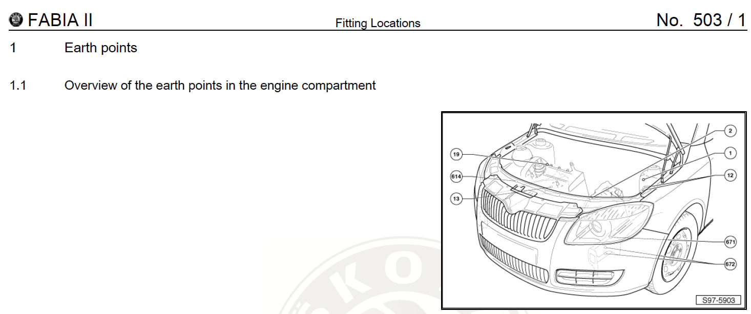

At a basic guess you might be able to check all the earthing points, starting with the most basic.
A break in a fuse that "closes" when cooler, so worth checking those out in the engine bay where it's toasty.
Not a mechanic, but these are some of the nice free/cheap things you can check.
