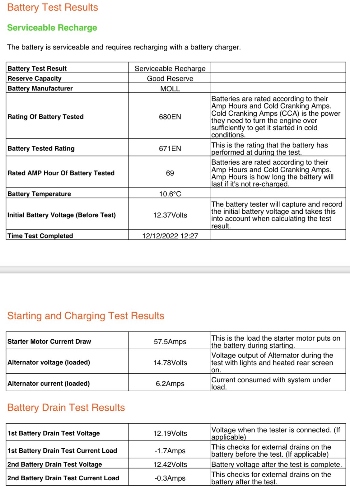

Update
I had the battery tested by the RAC earlier today - results are below. So, there is nowt wrong with the battery. In fact he was quite surprised that a 7 year old 680en battery was showing a test rating of 671 and it was holding its charge OK.
However, it was only showing a 47% charge, which he supposed was caused by very short local journeys, which I confirmed to be correct so he told me to shove it on the C-Tek overnight and take it for a decent run tomorrow using as little load as possible and then put it back on the charger for 24 hours.
Finally - and this was interesting - he said when it does fail, he confirmed that firstly, the replacement battery would be adapted to the car and secondly, they would replace the current EFB with an AGM unit, primarily so the RAC can be assured it should outlast their 5 Year battery warranty, as they still experience early failures of OE EFB units.

2 hours ago, numskull said:
Update
With those results you might want to think about keeping the battery and changing the car! 🤣
If you recharge the battery with a battery charger now and in future when appropriate, rather than trying to make up too larger  battery deficit by just driving as many think, and use the battery charger maintainer when appropriate you could get a lot more life from the battery.
You will need to abuse the battery a lot more and perhaps nearer the end of your membership cover for the year, or future year(s).
Follow the RAC advice and you should be OK battery wise for your upcoming trip.  Good luck and enjoy your trip.

/cdn-cgi/mirage/7ef2a44b785400d29a8fd15a0e4d5fffe2d9913bfac72229cb253167b445d29b/1280/https://www.briskoda.net/forums/uploads/monthly_2022_12/27EBDB28-A4BB-4739-B95F-F03127A5C169.thumb.jpeg.a29d1a866d02d446a9488d34c47f10d5.jpeg
A bit healthier than my 680 EN AGM battery just under 6 years . I’m down to 350 EN.
after a good drive yesterday my resting voltage after the car fully shutting down was 12.66v. But overnight sitting 11 hours it slowly and gradually dropped to 12.45v. Quite low voltage for an AGM.
Edited by Micky 32
