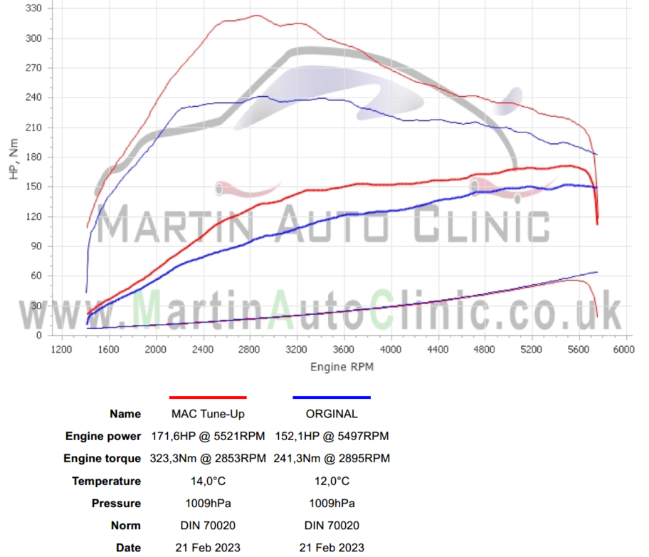

The car initial test had shown to have 152bhp and 241.3Nm torque, after remap we achieved 172bhp and 323Nm, I wanted to go with save numbers so not too overload a gearbox. I also did a DSG remap.
After 40 minutes of driving home I honestly did not see much difference, for example with diesel engines I noticed the difference straight away, with petrol not so much, it does look like the car picks up better from 50-60mph but during normal driving I can't really tell the difference, weird. May be something to do with the engine being petrol or I just don't want to floor it! lol :)
Even picking up kids from school the car behaved as usual, may be gearbox need time to adjust? May be I need to change air filter and plugs? Will give it a few more days and have guts to properly floor it.
I also not sure if my fuel consumption will be affected, with diesel engines the fuel actually got better but with petrol who knows, will see.
I remember that my automatic diesel BMW after remaping stopped changing gears from 3rd to 2nd on some hills as it had enough added torque to pull the car through, with Karoq, the same roads and the same driving experience as it was before remapping.
I trust the guy, he has very modern dyno road and he spent 3.5 hours playing with the car so do not think he just took my money and did nothing.

This is graph I got. It seems like I should feel that additional torque!
That is the first figures achieved with a 1.5 TSI ACT i have seen.
What gear was he using?
Best leave the plugs for now and see that there are no hicups.  ECP or EML coming on.
Ignition Coil removal tool required rather than being hashy / red neck.  Your tuner will have one.
At what RPM does your car change gear during normal driving, @Vlady?
No idea what gear, I thought it should work through all the gears being DSG?
I looked at the rpm this morning and driving normally all the gear changes happen about just under 2000rpm, sometimes, when going over big speed bumps the car drops to 1st gear and changes to 2nd at almost 2750rpm which gives unnecessary revs, noise and speed higher than you require for condition but this was before remap and was annoying me, I was hoping the DSG remap will solve this but it is the same thing now.
