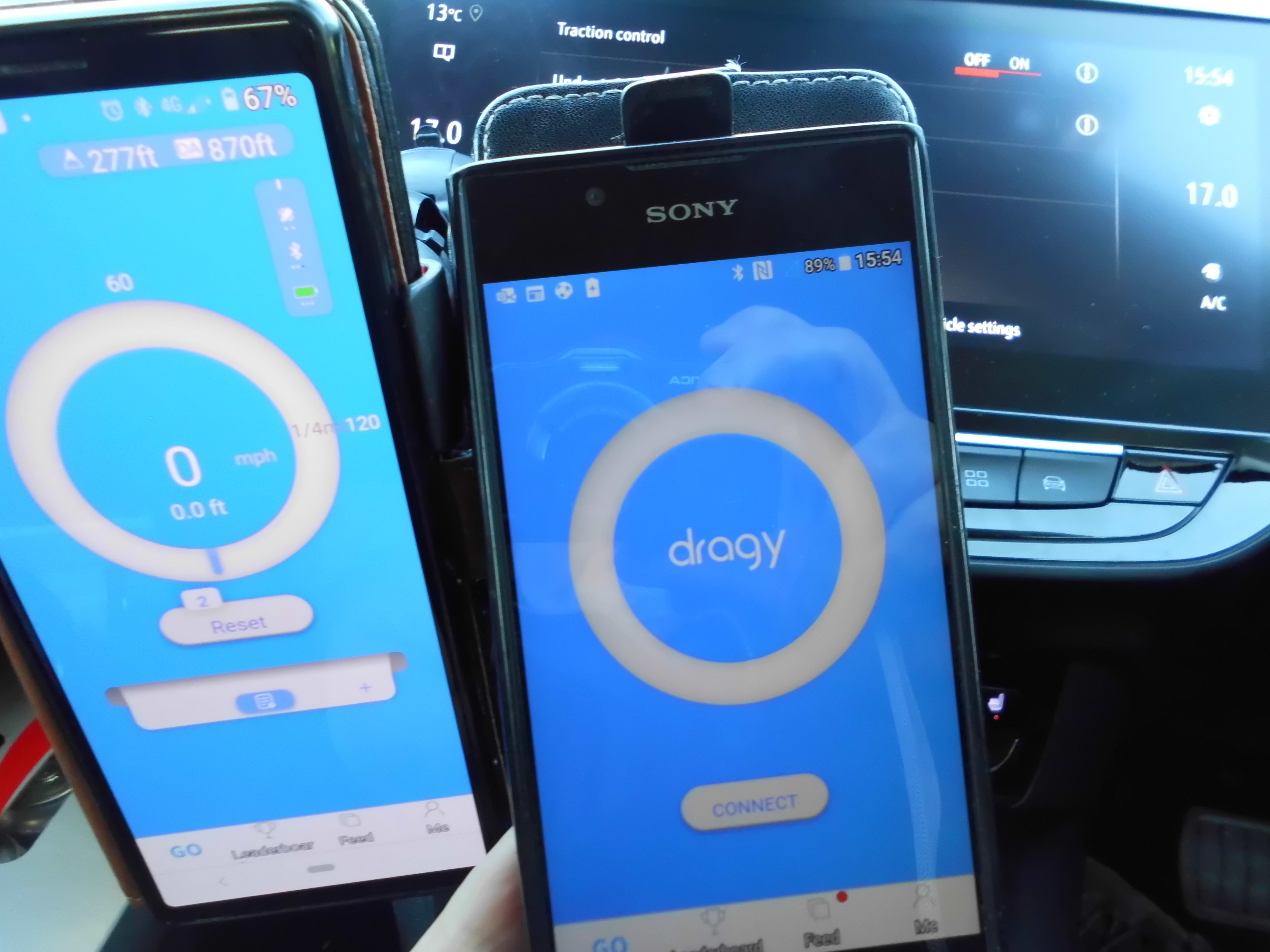

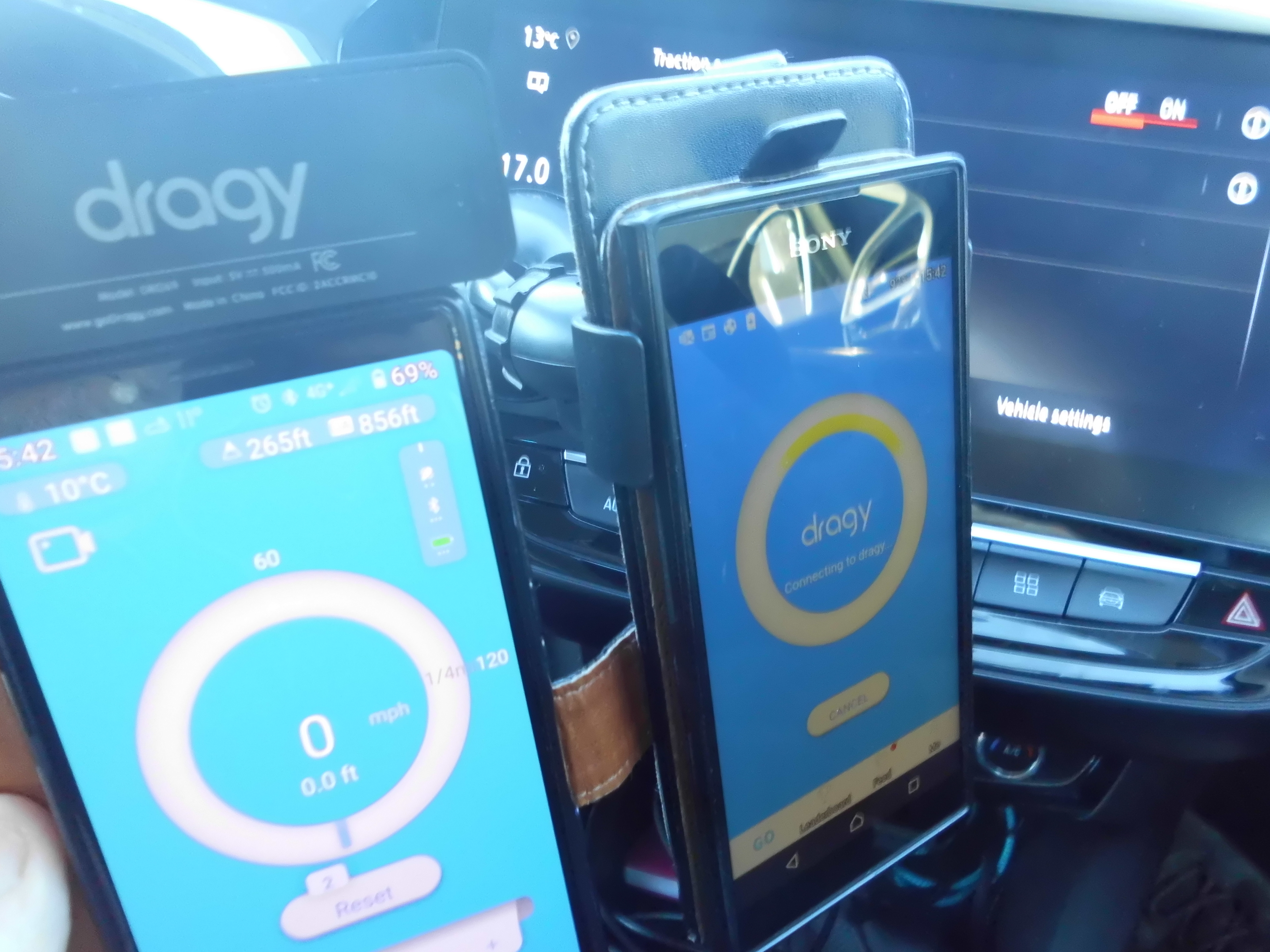

Personally as well as having the pre remap Dyno I would have had the V-box or Draggy figures from the car and with good tyres on which is pretty important with a remapped FWD car IMO.   No point always having to put Traction Control off just to enjoy a bit quicker acceleration.
