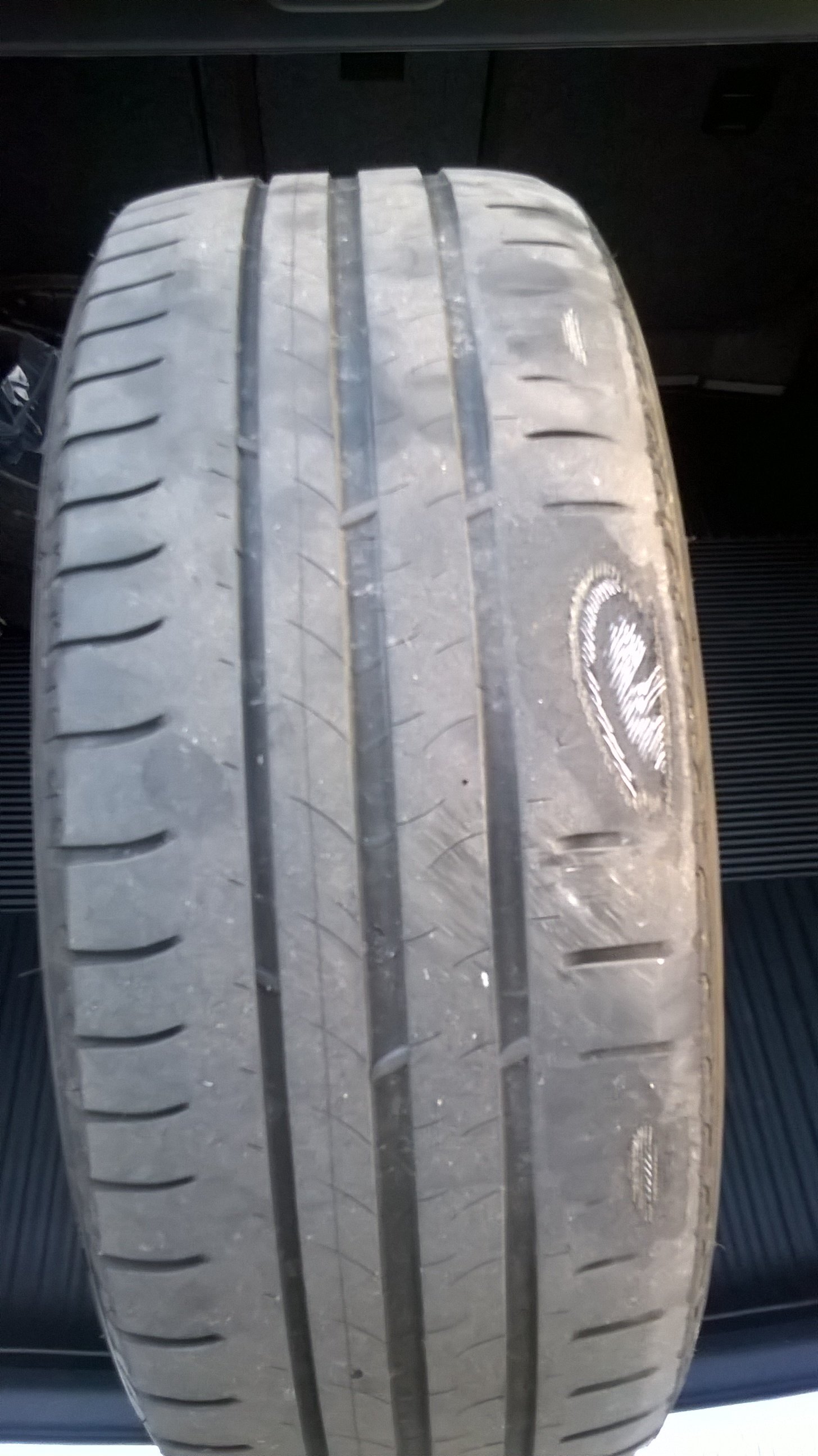

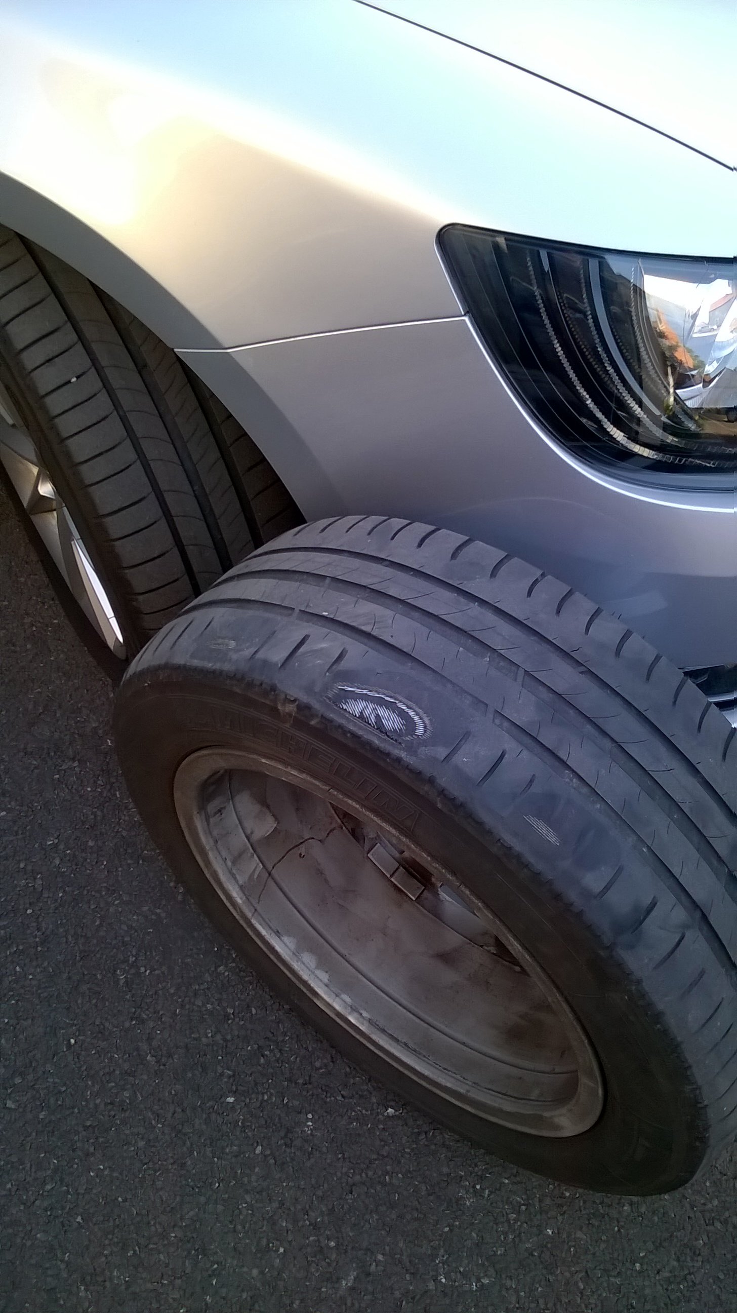

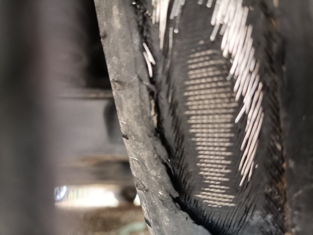

I had a rhythmic noise on the motorway last week, sounded like a rear wheel so I had a poke and a prod and found nothing, then 3 days later (next use) after a short drive the tyre pressure indicator advised I had a problem, and boy did I...
That's an original Pirelli (wk 2217) seems it's a common problem with 'older' tyres, tread base cracking allowing water ingress, water causes delamintation and a blister that fails pretty soon after, and then the carcass is exposed and you get this....
Tyre dealer had dozens of tyres with tread failure - some 2yrs old with 8mm tread, Pirelli and Avon well over-represented in his pile of similar failures!
Moral is that when you check your tyres (and I do) make sure you do it with a raised wheel, or roll car forward half a rev to ensure you can feel all the tyre.

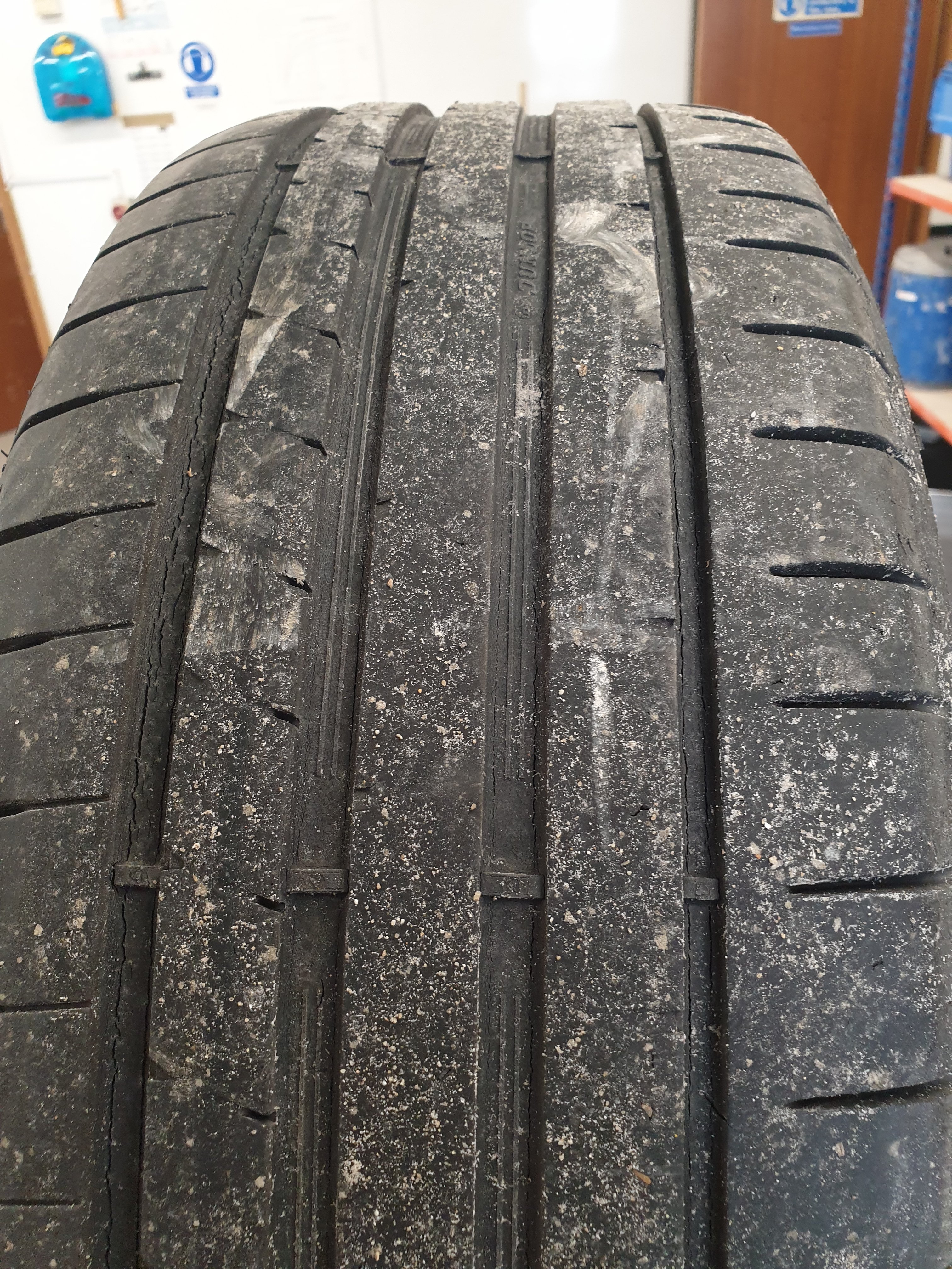

OK, got a bit of time to post some pics and further information.
Tyres are Slovenia's finest Dunlop SportMaxx RT2 (94Y)
Picture is of one of the rumbling rear tyres. Inside track is left, outside is on the right of the pic..
As per NJRJs post there seems to be the beginnings of the tread base cracking on the inner radial channel. This is apparent on both rear tyres which are approx 2 years old / 50k miles.
Not shown clearly in the photo, the centre radial tread has worn down slightly more than the two adjacent radial treads by 0.6mm, indicating running over-inflated. ( I have been inflating all the tyres to ECO option ). Also when sat on the floor the wheel/tyre doesn't stand vertically, it leans inward by about 15 degrees.
Tread depths measured in each radial channel from inside to outside ( L - R ) were 4.31mm - 3.80mm - 4.13mm - 5.19mm
As mentioned in an earlier post, I spotted the shocks were both leaking ( now replaced with new pair of Sachs ) and when checking the rear tyres, some of the inside tread segments are noticeably more worn than others, which I believe is called 'cupping'
After doing a diagonal front-to-back swap, the rumble has now moved to the front of the car. Can I expect the rumble to reduce as the tyres wear further, ie will the less worn segments ultimately catch up with the 'cupped' segments?
