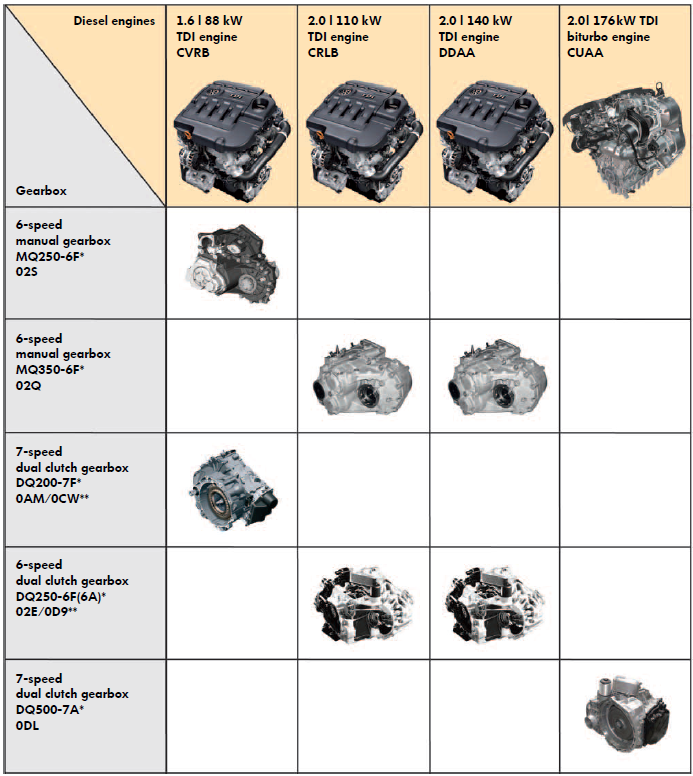

None of the mk3 Superb models come equipped with the DQ500 DSG box.
53 minutes ago, Micky 32 said:
I would have thought the 280’s came with it?
280 came with DQ250 (DSG-6 wet).
The later 272 comes with the newer DQ380/381.
I think the Kodiaq RS Bi-turbo diesel came with the DQ500.

All 2.0 BiTDi 240 passats are fitted with the DQ500 gearbox. The VW dealer claimed they needed replacing through diagnostic .
