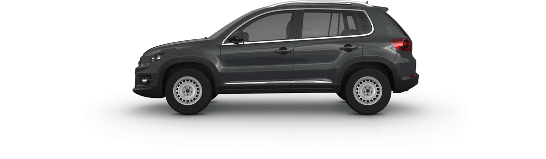

6.5Jx16 ET33 5/112 57.1 steel rims (from the VW Tiguan MK1)
https://www.mytyres.co.uk/rims/details?vehicleId=62269191771657328&rimCode=ALCAR9922
The VW Tiguan MK1 uses a 215/65R16 tyres for its 16" wheel size.
