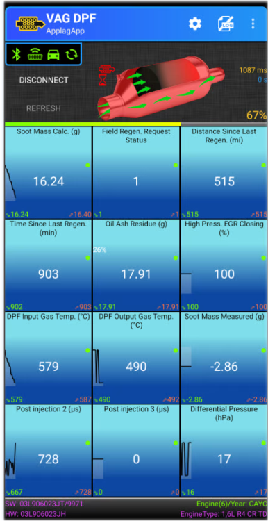

I've been using my VAG DPF for 6 ish years now, really to keep an eye on the oil ash residue.
Three things I'm not sure on - what is the ultimate limit of the oil ash as there seems to be no definitive figure. I'm measuring in (l), which I might guess is litres?
The other two things are "differential pressure", which I guess is measured on the inlet and outlet of the DPF?
The third thing is "High Press. EGR Closing (%)" Obviously it is to do with the EGR operating condition - what does it actually show? Does it show the actual degree of movement, and the frequency of operation? Mine goes up and down like a yo-yo and looks impressive - but does/can it give a warning of EGR clogging?

I would expect the (calculated) oil ash residue to be in grams or percent.  There is a maximum limit, I don't know the exact figure for the Yeti but something like 100 grams.
The differential pressure is as you would expect, the difference between absolute input and absolute output pressure.  The bigger the pressure difference for a given mass air flow, the more restrictive the DPF. Presumably there is a threshold which triggers a regeneration.
I have no information on the high pressure loop EGR except that it is mainly used at lower speeds and engine loads, with the low pressure loop EGR used at higher speeds and loads.  The latter is fed post catalyst so is less inclined to carbon fouling.

2 hours ago, Yety said:
It's the EGR one that bugs me, what is it actually showing, the  phraseology is difficult to interpretate?
I read it as when it shows 100% it's closed, normally during hard acceleration and when doing a regen.  The rest of the times it's various states of closed i.e. when it shows 16% it's 16% closed or 84% open.
I may of course be completely wrong.

From what I have been able to ascertain, ash in a DPF has a packing density of roughly 0.4 grams per cubic centimetre, which equates to 400 grams per litre or 72 grams for 0.18 litres.
Unlike soot, ash cannot be removed by oxidation during a regen i.e. it's the residue that gets left behind
I have no idea what algorithm VAG use to calculate the ash volume, and in any case this calculation is only a guide to what's really happening.

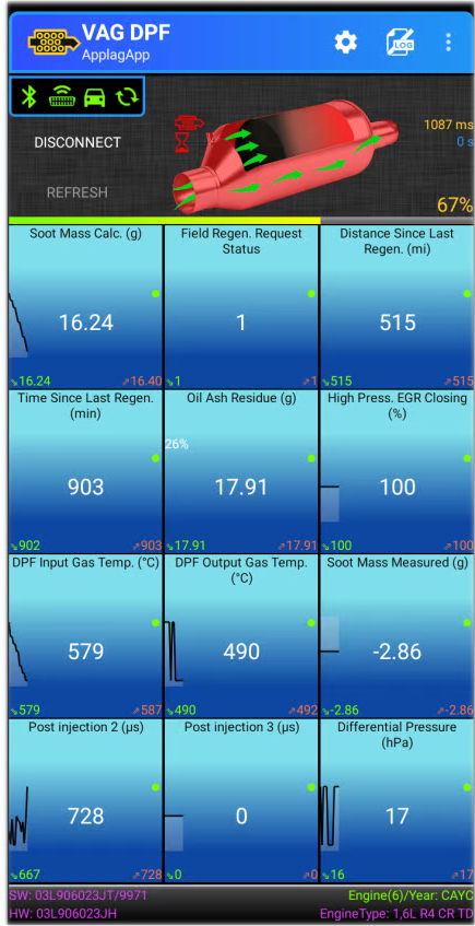

Using the picture above 26% =17.91g so 100% would be (17.91/26) x 100 =68.88g
And if your figures are correct at 72g my DPF is over full. 😱
I'm getting shorter distances between regens down to 89miles sometimes 😟

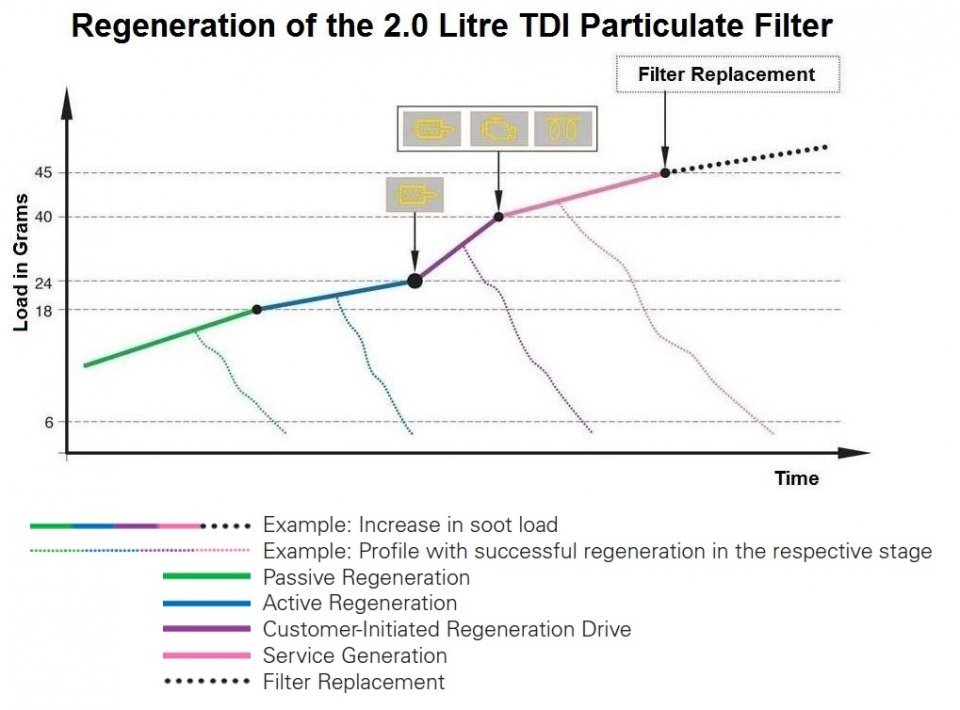

Don't know where this came from - I saved it in 2018!dpf_jpg_a086f5f5ee783d0a848200a4608781ad.jpg.13d468d4cabc4daebb176a791acf7165.jpg

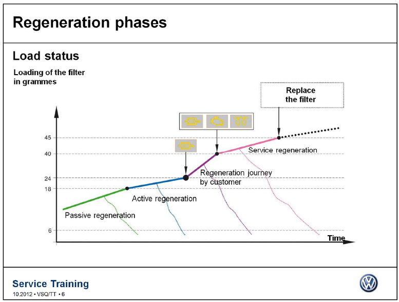

It's from this document, it had been cut off the bottom the source.
Hi
Those graphs from VTP-122 are for soot (carbon) load.  The soot load goes down during regeneration as the carbon particles are oxidised (= burnt).
The ash stays behind
