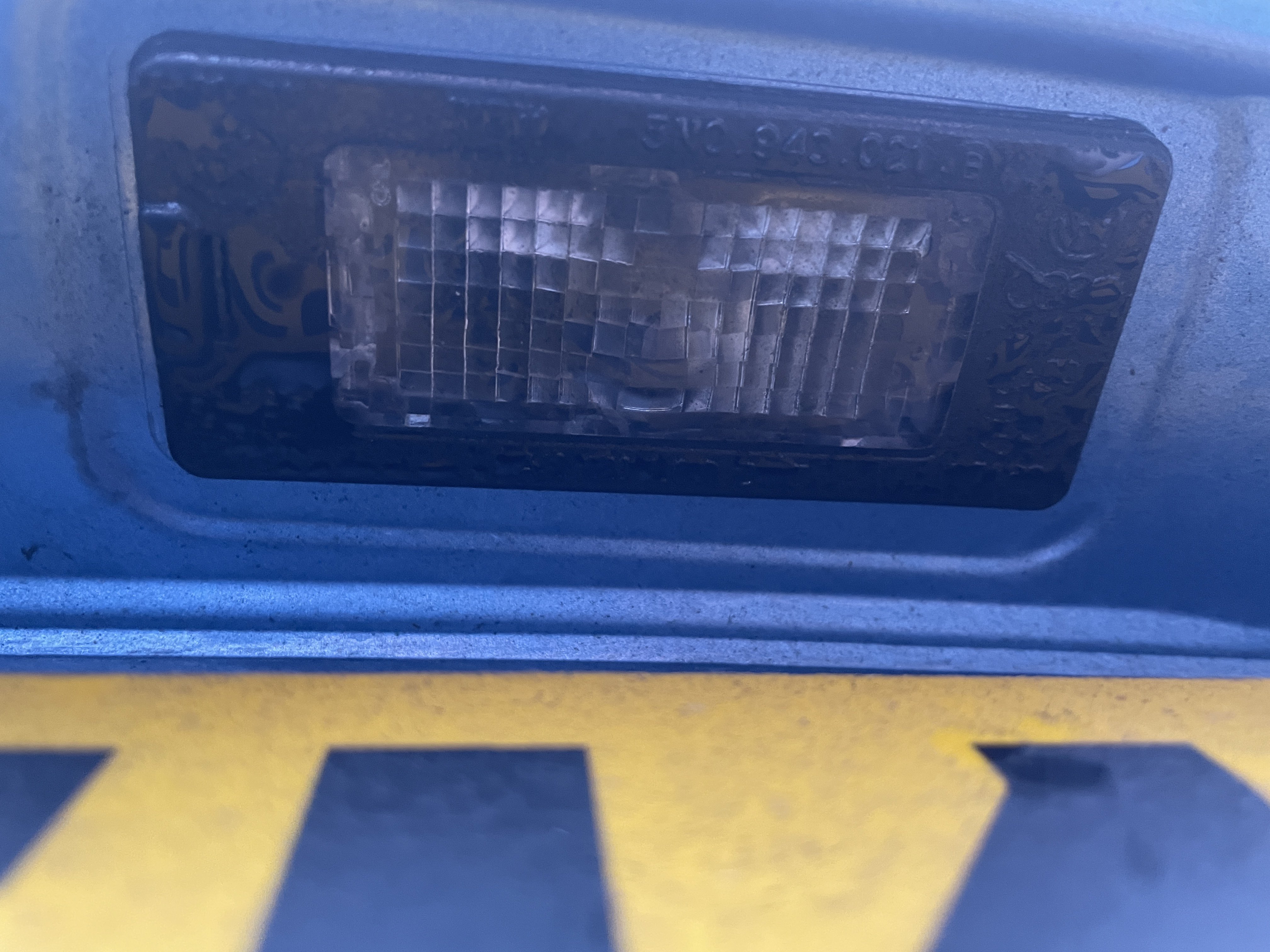

Many thanks for the responses on this.I’ve taken photo of the boot handle. Hopefully this has uploaded ok.
Could you please confirm this is the part you’re referring to?
Also if this handle is at fault why is the boot unlocking using the middle button on the key fob?
yes. this is the part that you need to replace. I have my post somewhere in this forum..I'll see if I can find .
