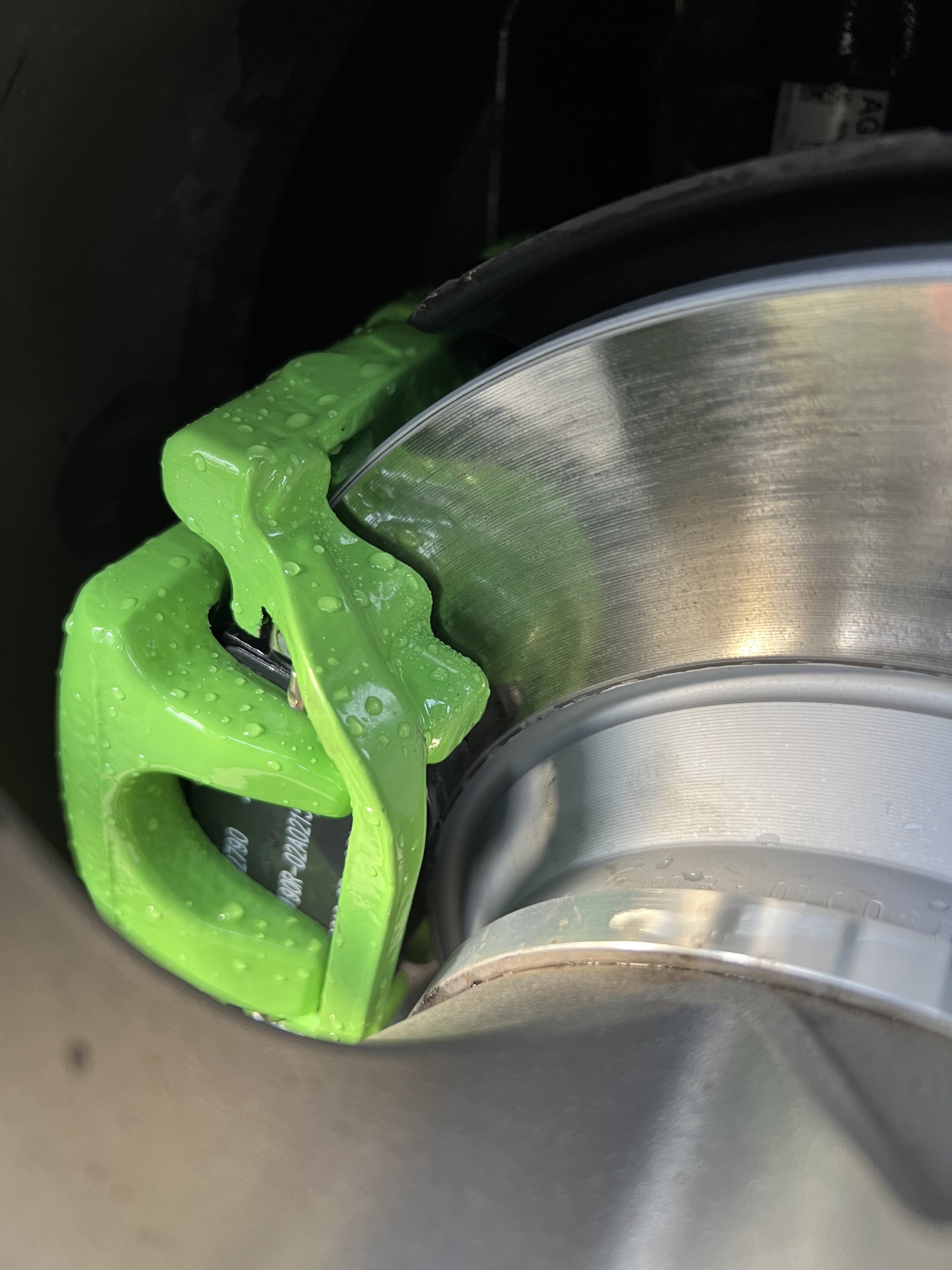

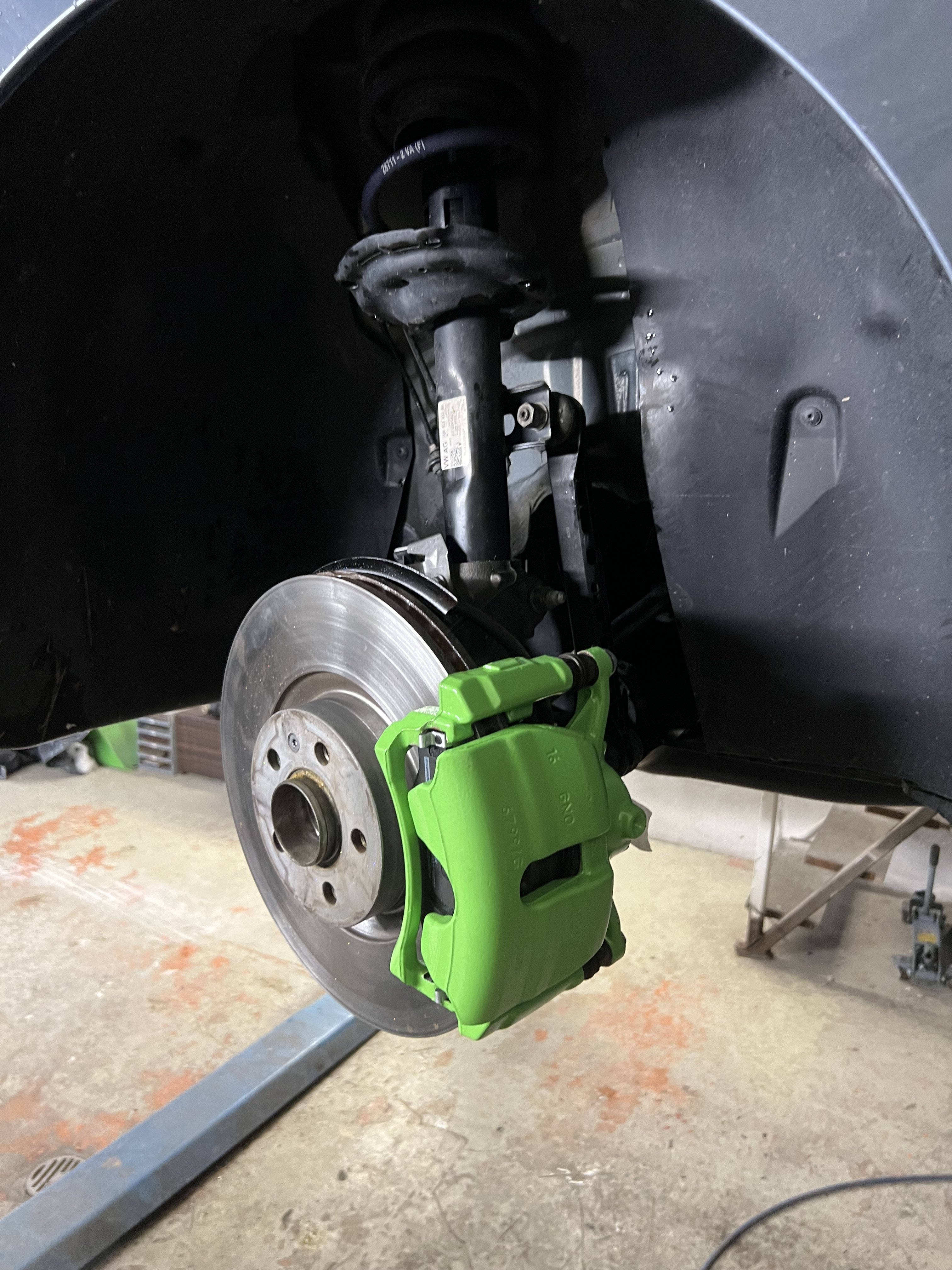

So i started today with upgrading the front big brake. Installing it was plug and play but then:

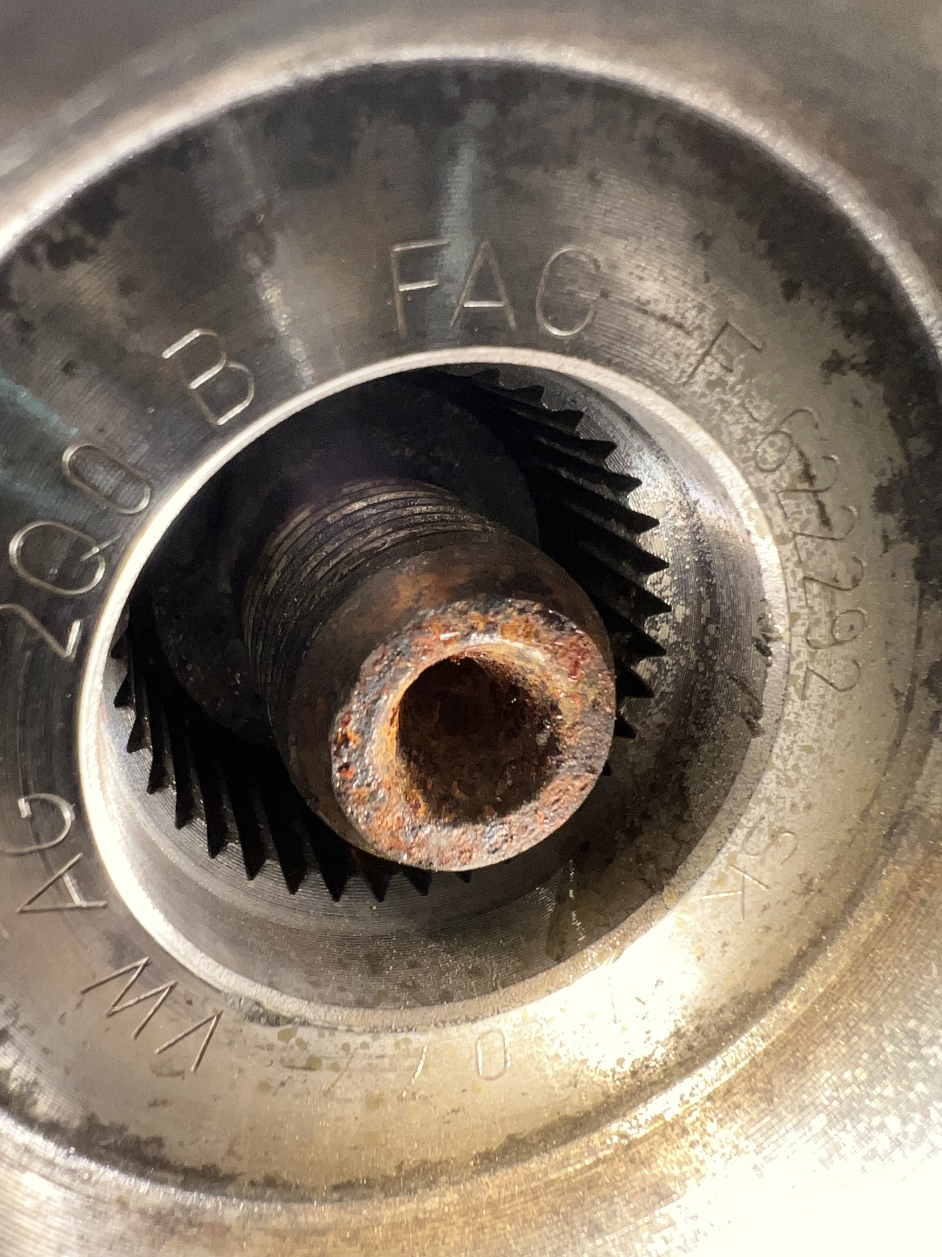

The outer joint of the drive shaft is too short for the Polo Bearing hub. I think it’s the mentioned 9mm. So replace with Audi or keep original. I recommend to replace the bearing.
Afterwards you have to adjust the steering. If not you ride like on pudding.
At the very end you have about 70 errors on VCDS. The very important is the Speedsensor: wrong component installed.
So we will try to use the Scalas Speedsensor on Monday.
Driving now is nearly impossible, too dangerous. And keep on mind, to have transmission in „P“ before unplug Speedsensor. I will update you on Monday (hopefully)
Edited by SteffLimitless
Update: Installed the Scalas Speed Sensor and no error codes anymore. Transmission was on „P“ and this error is gone too.

@Carlston Indeed, like i already said, the joint of the drive shaft is shorter, but not too short.

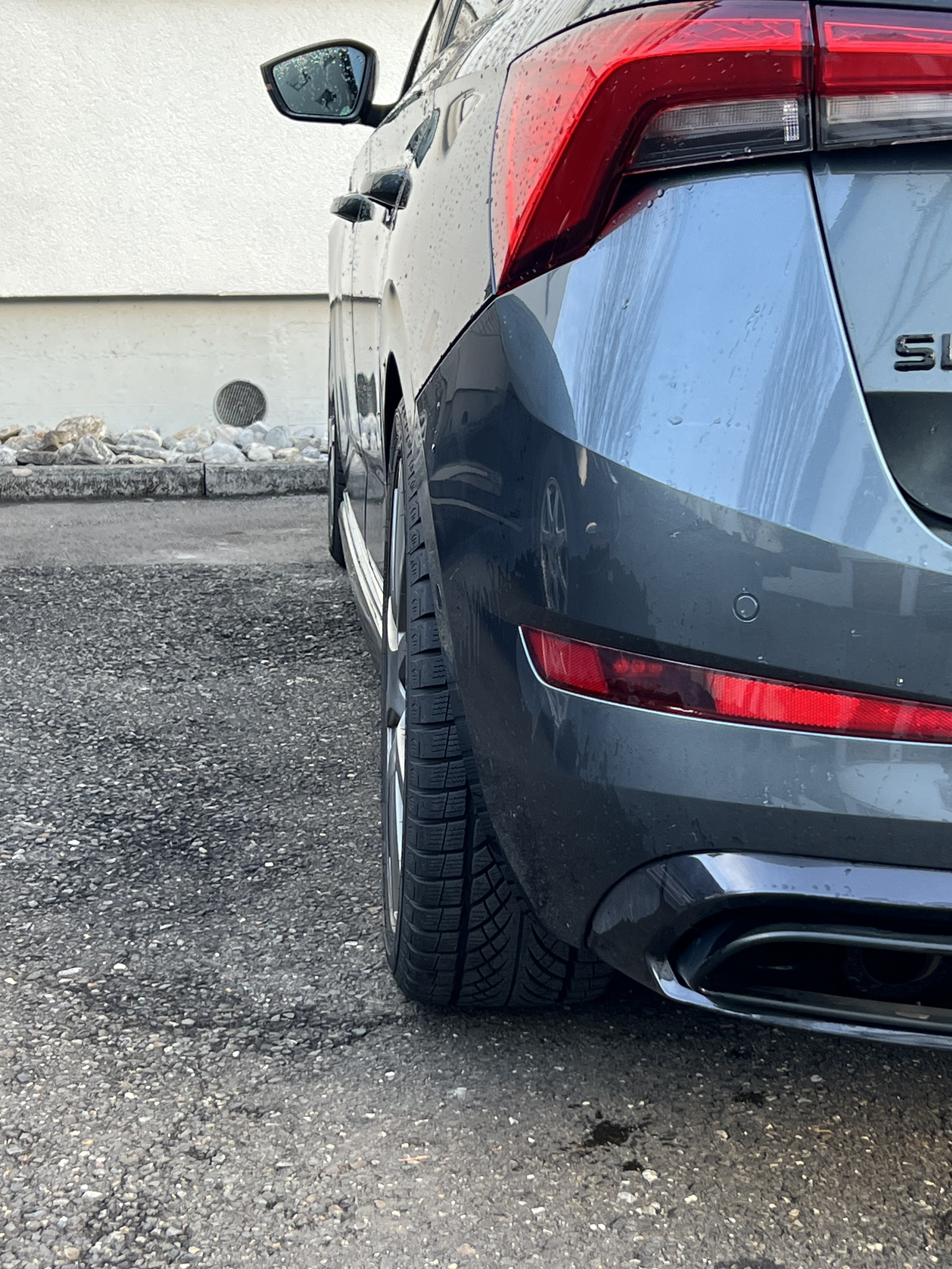

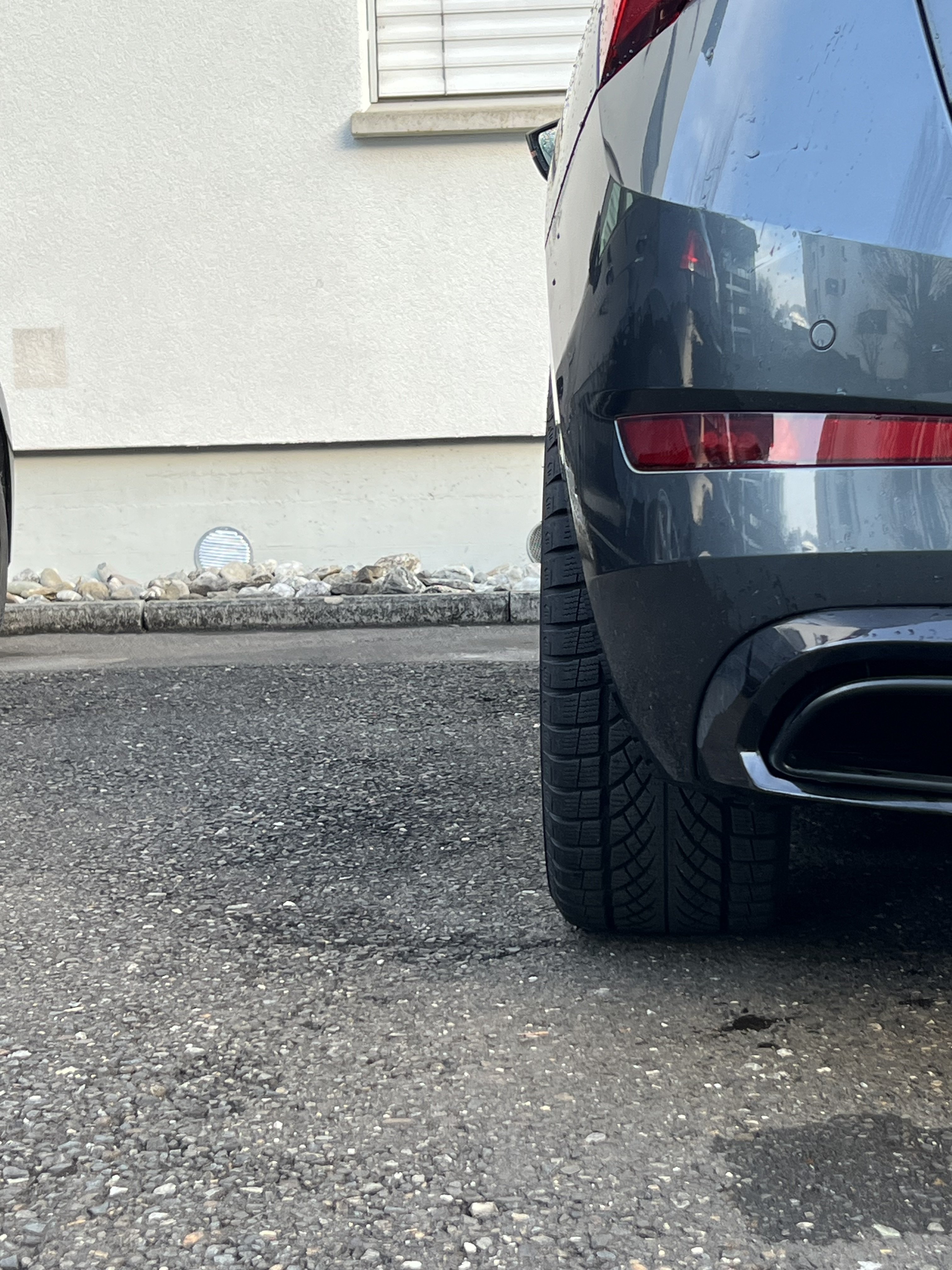

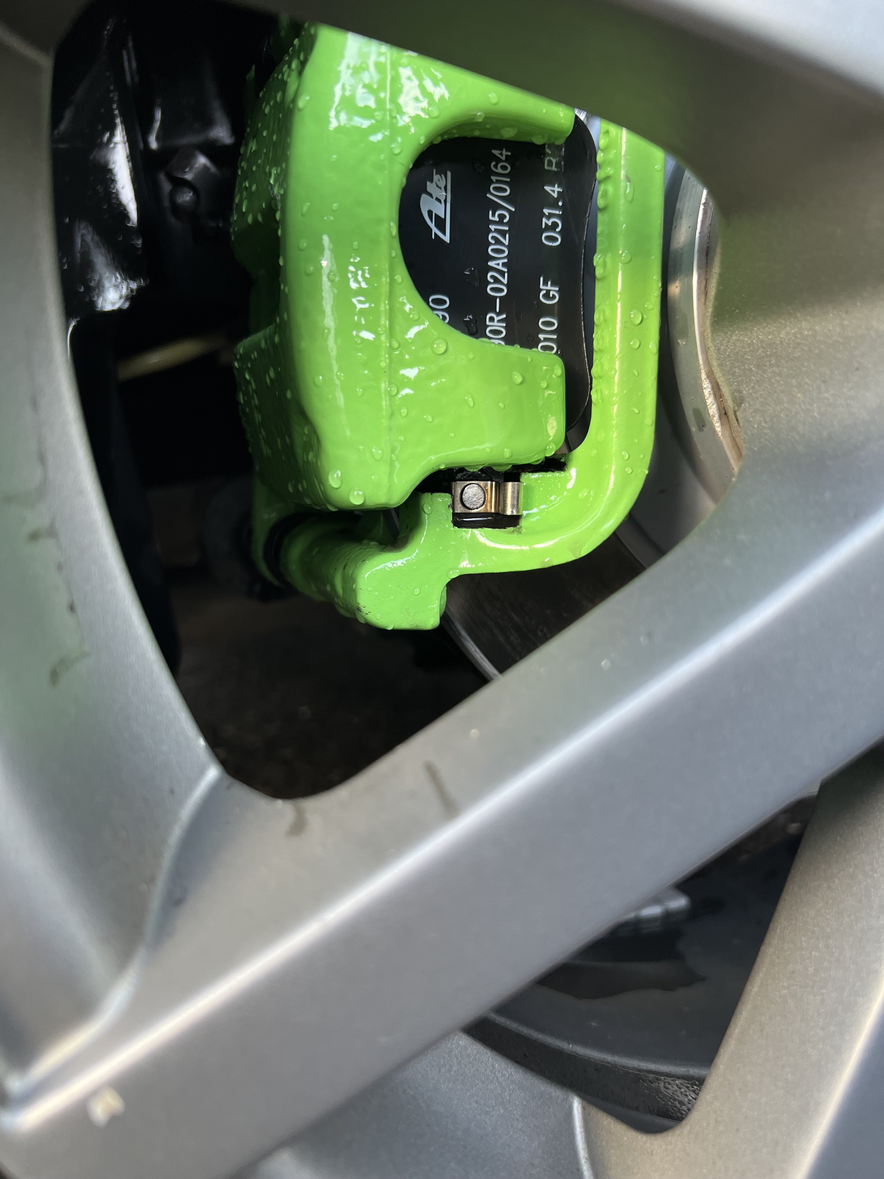

So finally i installed the rear axle from Polo AW1 GTI.
My Experience comparing the BQ and BF axle is:
Wheelbase is the same
Mounting holes for brake caliper carrier are exactly the same
There is more negative camber
The axle itself weighs a few kilos less and the continuous height of the crossbar has only 8cm, instead of 9.5cm as with the BQ. Means the Scalas BQ Axle can carry more weight.
So actually it’s not necessary to change the whole axle like @Carlston recommended. Tell me if i am wrong.
When you have a trailer hitch, better keep the original BQ rear axle, when you want to have a little bit negative camber, the BF is recommended.
Pictures will follow
Look forward to pictures.
Could you please share cost of this retrofit and a list of changed spare parts?
The costs were: €500 for complete used rear axle. €60 2 component 3 layer color for brakes. €170 aligning track. New Zimmermann discs 80€. New ATE pads 35€.
i have good friends, one is car painter and the other is mechanic, so i just paid the parts except track alignment.
Here the Pictures🙂

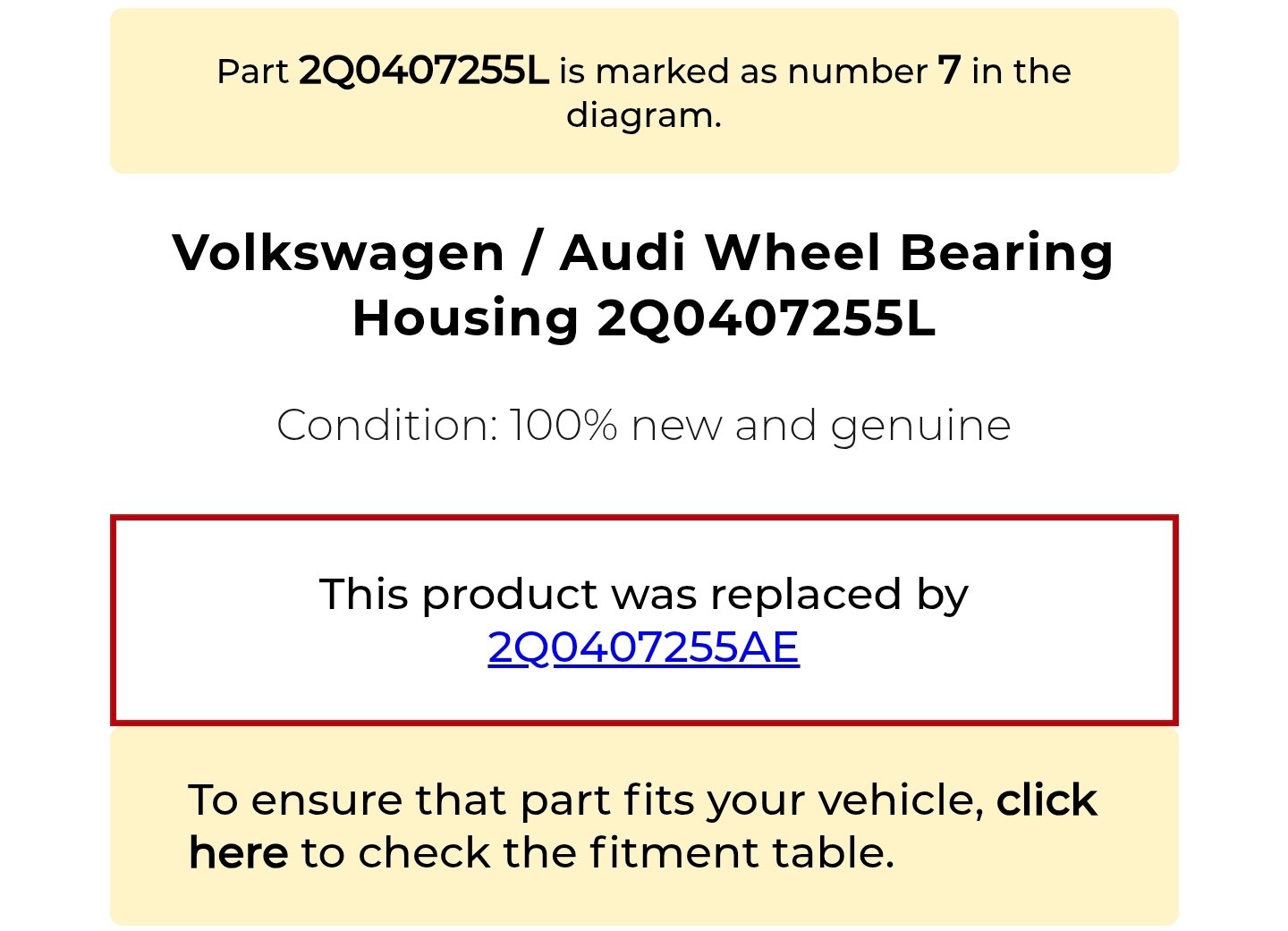

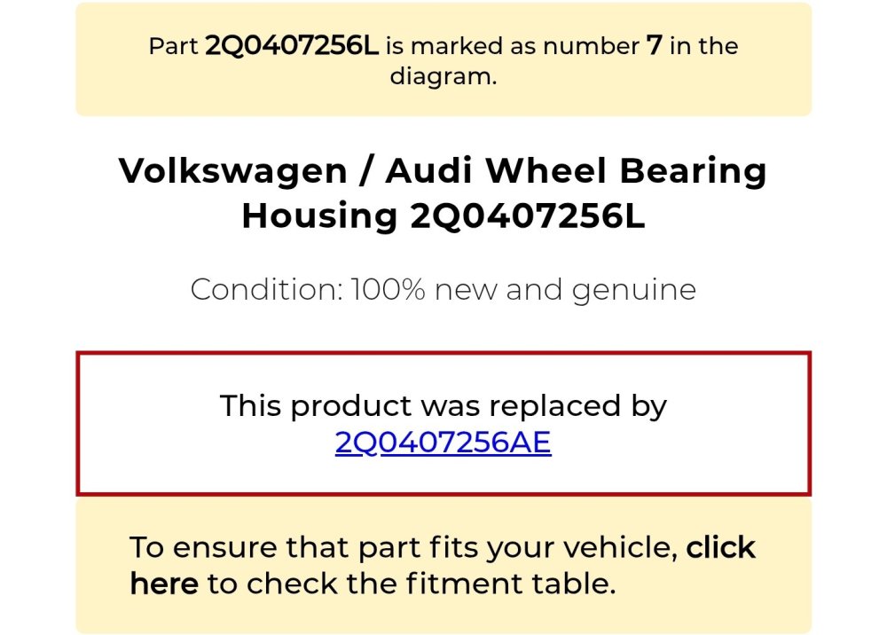

Its a scala 1.0 gtec 2020 model, with 256 front discs and i need upgrade the front and the rear brake system. So i have to change the front steering knuckles with the polo aw gti that doesnt have the built in carrier, right?
The diameter of the front shock absorber of my scala and the polo aw mk6 gti are the same?

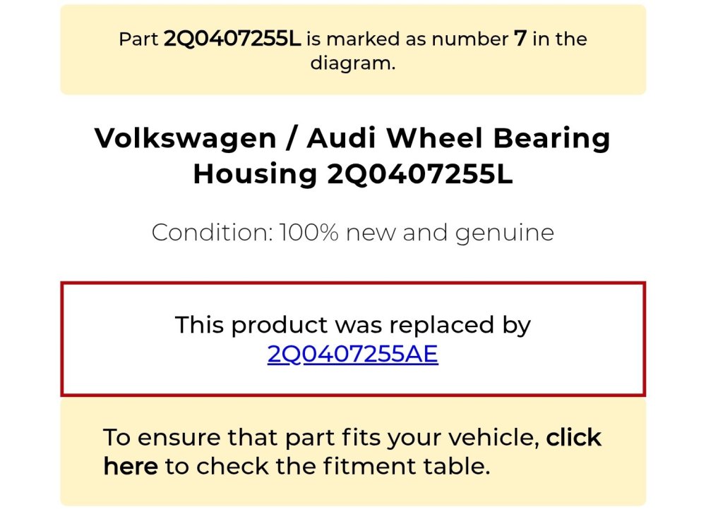

Also the part number of the steering knuckles, as you said are 2q0407256L and 2q0407255L.
At the lllparts i see that part number have been replaced with the 2Q0407255AE.
Are these the same?

What do you think about the wheel bearing housing?
The lllparts says that 2q0407255L & 2q0407256L are replaced with the 2q0407255AE & 2q0407256AE.
I found both part numbers available, are these 2 the same items?
The Polo MK6 parts catalogue lists 2Q0407255L, 2Q0407256L, 2Q0407255AE, and 2Q0407256AE...with the AE version being a newer version of the older L version. Cars manufactured after 25/05/2020 used the newer AE version instead of the older L version. It seems likely that they are interchangeable.
