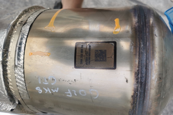

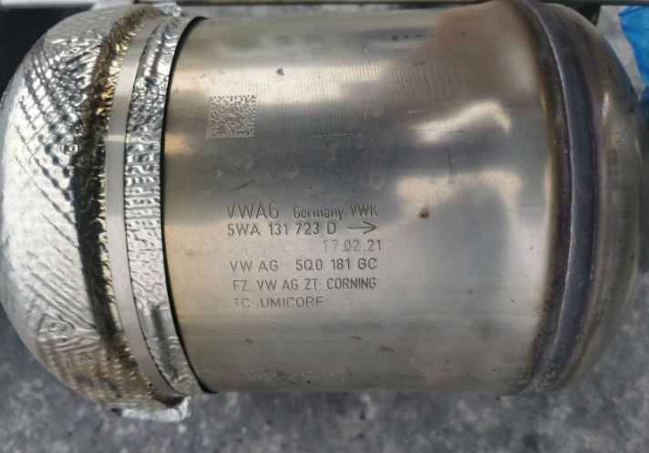

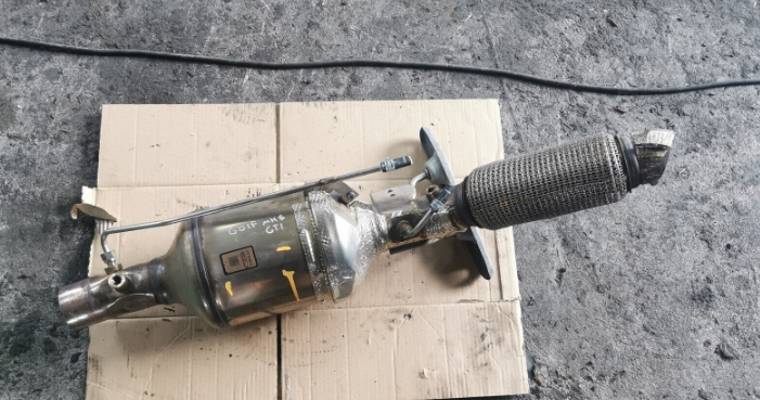

Have a look under the car and see if you can see the GPF. It looks just like a DPF on a diesel.
It will look pretty much like this.

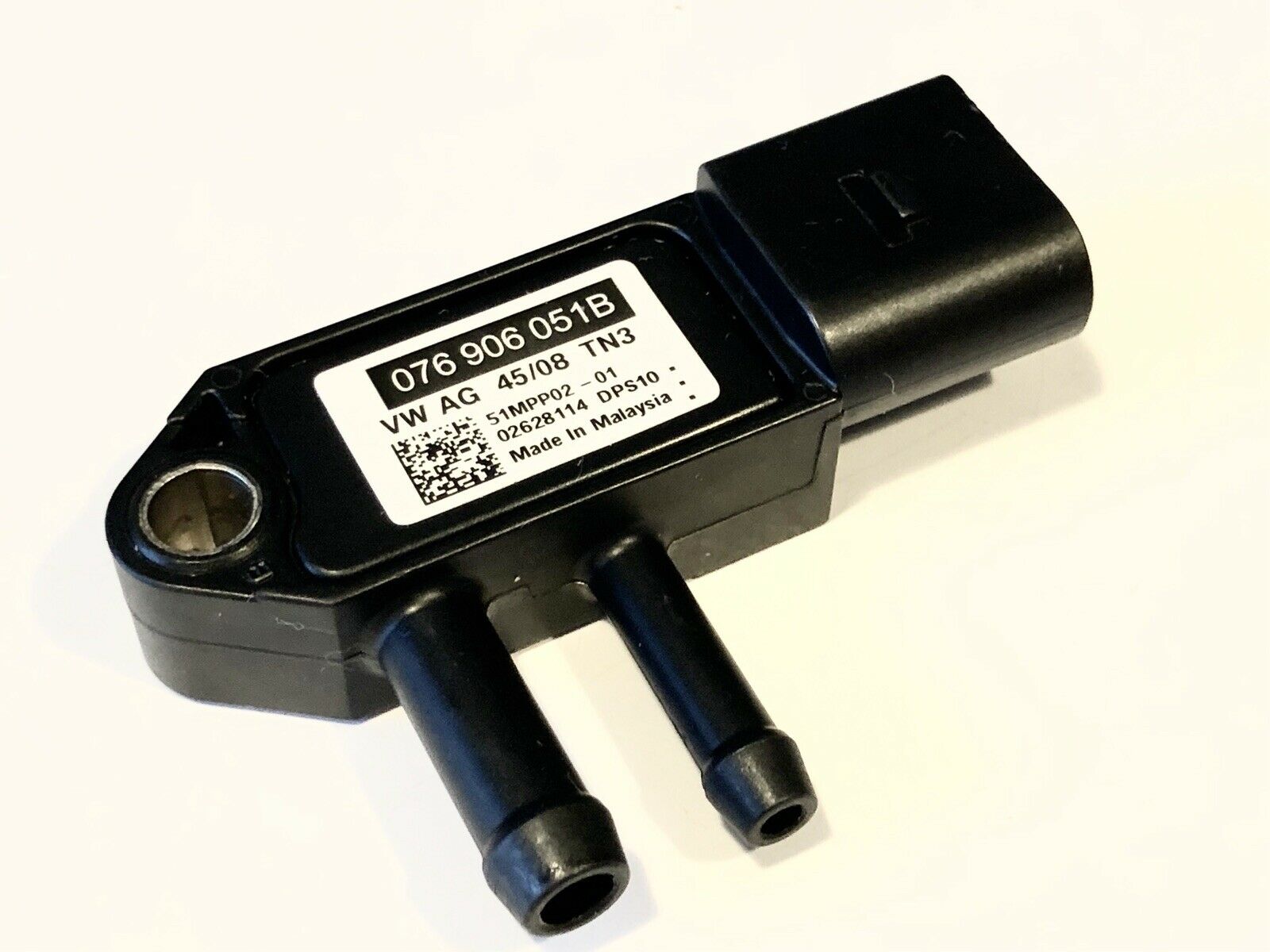

You can save crawling around if you look at the top/back area of your engine.  Look for black/grey heat wrap with some buttons usually, and if you pop them open to reveal this, you have GPF.
/cdn-cgi/mirage/5743e71b2929cd34ec7dffabb57f89f4f5bbc7c9f6d828f9fc72e73d5da851e1/1280/https://www.briskoda.net/forums/uploads/monthly_2023_01/G450.thumb.jpg.a8edc9e130149e4ac46dbe46b6917964.jpg
Reminds me of the similar thing in front of the drivers bulkhead DPF pressure sensor because I had one replaced on a TDI.
Correct, the DPF or GPF will use a G450 or G505 sensor 🤝It will look same, along with a pipe(s) down to the filter.
