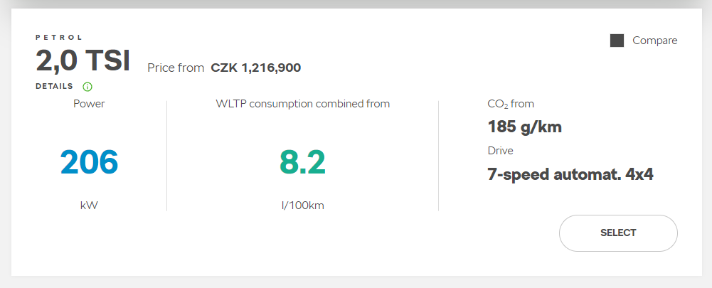

Ours is a March 21 which seems to be referred to as a 206kw but is also referred to as a 280 - was under the impression it’s different to the 272… has 7speed wet clutch.

206kw is 280ps. 272ps is 200kw. ps of course being metric horsepower.

At some point in 2021, Skoda 'restored' the missing power from the 272PS/200kW engine. Yours is most likely one of these models.
