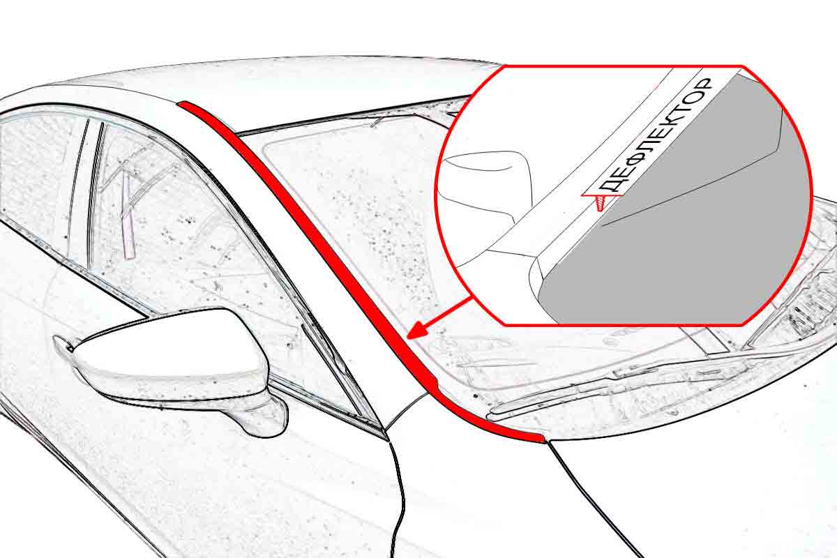

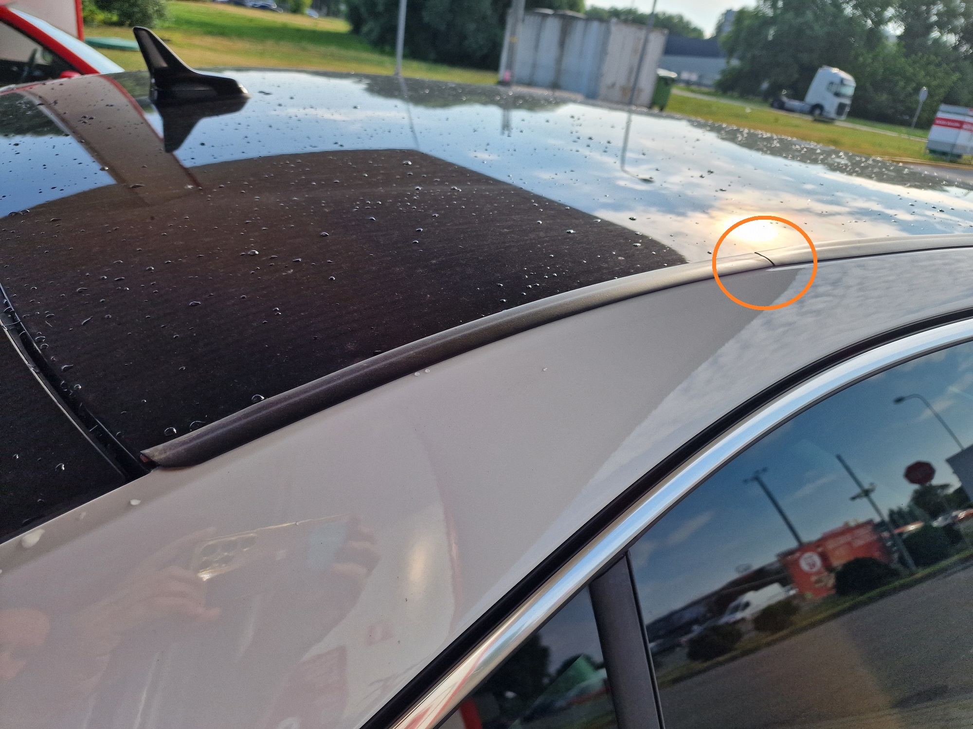

Windscreen Rain Deflectors on A-Pillars

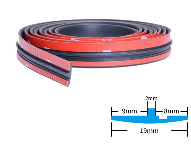

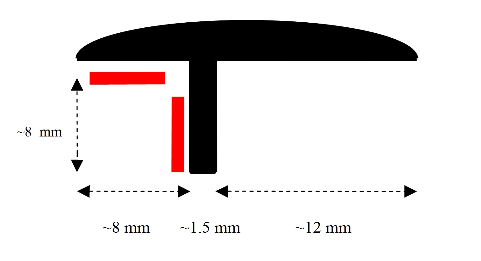

Maybe someone can suggest where i can order something like this
Profile like in picture:
(red is adhesive 3M tape)
Length 100cm (80cm windscreen + 20cm partly on the roof)
Left and Right have small difference in cut shapings on the ends.
There is also field for extended versions:
b)    237cm (80cm windscreen + 157cm whole length of roof) for sedan, would prefer that model
c)    ~280cm (80cm windscreen + ~200cm whole length of roof) for wagon

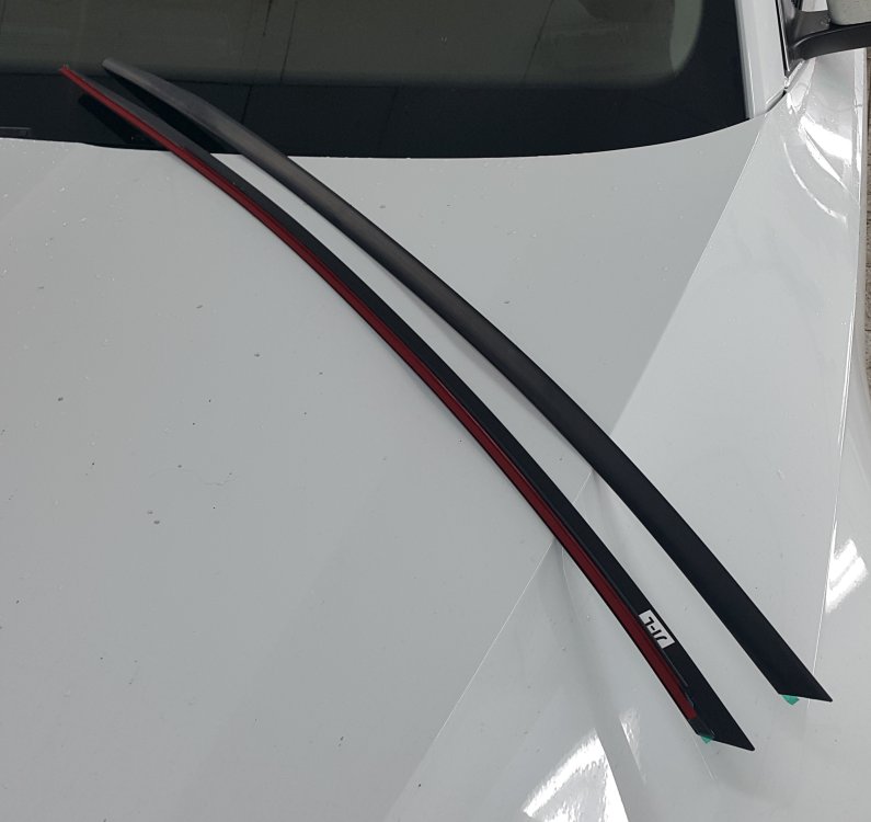

for current car, in far 2017, i ordered from Moscow
-> https://strelka11.ru/deflektor-2d/superb/deflektor-strelka-2/skoda-superb-690
but for known reason this source has been closed physically and morally for next few decades
20171117_A-Pillar_Rain_Deflectors_Strelka11_0.thumb.jpg.473a6c43d8127cd3dc2ecab44349b35b.jpg
20171117_A-Pillar_Rain_Deflectors_Strelka11_1_ED.thumb.jpg.8e32c49fdf92793464d1580ef837c277.jpg

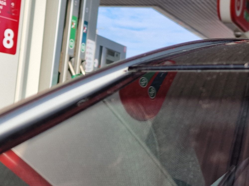

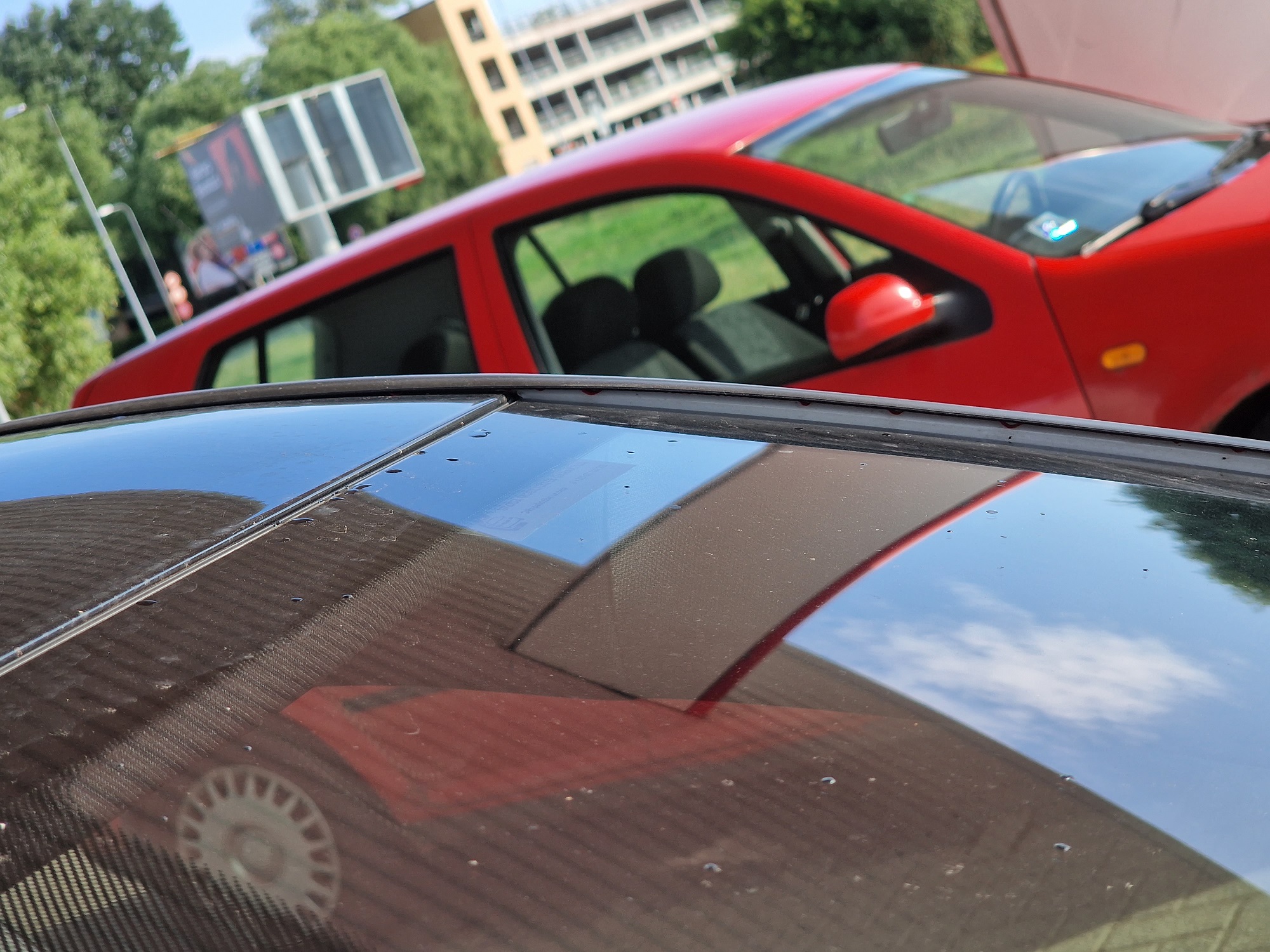

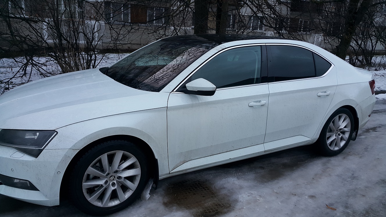

after ~50km without deflectors:
20171117_A-Pillar_Rain_Deflectors_Strelka11_30_25p.thumb.jpg.0c6f83b10a1d22e05bec44e6102a990a.jpg

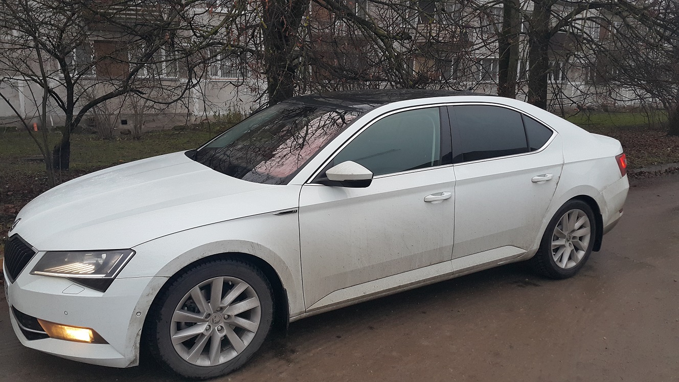

after ~600km trip (Riga<->Vilnius) with deflectors:
20171117_A-Pillar_Rain_Deflectors_Strelka11_31_25p.thumb.jpg.b5a648ca1621de2b7ab22babef3bb4ef.jpg

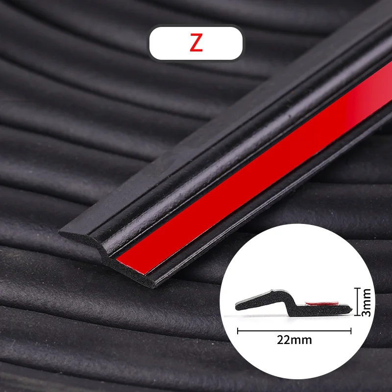

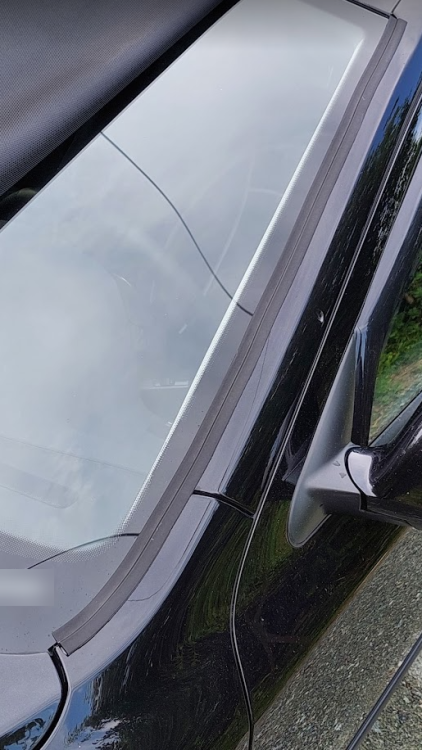

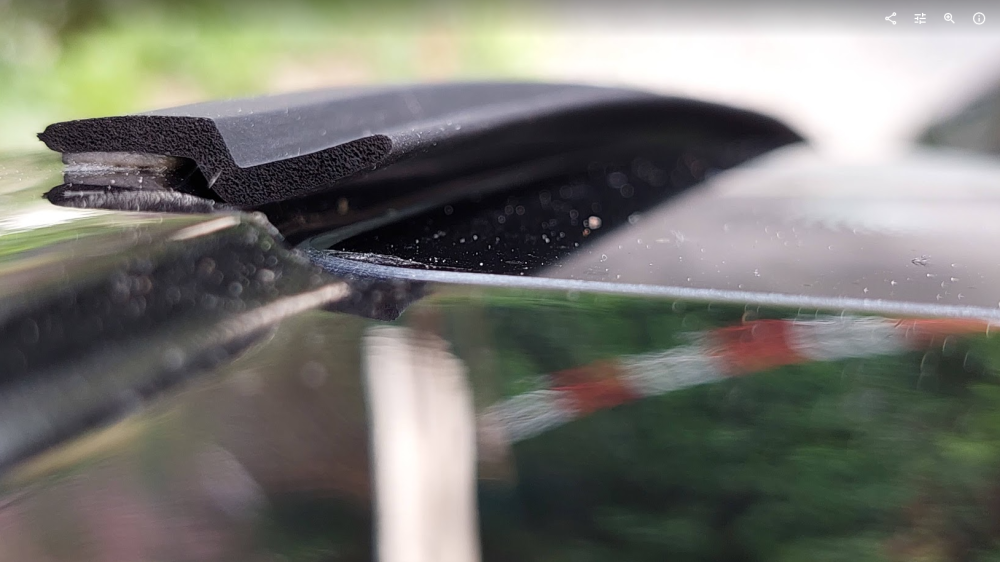

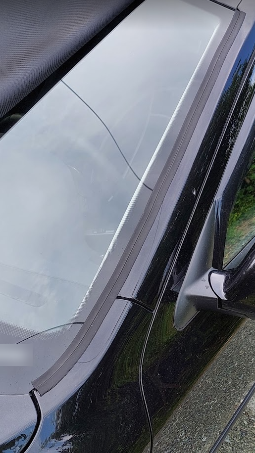

partly solved by adding soft rubber, ordered from Ali.
wide side glued on metal, narrow remains in the air
19mm-Car-Window-Edge-Windshield-Rubber-Seal_ED.jpg.6d9b6b7507fbb90cd22c86bf4e7e1224.jpg
~2mm closer on the left side than on right makes it less effective
LEFT - nok
RIGHT - OK
ordered 2pcs 4m, but received 4pcs 2m 😞
few cms around bonnet unglued, after reached 198 kmh in speed test,
solved by double side 3M
russian T profile were from harder material, what is better for this position
