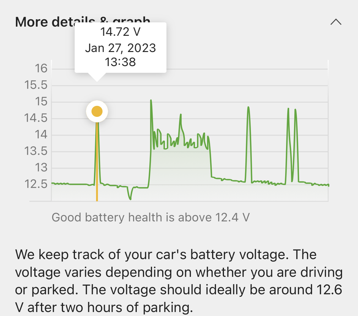

    So I see you guys have been having fun with my thread 🙂 - good interesting stuff   I decided my battery was effectively dead (in that it would not drive start/stop and gave up the ghost afte
  • RIncewindwiz
    RIncewindwiz
    Charger on car for < 2 hours (I looked after 2 hours and it was fully charged) Plugged into 12v - Only a GPS watch FYI I sent Yuasa the charging readings and they replied 12.58v would n

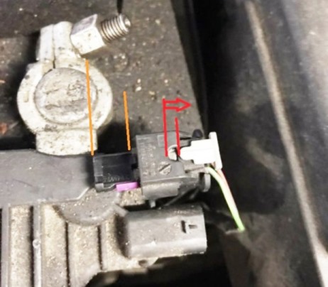

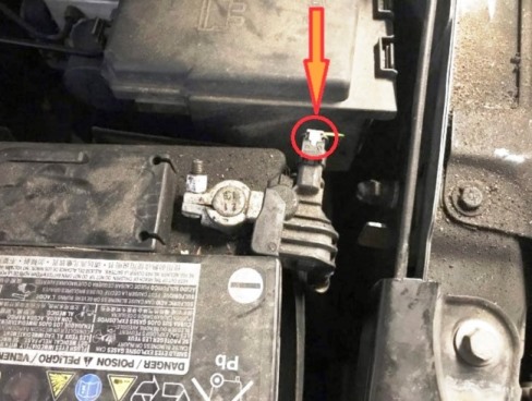

Nirrain, it'd help if you added your car details and if you want location to the wotits that are at the left side of the posts.  2018 Octavia Mk3 - what engine, gearbox, trim level.
Also if you could put a link up to the 2-amp charger or its make and model.
You are doing the right thing by having a low amperage but you're not applying it at the right time and possibly not correctly.
I suggest for now you read the Owner's Manual about disconnecting and reconnecting the battery and possible resets on the car and you disconnect the battery, and leave it on charge again until full.
For the sake of the little effort and time required whilst the battery is disconnected - [ETA: - carefully bridge/join the positive and negative battery leads post clamps together to complete a circuit ] - turn the ignition on, press and hold the brake pedal down so that if the battery was connected the brake lights would be on, turn the headlights on, after about 20 seconds, turn headlights and ignition off.  This might reset some of the many computers that might have been upset or just a refresh of 'turning it off 'n' on agen'.
For the sake of the little effort and time required whilst the battery is disconnected turn the ignition on, press and hold the brake pedal down so that if the battery was connected the brake lights would be on, turn the headlights on, after about 20 seconds, turn headlights and ignition off.  This might reset some of the many computers that might have been upset or just a refresh of 'turning it off 'n' on agen'.

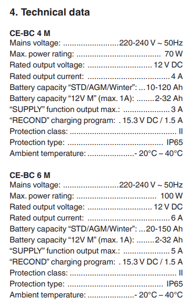

On 27/01/2023 at 14:22, Nirrain said:
The charger is an Einhell CE-BC 2 M 'smart charger'
I note from the Manual for the charger that it is designed for up to 60Ah, your battery is rated at 69Ah so using the formula in the manual if the battery is fully discharged it will take 34.5 hours (at 2-amps) to get it to 80% charge (about 12.4-12.5v).  In maintenance mode at a maximum of 1-amp the time doubles.  These times will be increased if the battery is connected to the car and has a constant drain on it.
The charger does not seem to have a recondition mode so once you have the battery as fully charged as you can from the charger it would possibly help to use the car to cycle the battery's discharge and charge, from the alternator, as the battery is designed for.  Use the least consumers and battery consumption as you can until you put the battery on the charger again, to fully recharge the battery again to hopefully have regained as much of the battery capacity as you can.  If required you could repeat use of the battery on the car and then another full recharge using the battery charger.
The maintenance mode is really for when the car is not used for long periods, as noted in the car's Owner's Manual but the battery is designed for cycling so should have some discharge.
Winter mode is for when the ambient temperature is below (+)5c, if the temperature was above 5c last time of charging I would not worry about it given the state of your battery.
Manual.pdf

From the SkodaConnect app the voltage fluctuates while in maintenance mode, see attached image showing 1 week measurements where the middle part was the long maintenance mode charge and the other peaks have been while driving.

The voltage readings have been from my multimeter as well as the "SkodaConnect" dongle that seem to be in agreement as long as the car is forced to be fully asleep (e.g. doors and bonnet hatch activated)

From the pdf of the manual for your charger. -
How good your battery is now is difficult to know so that makes it more difficult to know how much your problem is related to the battery or the car and in what proportion.  I'm not sure about the accuracy of doing your test and if you do the battery is as it is at the moment.
