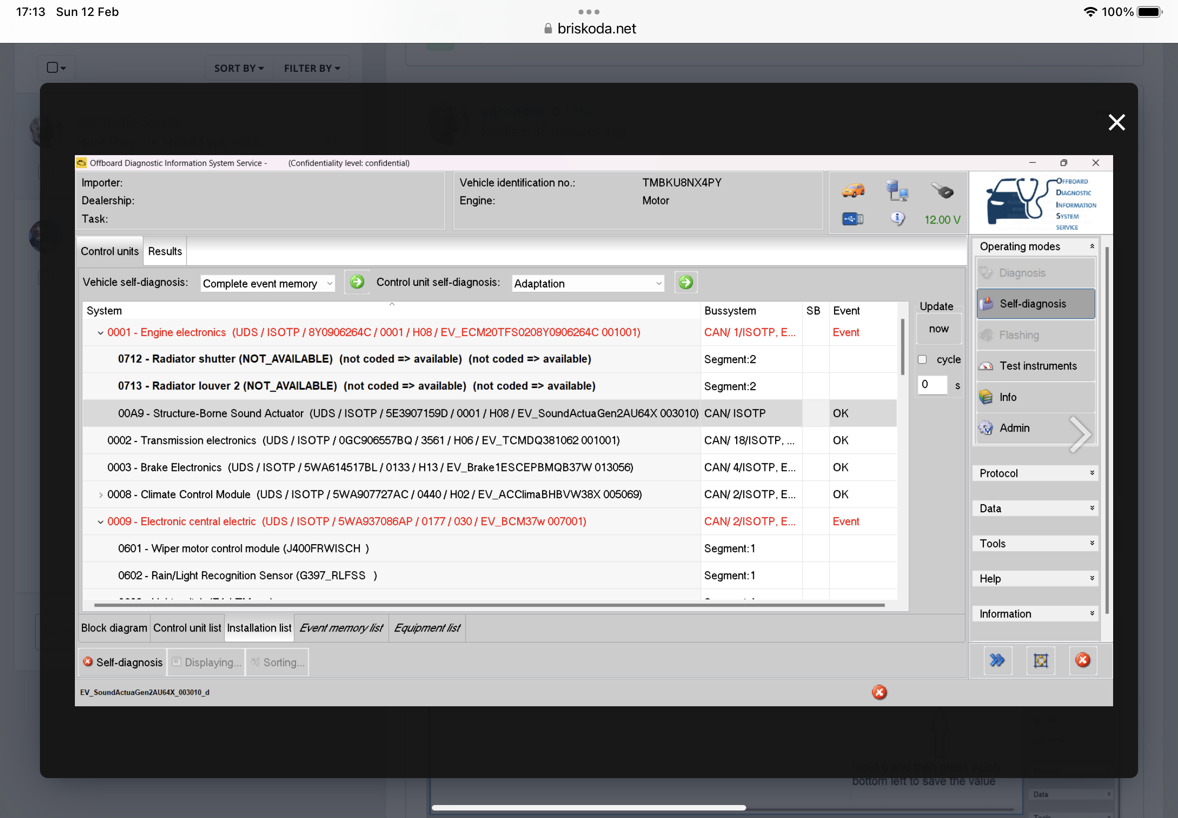

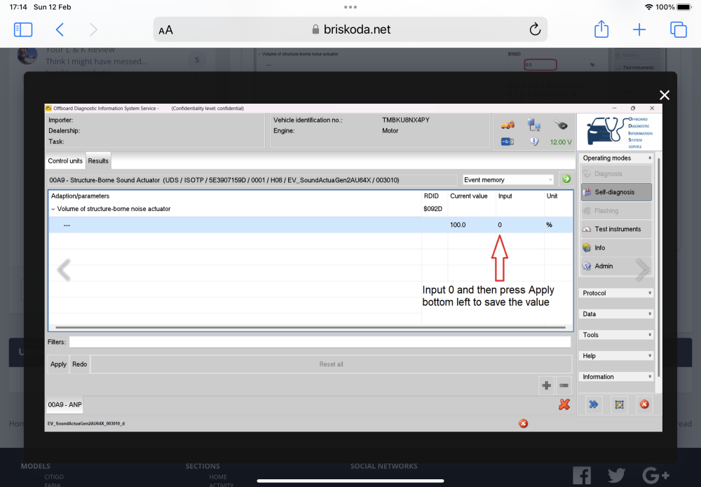

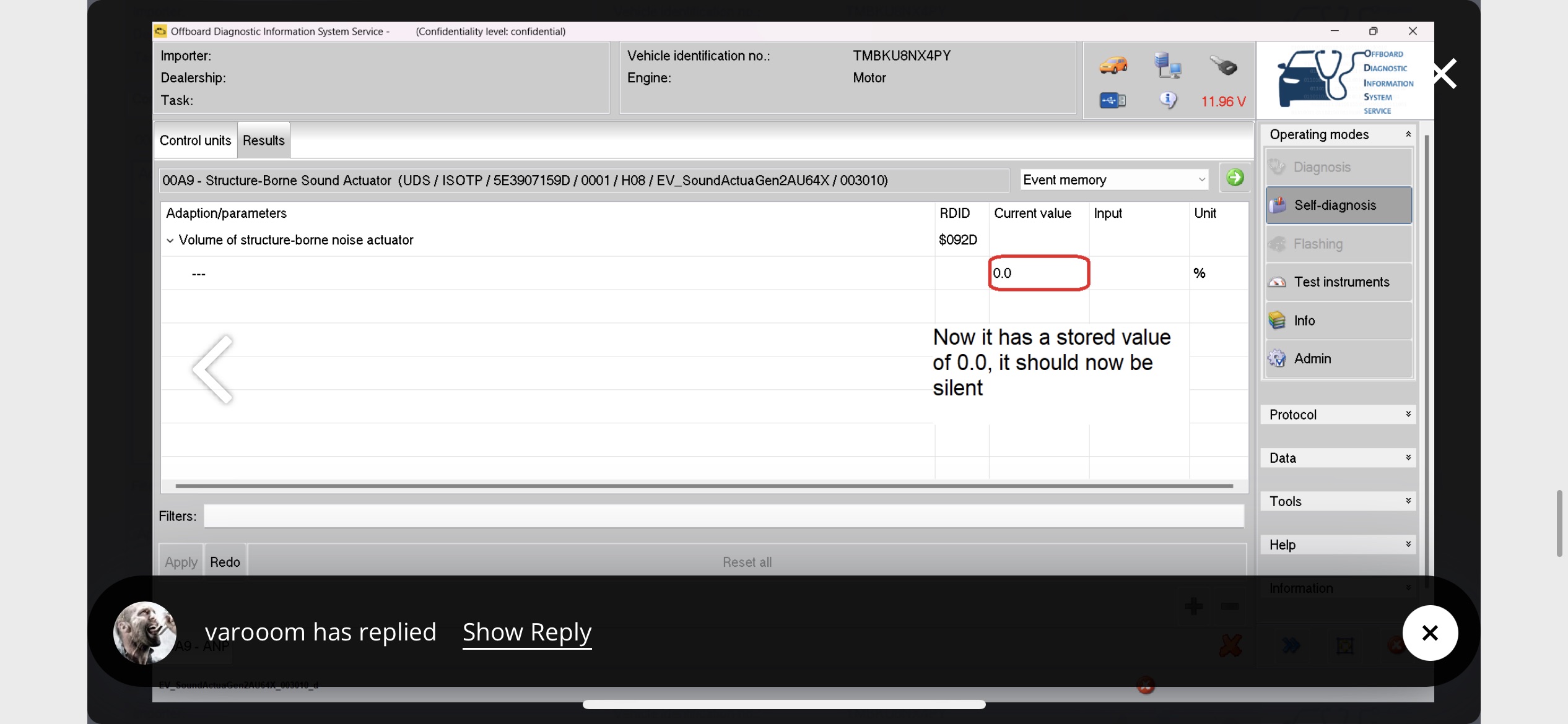

How to Switch Off Fake Engine sound using ODIS
Nice write up, I just wish someone had mentioned it was under engine address, as it took longer to find than execute the change.
But it should help others locate it, if they are struggling 🤝
I too didn't like the sound actuator at 100%.  Had mine turned down to 30% which seemed to be a good compromise.
Gaz

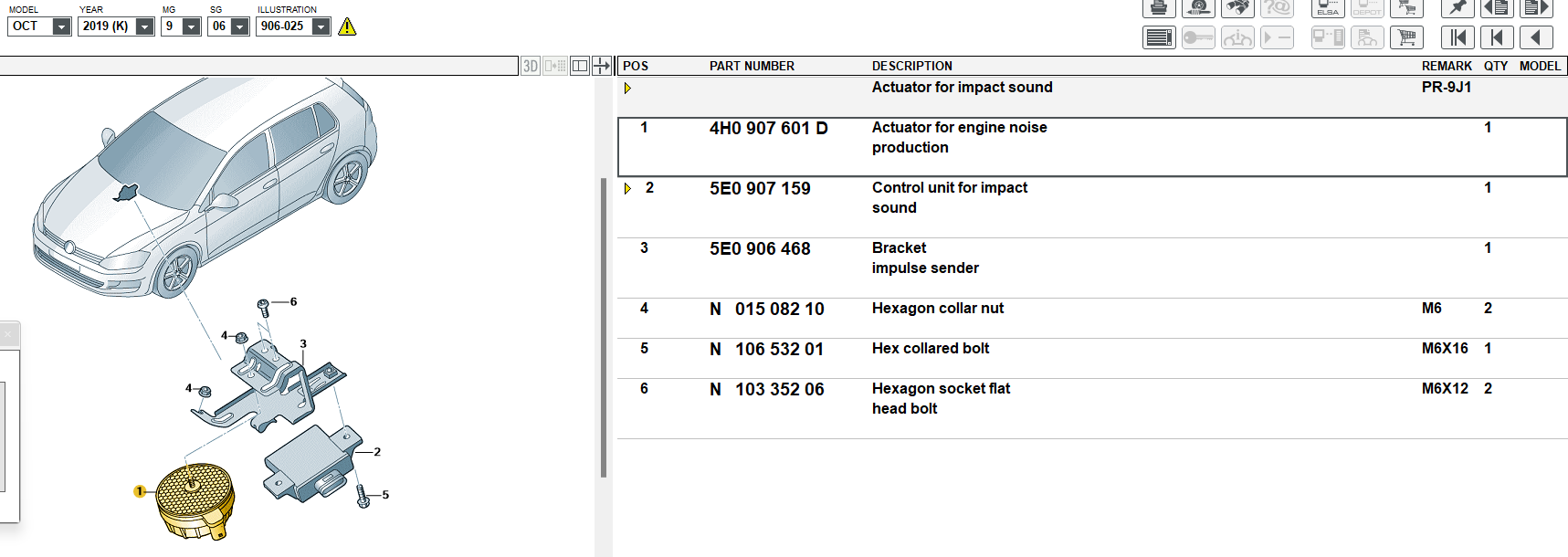

This might be the code also, if it's not the one @langers2k mentioned 👑
PRCode: 9J1 = Supertone system and tone sequence control

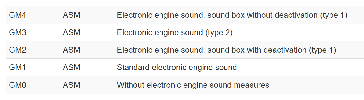

I have code "GM1" and the description I have is "Electronic engine sound measures: Standard electronic engine sound".
That suggests my car produces fake engine noise, though a "standard" fake noise, not a sports sound.
I'd be slightly confused, but not entirely surprised if my car has a fake noise generator, as it does make a slightly odd rorty sound on the rare occasions I give it some welly, which sounds slightly unusual.
I assumed it was just how the car sounds when you boot it, not an electronic noise. It's not intrusive, in fact it's oddly pleasing. But I could live without it.
I've never heard the sound outside the car, so I've no idea how it sounds to the rest of the world, assuming they can hear it.
A little research and it turns out there's a few of these codes: https://vag-codes.info/

Here the the 9Jx series then for completion sake, I did suspect there would be a range for them.
9J0 STA Without supertone system and tone sequence control
9J1 STA Supertone system and tone sequence control
9J2 STA Super-tone system and tone sequence control preparation
9J3 STA Supertone system and tone sequence control without city horn circuit
9J4 STA Tone sequence control preparation for Police
9J5 STA Supertone system and tone sequence control

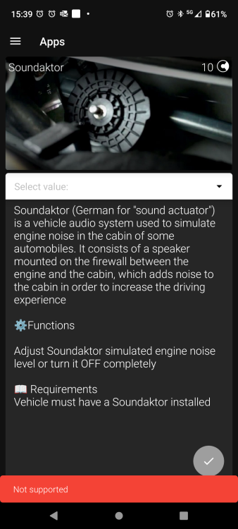

"Not supported".
Well now, isn't that peachy. 🙄
I'm hesitant to get into long coding as it seems my vehicle is quite an unusual variant, so I'll have to keep researching exactly how to turn the fake noise off.
Not that it's a huge problem, but now it seems I can't easily change it, of course I want to change it all the more. 😄
