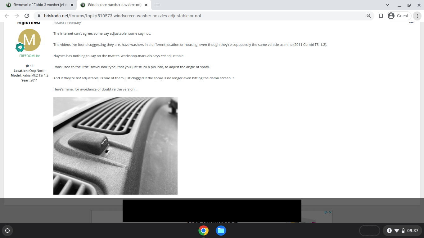

There is a thread in the past week in the Fabia MK3 and MK2 section covering 2 types of nozzle removal.  Are they just the twist type.  Vids in the threads or on YouTube.  Are they the kind that is blocked you just replace for a few Quid each?
Not sure which types the Fabia have, I've seen videos on the twist ones, but those seem to be ones mounted in the bonnet itself, whereas mine are mounted on the main body of the car.

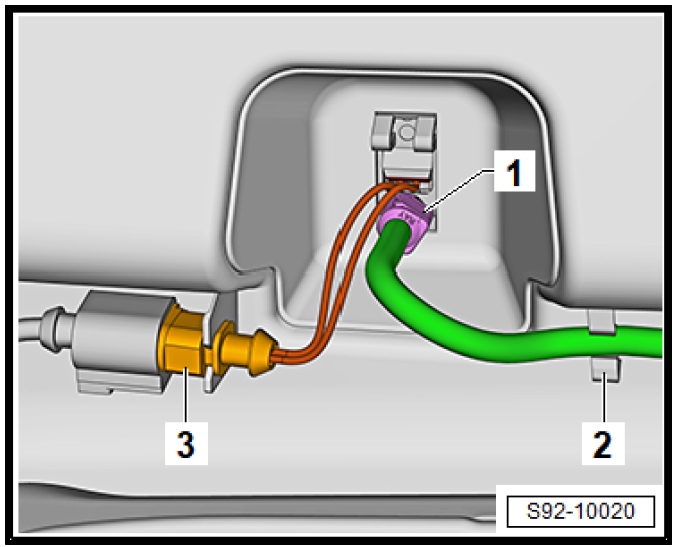

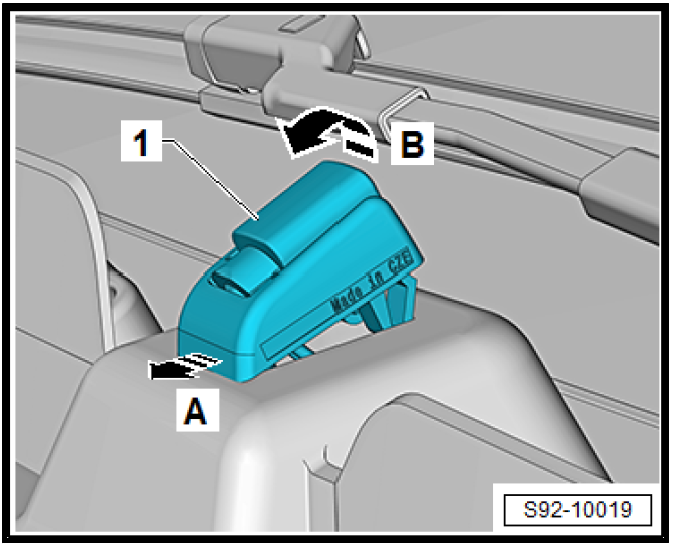

2.5 Removing and installing washer jets
Removing
– Support the nozzle -1- in the direction of the arrow -A- and
swivel this out in the direction of arrow -B- and partially push
it out.
– Unlock and remove the hose connection -1-, the hose remains
in the holder -2-.
Removing
it out.
in the holder -2-.
Amazing, will give this a try later!

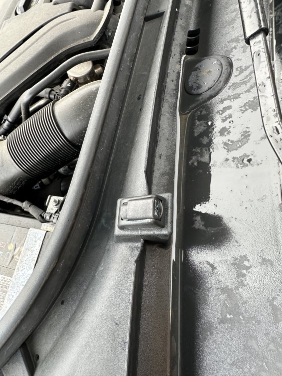

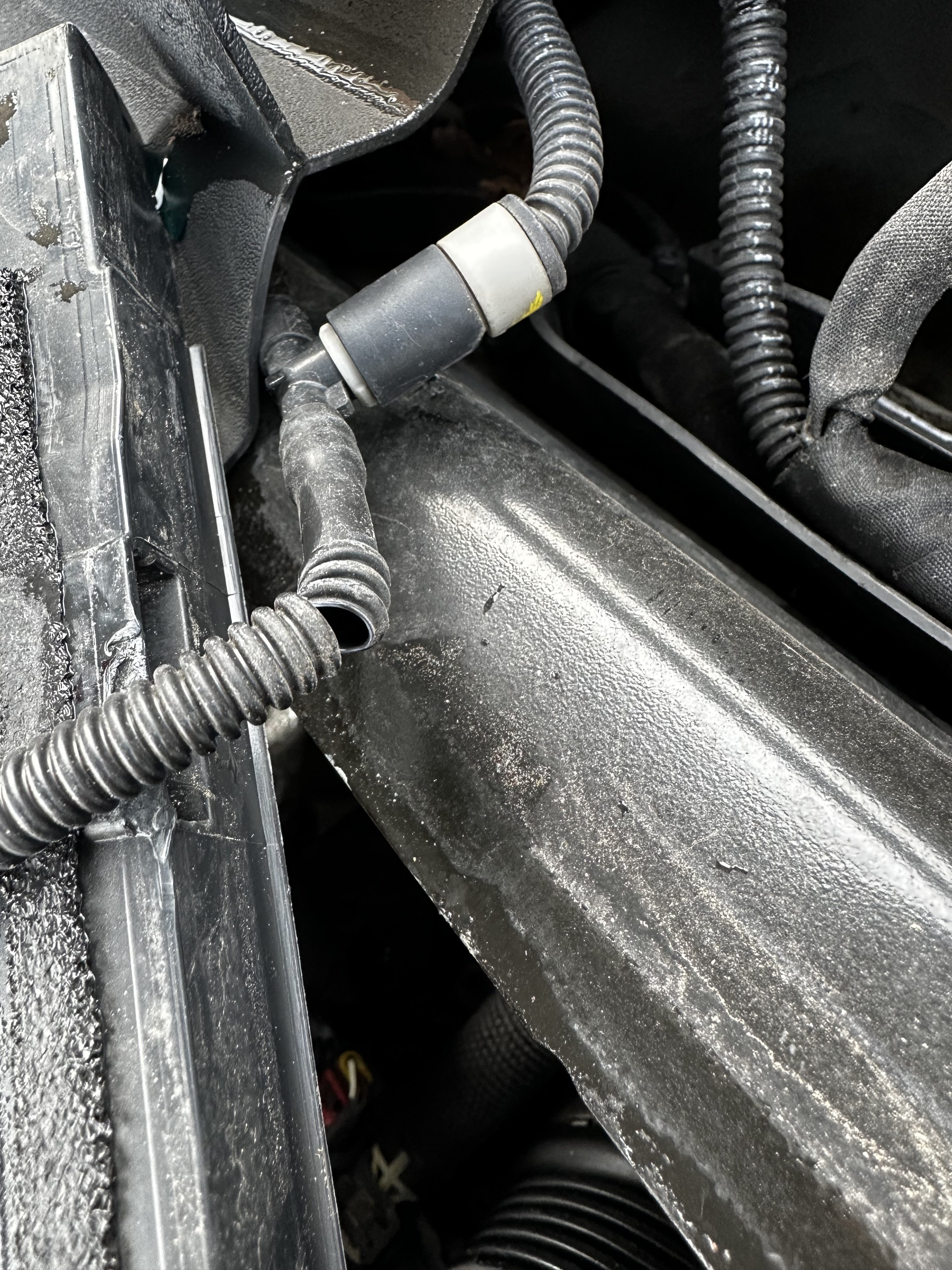

This was my issue. Easy access underneath the windscreen. IMG_5497.thumb.jpeg.b446b0b5fe84e8292b10c3a0da2b1b99.jpeg
Good to know. I would assume in your case it was only the front screen washers that didnt work.
