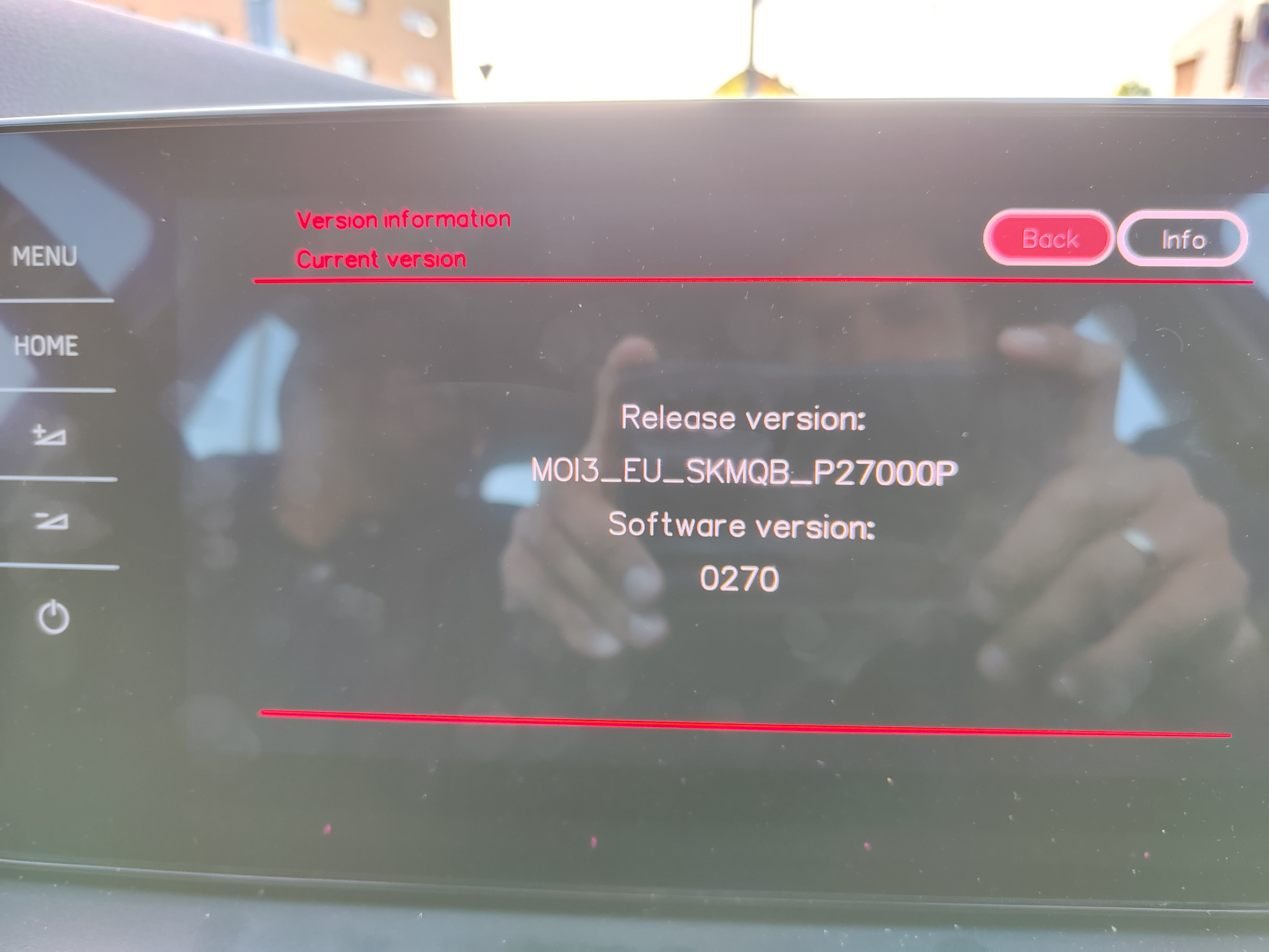

On 19/05/2023 at 12:20, Giuseppe82 said:
ThanksHi ,I have a Skoda scale my2019 with h12 ,currently I have software MOI3_EU_SKMQB_P27600P_MU0276
I know there is version 0306 or newer, where can I find it?
Thank you
Mah I don’t have bolero but admudsen

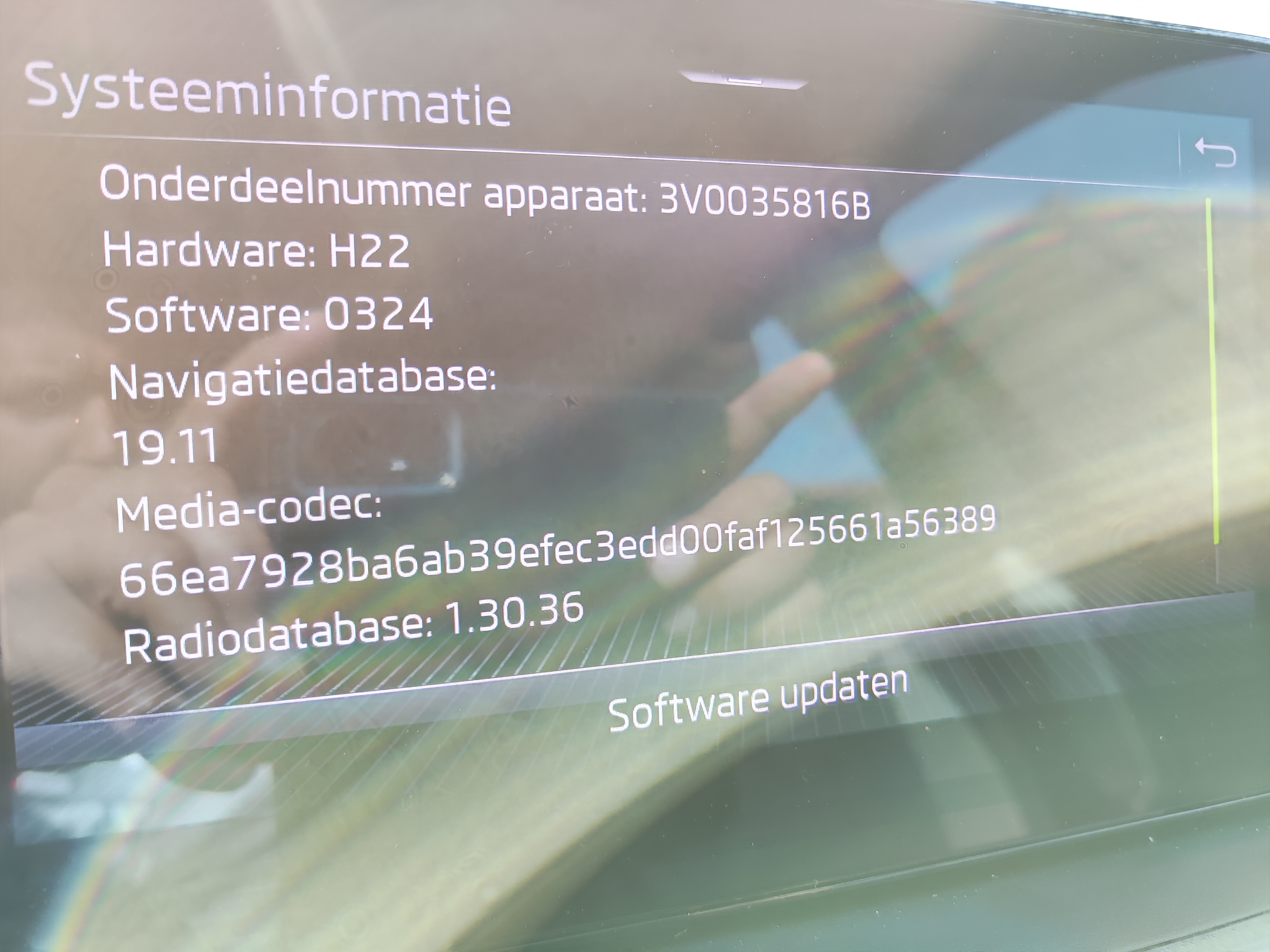

324 is the latest. Is a two stage update to 324.
You have the 324 version?
yes i have it
but the Skoda version? could you turn it around?
Yes Skoda version. What do you mean?
I thought you had the Volkswagen version
Have you noticed any differences or improvements?
I also have the VW version. Yes faster and more responsive
could you send me the file? I would be grateful
No unfortunately not yet. Maybe @varooomcan sent it to you

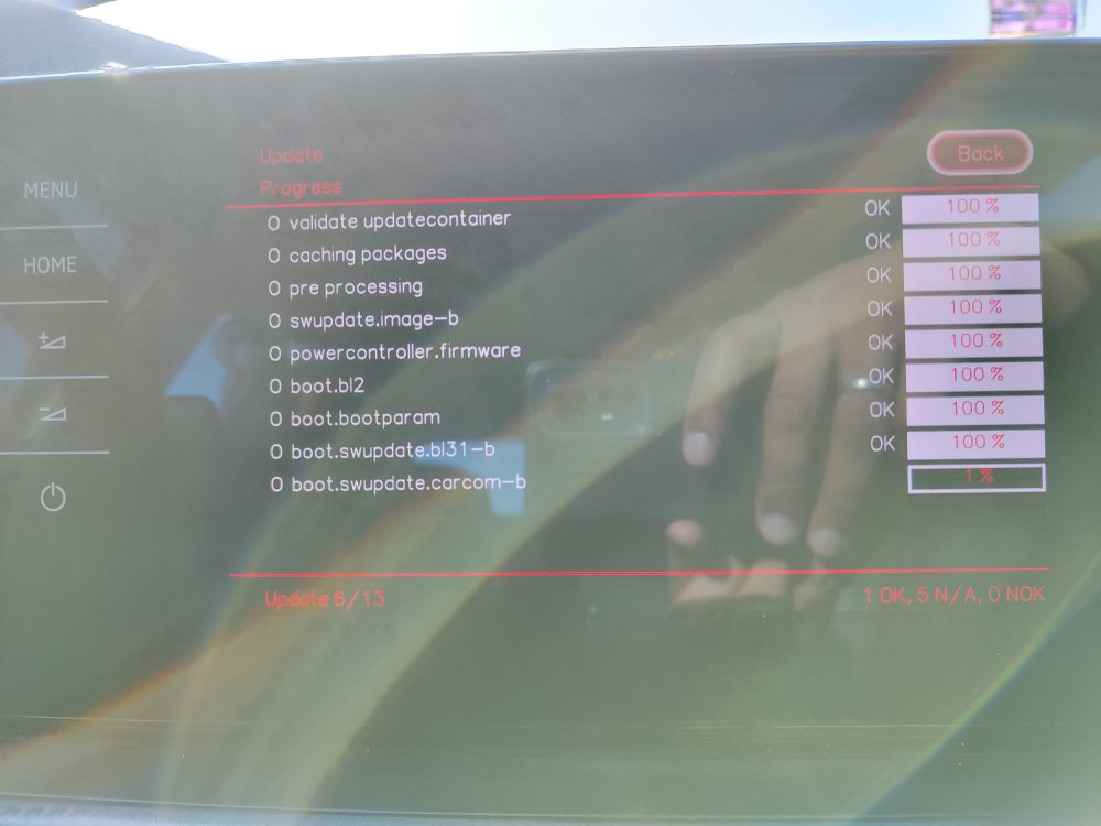

I have the files, but remember you could break your system @Giuseppe82
So please let me know here if you still wish to try this out...
So far no problems after updating from 270 to 324. Done several cars
