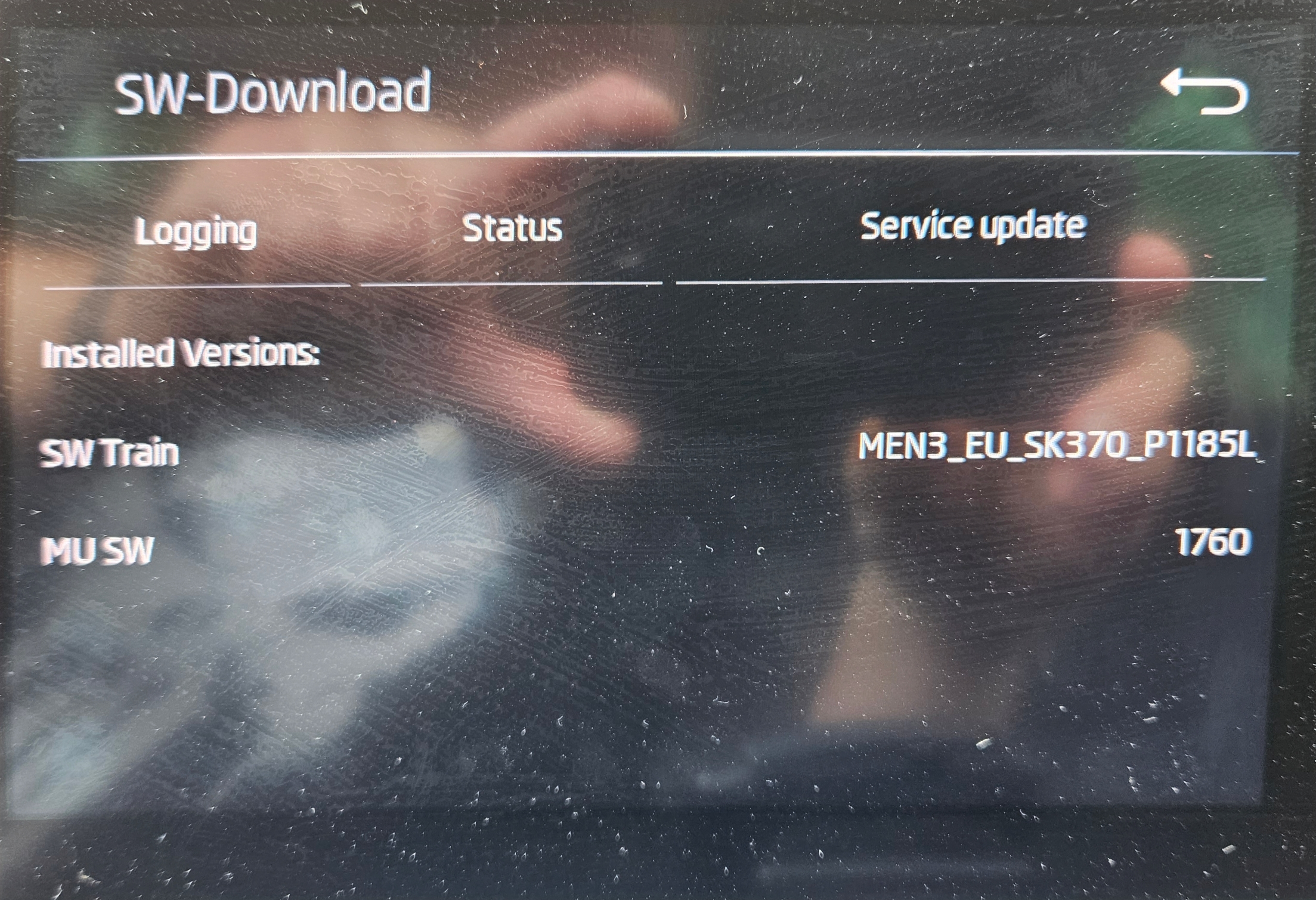

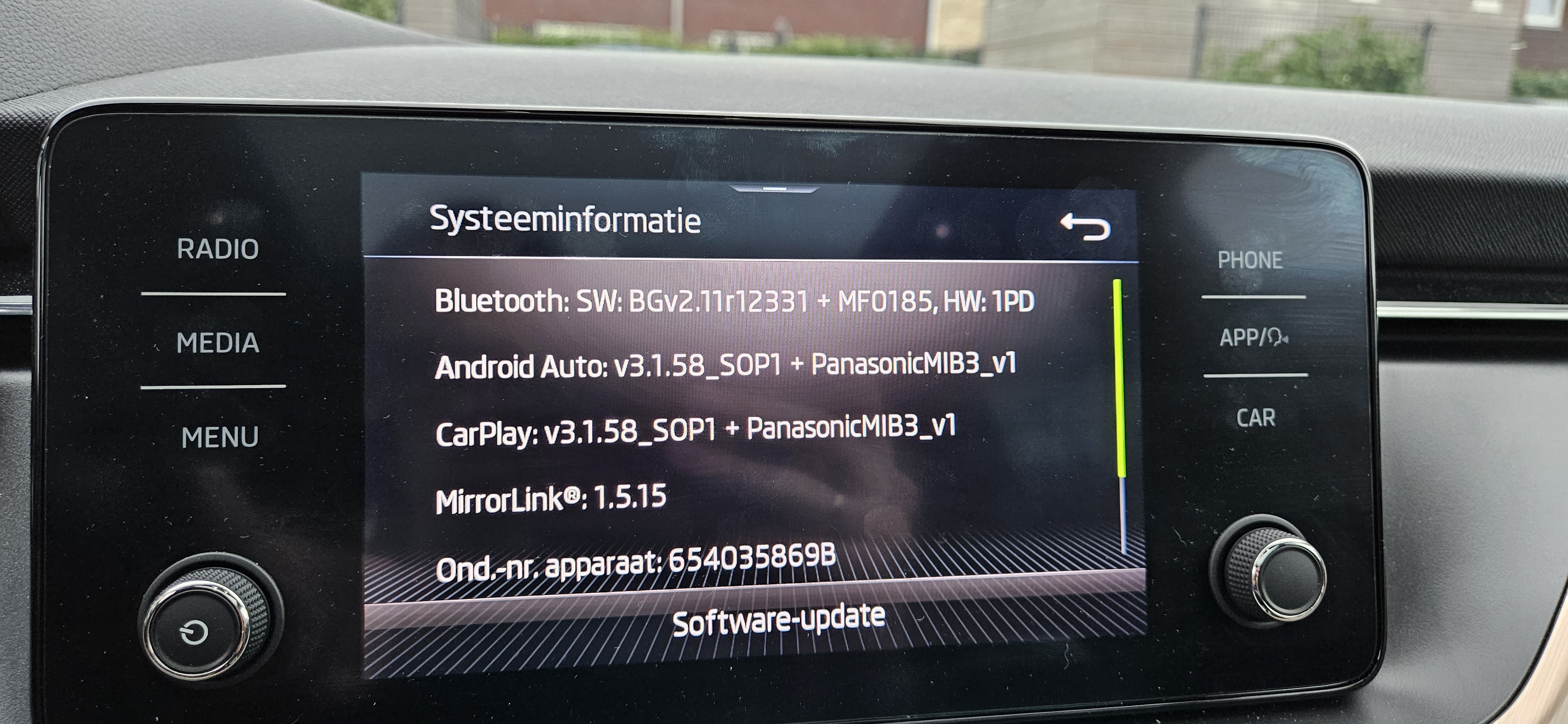

Hey dear varoom,
I have kamiq 2023 with bolero system my current versions are in the photo attached to this message.
I have a problem connecting my oneplus 11 to the android auto can you help me find a software update that might help

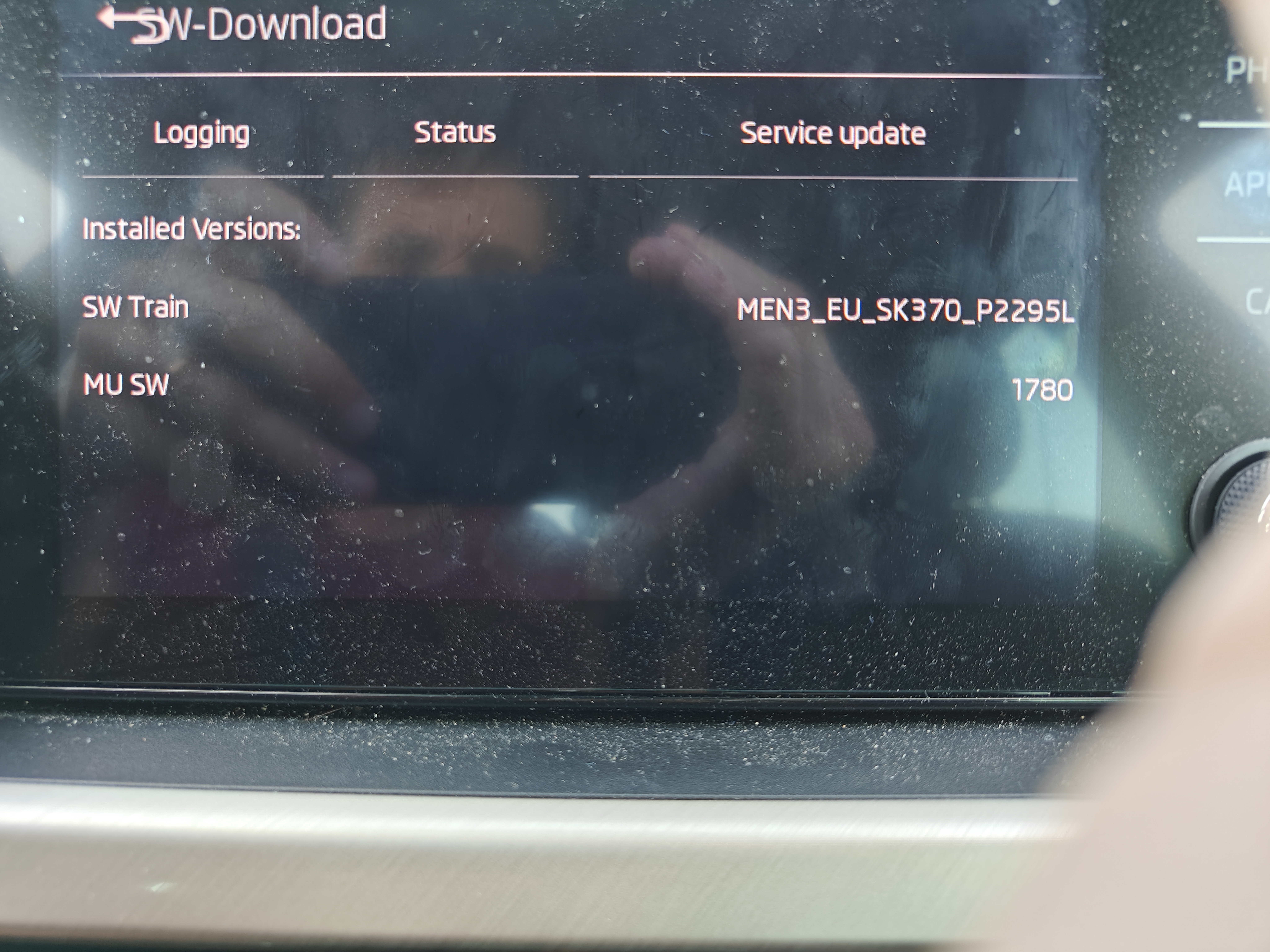

    I just updated to 1800, I have a Skoda Slavia in India with the Bolero system. I can confirm that the issue with S23 Ultra is finally resolved! Attaching images.

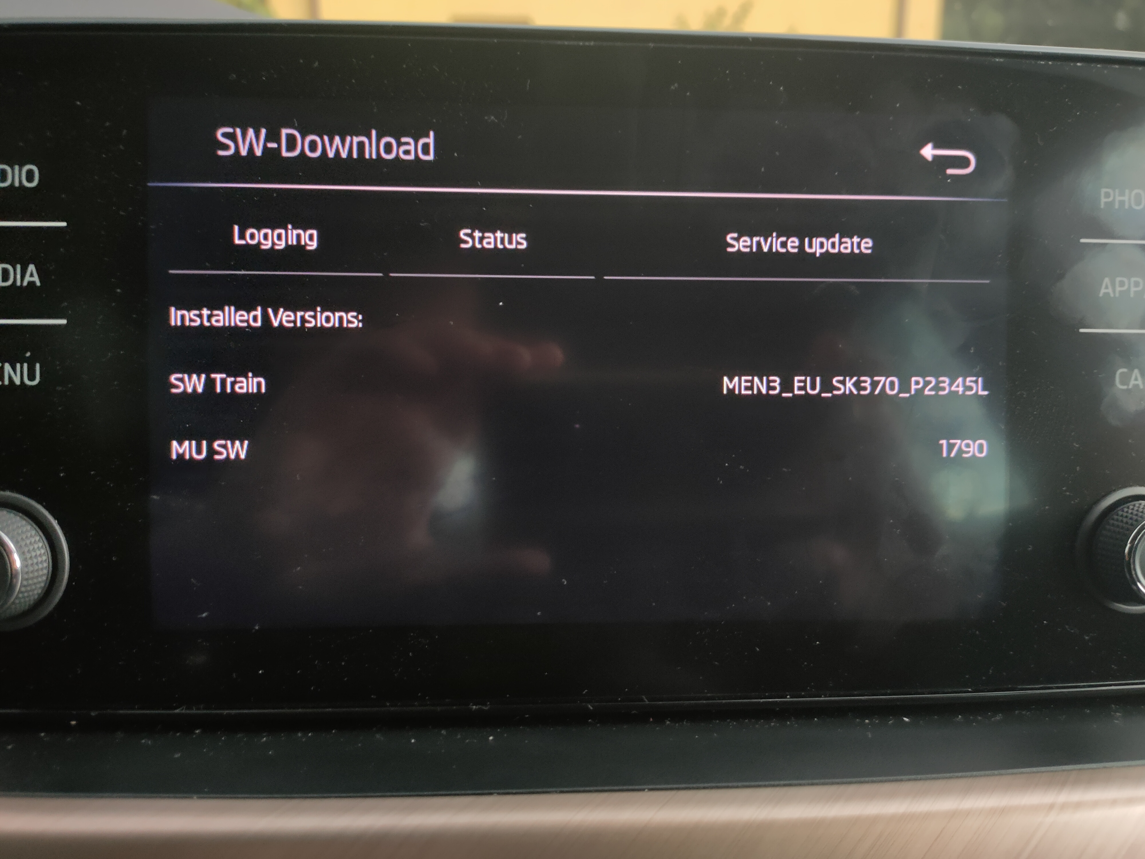

Sure, these two are available for you to try and use, will send by Private Message
MEN3_EU_SK370_P2345L_1790
MEN3_EU_SK370_P3225L_1798

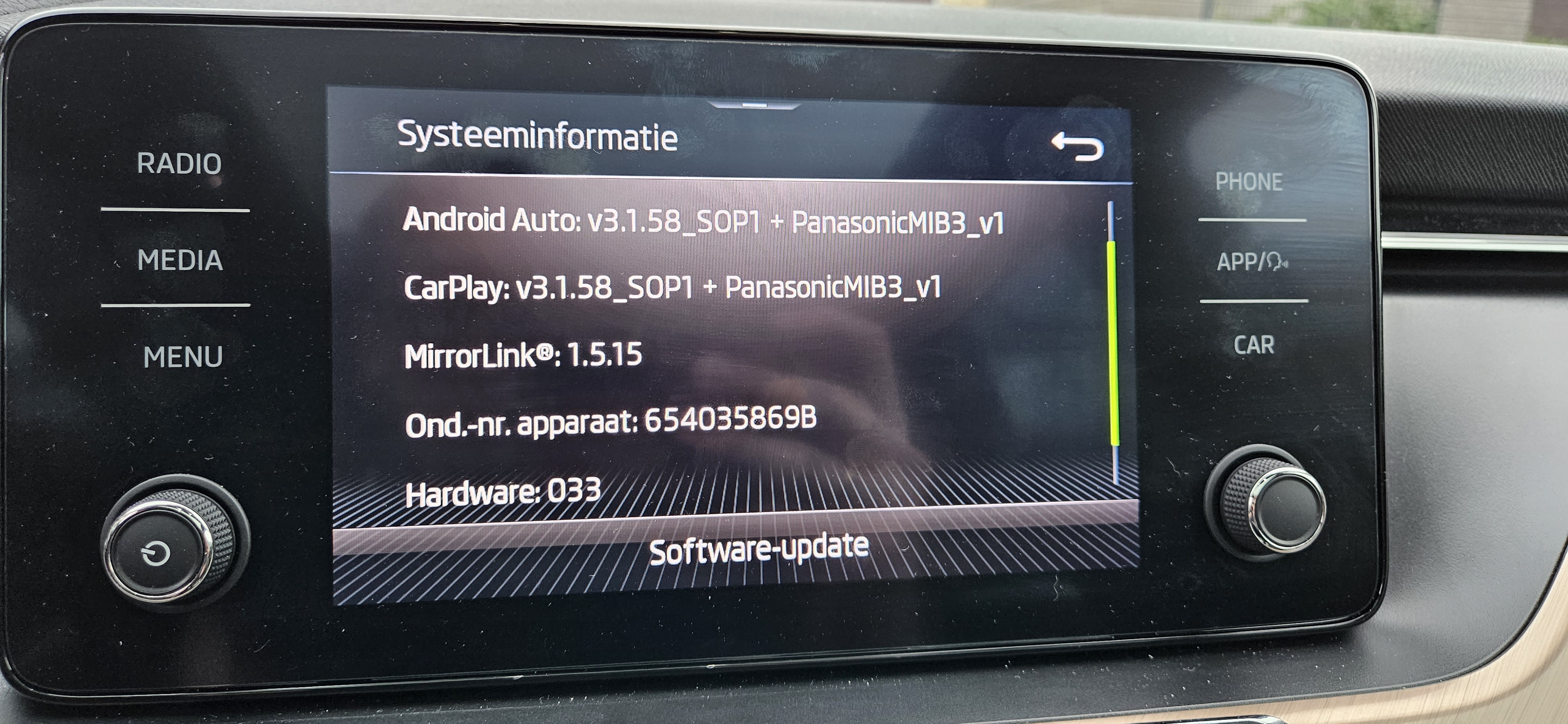

Can somebody check the VC software version for me? In the update menu you see something like KI_654xxx or a different number.

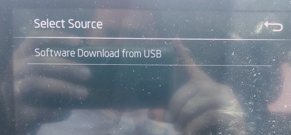

So guys, those of you who made it, did you have issues with car not reading USB stick? I have a USB type-c stick, I plug it in the normal USB type-c plugs, but when in the menu and in the service update, stick is not offered as an option to select it.

My car wouldnt recognize the usb stick, fixed it by making a folder named the same as the update, and copied the firmware folders into that folder
Yeah, I tried that as well, but still did not work. I suppose I could try again.

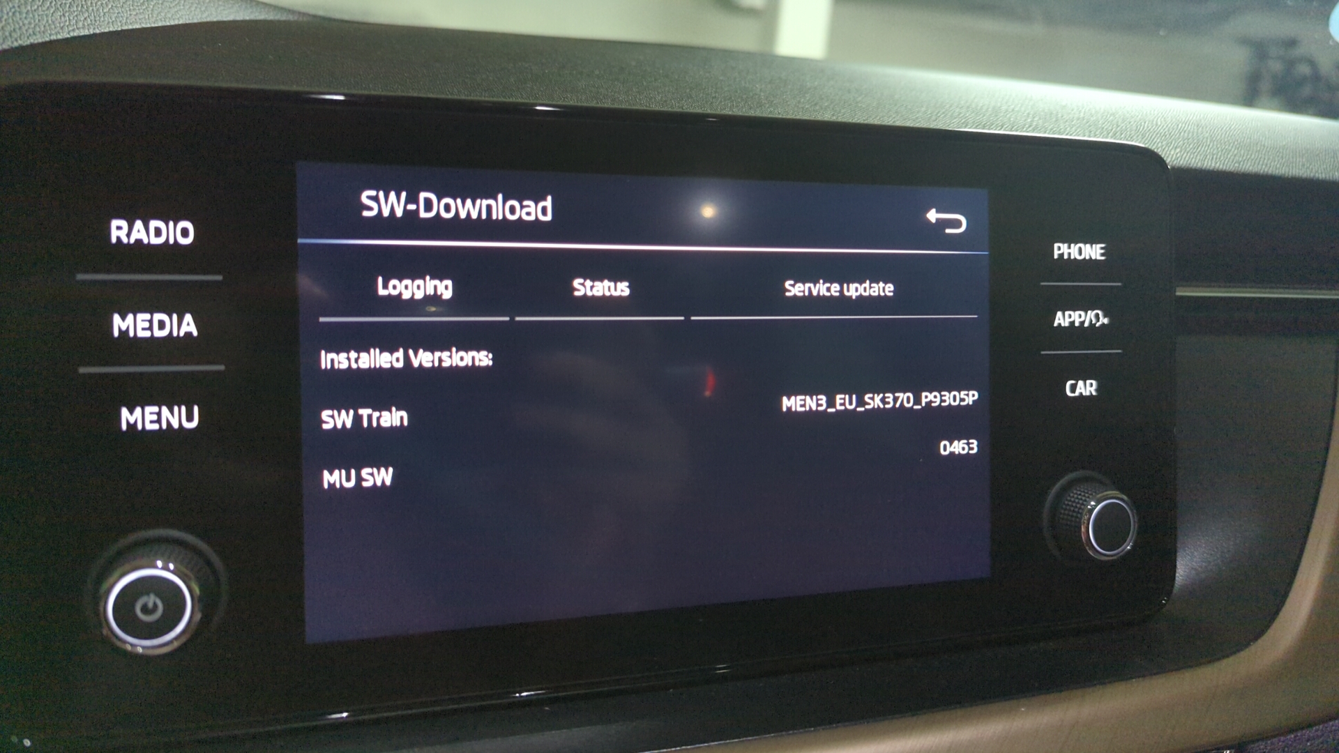

Hello, I have version 0463 from what I have read to you I need the MEN3_EU_SK370_P0113P. Am I correct? Could you pass it to me? Thanks!

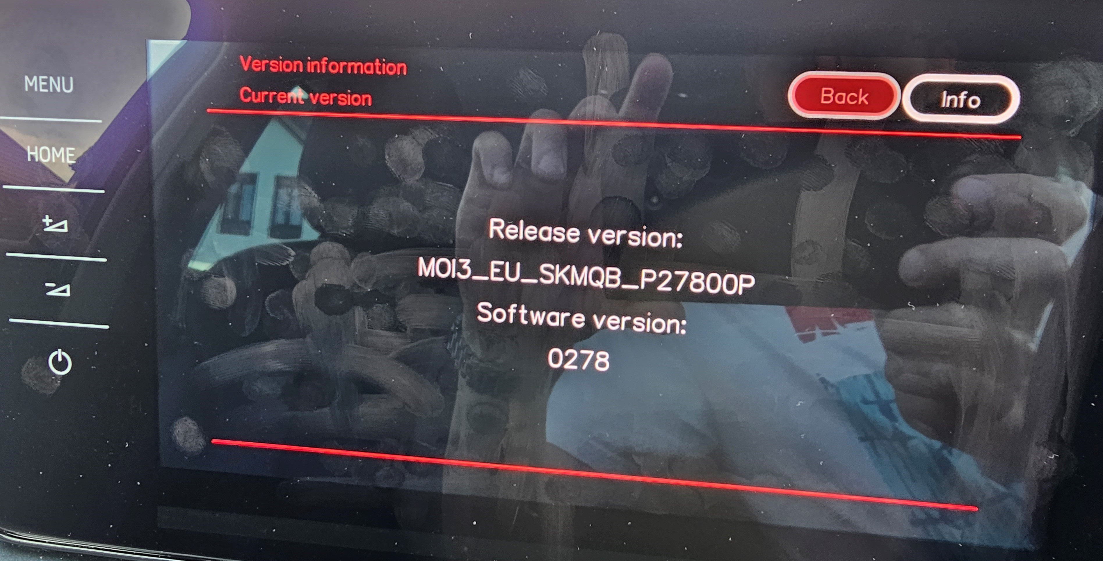

Hello,
The current version train for my Scala 2022 is attached. Is there a newer version and what should I do to install it?
Thank you in advance.

Please can somebody share the latest update for a 2020 Scala. I believe it's MOI3_EU_SKMQB_P30603P. Thank you!

Hi. Did You tried with USB disk formatted in FAT32 file system? I checked that my radio does not recognize NTFS and exFAT but FAT32 is visible.
I actually wanted to try that as well, but w10 does not have fat32 natively so I did not.
Since the car is still under warranty I have a scheduled service to update it in the garage so we will see after that.
Just use a smaller usb. Till 32gb you can format Fat32 native
On 13/07/2023 at 17:37, indyjones said:
Excuse the the finger print marks ! :)
All updated to P32400P, still will not let me change the lock settings.. I am preferring MIB2 at this rate!
Set adaptation channels in 5F
