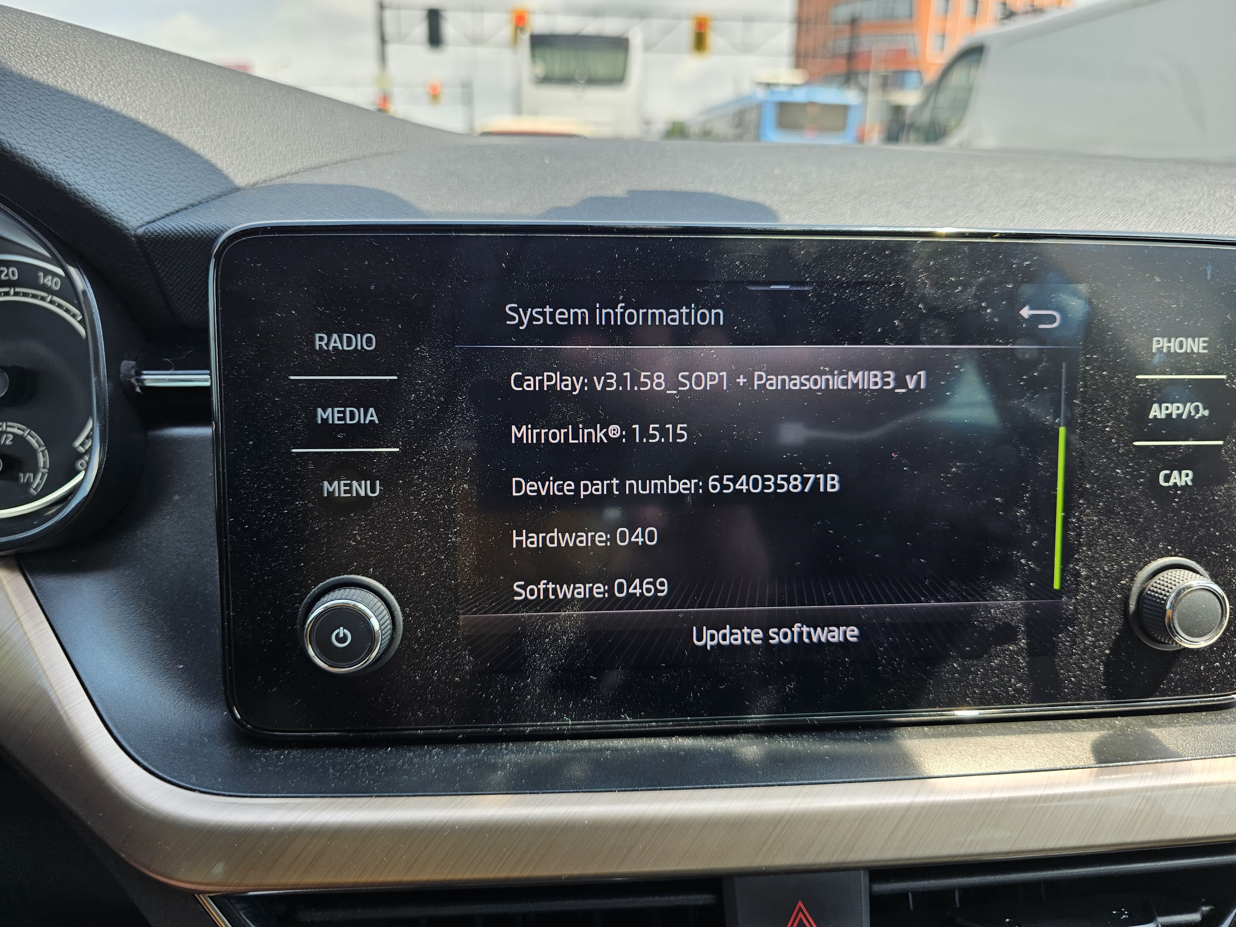

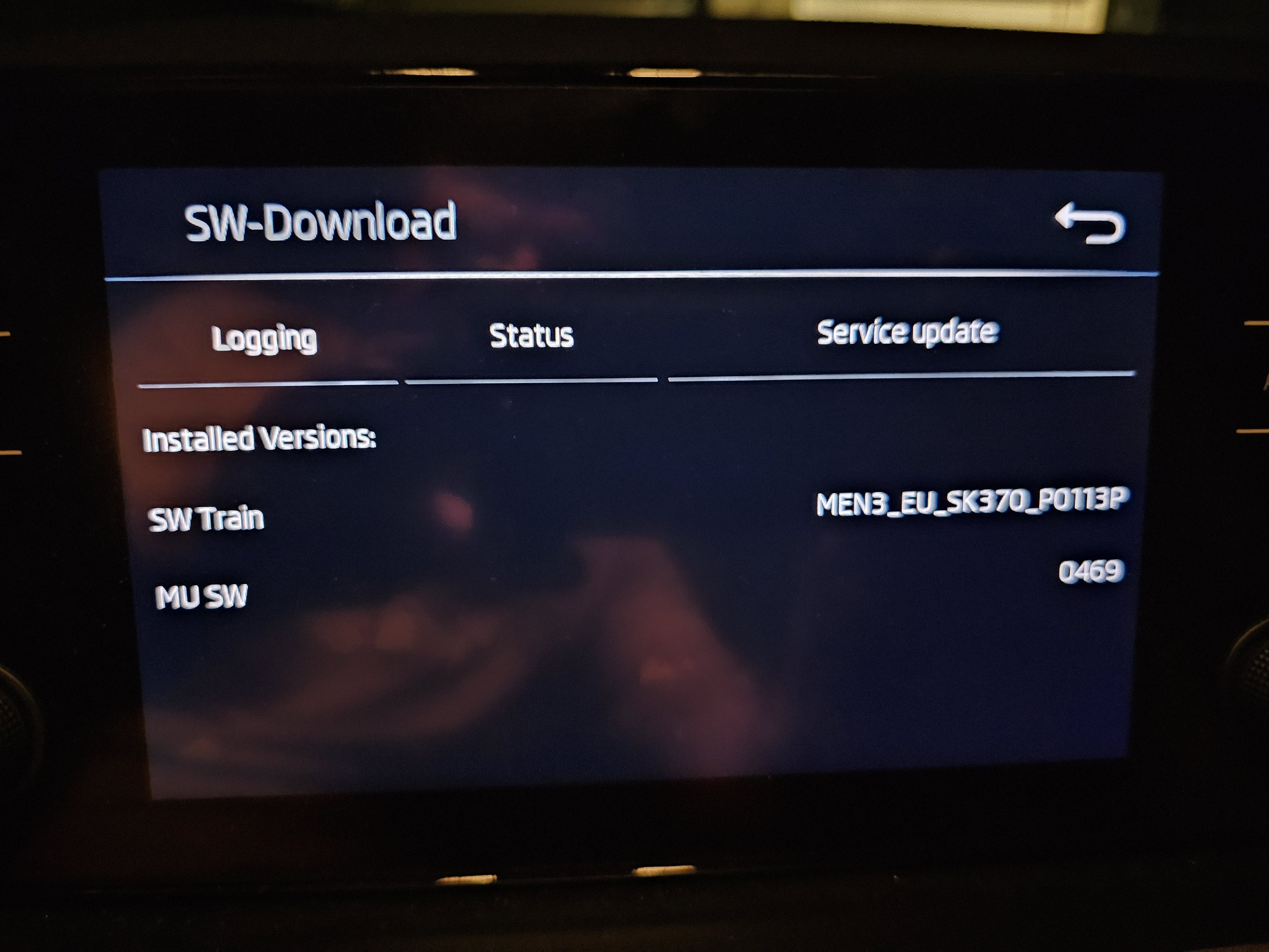

hello I have 2020 scala sometimes the screen does not turn on for days I have the bolero 0469 version which version should I update it please help I am writing from Turkey

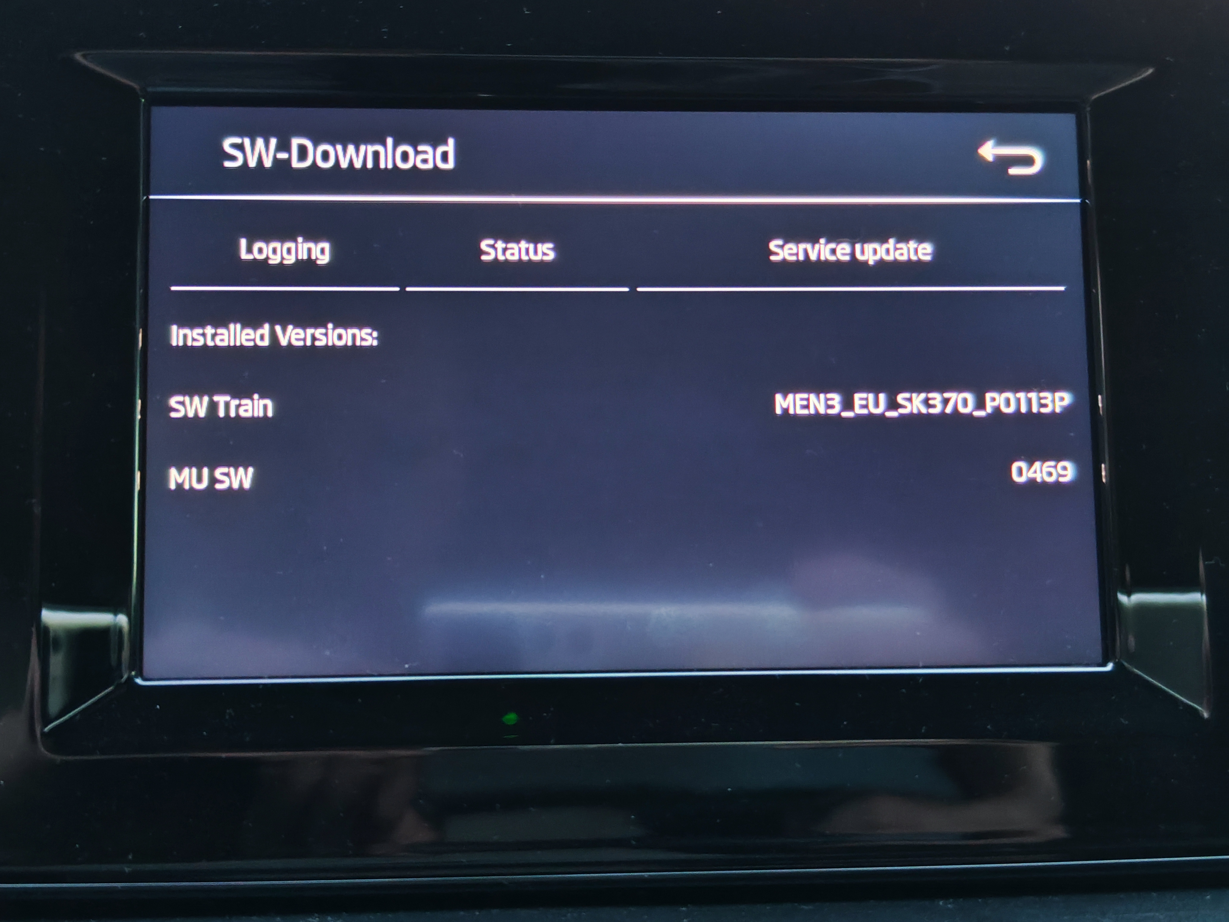

@Asimozari Check this page, see if your Software Train matches this image.
Software Train
MEN3_EU_SK370_P0113P
SW: 0469
thanks, I understand that I need to start from 0742 to try, if so, can you send me this update?
my multimedia sometimes doesn't open, the screen stays black, I wonder if I reinstall version 0469 first, will it fix it?
0741/0742...
I will send you some updates to try.

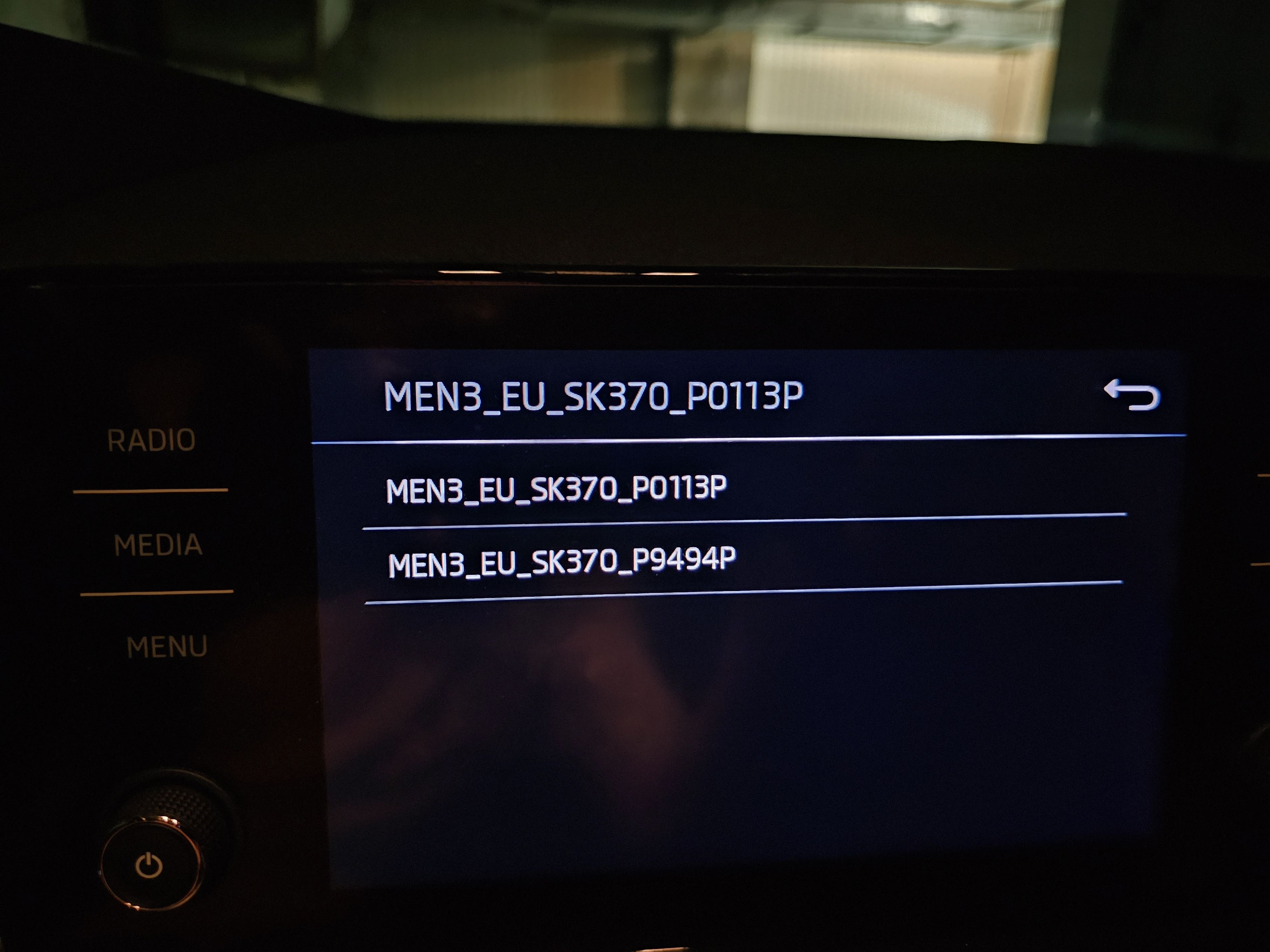

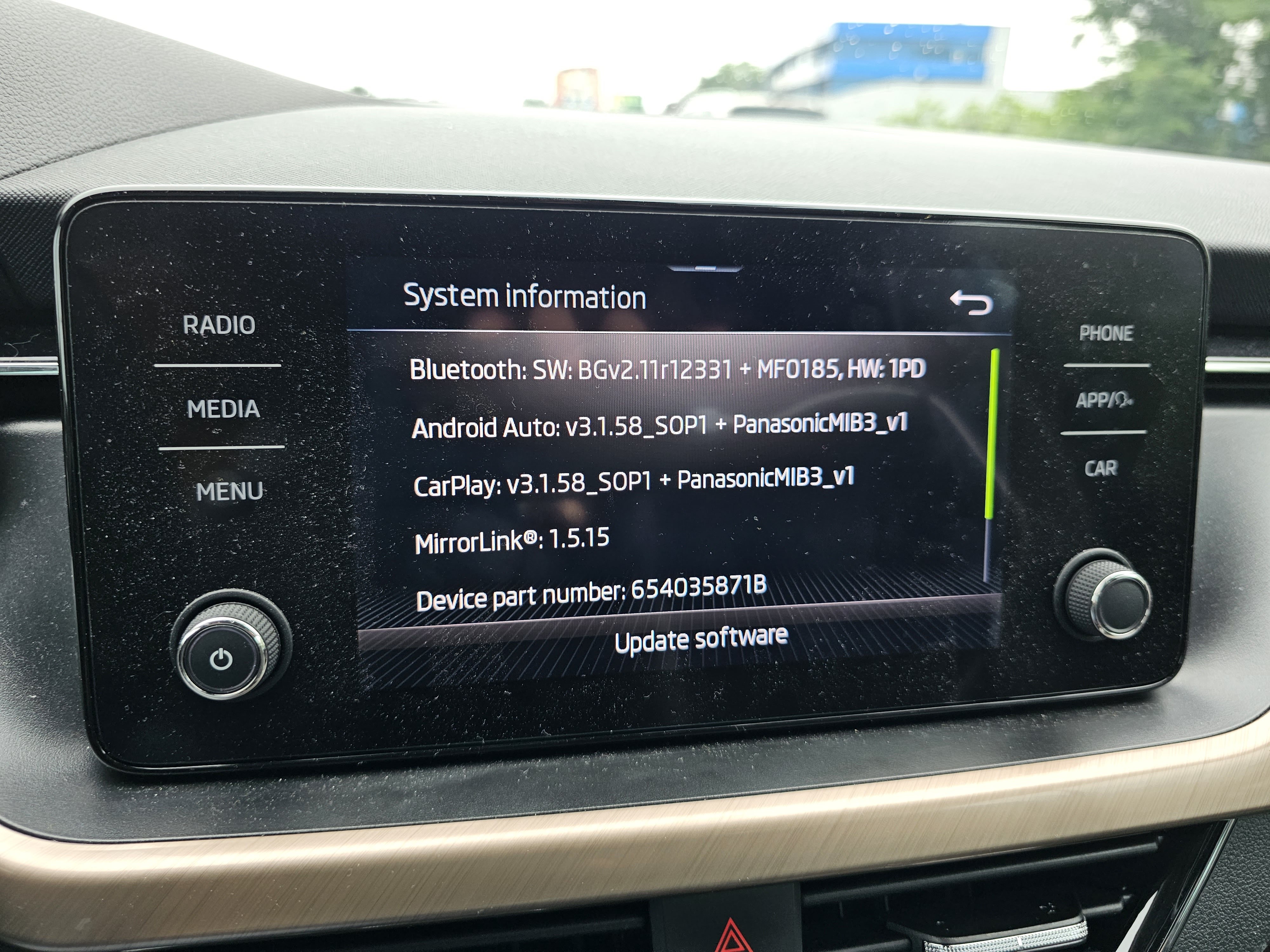

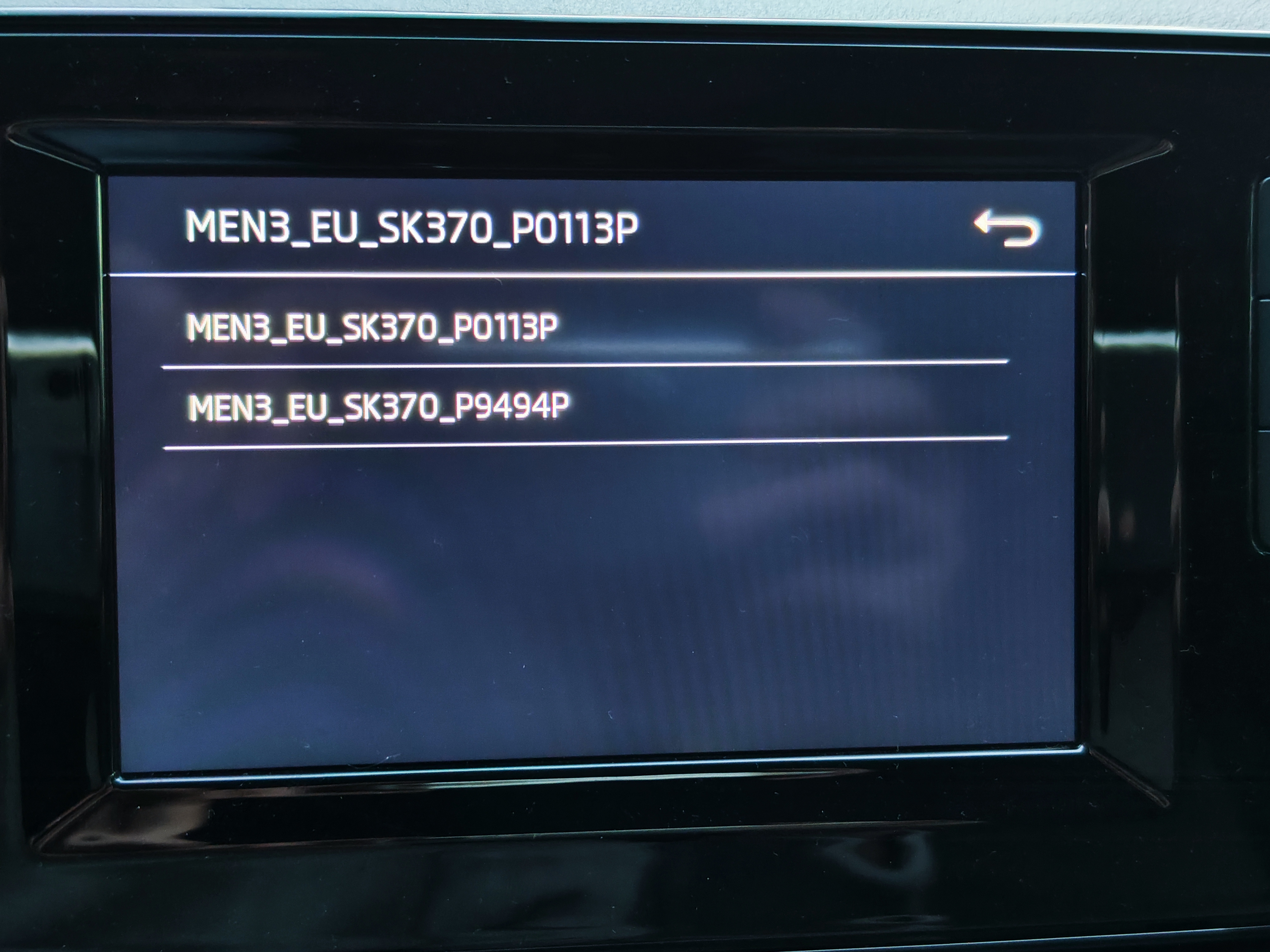

Hello,
I have a problem with my Skoda Kamiq's Bolero infotaintmend. I just bought a Samsung S23 Ultra and it fails to connect to my car. I tried multiple cables to no avail. I also tried multiple versions of Android auto - no dice.
My previous phone - a Samsung S20FE works flawlessly (even wirelessly).
Maybe the software of the infotainment needs an update? I am attaching images with all the versions as I'm not sure what is most important.
The SW Train is: MEN3_EU_SK370_P0113P (also seen in pictures, but I wanted to add it as text to help if someone needs to copy it).
@varooomIs it possible to update to a newer version to maybe solve the problem I have? Someone else posted about a similar issue, but I don't see a response if that worked.
Also,  I took a photo of the Logging section and there are 2 logs. Does that mean that the car's software was updated already at least once?
Thanks in advance.

MEN3_EU_SK370_P9494P = 0464
MEN3_EU_SK370_P0113P = 0469 (current)
I can send you some updates to try and load, won't know if it will make you S23 work, but worth a try.

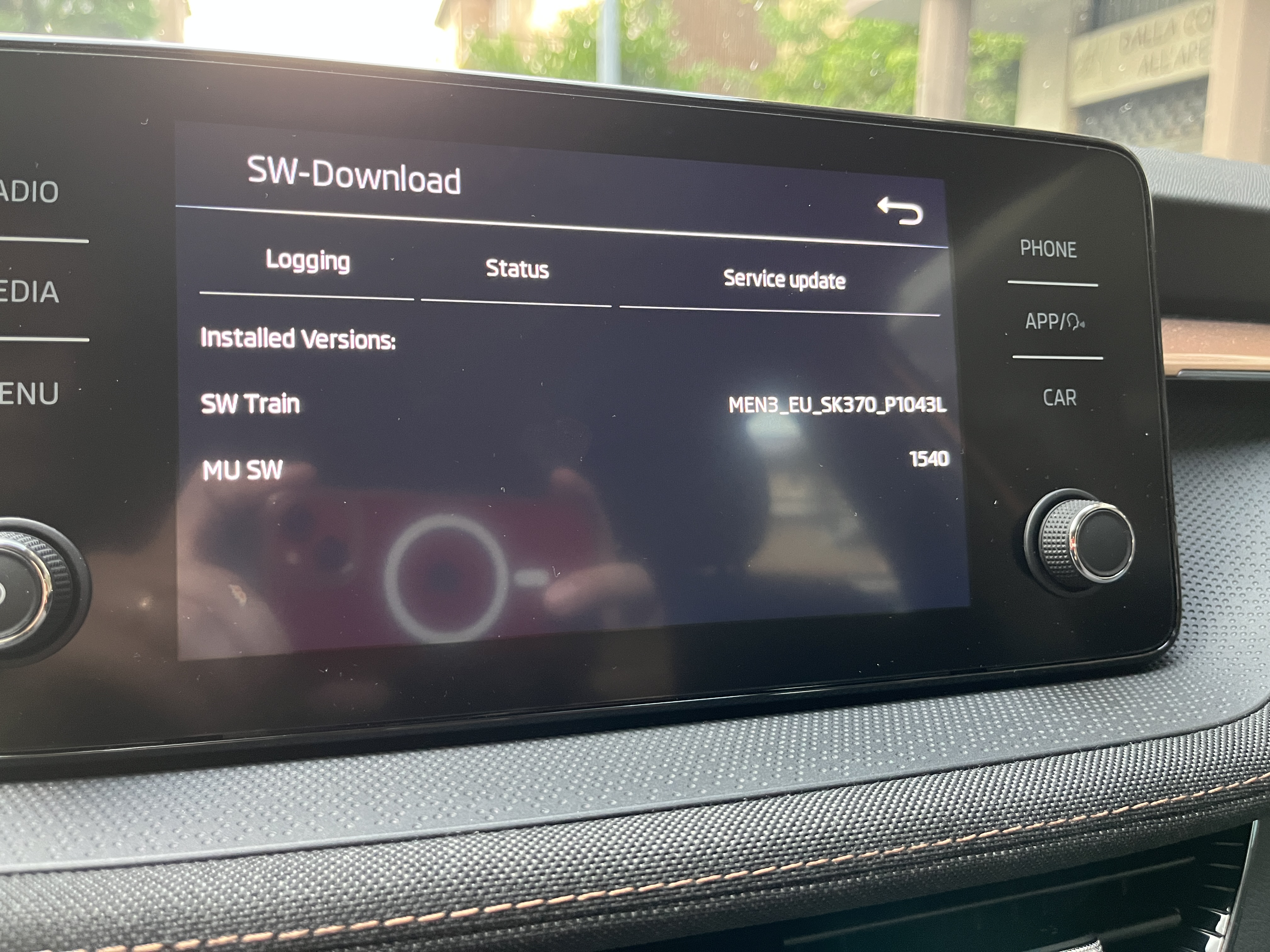

For the attention of @Rainesh I think I have sent 1760, 1790 & 1798, for them to try.  But none will load (but I have not seen 1540 version before)
