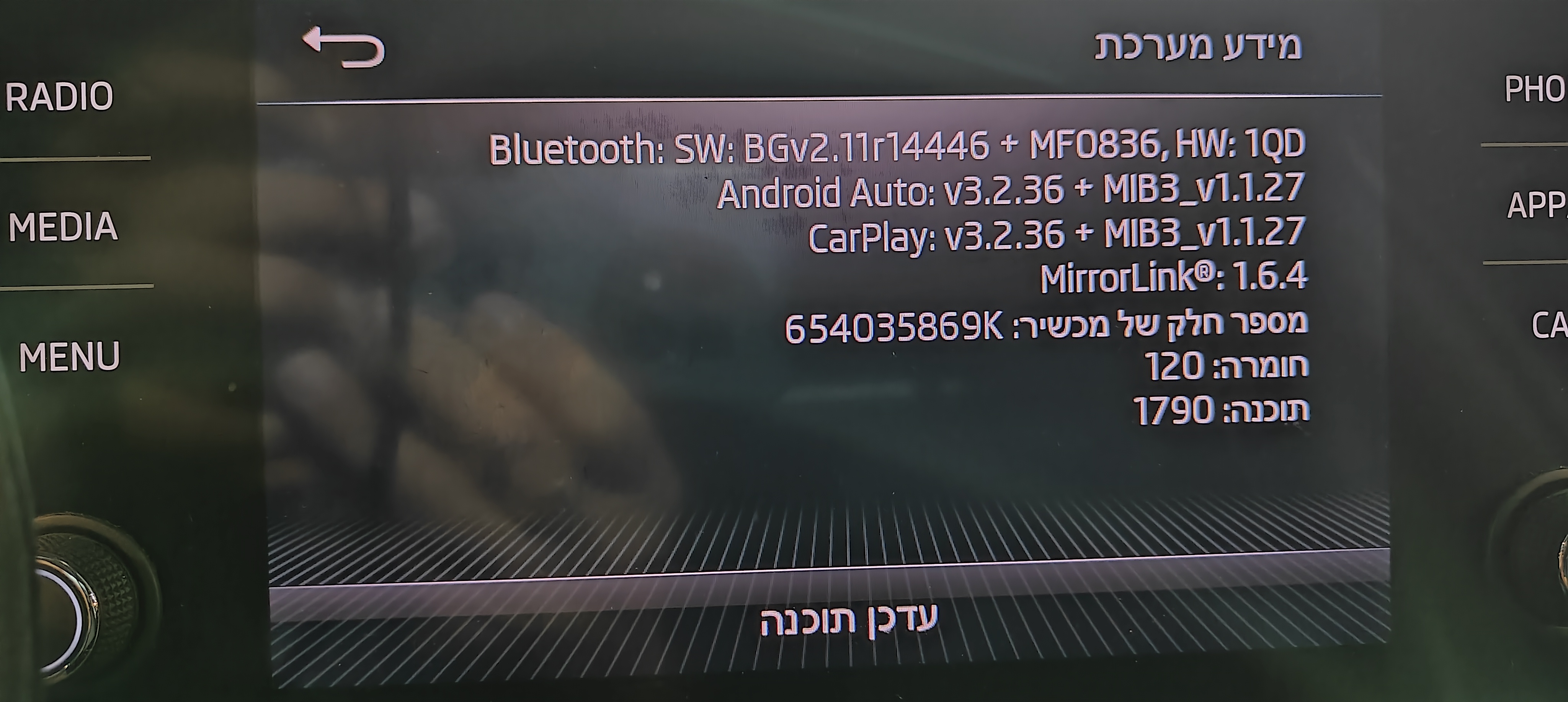

Hello everyone.
I have the same problem as most people that replied to this thread.

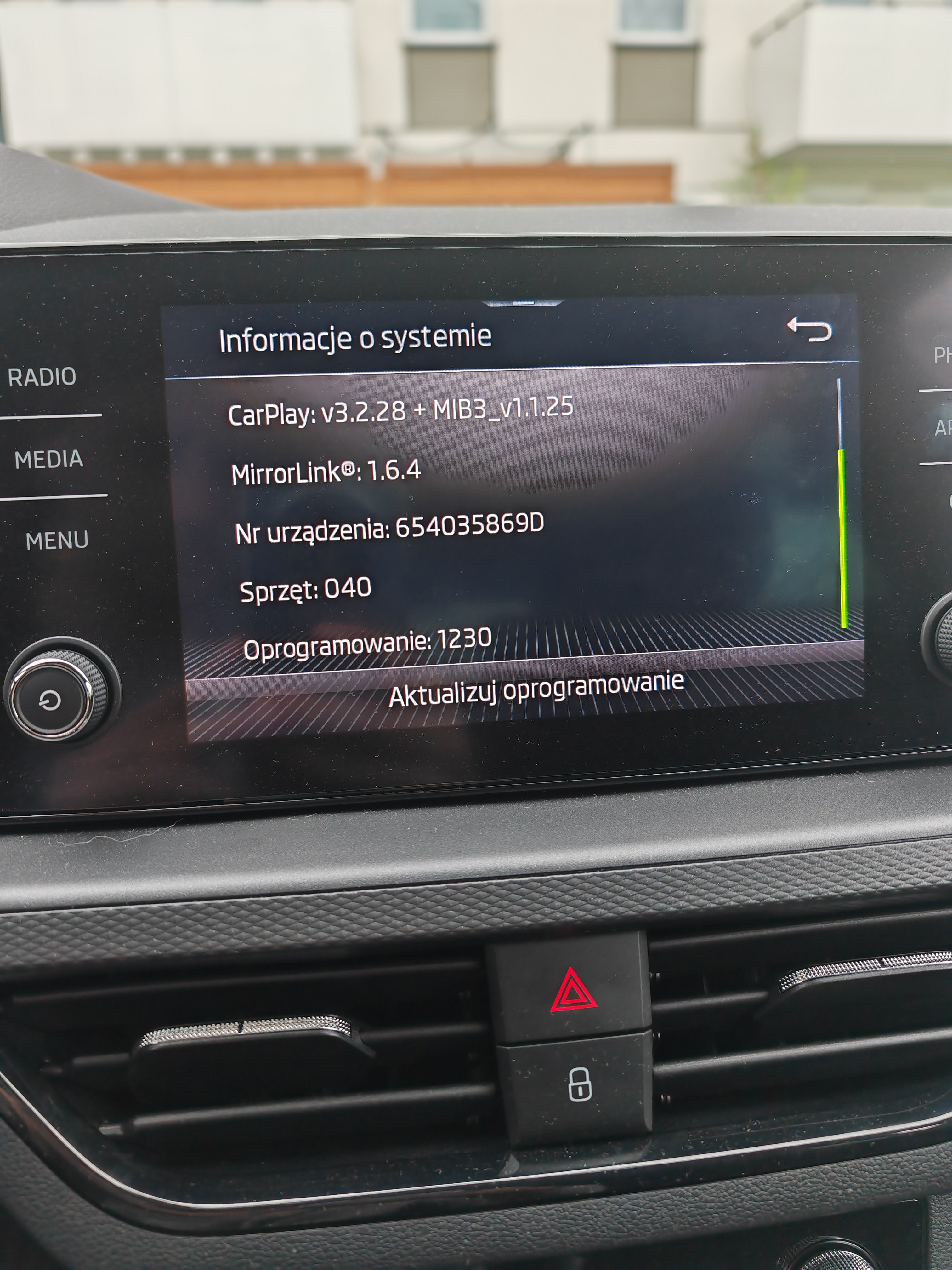

Skoda Scala 2023 with the Bolero infotainment system.
My phone is OnePlus 11 5G and as you can guess AA is not connecting.
Attaching a screen shot of the tech details.
@Rainesh
Can you please send me versions 1790 and 1798, I'll try upgrading, if it wont help I'll just revert back.
Thank you!
Nadav.

    I just updated to 1800, I have a Skoda Slavia in India with the Bolero system. I can confirm that the issue with S23 Ultra is finally resolved! Attaching images.

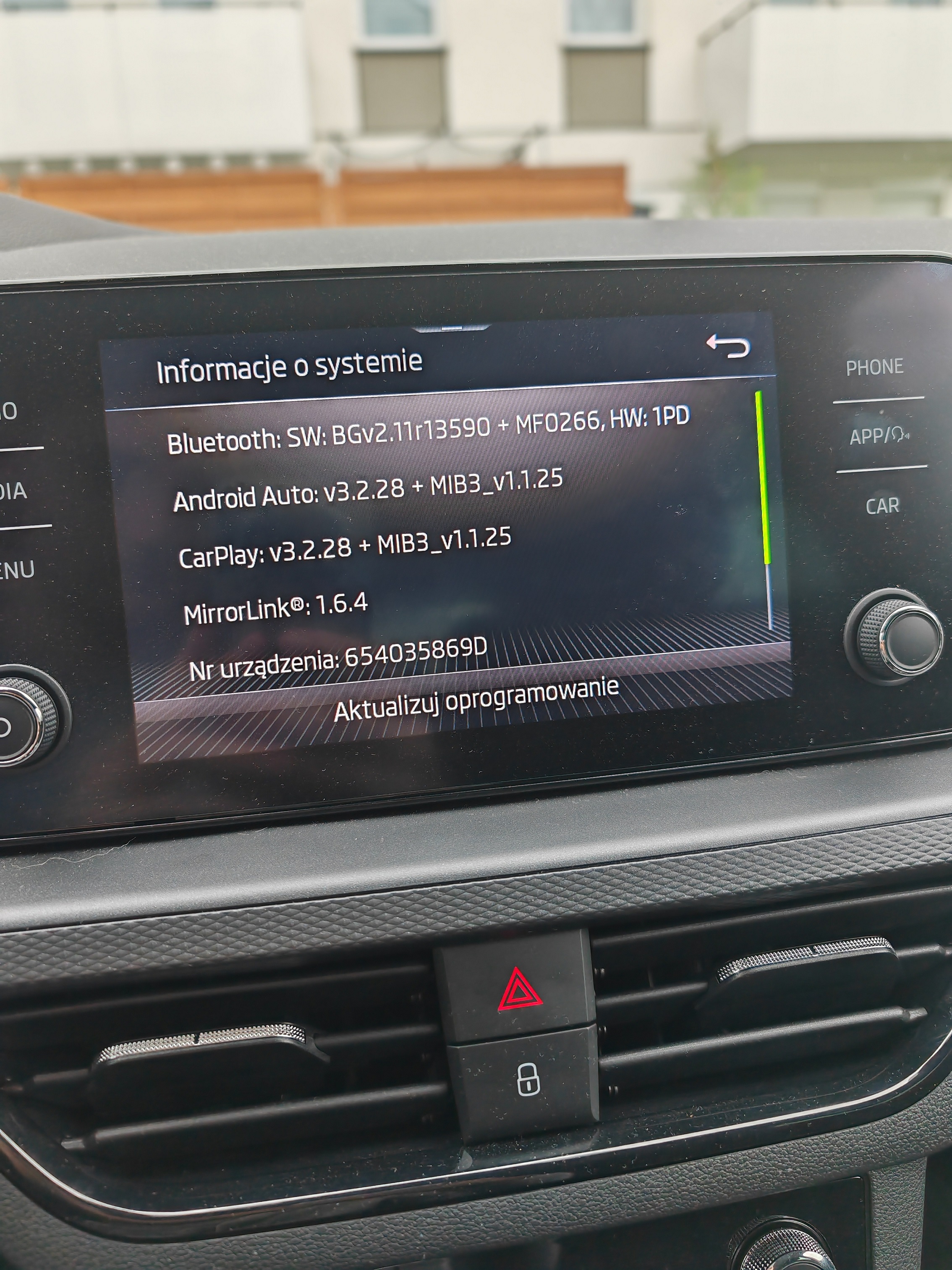

    Cześć, poniżej link do strony z opisem możliwych FW U Ciebie powinno pójść do wersji 742. https://www.drive2.ru/l/650934799095051499/

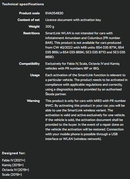

Everything went well.  My goal is to activate the wireless android car after purchasing the official activation key here:
https://eshop.skoda-auto.sk/sk_SK/smartlink-wlan/p/6VA054830B
I requested the activation of wireless WLAN in the official service.
Unfortunately, the activation was unsuccessful after several attempts.  The detected bug is said to be higher installed software 1798.
My car is from 4/2019 and this model has the latest official software 742.

How did you figure out that your CAR fulfill all requiremens?
There is also more expensive version and I found it only in Slovakia, Checz Republic and Netherlands eshop.
I bought my car in Germany and so I'm wondering if I could buy it online and go to official service in Germany to enable WiFi functionality on my car.

MIB 3 verified in the original car service according to the VIN.
On this basis, the system allowed the Wireless product to be ordered
6VA054830B
The order arrived for service and activation exclusively at an authorized Škoda auto dealer.
I was with the technician.  The radio enables activation, unfortunately, no success yet.

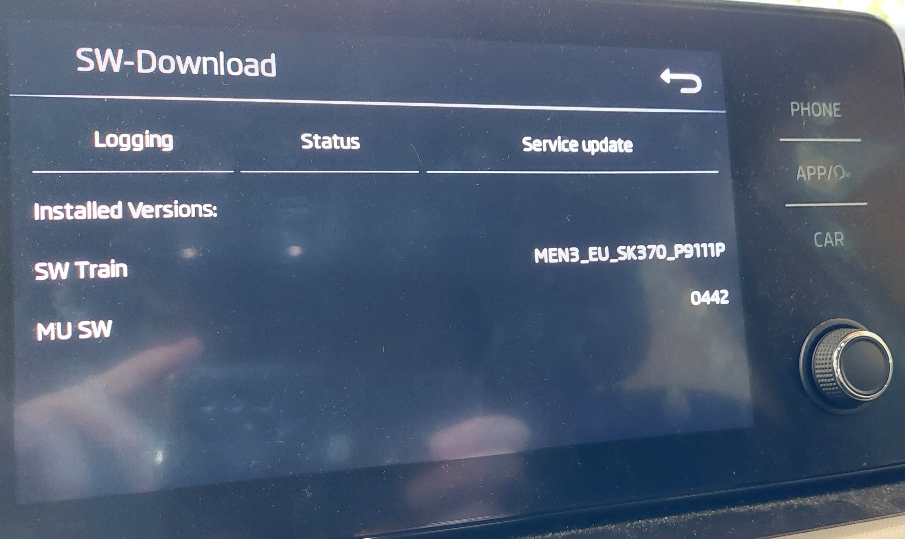

Hello.
My car is a 2019 Scala with this version :
MEN3_EU_SK370_P9111P
0442
A message appear  when I use google MAP : Pre-Production Hardware. Not for Resale.
I'm in France.
Could you help me to update to a last stable version, please?
Thank you 🙂

You have an old version of the software.  You need to go to an official authorized SKODA service center and request an update.  The update will fix your problem.

Thank you for your response but Skoda ask me 130€ just for the diagnotisc 😞

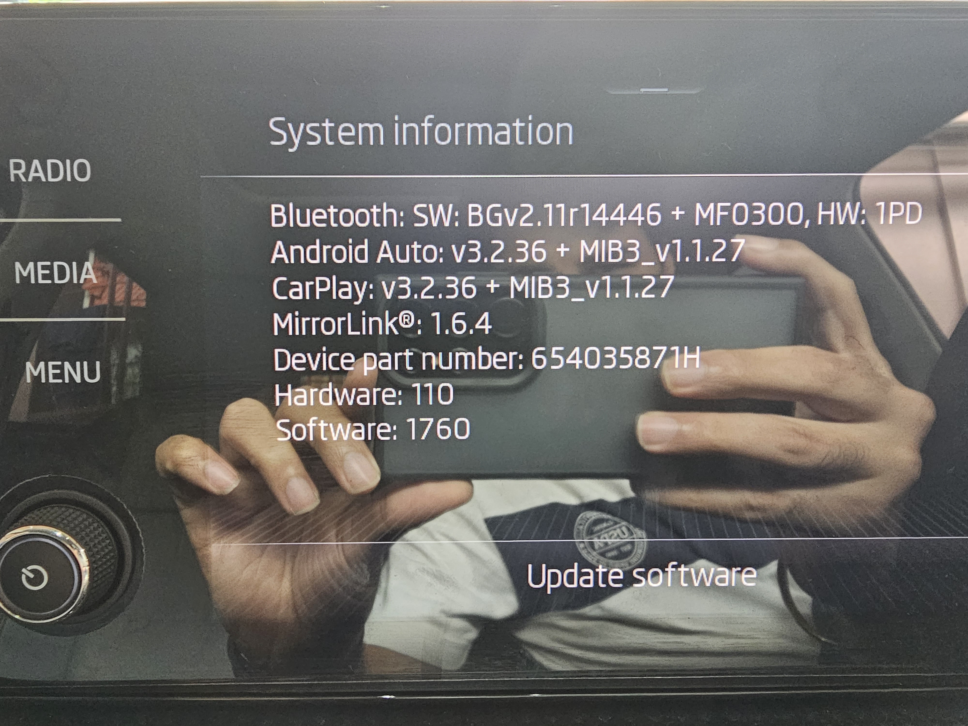

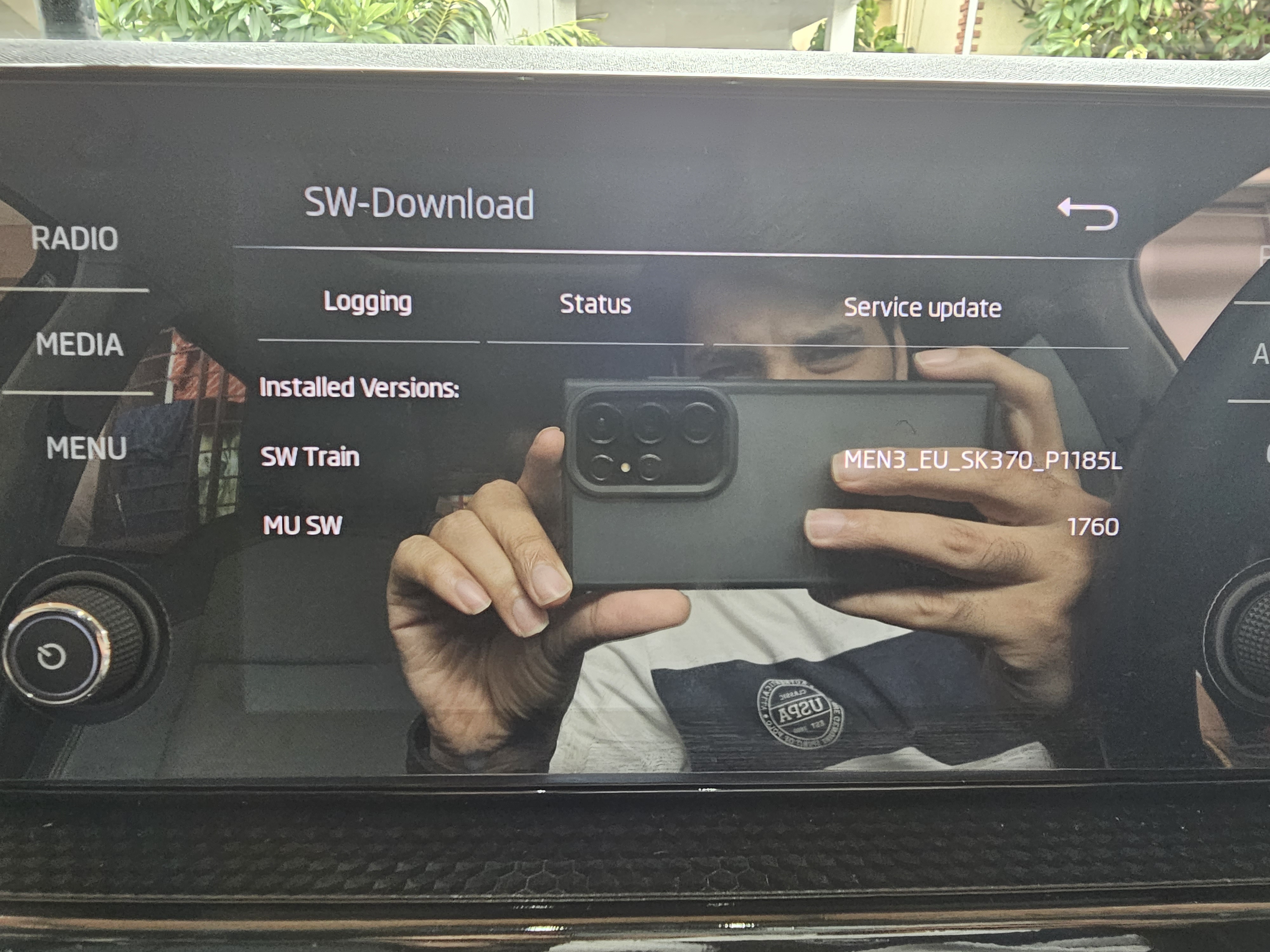

Hi,
I am new on this forum. I own a skoda kushaq and got the same bolero infotainment with MEN3_EU_SK370_P1185L_1760.
Recently ASC updated it to MEN3_EU_SK370_P2345L_1790 but still AA doesn't work.
Can I apply the above mentioned update. If yes please share the exact steps.
