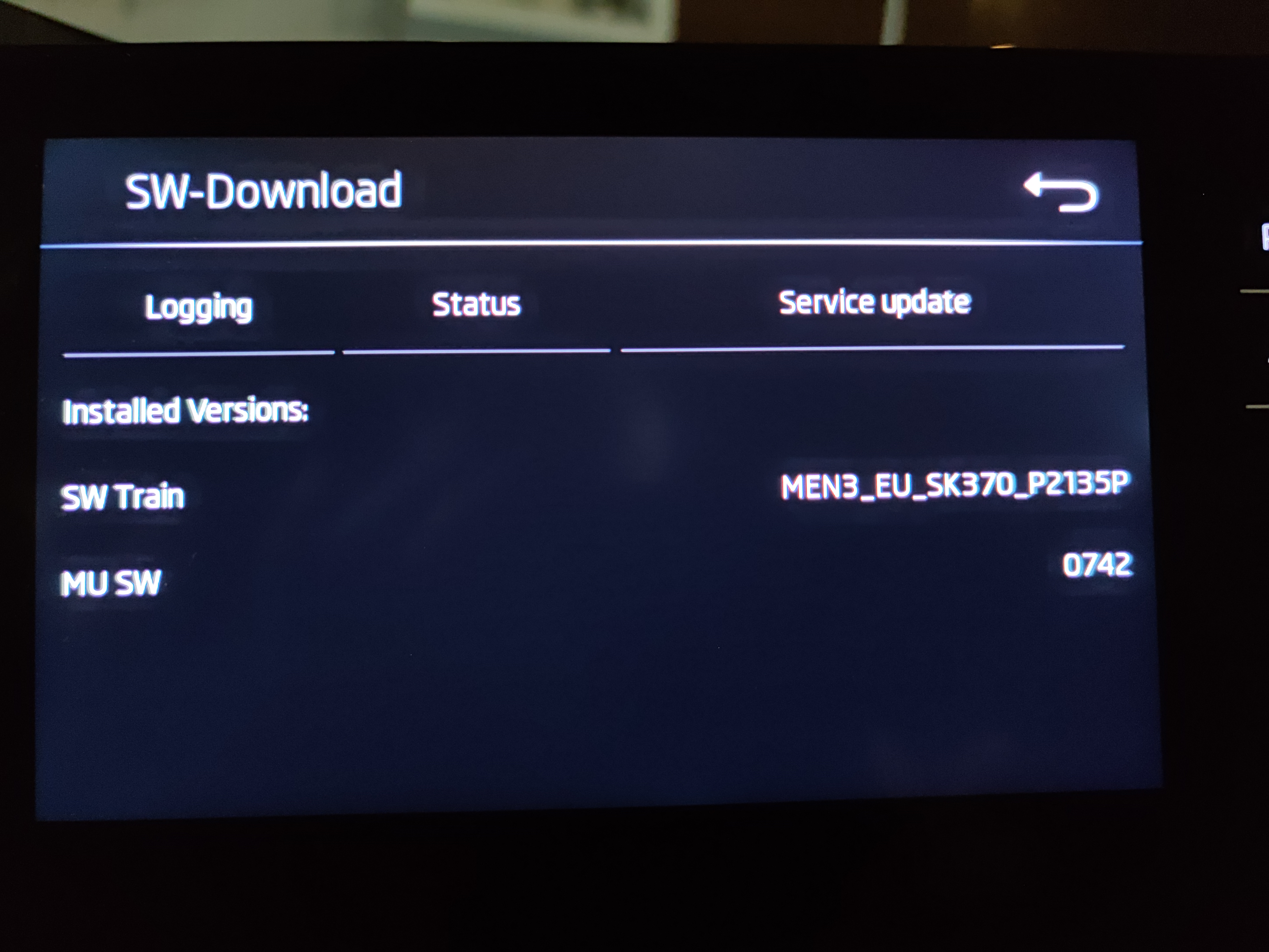

I have a Scala with Bolero MEN3_EU_SK370_P2135P 0742.
Could I have an update please ?
Also, I have wireless Apple CarPlay but no wan and no wireless Android Auto. Can it be enabled through this update or through obd coding ?
Thank you very much

    Cześć, poniżej link do strony z opisem możliwych FW U Ciebie powinno pójść do wersji 742. https://www.drive2.ru/l/650934799095051499/
  • There are these updates, but not sure if the higher number will apply to your system.   MEN3_EU_SK370_P0113P_0469 MEN3_EU_SK370_P2135P_0742   MEN3_EU_SK370_P1185L_1760 ME
For the MEN3 updates there is a link with all the versions and I posted yesterday the link for the newest one.
Regarding wireless AA you have to buy and active by your dealer something like this Wireless Aktivierungssoftware für Serien-SmartLink MIB III | autohaus-eckstein (skoda-sonneberg.de) since you need FEC/SWaP for it. There are multiple variants and based on your car VIN any dealer can figure out which one you need and whether it's compatible with you car. However as you already have SmartLink, though I don't get it how you have a wireless Apple Car without a WLAN, but maybe it doesn't required WiFi as I use company iPhone as a paperweight.
I've scheduled an appointment at my dealer for this on the 22nd of November, so I can provide more feedback afterward.
Thank you very much.
I don't know how it works without WLAN but somehow it does. I read somewhere that here in France Scala was compatible with wireless AA since 09/2020 but mine is from 04/2020, that's why I think it'd be possible to code it somehow.
I'll ask my dealer I can buy it.
Who already has WLAN and don't have wireless AA/CP can enalbe it with OBD11 by changing configuration.
However who doesn't have WLAN needs to install FEC/SWaP 00070700,.and as MIB3 is not hacked, you have to buy code and activate it at some dealer. Afterward dealer changes configuration using ODIS, but one can do it also with OBD11.

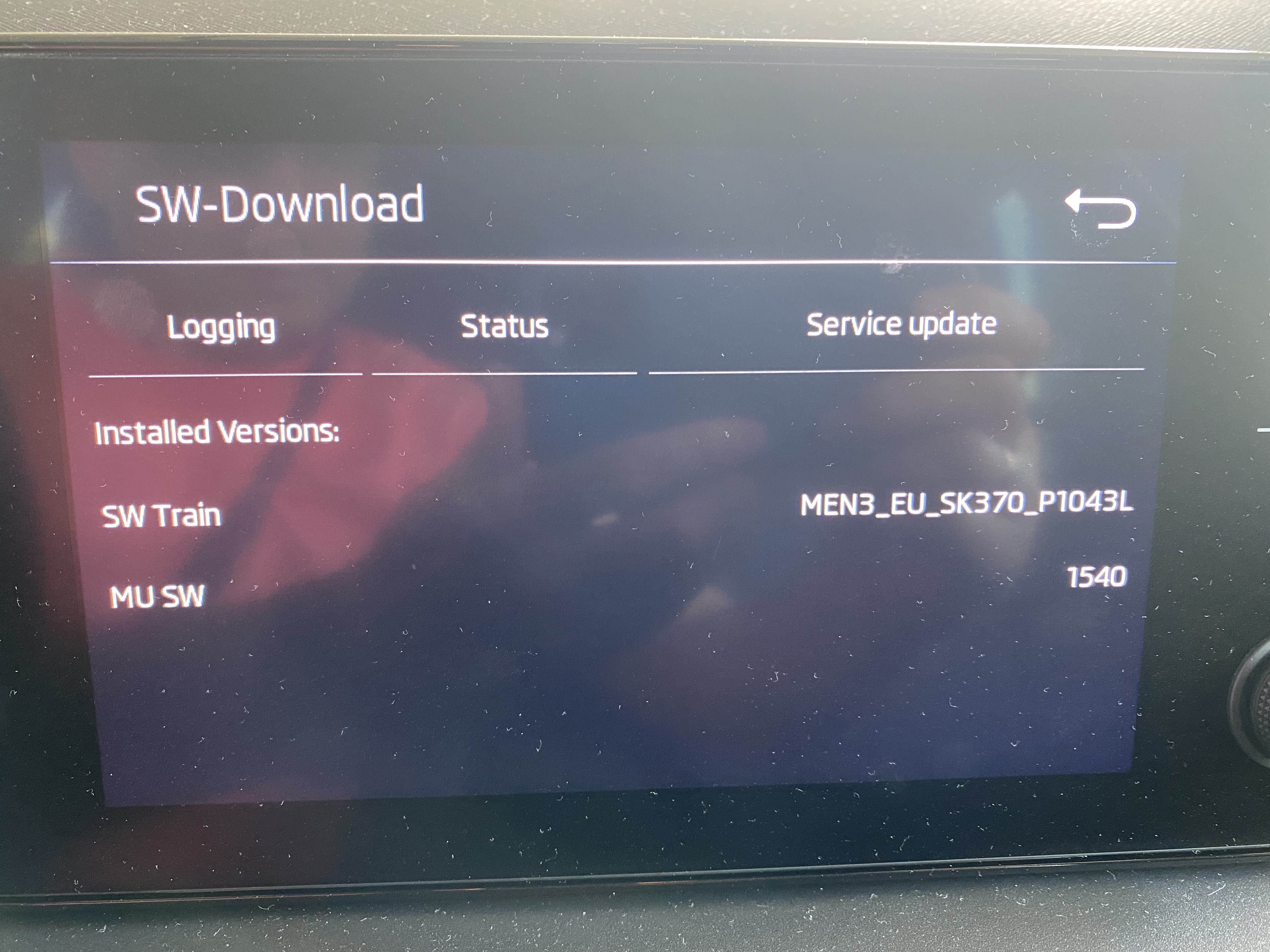

Please could You share with me link for 1798 version?
Can I update to it directly from my current one 1540?
