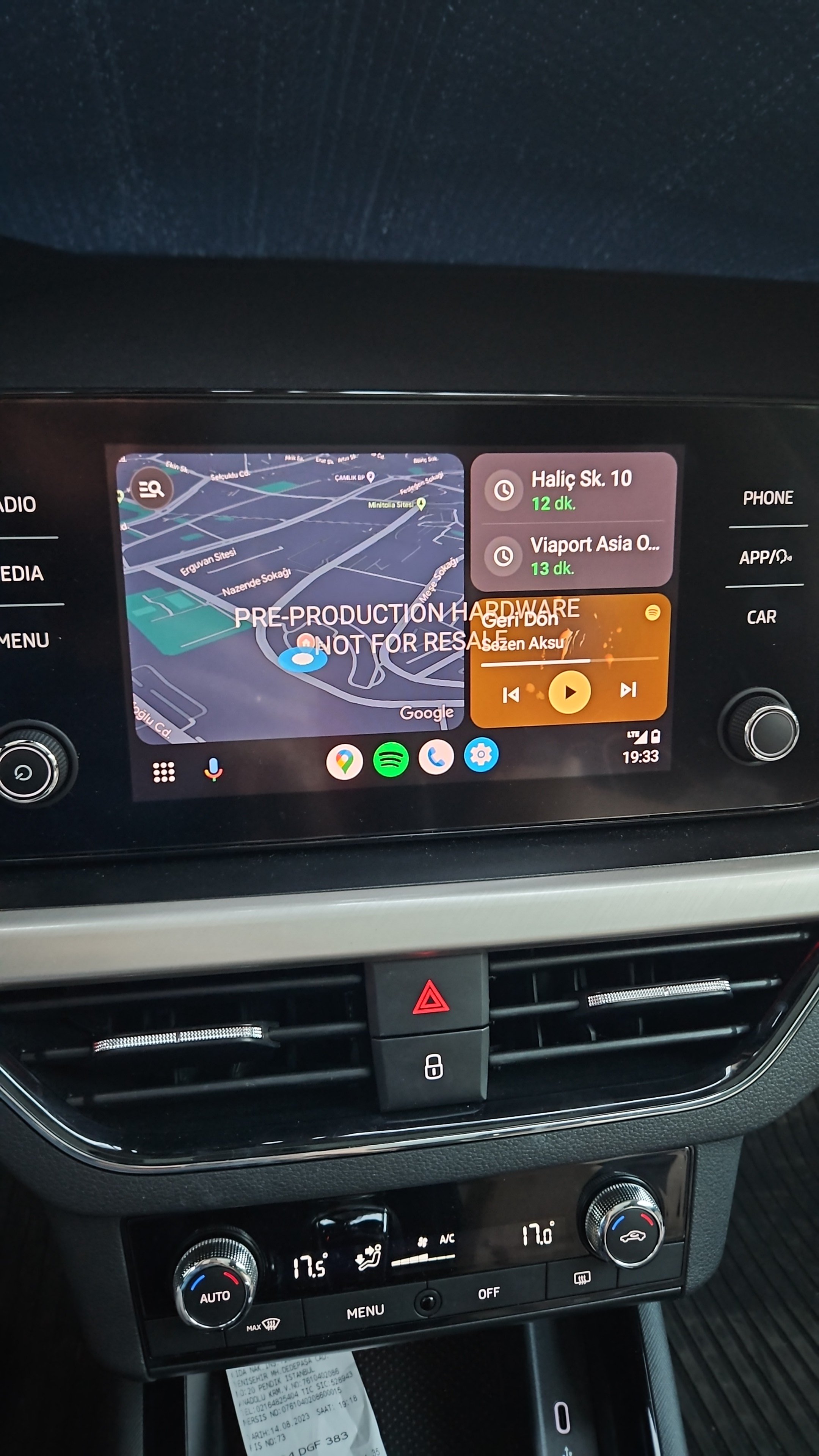

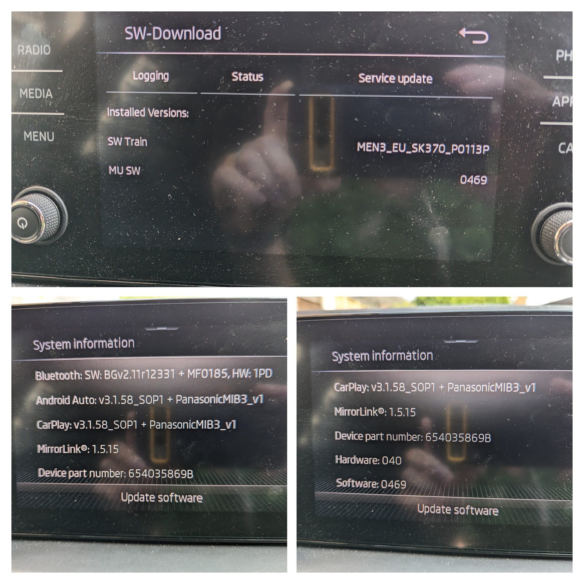

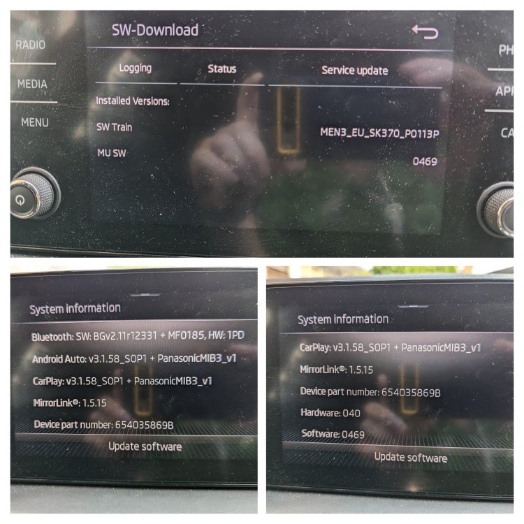

Hi
I had version 0469 in my Scala and I replaced it with 0742. Then "Pre production hardware not for resale" started to appear on the android auto screen and I want to go back to the old version.
Should I reinstall version 0469 with usb memory or is there another way to return to the factory version?
In any case, can you share version 0469 with me?

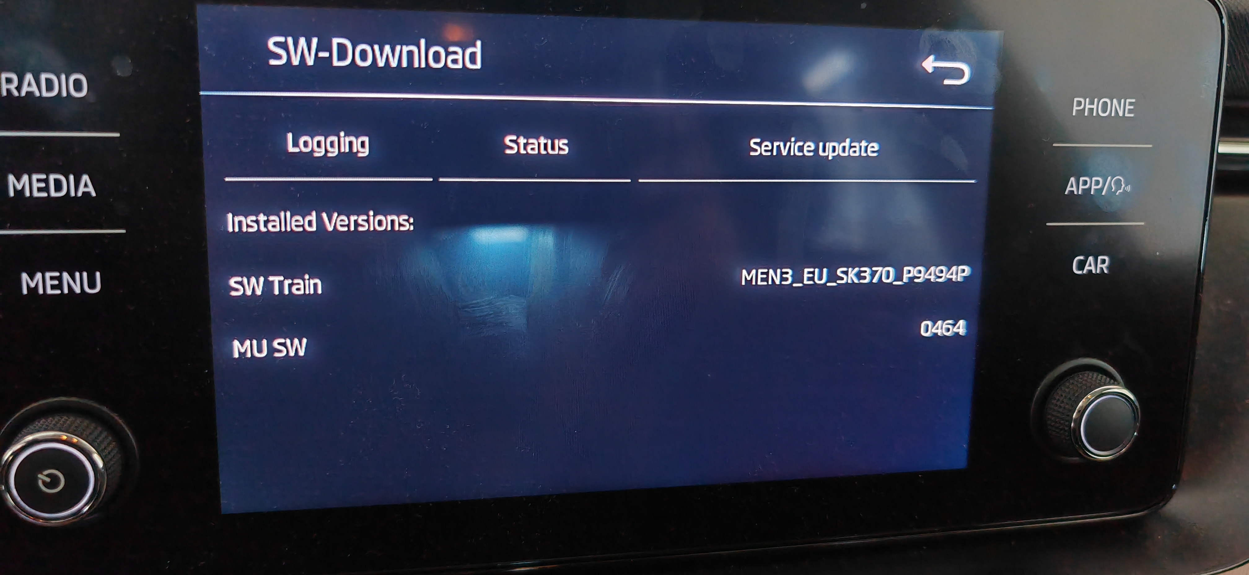

Hi everybody,
Rainesh was so kind and gave me access to the following Updates:
MEN3_EU_SK370_P3225L MU1798
MEN3_EU_SK370_P2345L_MU1790
Unfortunally i'm not able to bring one of them to work...
What i've done while following your instructions:
I have a 64GB USB stick from the brand "Keksin", this has USB C and USB 3 as connection (my Scala only has usb c, or im also too dumb to find any SD-Card-Slot).
I formatted the USB stick as FAT32 and copied the unzipped folders "MEN3_EU_SK370_P2345L" + "MEN3_EU_SK370_P3225L" to it.
The folders are recognized in my Scala, so I can select the source USB in the update menu "Service Update" and see the folder or folders I mentioned above.
But if I try to open one of them, "Reading Meta Info" only appears very briefly and I'm back in the folder selection that shows me the above-mentioned folders.
usb with the subfolders (meta) of one update - does not work, folders are not displayed in scala. As if there were no stick in the usb
usb with the main folder - does not work, folder is displayed in scala but cannot be opened.
usb with both main folders - does not work. folder is shown in scala but cannot be opened
I formatted my 64gb stick to fat32
Main folder, packed on the stick. The folder is displayed in the update menu and cannot be opened. both versions are affected.
folders decompressed, subordinate meta and data packed on the stick. USB stick is not displayed in the update menu.
same behavior with ntfs and exfat formatting.
I hope anybody can help me, THX!
Ah now i see that you need an intermediate firmware. Will sent you another one

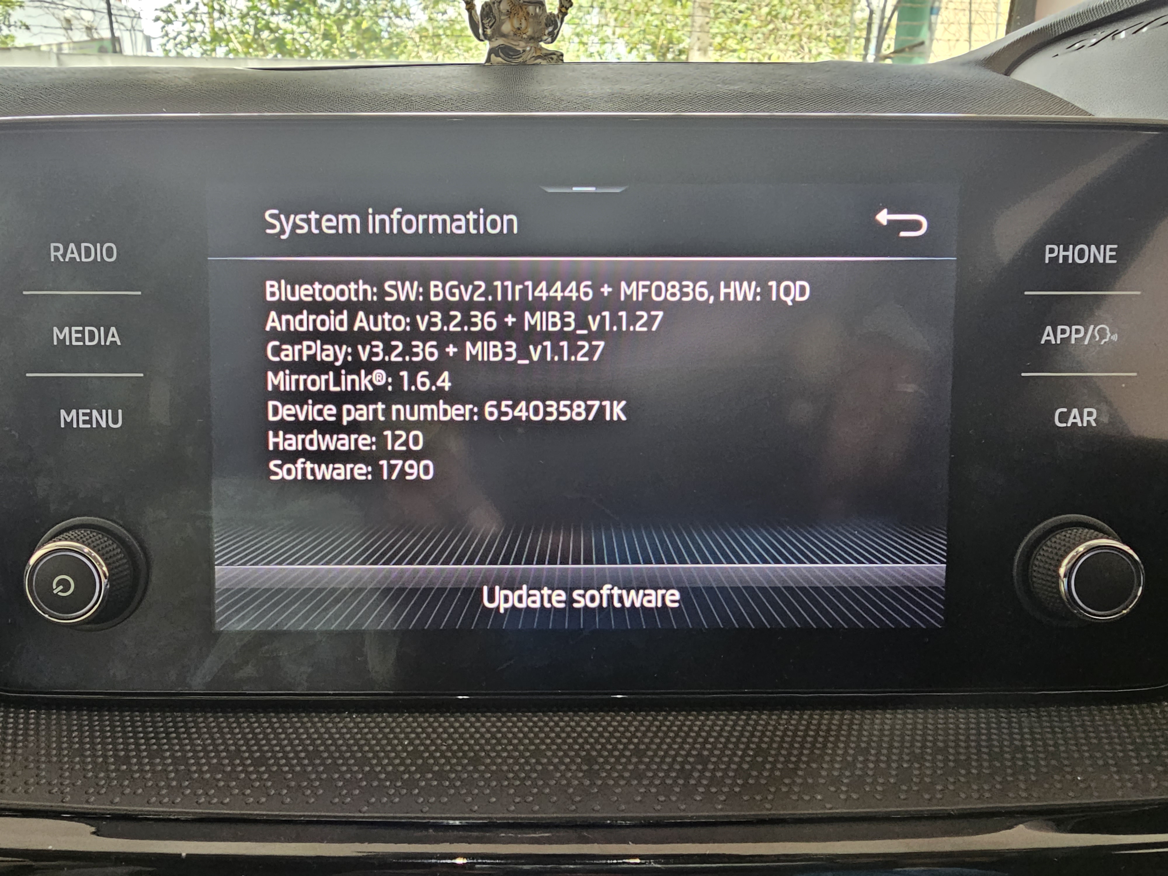

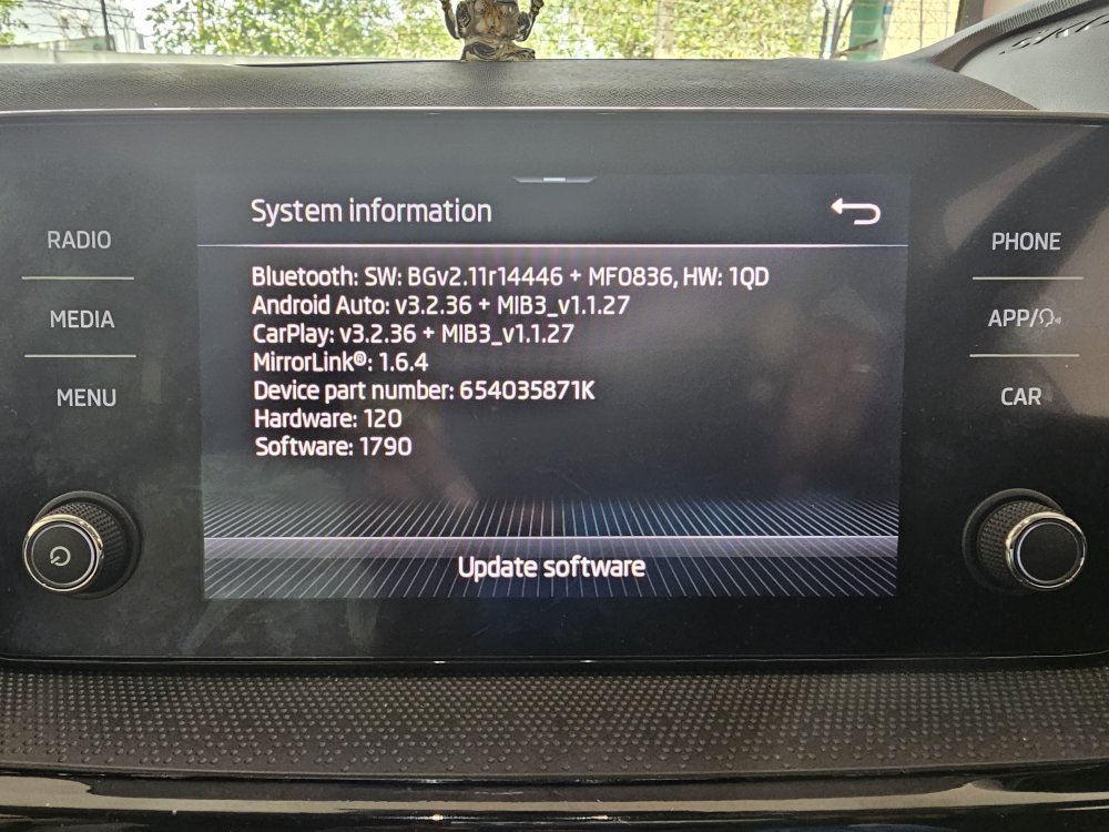

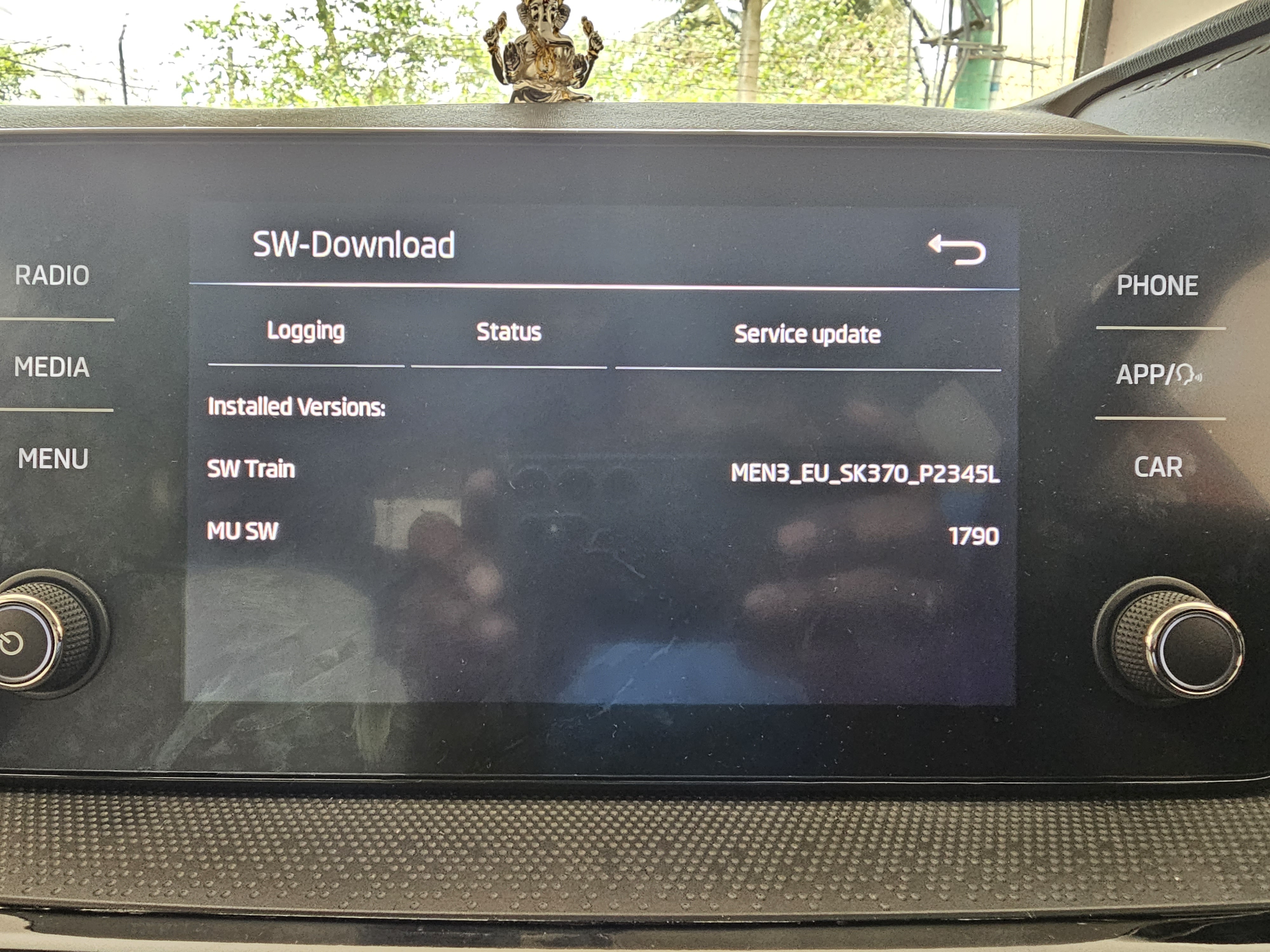

I'm having issues connecting my S23 Ultra for Android Auto. I am running version 1790 on my infotainment. Attached the screenshot. Would be great if you can share 1798 with me.
This is my software train:
@varooom @Rainesh it would be helpful if you can PM me the instructions and the link to download 1798
Can somebody sent him the link 1798? Currently not able to sent

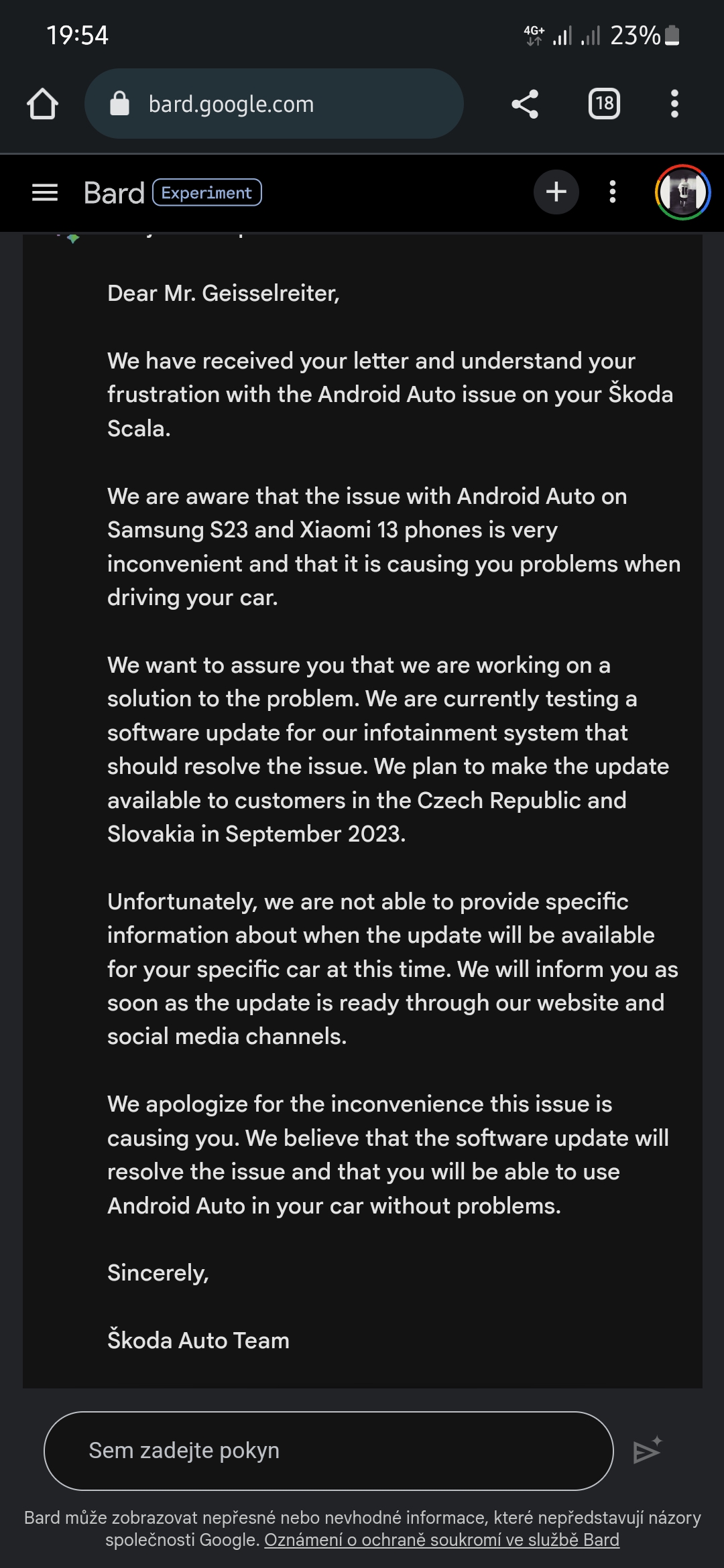

Nope nothing works, but i found some emails from Skoda that they are planning upgrade on the end of summery even when i use Google Bard to check my writing of email to Skoda before i send it reply me that they are already testing SW in CZ and Slovakia but i dont know where the Bard find that info it looks like text from Skoda

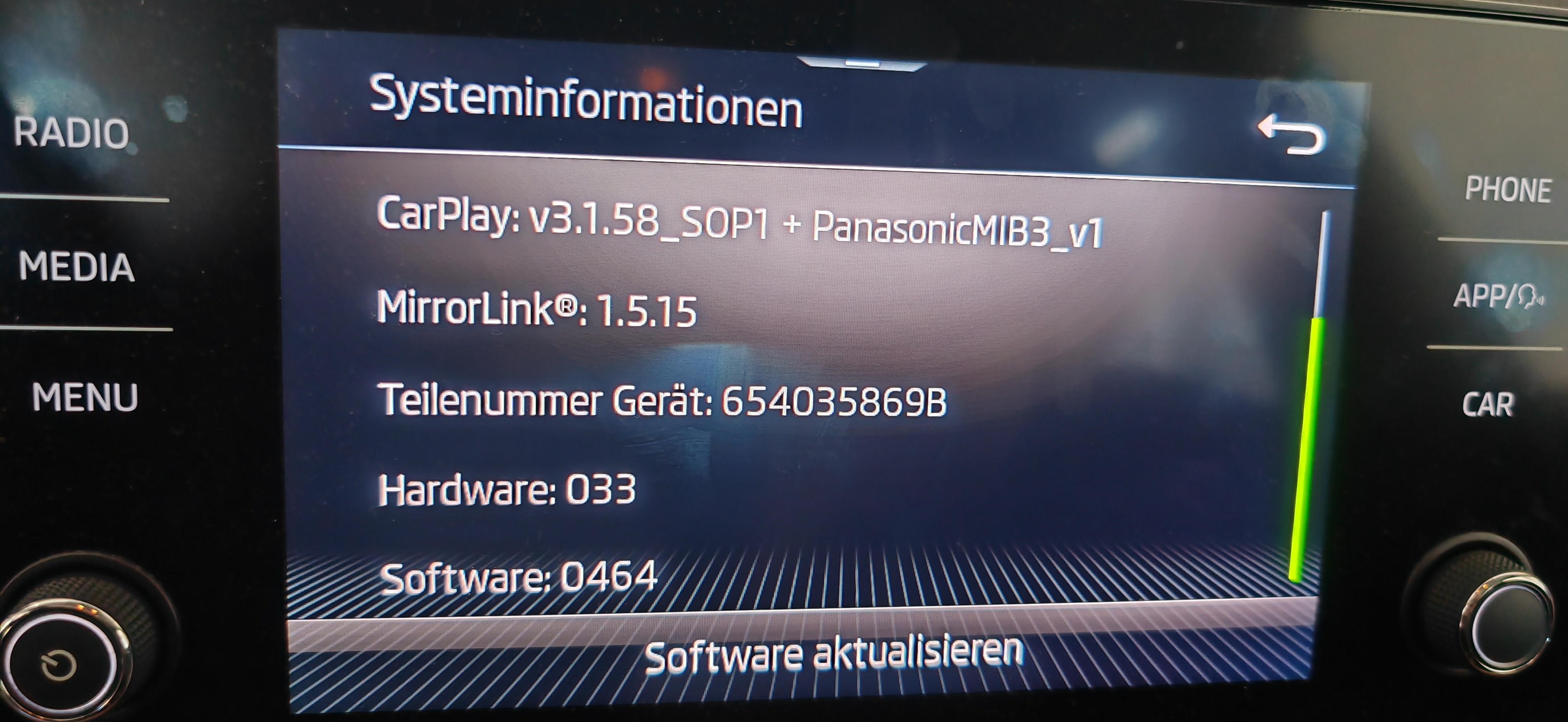

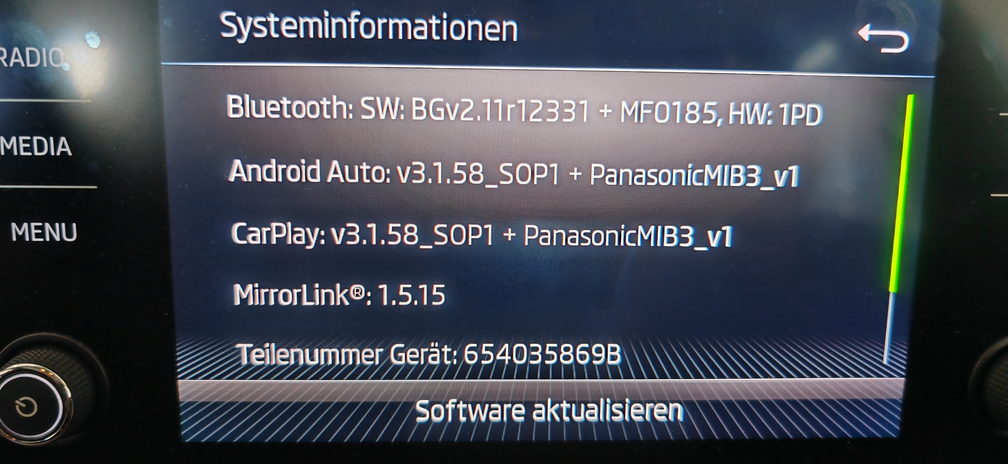

can I please you to send me the newest software and firmware for my Scala 2019? Actually there is software MEN3_EU_SK370_PO113P, 0469.
Thank you!

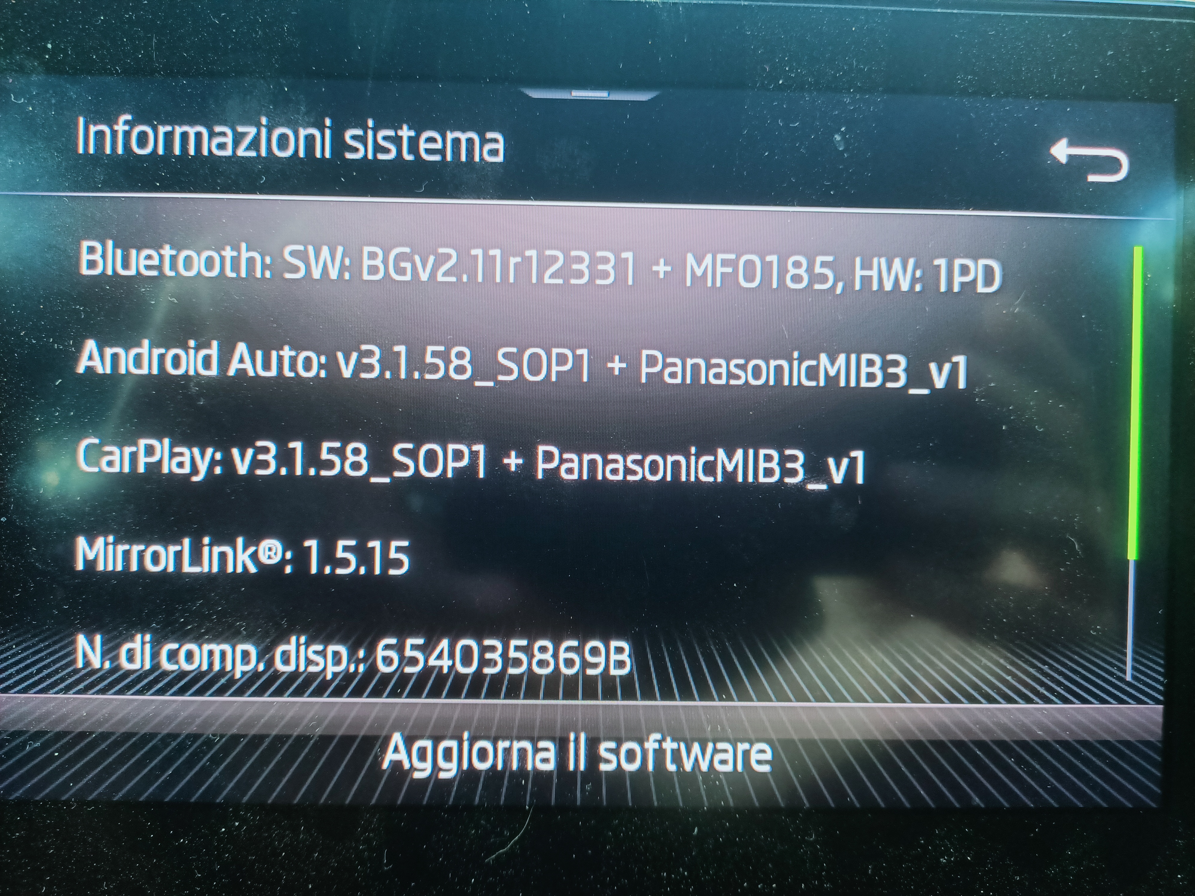

i have the same 0278 can someone help me to update it thanks
