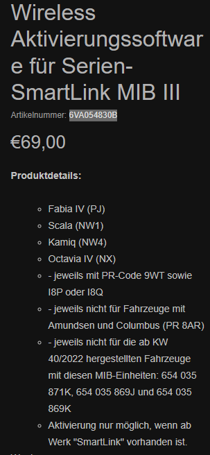

Update to version 1800 was free for me, performed by car dealership, updated from 1760. Connectivity via cable works.
Also purchased a license about 60 EUR for upgrading Smartlink to wireless and it works perfectly.
After installing the license you need to re-pair your phone for Android Auto to work wirelessly.
Where did you get that license? Just from the dealer?
Yes, dealer ordered and activated it.

Since my dealer failed to active it (ODIS timeouted multiple times) on the my current version 1760, and apparently 1800 is still not official in Germany, so he can update my car, do you know whether your delaer activated wireless smarlink after the upgrade to the version 1800 or before? I left with the last resort, bombarding my dealer with facts from the varios forums to force him to do something about the version 1800, which I actually need also to be able to use my A54 phone.
Many thanks in advance!
As far as i know 1800 is requirement for Wireless activation. In my case it was activated after 1800 update.
Try sending a ticket to Skoda and another car dealer.
I doubt Romania has it and Germany not 😆.
You can also try to order Wireless and let us know if it works on 1760.
I've alrady ordered it and went dealer after he verified that my model of Kamiq fulfills all requirements. However the activation was not successful due to a "multiple ODIS timeouts" on the current 1760 version. Of course I didn't pay a dime and the dealer opened a ticket at Skoda - I saw it on his monitor and still no update after ~3 weeks!
Now I keep bothering them and again offer to bring the 1800 version so they can update my car and enable the wireless smart link :)
Not sure about Kamiq if version and availability is the same. If someone here has it please let us know.
