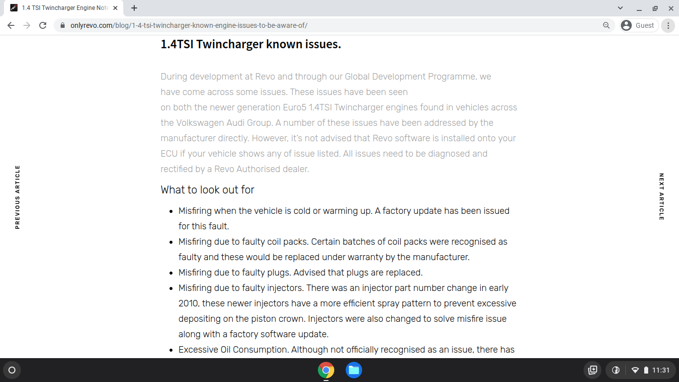

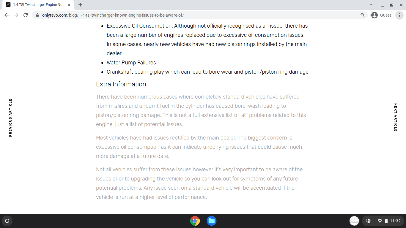

REVO did and still do make customers aware of issues and potential problems.  As did i very very often. You can only try telling people, they might ignore that warnings.

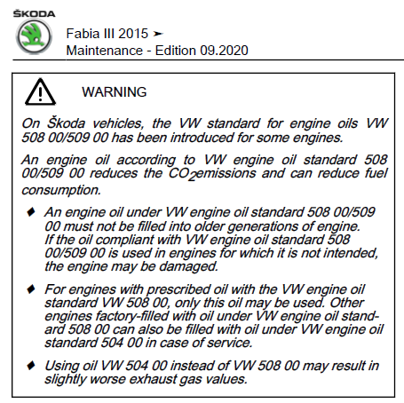

I was only asking as about you say not OE, or you may be refering to the original fitted.
On 22/03/2023 at 11:20, toot said:
An APR Stage 1 map, a change of spark plugs from OE and not using the Castrol Long Life oil and 99 Ron and you were on a winner.
Is there a problem with long-life oils and remaps or just the Castrol Long Life oil, @toot?

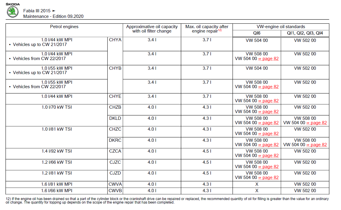

@EnterNameThe issue was different with the Twinchargers but worth knowing about as it was VW / Skoda not giving a damn and not listening to the issues, and not acting on them.
Borewash was and is an issue, and even though they run on 95 ron the prescribed fuel was Super Unleaded.
There are enough detergents in oil, and in the fuel, and when you have issues like borewash then an oil suitable for the temperatures the engine might be reaching
and the fact the Standard  Oil capacity is so low that you need good protection.
(I never used just 3.6 litres, i used 4 litres as did others, and never used Long Life Oil, even doing oil changes much sooner than 9,400 miles / 12 months.)
The first Twinchargers did not have a Service Code for Flexible / Variable servicing but had Long Life Oil from the Factory and got Long Life oil , VW504 00 /507 00 at Dealership services.  2011 the Servicing code changed from Fixed or Variable.
They were better off IME with VW502 00 so not long life and the Super Unleaded.   (Long life oil / short life 1.4 TSI / TFSI Twinchargers.
The other issue was crap OE plugs, wrong gap, then the revised OE plugs with a different gap still crap.
Inlet manifold cooked one plug, crap engine management etc.
