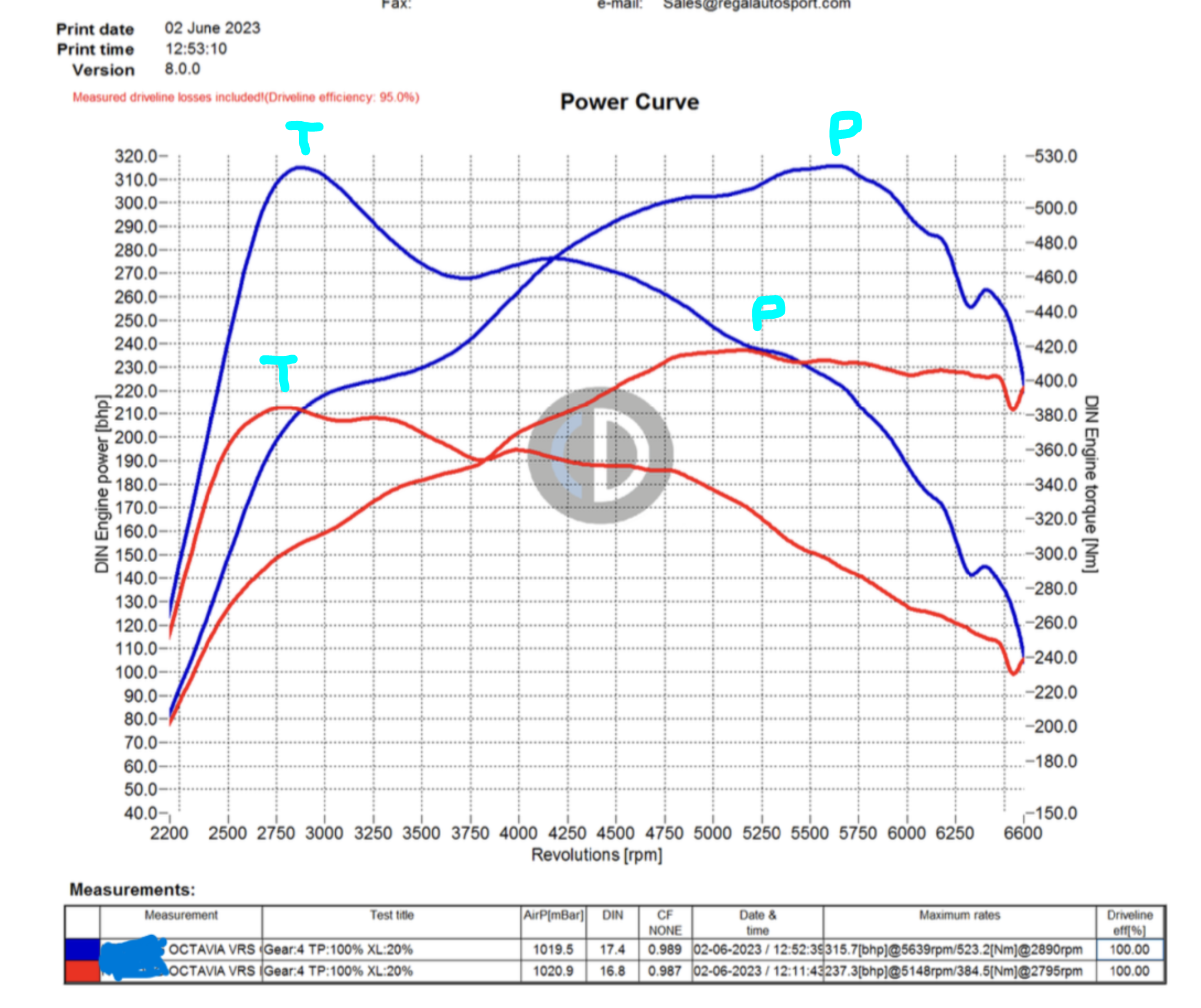

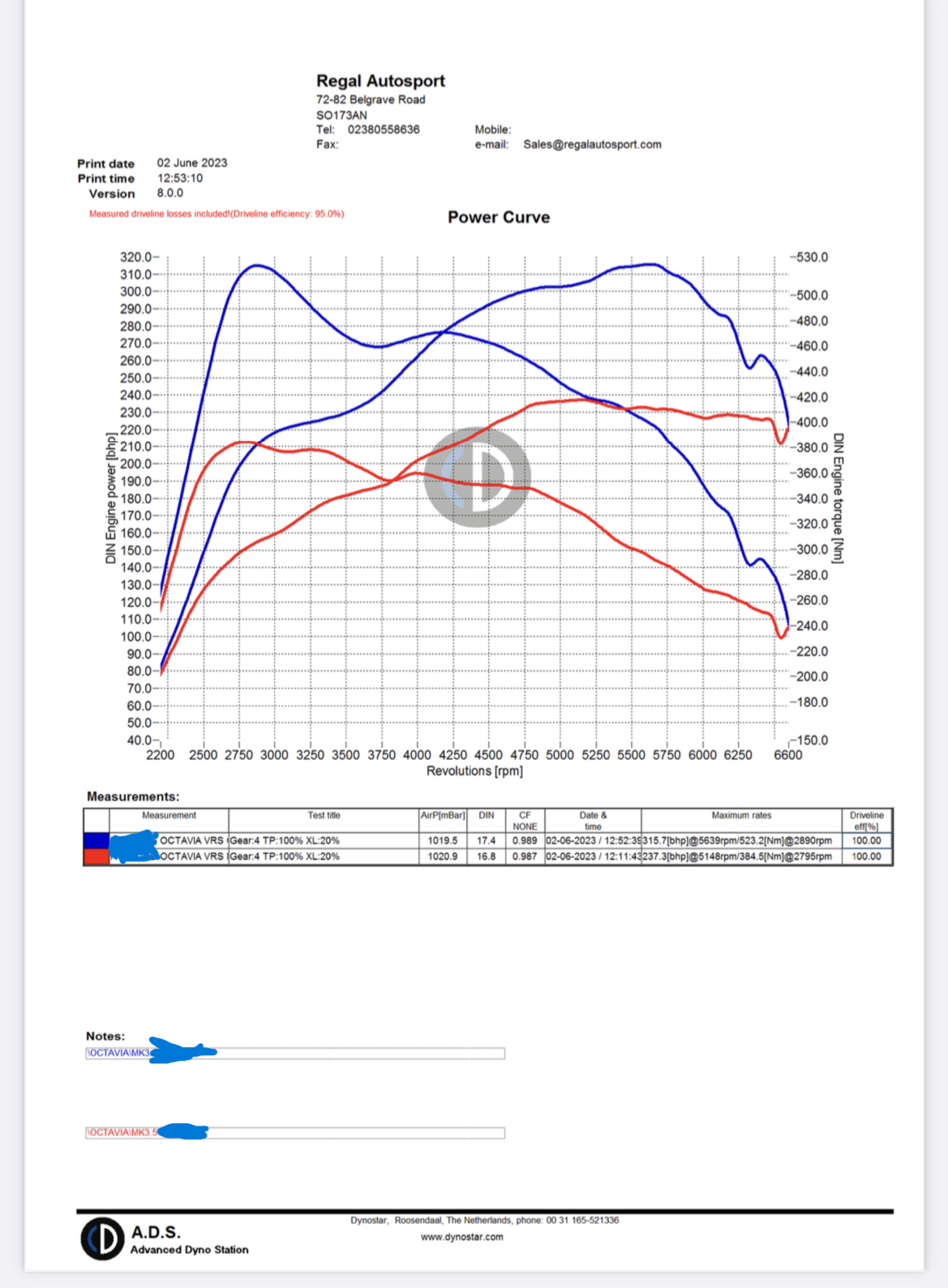

Had it done today, quite good results, pre and post! Been running Tesco 99 for a while.
I asked on another thread if they were pre and post tune graphs, you have confirmed it here.
There is something very very very wrong with that graph, am I the only one to see it?
instead of asking us, please tell.......?
Sure, possibly I am misinterpreting the curves.
Blue is power and Red is torque is that correct?
They cross at 5250 rpm which is as it should be.
I was going to say that the other pair of curves do not cross which is a physical impossibility.
On reflection I decided that it was not a pair of curves pre and post but a power run and then a coast down dyno powered run to measure the transmission losses, this is shown by the blue curves turning back on themselves and turning red and maybe its just a coincidence that the blue from one and the red from the other cross at 5250, maybe the torque curves are not shown but the graph has a torque scale.
What are you seeing?
It doesn't help that I cant read the numbers from the table, it looks like the power has gone from 237hp at 2800 rpm to 316hp at 2900 rpm, I can see one blue curve indicating the former but nothing resembling the latter.
The more I look at it the more confused I get, I dont like these graphs with 2 different vertical scales, bad presentation and mathematics but I can usually make out what is going on, not this time.
Perhaps you can enlighten me.
That initial torque figure is great and will make it feel fast. How does it drive? Interested as really want to get mine mapped. Remind me, is yours DSG?
I think, although maybe wrong, red is before and blue is after. There's no crossover at 5250 and it's coincidence. They should have put Torque as one colour and power as the other.
JR, both red are pre, both blue are post.
Click the photo, it should go bigger, then you can zoom in. I checked as yes, you cannot read the figures as they are.
The lines will cross at 5250rpm if the Y axis where the same scale.
Agreed it's not great, but seems correct in my mind.

I'm a little nervous about the 520nm torque, is it really safe to be pushing that much? It drops off fast too, guess the turbo runs out of puff.....
Perhaps I'd feel happier with the lower torque map.
Where are you finding in the rev range it's running out? Although I haven't looked, I am guessing they offer a low torque version for manuals to save clutches?

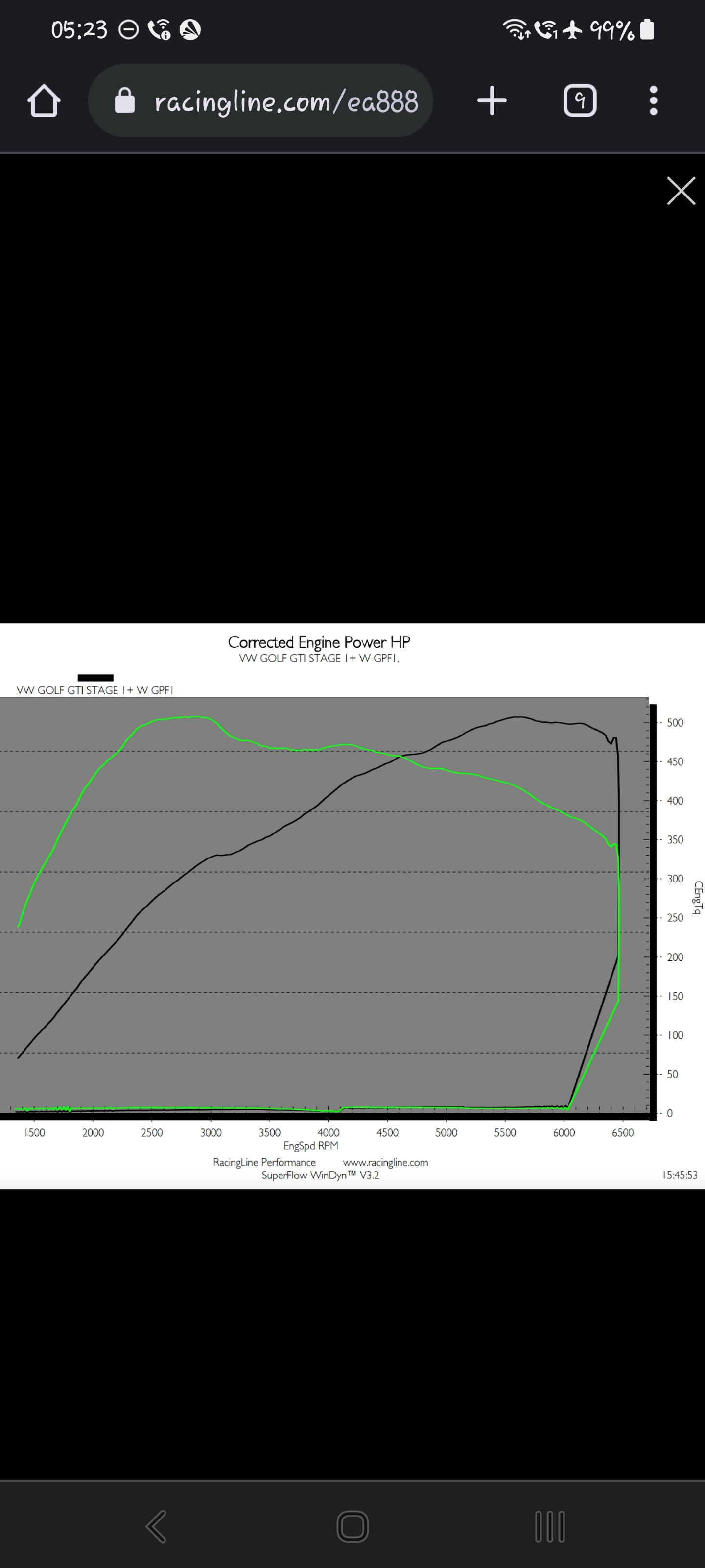

It's the big peak at the 3000rpm range, none of the Racingline curves look like that. Attached their OEM+ curve from their site. None of them have a peak like mine does, did my car move on the rollers?
The stage 1 says it's around 440nm and the OEM+ for cars with GPF is 500nm.
Stage 3 is 550nm, so how am I making 523nm?! And is it really safe?
Going to speak to them today.

I don't really know how the plots were calculated, but perhaps the gearbox losses are a factor in the torque and power curves not crossing at 5250 as expected?
But that's just the start of the weirdness of those plots. It's weird that the pre-remap curves (red) and the remap curves (blue) cross at different RPM.
I'm bemused as to why the power curves start to be measured at a relatively high 2200rpm.

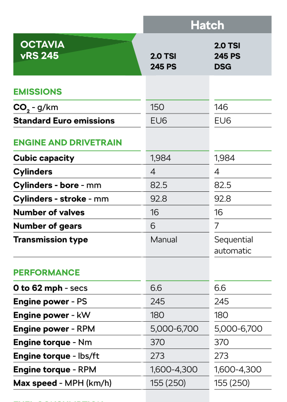

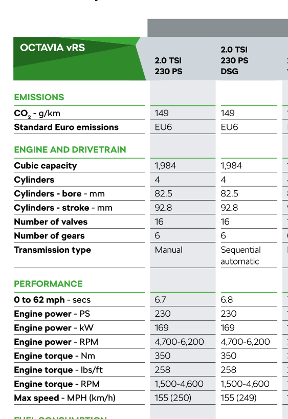

I'm not sure what engine @RoddersUKhas, but both the 230vRS and 245vRS engines' peak toque in standard tune is available from 1500rpm & 1600rpm respectively, so starting measuring at 2200rpm seems odd.
What's even odder, is that peak torque on Rodders standard tune was a healthy 384.5Nm but at a heady 2750rpm, when it should be developing 350Nm (230ps) or 370Nm (245ps) from 1500rpm & 1600rpm respectively.

If you make the y axis of the torque the same scale as bhp  they cross at 5250rpm.
I have no idea why the rpm starts at 2000rpm, perhaps that's why it's showing such a peak, maybe it messed up the plot.....
Another question I shall be asking them.

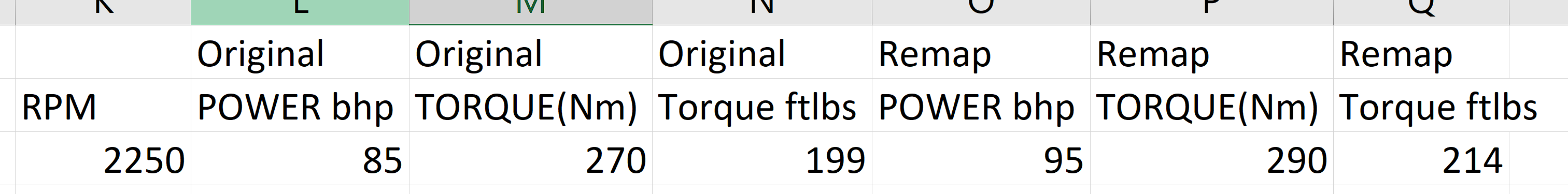

BIngo! Yes, you're right. From my somewhat crude peering at the screen in conjunction with your sensible context, I get the following data.
(Errors would appear to be down to my accuracy reading the graph.)
So that makes sense now. Thanks @RoddersUK
I'll be interested to hear what Racingline say about the low rpm torque. 👍
I've just been looking at some other people's graphs and their torque is at similar rpm?
Even the racingline graph is 2500 to 3000rpm for max torque
Yes, that seems to be consistent across a variety of tuners.
During my online search, I saw curves from smaller VAG engines recording peak torque from low RPM, but I'm not seeing any measured evidence to back up VAGs claim of high torque from 1500/1600rpm for the EA888 2.0tsi. I cannot explain the discrepancy.
