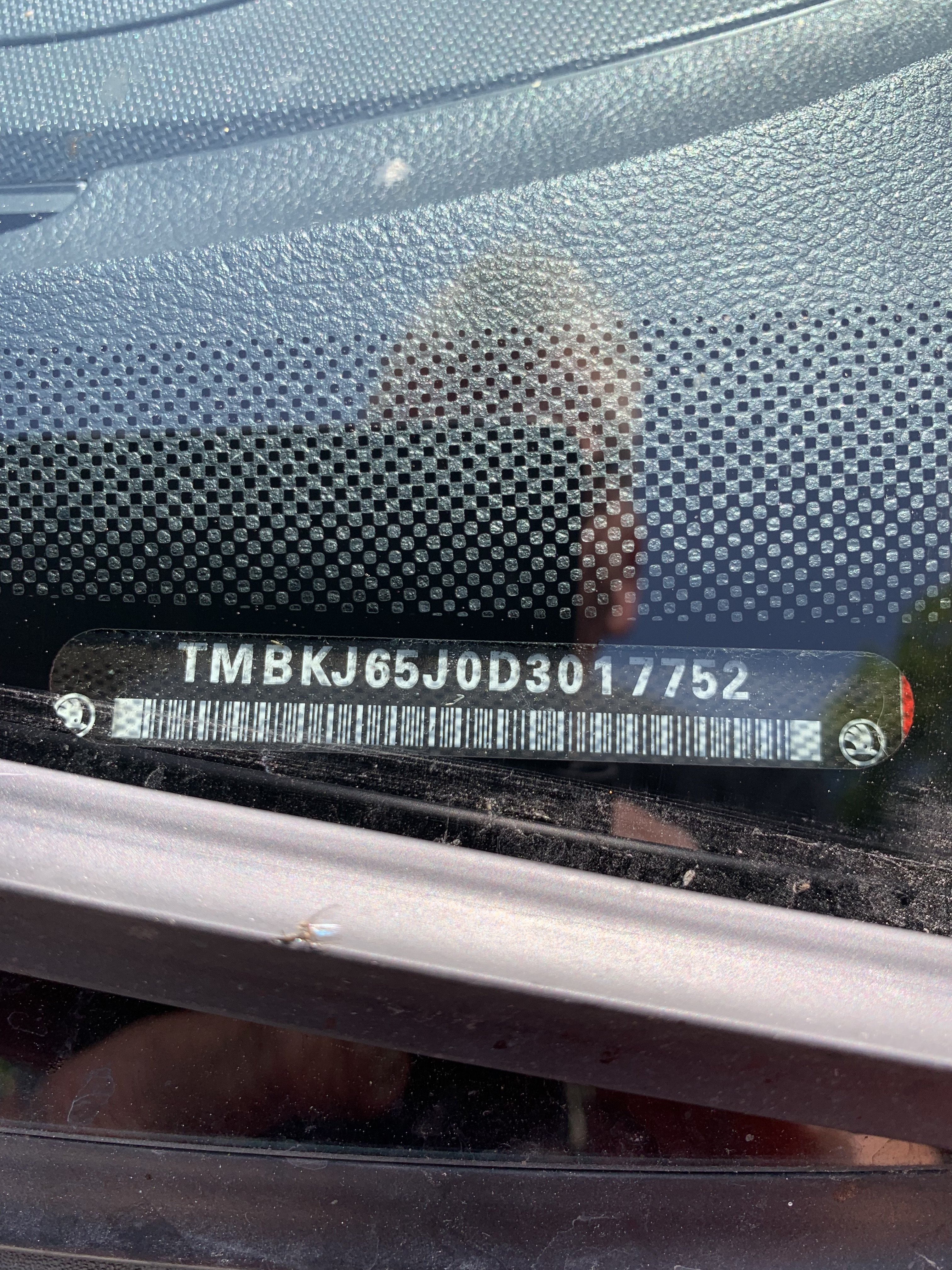

The immobiliser is in the cluster so you can’t “plug and play” anything, not even a genuine exchange panel, what is the VIN?

Firstly, I’ve realised I was searching incorrectly and now have found a matching cluster! 🙄
I’ve just photographed the VIN for you.
The old one can be repaired, given that it's all four needles I imagine they're all illuminated by the same failed LED which can be replaced by a workshop with the necessary equipment.

I get the genuine part number as being 5J0 920 941 D
