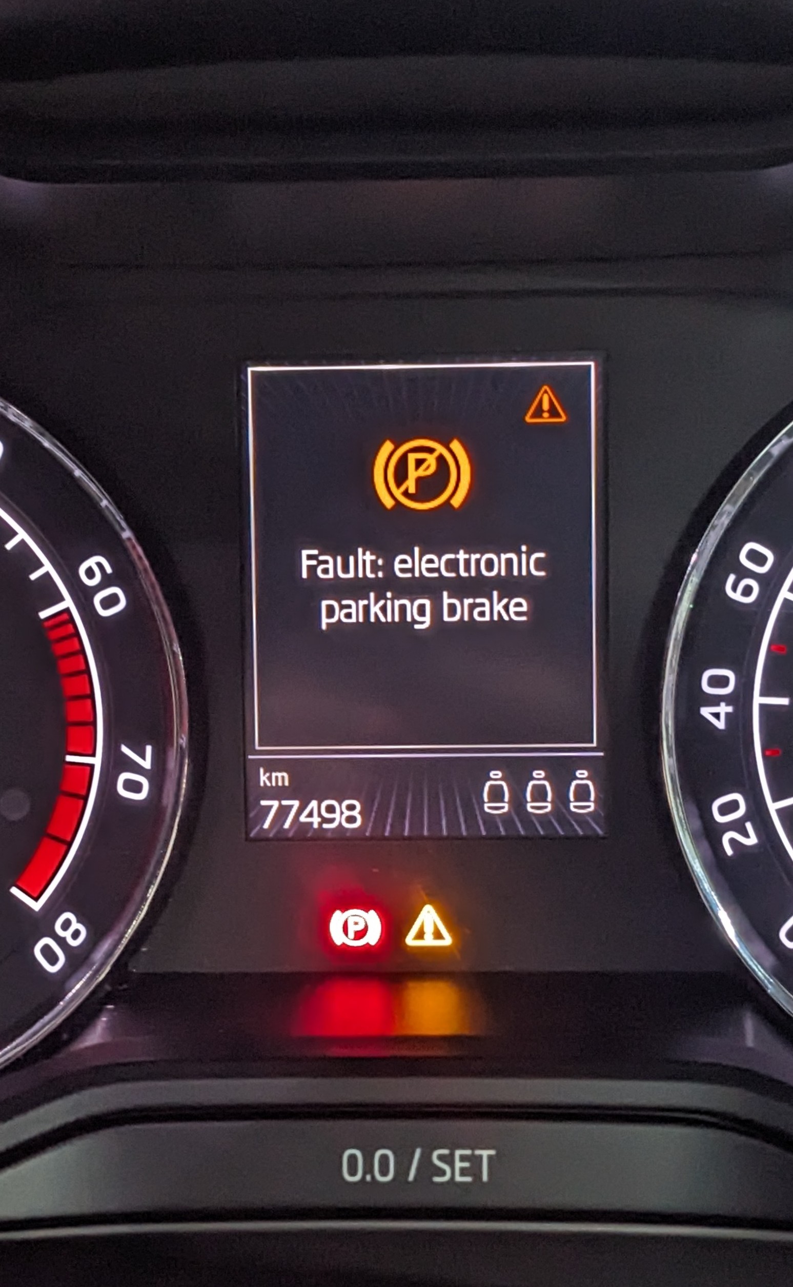

Hi, sorry for not being clear. Basically I cannot turn my handbrake on or off. It started flashing and had a error message on the dashboard. So I took it in and I was told the handbrake switch needs to be replaced. Many thanks

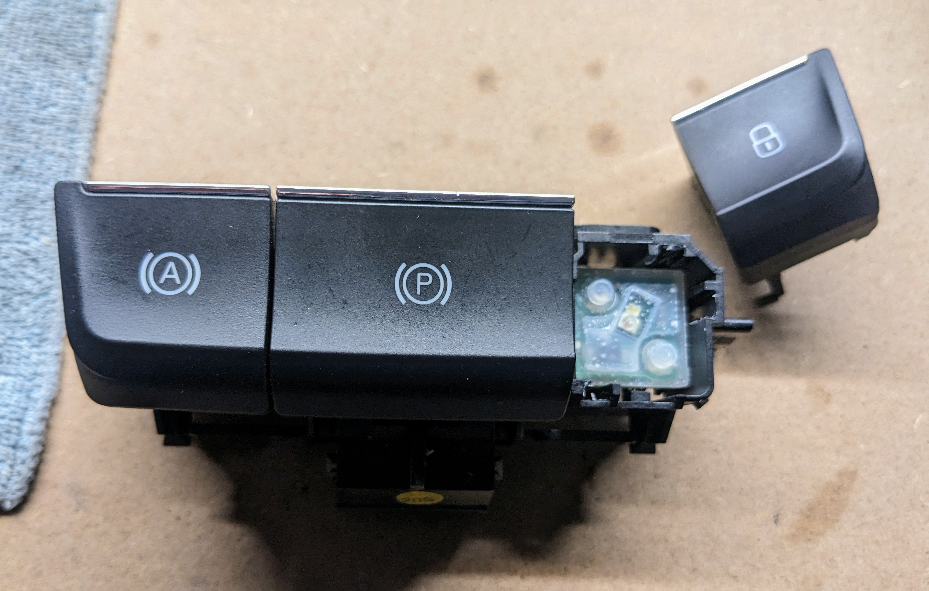

Ok - I just did this job about 4 weeks ago.
In my case, the electronic brake would apply itself when the engine was switched off and released itself when the car moved off in gear, all as normal.

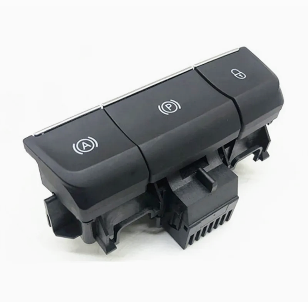

What did not work was the switch in the middle of the panel of 3 just aft of the gear selector (DSG).
I also had the dashboard warning message and another one about the cruise control not being available.
The handbrake switch cannot be replaced without the other 2 (Auto-hold and door locks?) - it is all one panel with the 3 switches.
I was quoted £135 for the panel by a dealer, but I managed to find a second hand one on Ebay for £42, which worked fine.
It's not at all difficult to swap, but getting the shiny black piece which surrounds the gear stick off is a bit tough.
I started by pulling out the bank of switched and blanks on each side of the gear selector.
These are removed by prizing them up from their forward edge (nearest the dash board) and are quite easy to remove.
It is probably not essential to pull these out, but it gives you a view into  the shiny black piece helps to see how it might come off.
If memory serves, the gear stick surround  is held on by 3 plastic prongs along each side and is just prized off with a bit of brute strength.
I have a set of plastic trim removal tools which are less damaging to the car and I used these to get under the front and back edges to force the black panel up enough to get fingers in to pull it free.

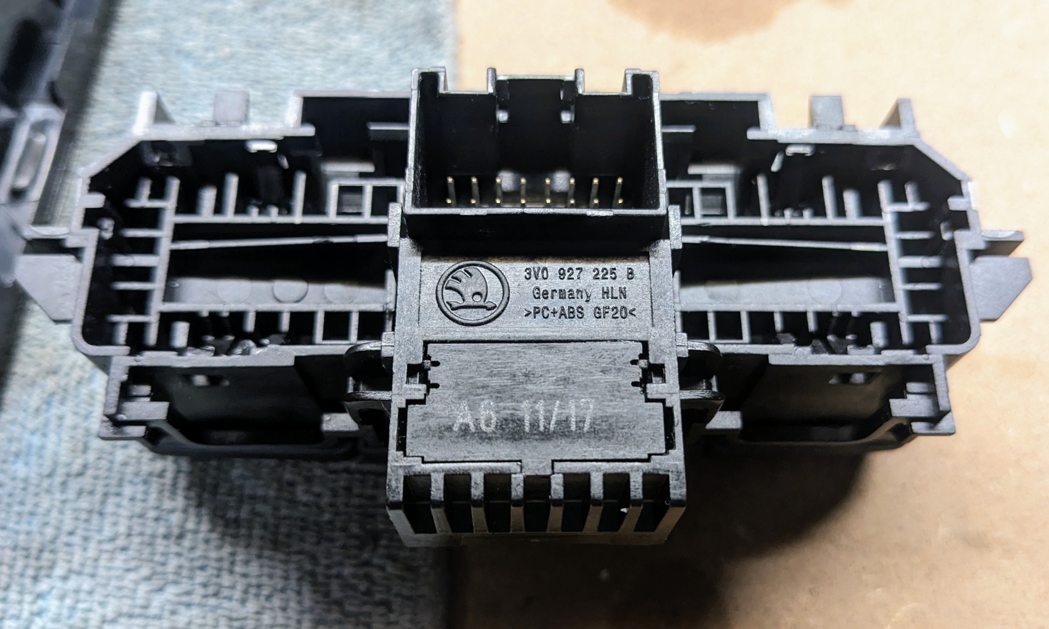

Once you've got that out the way the handbrake switch panel is easily accessed and has a single electrical plug to pull off.
(there's a little hook/trigger thing to one side which needs to be pressed in to release the plug)
Reassembly is very simple as the pieces all just snap back into place in seconds.
Edited to add - the replacement switch solved all the problems and removed the error messages

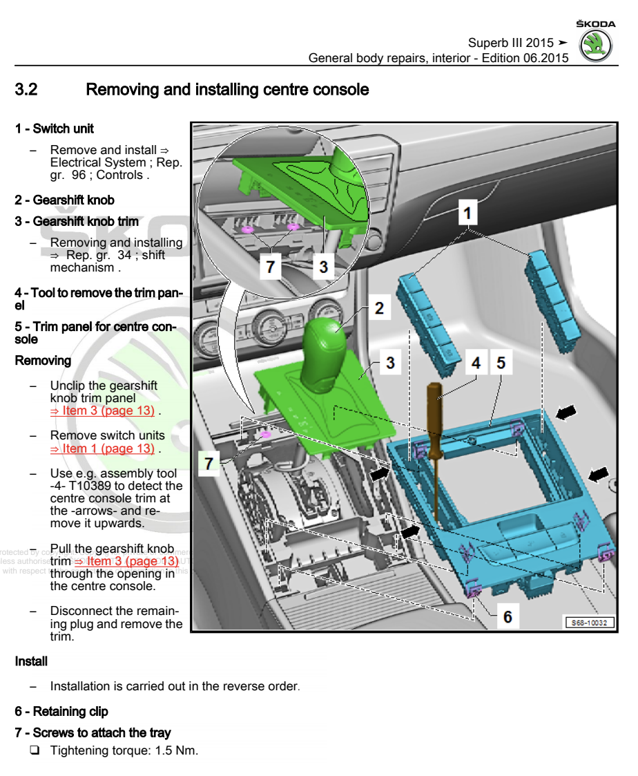

I had the same problem a few weeks ago.  Bought a 2nd hand one from a breakers for €65 I think it was an fitted it myself.  This gives a bit of a guide to how to remove the centre console:
Once you get the console trim lifted you can unplug the cables and remove it completely to make it easier to remove the switch.  The switch is held in with a few plastic clips.  Easy enough to get the switch out.  Just take you time so you don't break anything.
