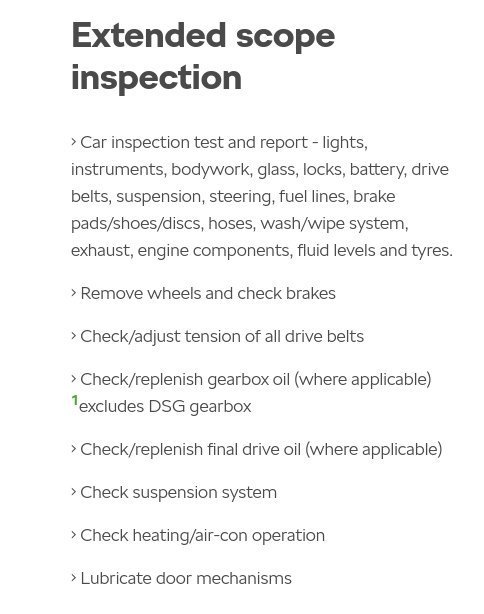

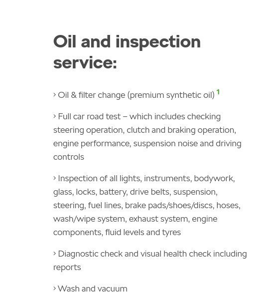

I should have added in my post that the cambelt cover is removed and the belt is inspected for signs of wear/ cracking/ fraying at each service. Well, at least that's what I was told.
@Scotjimland  That is no Replacement Schedule then.    Loose words from them, 'Service'.
Somehow these muppets think Oil changes are Servicing.   Not just Oil & Filter Services.      Inspections of belts is all about Servicing & Maintenance and schedules.
They like money for old rope.
