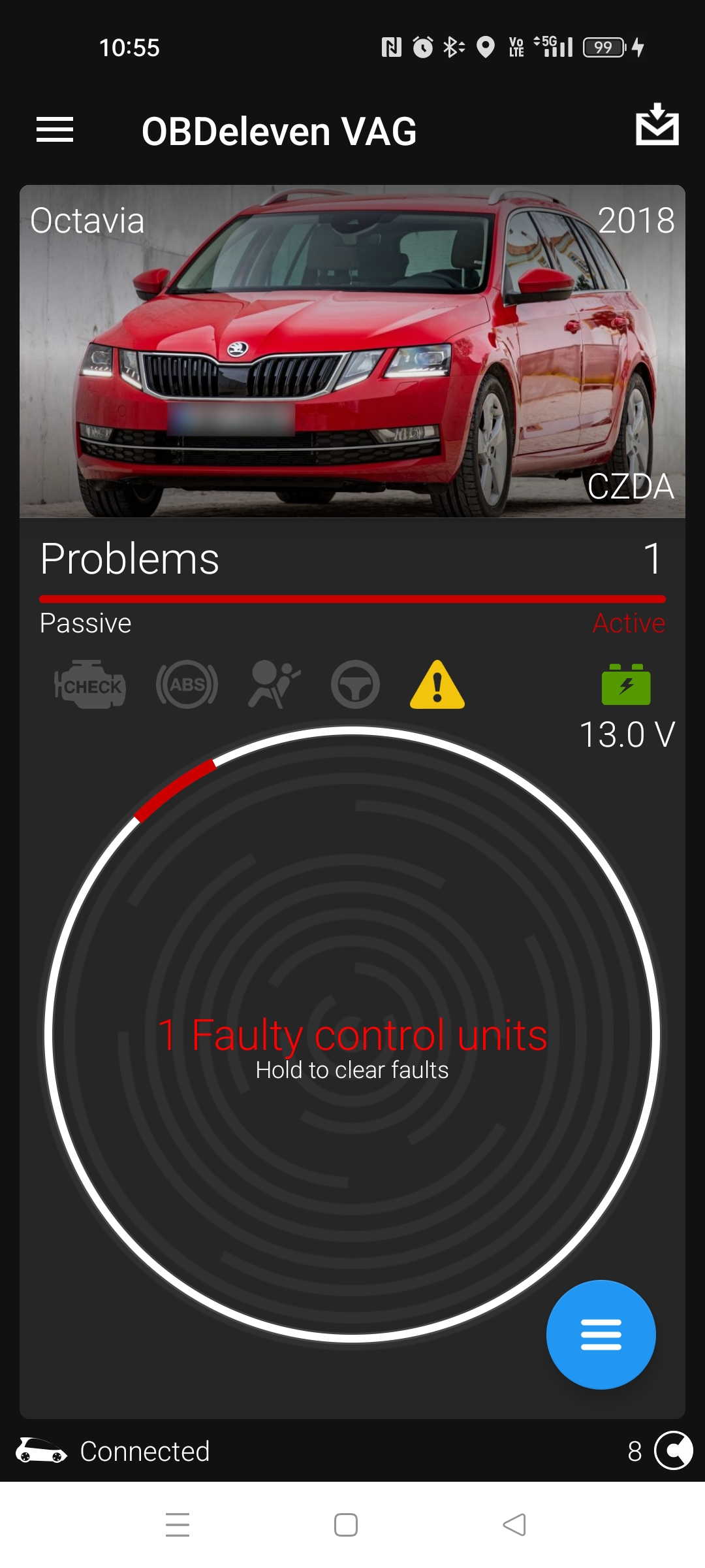

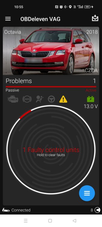

No, it doesn't show the reason. when i scanned, it gave me fault for cyl3 misfire + random cyl misfire only.
OBDeleven data log
Date: 2023-08-29 23:17
    VIN: TMBBC7NE9J0155483
    Car: Skoda Octavia
    Year: 2018
    Body type: Estate
    Engine: CZDA
    Mileage: 167650 KM
01 Engine
    System description: R4 1.4l TFS
    Software number: 04E906027HD
    Software version: 3742
    Hardware number: 04E907309BH
    Hardware version: H26
    ODX name: EV_ECM14TFS01104E906027HD
    ODX version: 001007
    Long coding: 01250032232401080000
    Trouble codes:
        P030000 - Random/Multiple Cylinder Misfire Detected
            static
                Date: 2023-08-29 22:40:19
                Mileage: 167627 km
                Priority: 2
                Malfunction frequency counter: 1
                Unlearning counter: 255
                Engine speed: 752.50 1/min
                Normed load value: 16.1 %
                Vehicle speed: 0 km/h
                Coolant temperature: 96 °C
                Intake air temperature: 50 °C
                Ambient air pressure: 1000 mbar
                Voltage terminal 30: 13.028 V
                Dynamic environmental data: 20965011BE000C13F4820EF40683F4463810D3001A14B408FC
        P030300 - Cyl.3 Misfire Detected
            static
                Date: 2023-08-29 22:40:25
                Mileage: 167627 km
                Priority: 2
                Dynamic environmental data: 209650F44638F40B21101000A314B408FC1199100017460001432100
