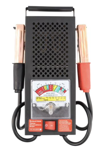

37 minutes ago, indars said:
what's this?
A proper old school battery tester, it can't be beaten if you know how to use it correctly
I still use mine but the scale range was designed when vehicles had far smaller batteries, if you look at the staircase type scale between the yellow Weak and the green OK you will see that each increment relates to a different battery AH capacity range, the needle is nearly as thick as the increments.
Inspired by mine I made a similar drop tester for intruder alarm and access control system batteries using  car cigarette lighter and an LED array, its time the Chinese did something similar to the above tester.

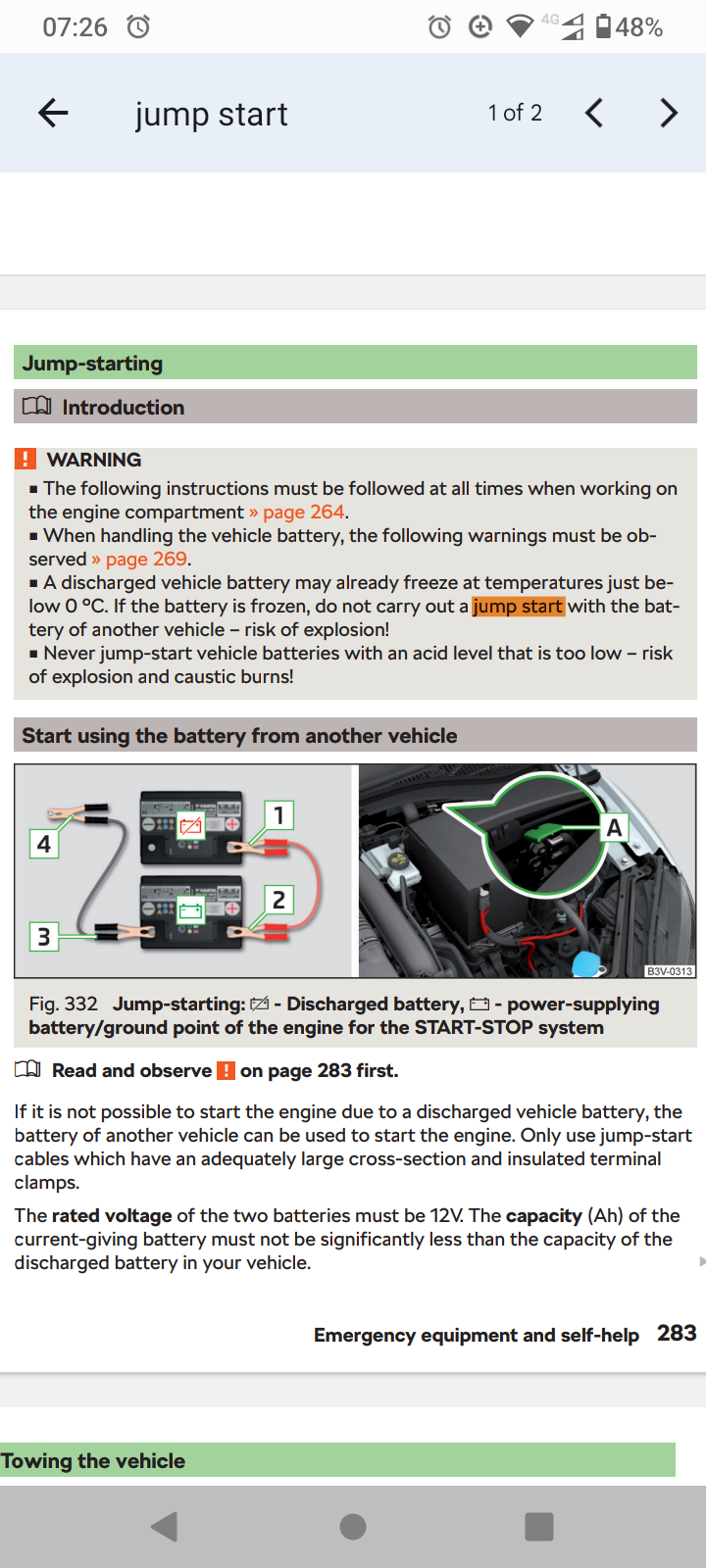

The manual states you must only jump start using the ground tab and not the negative post as you are bypassing the battery current sensor and confusing the battery management.

40 minutes ago, Graham Butcher said:
If yes then that may the cause of your problems as the current sensor has been bypassed and confused the charging regulator meaning the battery could have been overcharged and suffered internal damage. Or it might be under charging and may just need charging and recoded again.
With all due respect your speculation of the results of jumpstarting directly to the battery is nonsense.
The reason for saying what I said was that if the car has been jump started using the incorrect method that the resultant current flow risks damaging the current sensor/battery monitor attached to the battery negative terminal cable clamp. This could then result in the battery charging management system not having the correct info being received from the monitor and can do one of the two things I originally mentioned. So it could overcharge and damage the battery plates internally, or it may be undercharging.
jump start.pdf
Sorry but that is pure fantasy and may cause unnecessary alarm to the OP or other readers.
The current flow through the shunt resistor when jump starting would be no different to that when cranking from a healthy battery.

If you are attributing :
"if the car has been jump started using the incorrect method that the resultant current flow risks damaging the current sensor/battery monitor attached to the battery negative terminal cable clamp. This could then result in the battery charging management system not having the correct info being received from the monitor and can do one of the two things I originally mentioned. So it could overcharge and damage the battery plates internally, or it may be undercharging."
as the words of your Skoda service agent then they are talking nonsense and you are repeating nonsense, if you understood where the simple shunt resistor lives (its in parallel with the negative cable from the battery to that stud) and its purpose you would have known they were talking nonsense.
