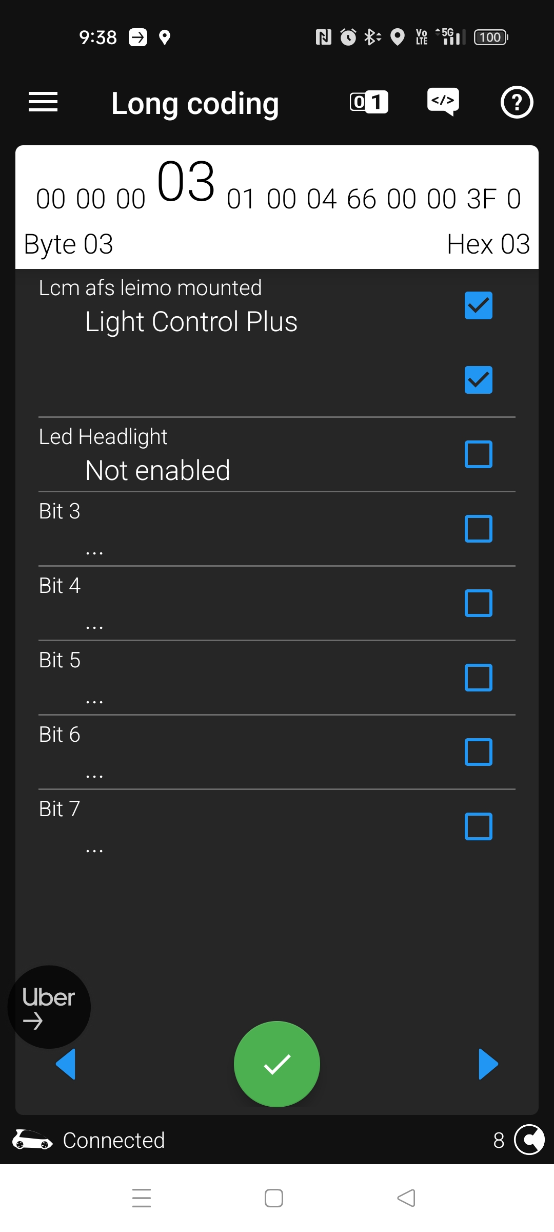

On 03/09/2023 at 15:22, Graham Butcher said:
I can see something incorrect to me here in long coding in Multicunction module
LED Headlight:  Not enabled.
Just wondering if i change it to enable what may happen?
Just because it says it is not enabled, does not mean that it is incorrect, it would only be applicable to a car that actually has LED headlights, do you actually know if your headlights are LED, Halogen or Xenon? What you are seeing might well be an option that some Octavia's have, but this will vary my the actual model within the range, or it may an option that can be specified as a factory fitment at the time of ordering the car when new. Now I don't know quite how the OBD11 device you have actually works, it might be a simple matter of toggling between Enable or Disable, or it asks you to input a long string of numbers and letters. Do you have a manual that was supplied with the device, if you have it might be an idea to read it and if it offers help in that area. I'm not an expert in that area at all so I cannot really advise on that.
Maybe if you post again with the make and model information on the device, maybe another member might be able to help you further, but I can't.

7 minutes ago, Graham Butcher said:
Do you actually know if your headlights are LED, Halogen or Xenon? What you are seeing might well be an option that some Octavia's have, but this will vary my the actual model within the range, or it may an option that can be specified as a factory fitment at the time of ordering the car when new. Now I don't know quite how the OBD11 device you have actually works, it might be a simple matter of toggling between Enable or Disable, or it asks you to input a long string of numbers and letters. Do you have a manual that was supplied with the device, if you have it might be an idea to read it and if it offers help in that area. I'm not an expert in that area at all so I cannot really advise on that.

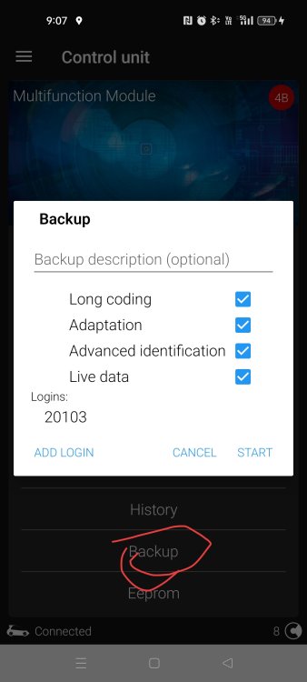

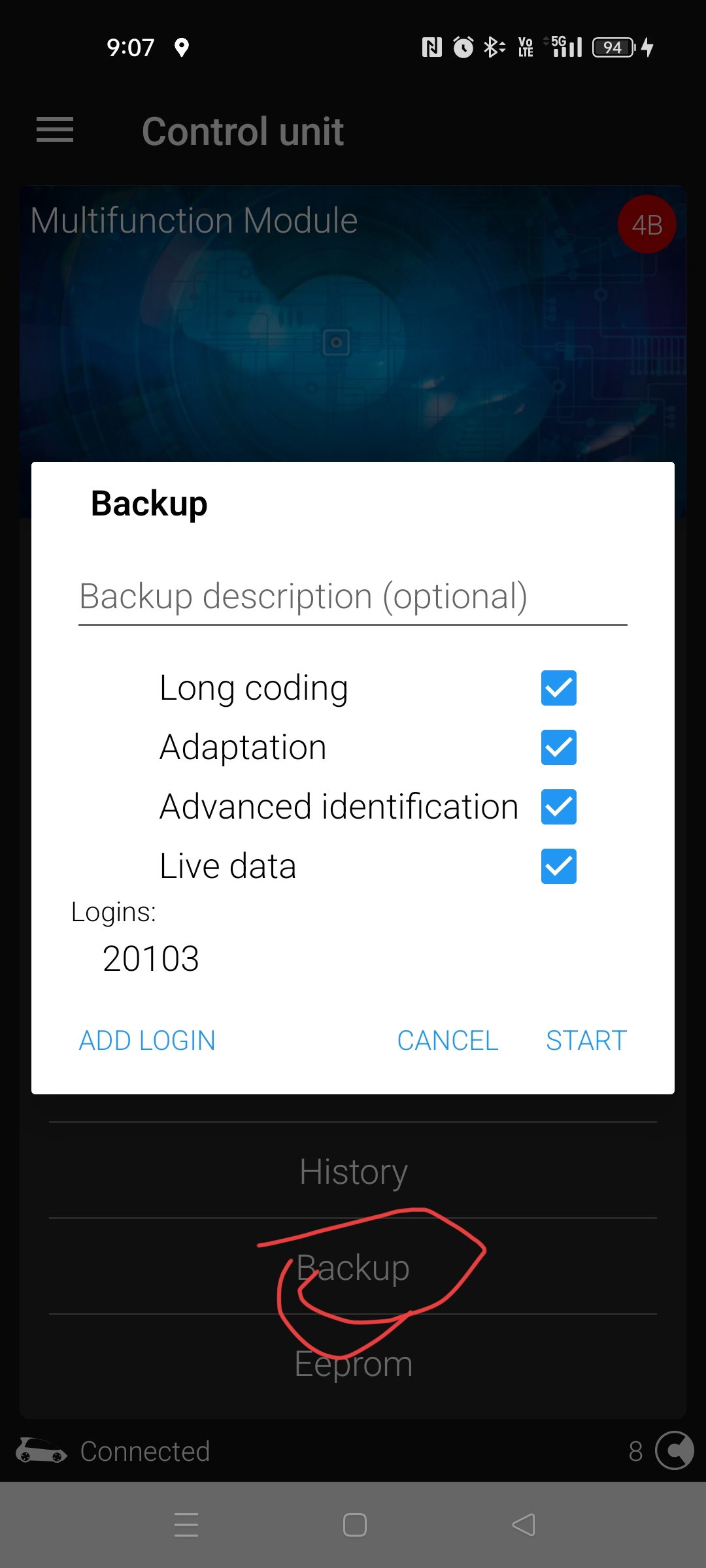

Post the full lcode and adaptation map from 4B. I think OBDeleven calls this a 'backup' and should be available after entering 4B...?

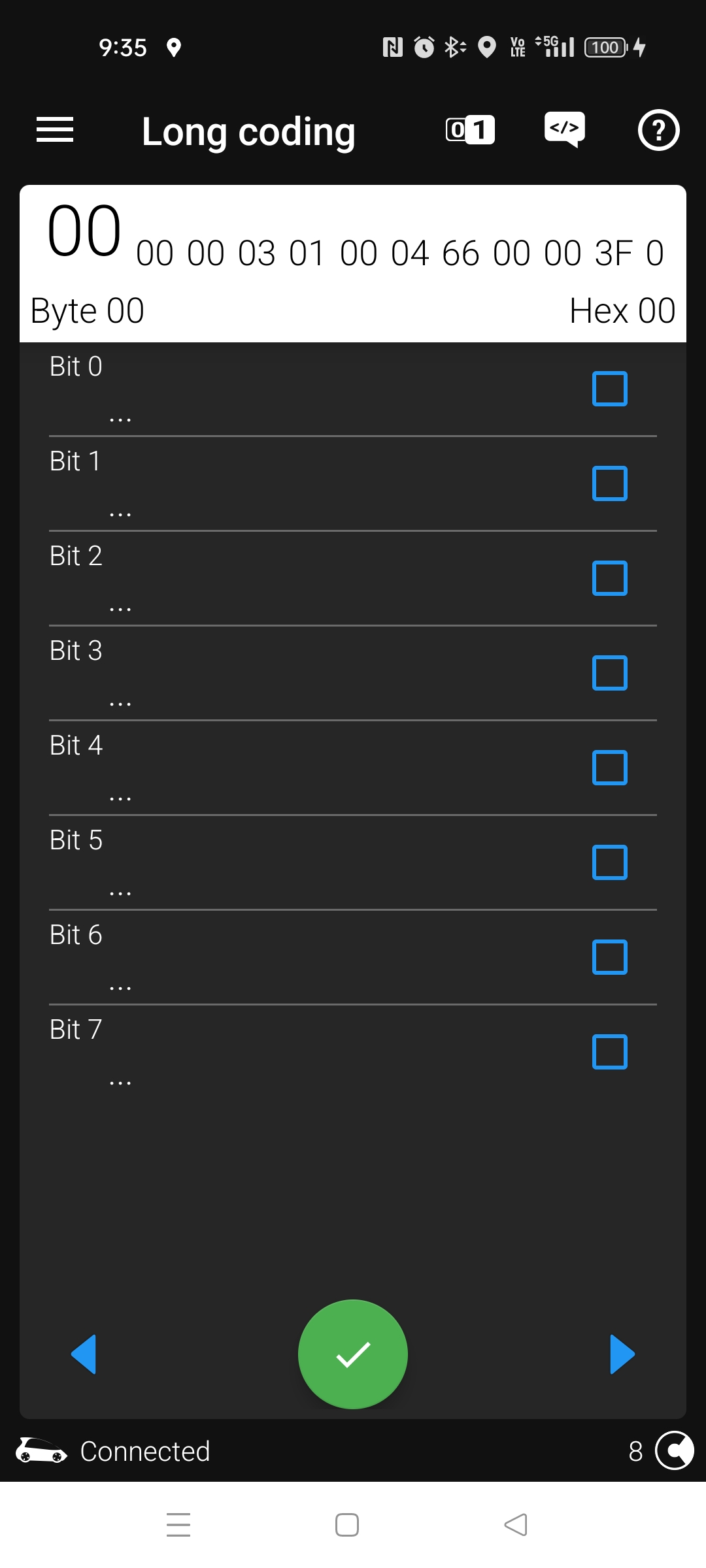

Just checked the 4B lcode in the scan: 000000030100046600003F01010000000000000000000000000000000000
This appears to be incorrect, especially as no other scan online shares the same lcode.
I would suggest trying: 000000070100046600003D01010000000000000000000000000000000000
As per this reference scan: https://forums.ross-tech.com/index.php?threads/11938/

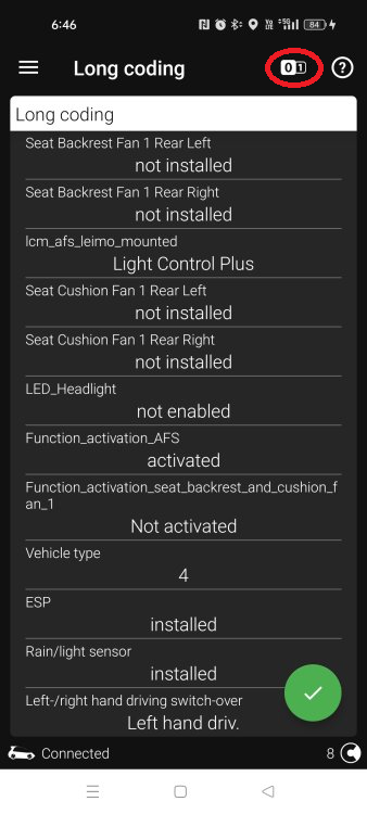

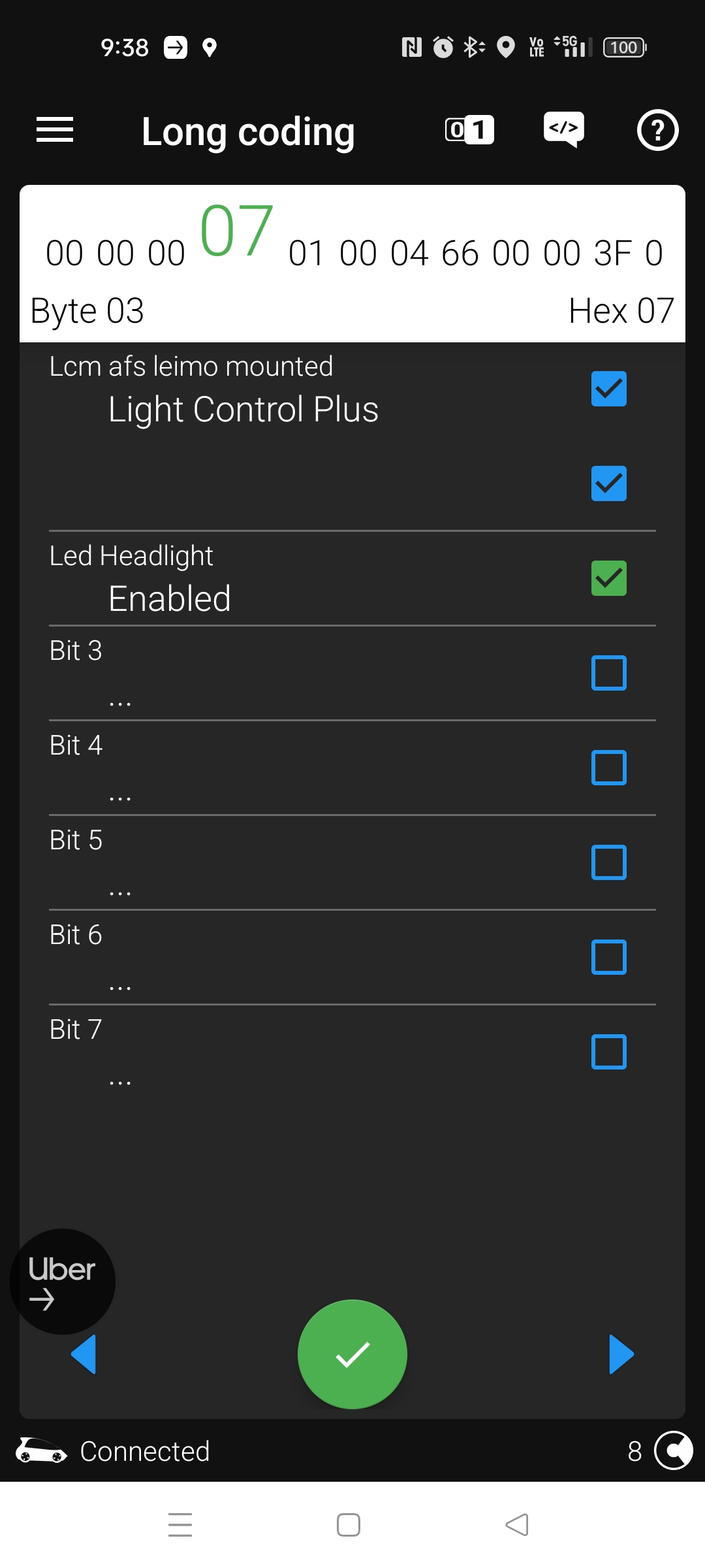

I wouldn't know where to input this code. Here in obd i just have toggling option. I wen to backup but it seems it will try to do back up once i click..but i didn't.
Complete guess, but maybe try hitting this button:
I have a feeling that'll then change to the proper lcode rather than their descriptions. You can then follow these instructions: https://support.obdeleven.com/en/articles/5608788-long-coding
You need to change:
- byte 03 from 03 to 07
- byte 10 from 3F to 3D
As that's probably easier than typing out the entire lcode :)

That's what i can see once i clicked on the top right as you highlighted.
I can see, it is same option like i mentioned..LED enabling and disabling..look at these screenshots.

I can copy and paste this long code.i tried to paste it and it works ..but I am scared to do it..previously i tried to fix this problem by changing/toggling options and it brought head light range fault on the maxidot display..
You'll need to perform basic settings after changes to 4b. So you'll probably get an error until then.
You already know what the coding was so worse case, you set it back.
What to do in basic settings though?
Most likely, just click start and the OK/acknowledge - I have zero idea how OBDeleven will present this. Ross-tech state the following: http://wiki.ross-tech.com/wiki/index.php/VW_MQB_Headlight_Regulation

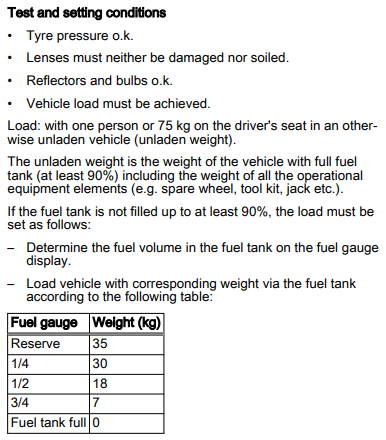

Please double check you're in module 4B before you hit basic settings.
In an ideal world, you then need to perform basic settings on a flat, level surface, whilst meeting these requirements:
Edit:
Turns out there is even a video for OBDeleven, just remember it's 4B not 55:
Edited by langers2k

automass, are you getting flashed at by other motorists because the headlights are too high?. If not self levelling is probably working.
That's exactly what i was thinking. Self labelling has been coded should be working. I am not getting honk from other drivers and my headlight low beam is not focusing to sky any more.
I am still scared to apply that code langers2k especially as you are also not sure about it. The headlight range  labelling warning is scary..previously I toggled an option which triggered it to pop in then i had to take the car to the same guy who did coding to adjust headlight labelling. Toggle the option back didn't eliminate that headlight range control warning.
57 minutes ago, automass said:
Graham, what information do you need for you to check that my car has LED front and back. When the car was advertised in carshop website it clearly stated about LED and then i cross checked before travelling to Manchester to buy it. I had 1.6tdi same car with halogen ..only reason to upgraded it was LEDs
N.B: I might be ignorant about too details of technical information of a car but not that much who can not identify halogen and LED .
Like I said before, the assumption you arrived at with the lack of a headlight levelling control was a red light and a warning bell to me because there are cars with LED headlights, that do also have the levelling controls on the dashboard.
I did also tell you that I was not an expert with OBD11, so I could not offer you any advice other than what I have already given. @langers2k has already confirmed that your car does have LED headlights, and he also has given a logical explanation of the function of module 4B is and how it operates, so you know need to pay close attention to his instructions as he is far more qualified on that topic than I am, I already told you I had zero knowledge of that, batteries and charging etc, yes, that is well within my ballpark. I still say that you have not yet solved why you were having flat battery issues and I suspect that until you discover why, you will suffer the same problem sometime in the future.
In the meantime, I'll leave you in the capable hands of @langers2kand he'll talk you through the steps to reactivate the levelling function of your headlights, and no, that would NOT be the cause of your occasional sudden loss of battery power.
Good luck.
@langers2k Thanks for the logic behind it. It all is now making sense to me after your detailed explanation, so I have today learnt something and that is good. I just hope that the OP can accept your knowledge on this matter and resolve his issue with his error codes.
Dash cam and faulty USB charger are to be blamed for battery problem. I am pretty certain about it now. USB charger has been changed, things all are working good now.
