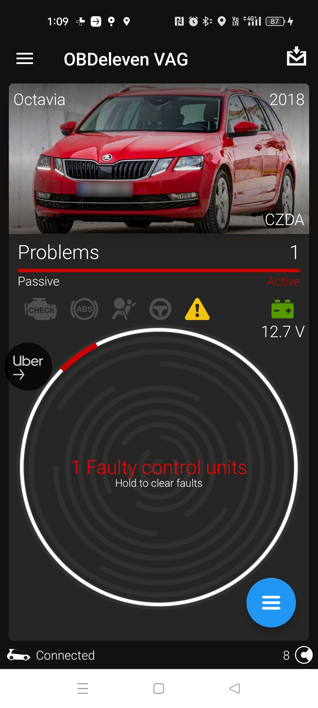

There is no electrical problem in the car that I have ever encountered. OBDeleven had authentication issue which they asked for the code few weeks ago..OBDeleven started working on the same day. it had authentication problem. So, they suggested me to uninstall and reinstall the app and restart the phone. and started working.
Last year on April i drove to Netherlands...and we went to a a shop to buy some groceries in there. as we came out of the shop, car wasn't starting. I had to jump start with the I had in my boot from some stranger's car. Well, that was with the original battery and I replaced it as soon as we got back to London. This time we went to Germany and before going to Germany battery started playing. but this time battery is fairly new.
the fault i have is something different, I mentioned in this thread already. this is 'Data  bus front light'. when i had my rear coil springs replaced months ago, local garage guy accidently snapped the sensor for the headlight leveling. so LED Module Left (D6) and LED Module Right (D7) accidently being activated during some coding (which can not be deleted). I have a thread about it. I'll be happy if you can help me how to disable this two modules.
If you have altered coding in another Module then that may be your problem. Modules not shutting down when the ignition is turned off.
Its time for you to measure the current drawn from the battery when everything is turned off.
Agreed.
Automass. To disable modules you need to first be sure that what you are doing is not going to have unintended consequences, then if you want to go ahead you delete the module from the "Installation list" or it could be "Installed modules" list, I believe that it is found within the programming of the Canbus Gateway.
You might then get fault codes where these now alien modules are trying to contact the mother ship, if this happens (like it did with my Bluetoooth module) then you need to disconnect them.

His obd thing has recorded an intermittent misfire cyl 3, and something about databus front light.
Xman has advised him to measure the current draw with everything switched off. That is definitely the first thing to do to rule out something draining the battery (you need to do this test automass), possibly caused as Xman suggests by interfering with the coding of the light module.

How to test the battery myself! Can I use OBDEleven to do that? As an example put the car in access mode and turn everythng off. then keep an eye on the battery volt
Because this problem has a habit of reoccurring and the reported apparent OBD11 intermittent misfiring issues and not being authorised warnings etc, I think there are other underlying issues and because there are so many control modules in the modern car that depended on the correct functioning and communication between them using the cars network, that I seriously recommend booking the car in for proper checking and diagnoses / repair.
